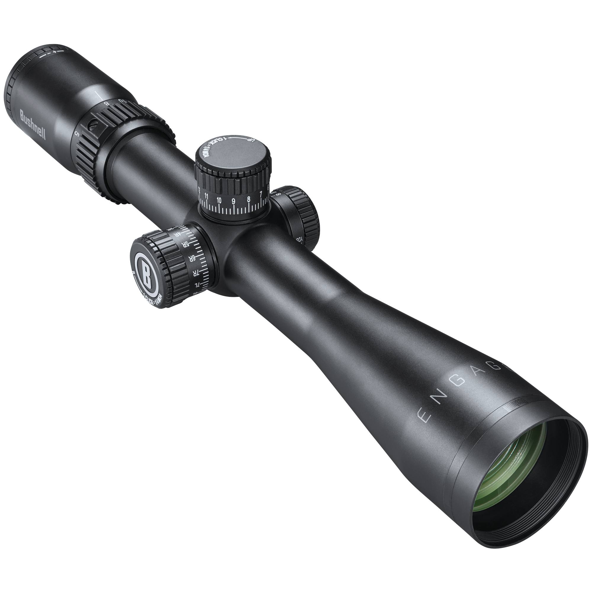

Bushnell Engage 2.5-10x44
Vortex diamondback tactical comes close
6-24x goes down to 10 yards parallax
4-14x goes down to 20 yards parallax
