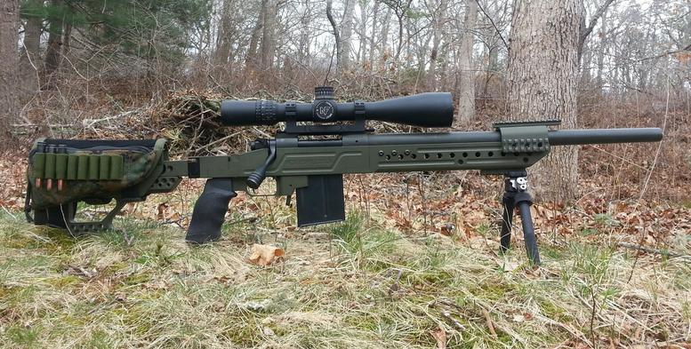

I had this A2 worked on by Dana English. http://englishrifles.com/index.html
Dana cut the barrel to 24", threaded it and indexed an AAC suppressor adapter. He bedded the action and finally he installed the CDI bottom metal. It deserves a better scope than I have on it. It is a great stick. Dana made a safe queen into a favorite.
I had this A2 worked on by Dana English. English Rifles - Precision Gunsmithing

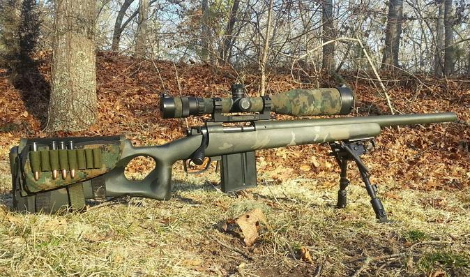

What optic is that?
