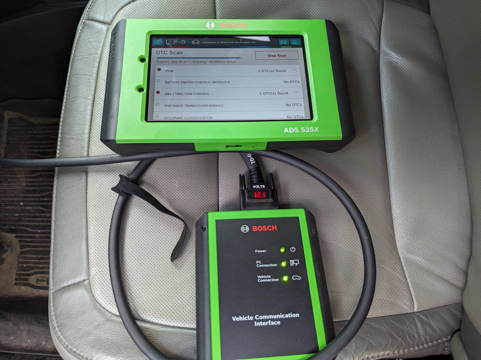

I like the Bosch and it was about half the price of other "big name" brands, but admittedly it's overkill for the average home mechanic. Given the other "investments" that I've made in this stupid hobby, it still felt like a good value.
If I had stricter budgetary constraints, something like the XTOOLS D7 or whatever Autel currently offers in the ~$500 range would be my choice. I don't think they offer pass-thru programming, but they should pull codes from almost all the modules on an older vehicle and aren't subject to stiff yearly maintenance costs. I know this is a lot more expensive than the $50 scanner hanging off a peg at AutoZone, but IMO one has to look at the money being saved by not relying on a shop and investing accordingly in tools.
