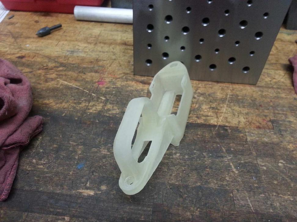

Hi Guys..sorry for the delay in responding, we have been crazy bizzy here. We are getting new machinery in the shop and that's consuming alot of my time. We have the design worked out and will start making test parts shortly. I have a rifle here AND a McMillan stock, so we will make it so it wont take much to fit into your rifle. Stay tuned, were working on it.. thanks for the support
Jeff and Pam

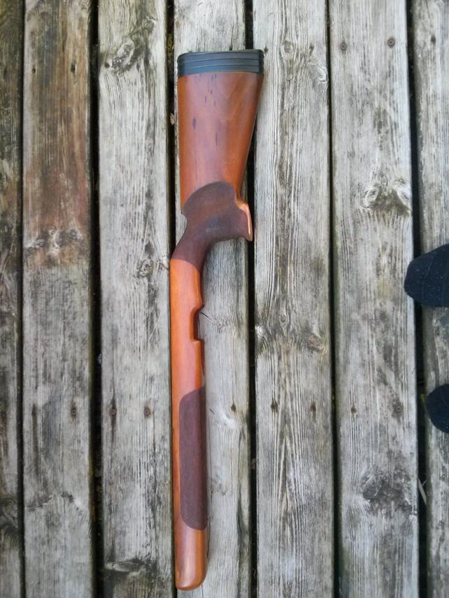

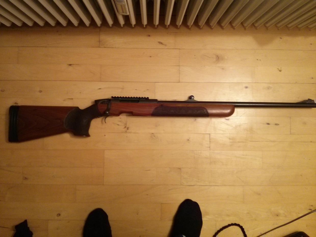

I bought the rifle with a wooden stock, it appears to be a Mchale stock, but i have not been able to find another picture on the internet of a Mchale stock in wood, so i assume that its a stock that has been made to order, but the original Steyr plastic triggerguard fit perfectly in it, and i assume that the CDI product will do aswell.
Take a look at the pictures and let med know if you agree.View attachment 21567View attachment 21568

While your stock looks similar to a McMillan mchale, I assure you the wood stock on your rifle is a factory Steyr stock. Ive seen a few Steyr SSG's with wood stocks such as yours. You certainly don't come across them often. Congrats on owning a fairly rare configuration.
Check out the SSG Match rifle listed right now on GunBroker; same stock as yours.
