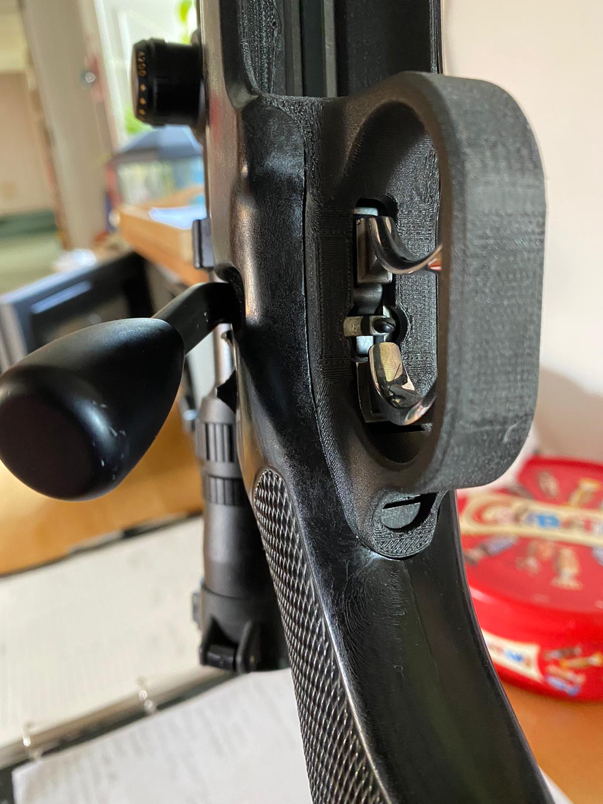

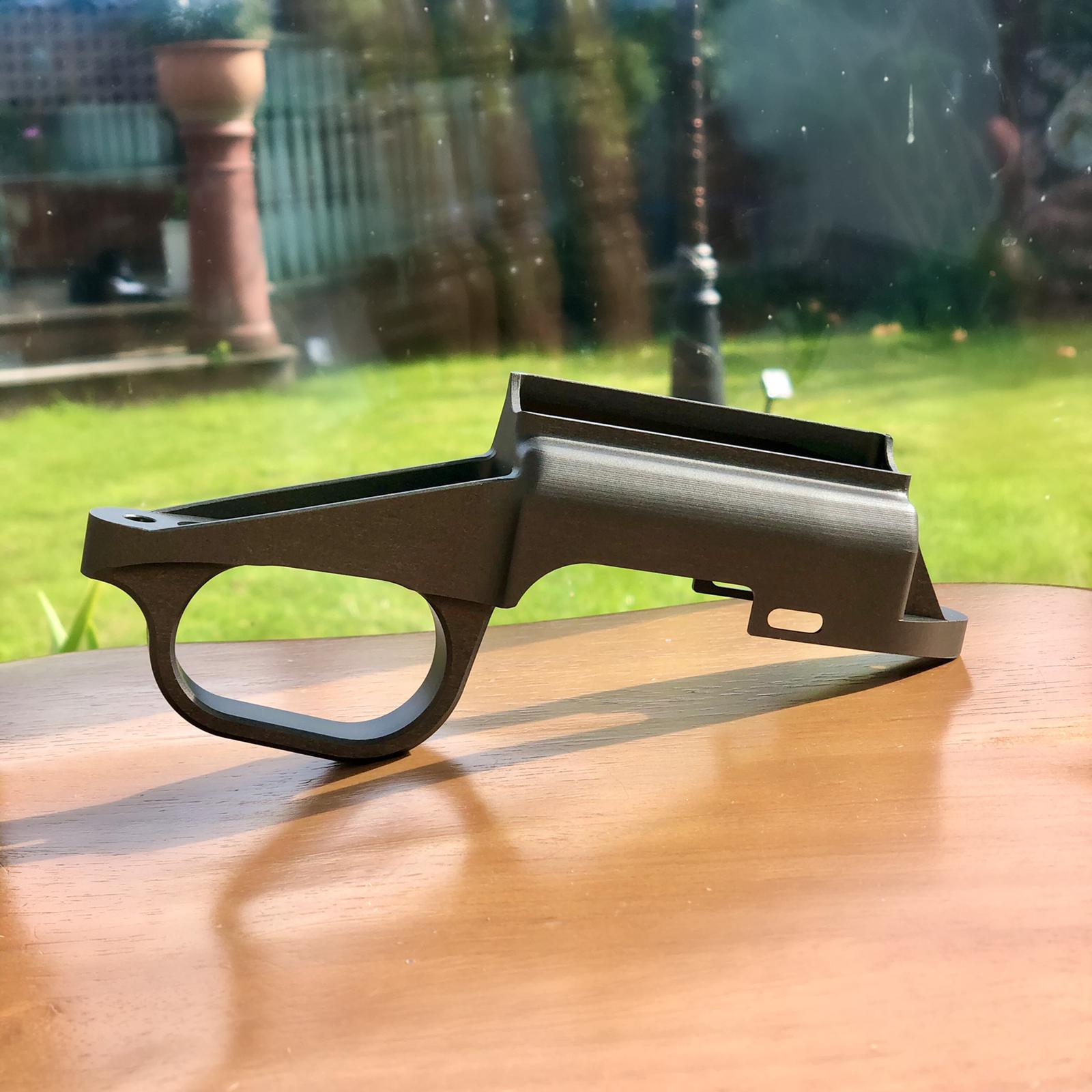

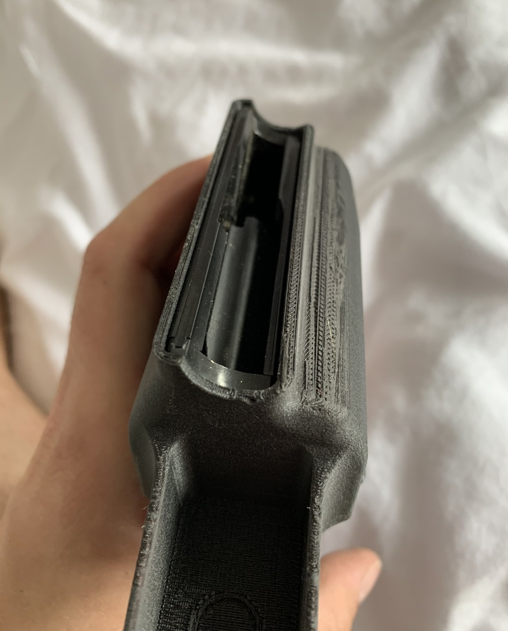

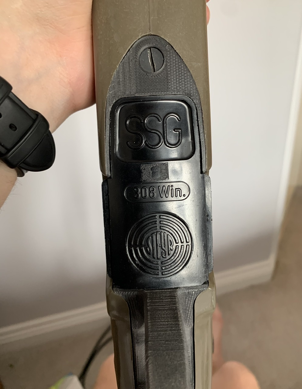

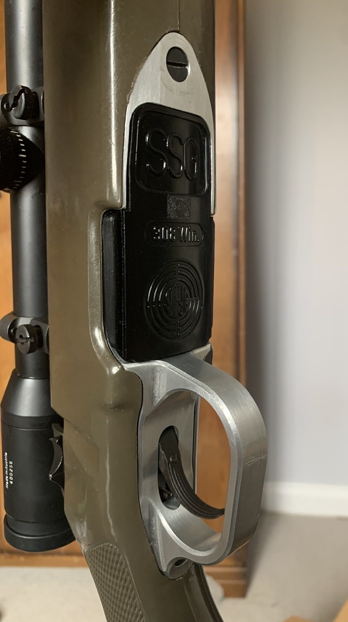

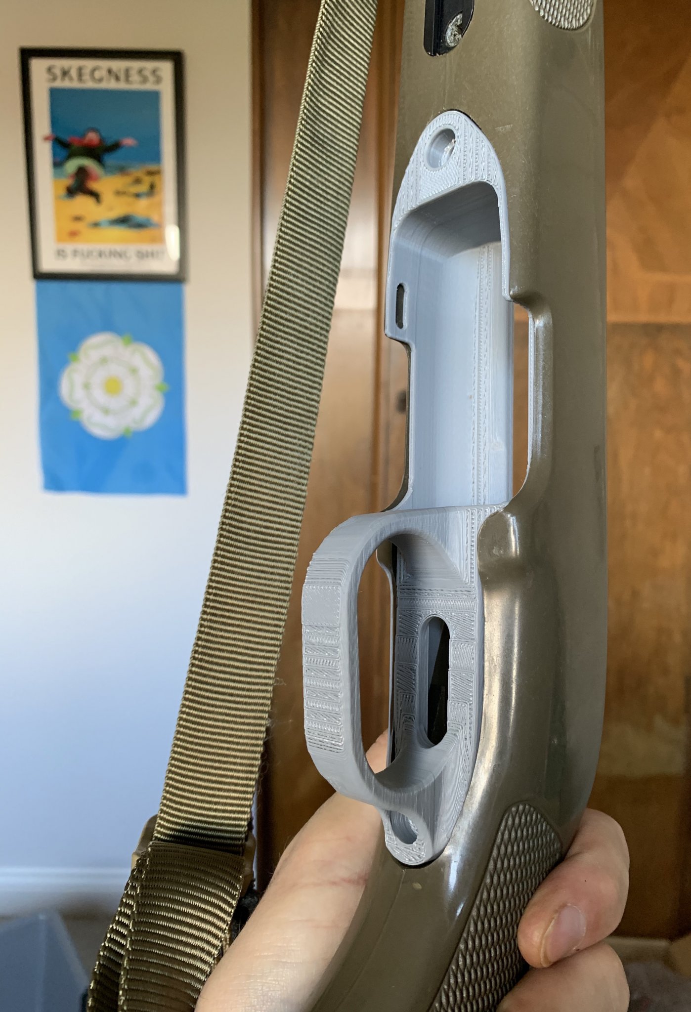

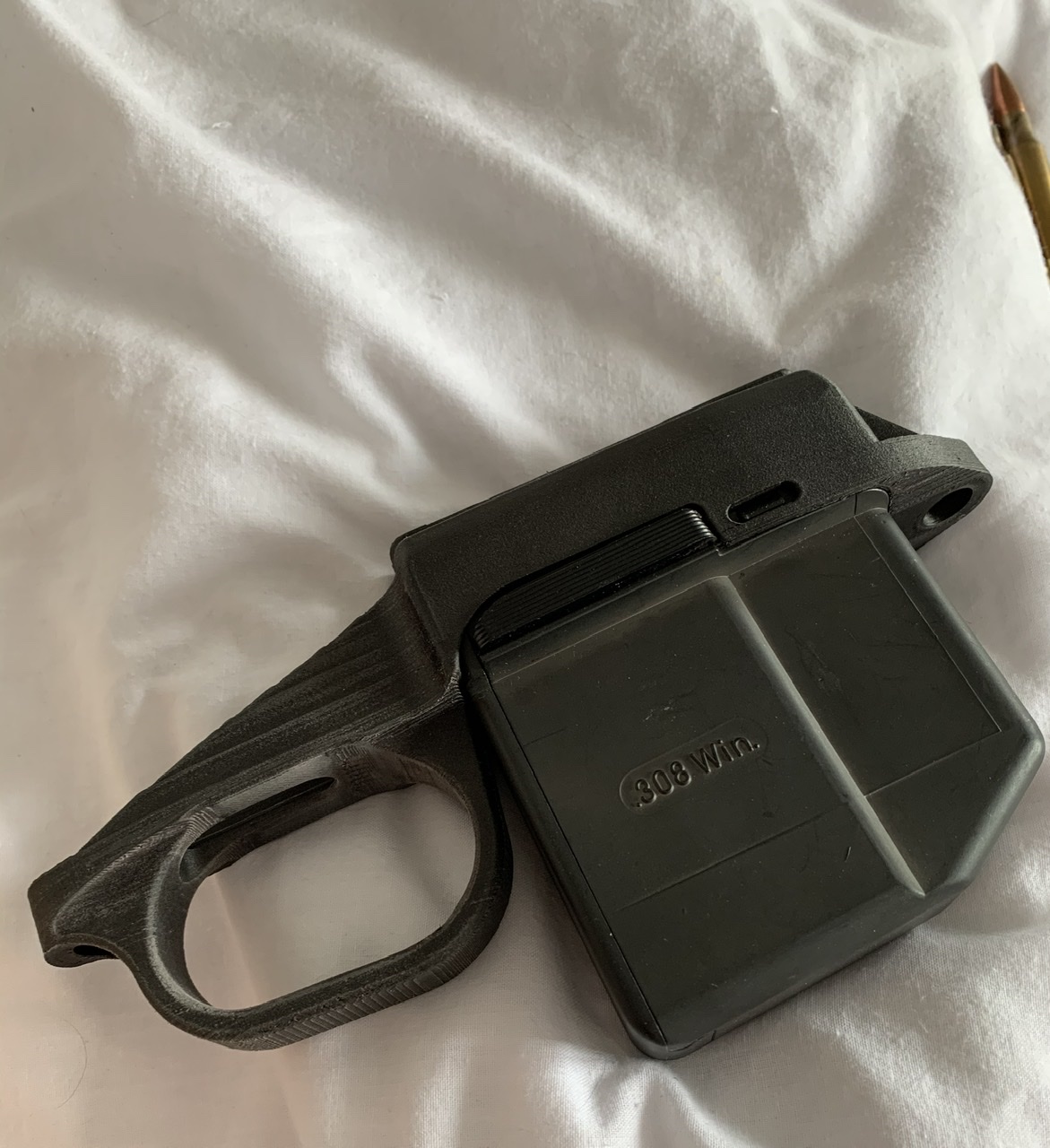

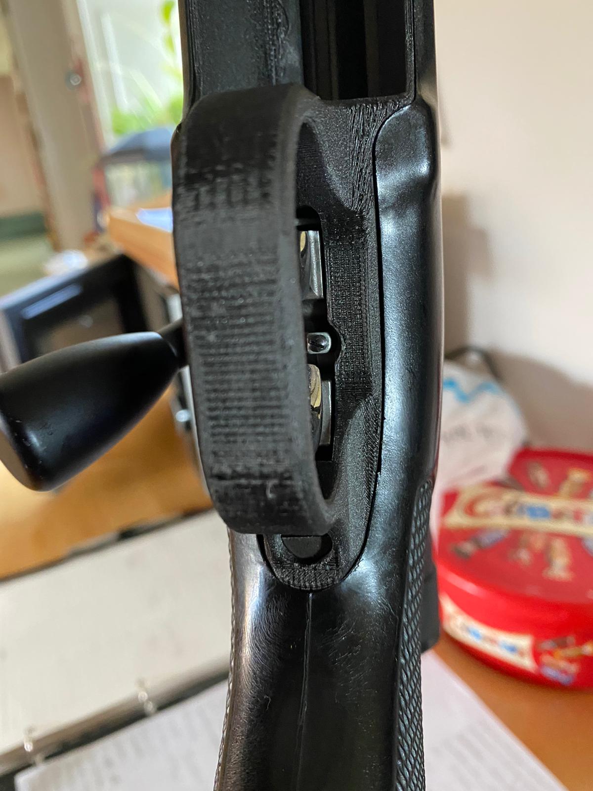

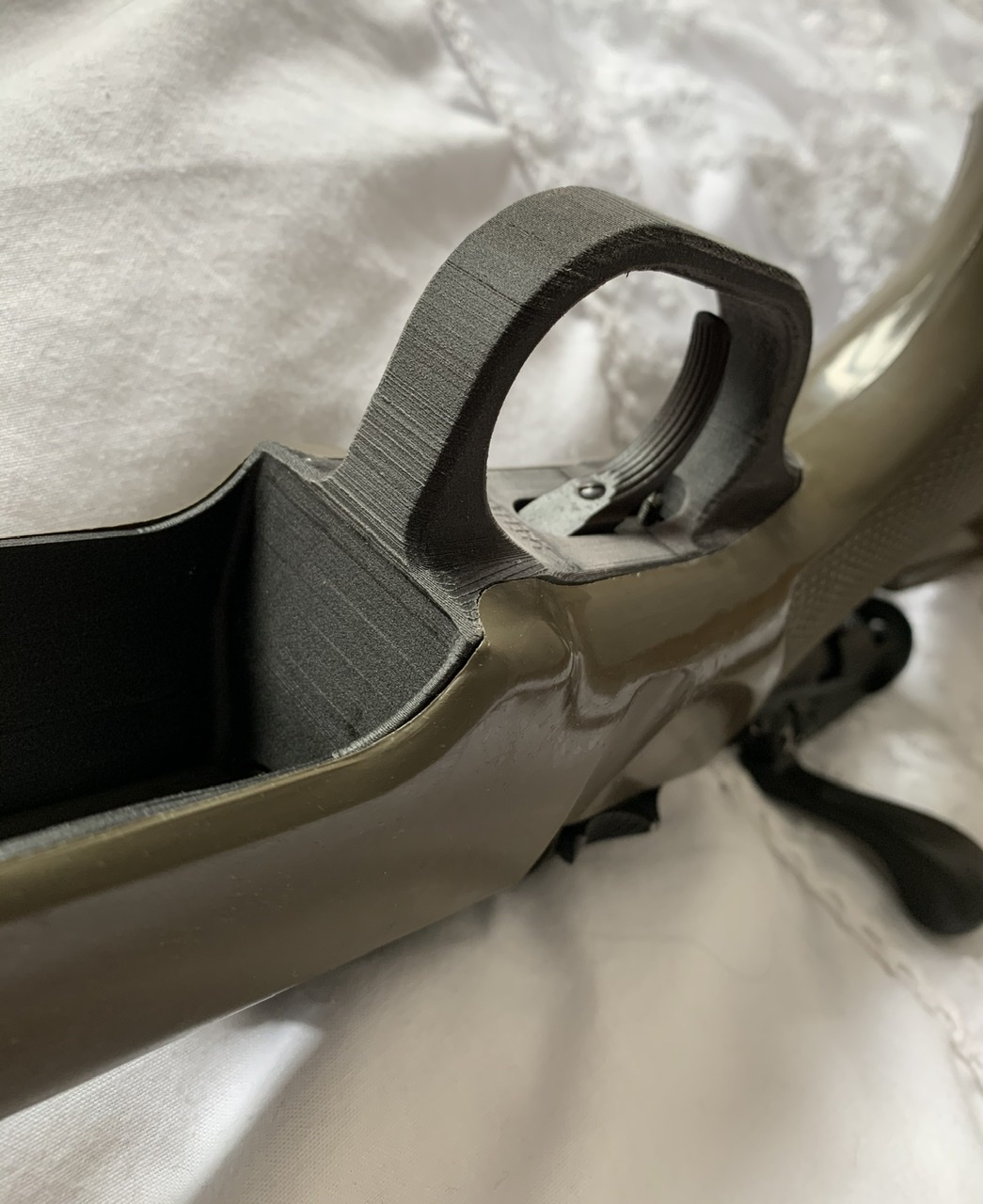

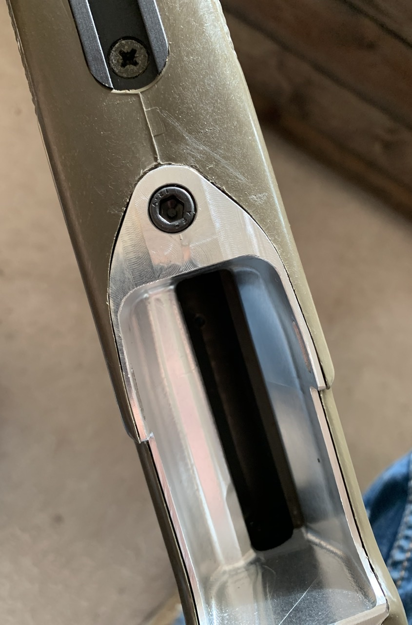

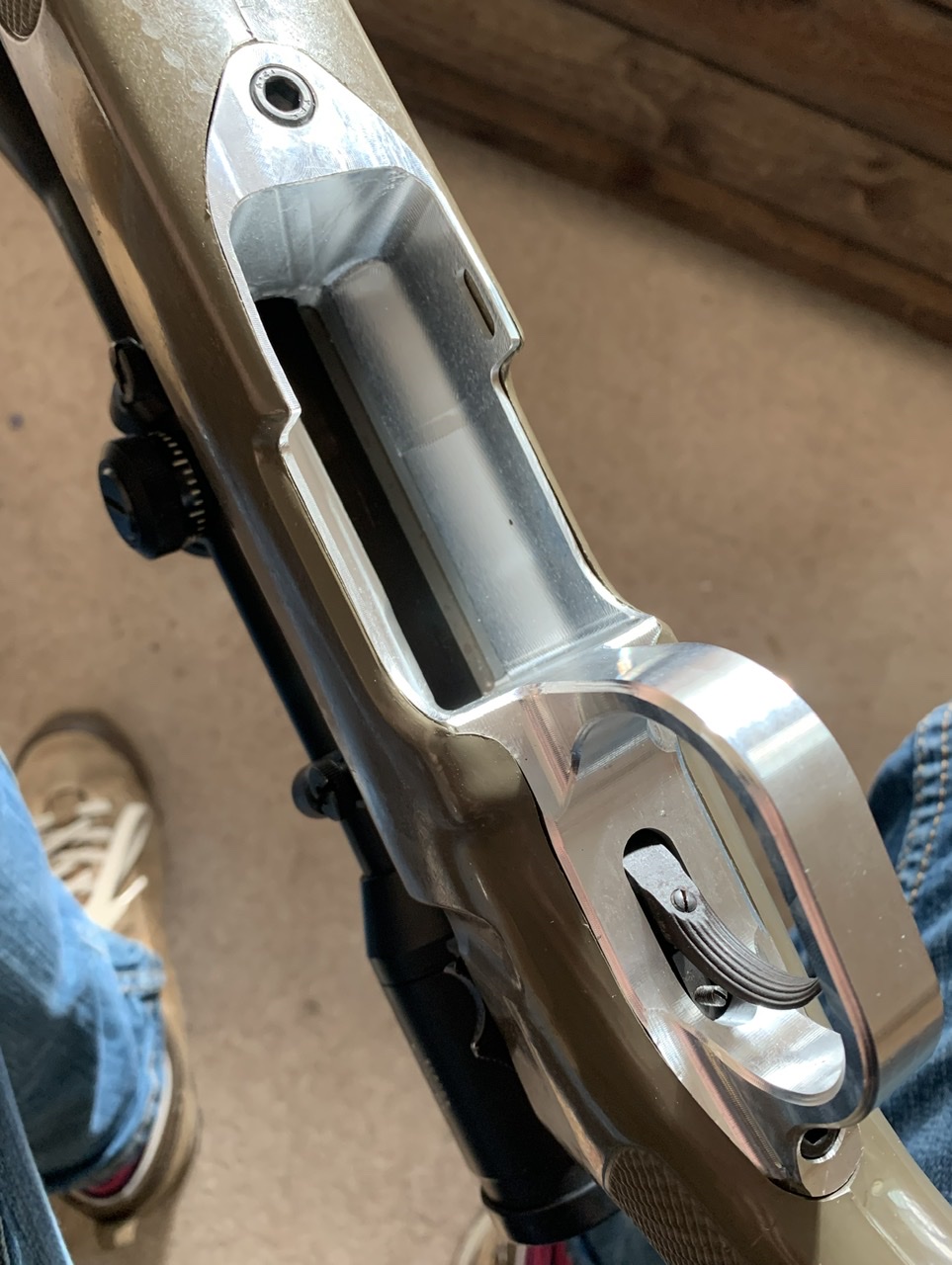

Sorry to bring this thread back from the dead but I stumbled upon it earlier. A few friends and I have been working towards creating a CNC milled aluminium magazine housing for the SSG 69 to accept the original magazines. A 3D model was made from an original housing and from that we had a prototype 3D model printed. That has been refined and another is heading my way currently. Once the second has been tested for fit and function we'll go into production of the CNC version.
A picture paints a thousand words so here are some of the first prototype:

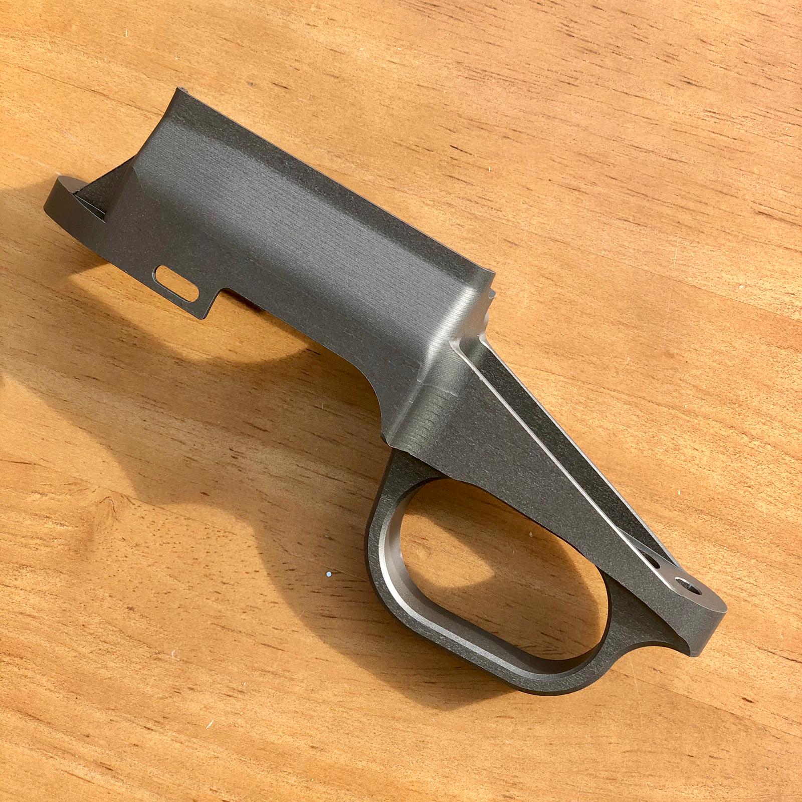

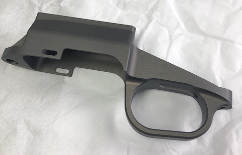

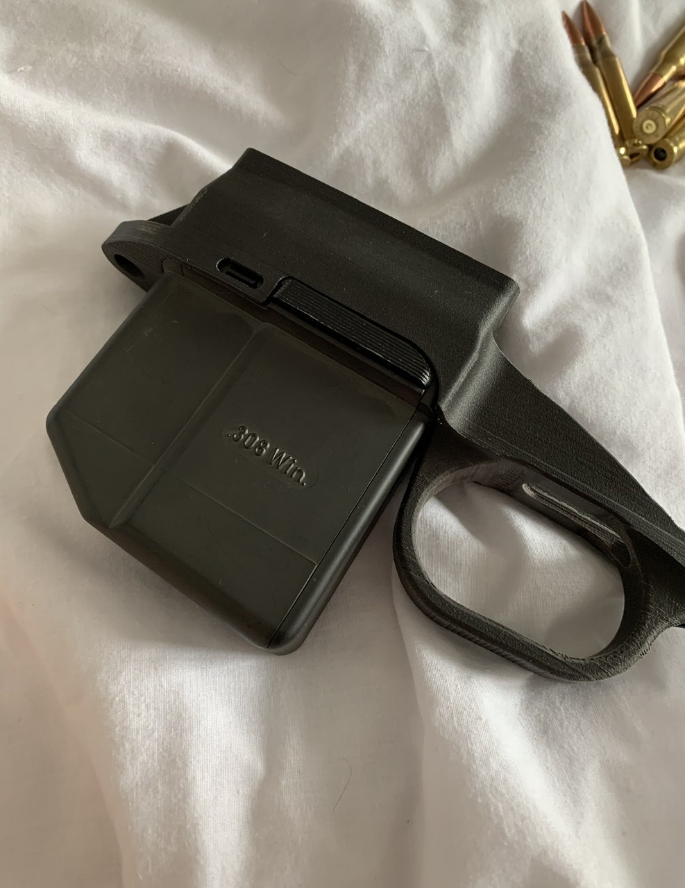

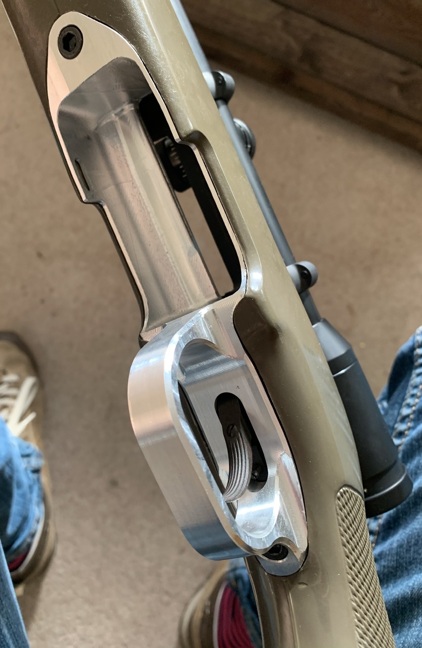

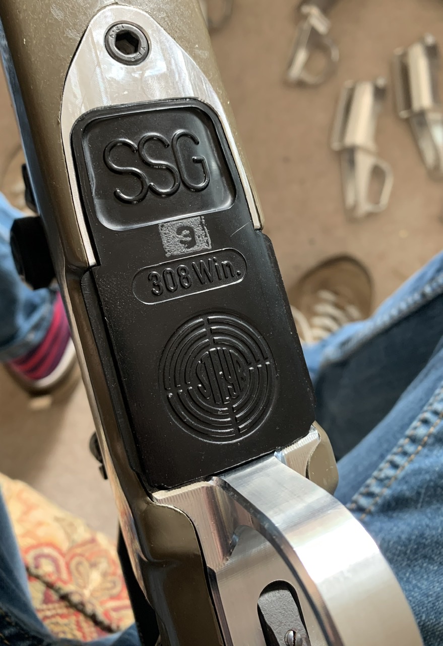

The rest of the batch is here! Unfortunately there will be a delay to them being vapour honed and anodised but hopefully it won’t take too long! They all fit and function perfectly.

Ah for sure, it’s on the ‘to look into’ list! I will keep everyone posted but right now I’m focusing on getting the CNC’d original version out to people!

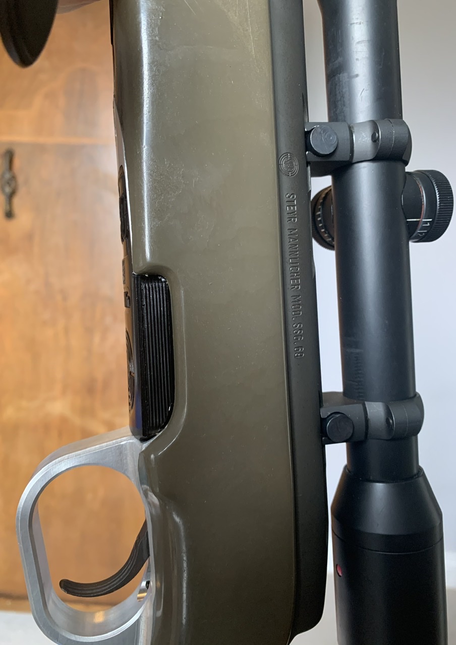

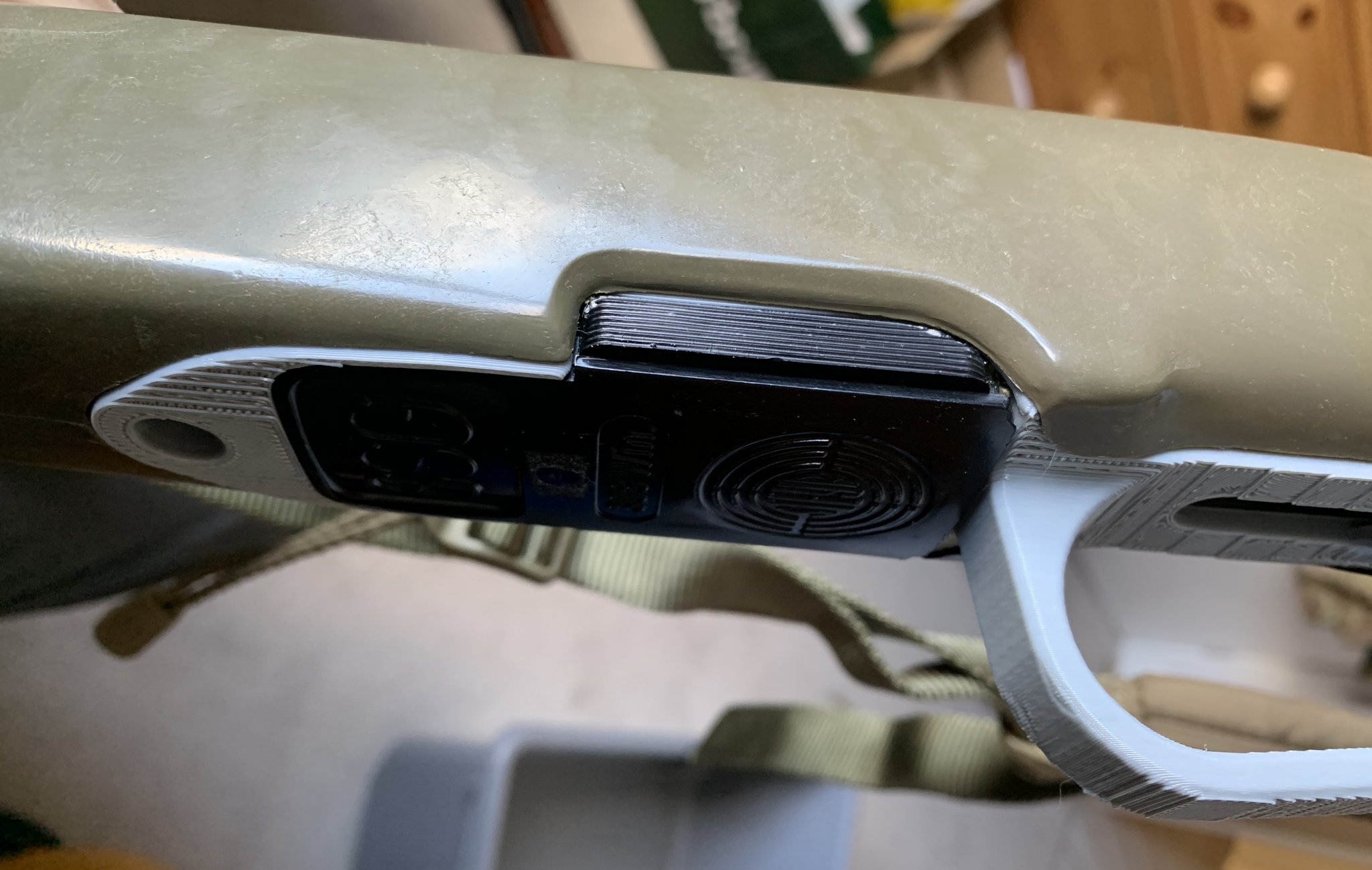

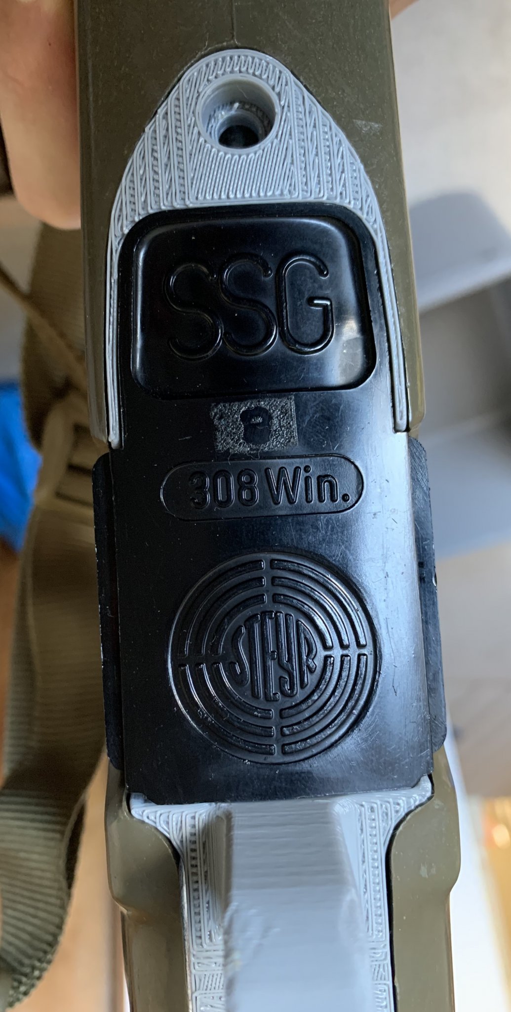

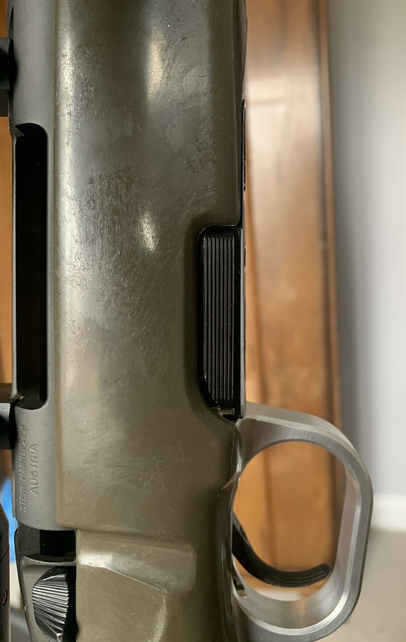

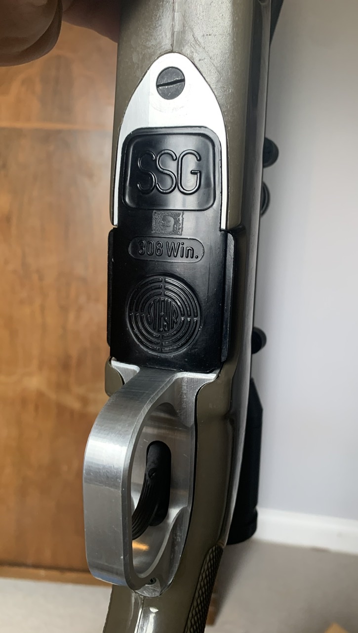

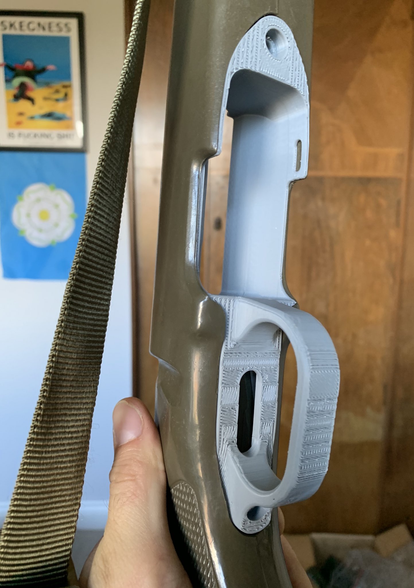

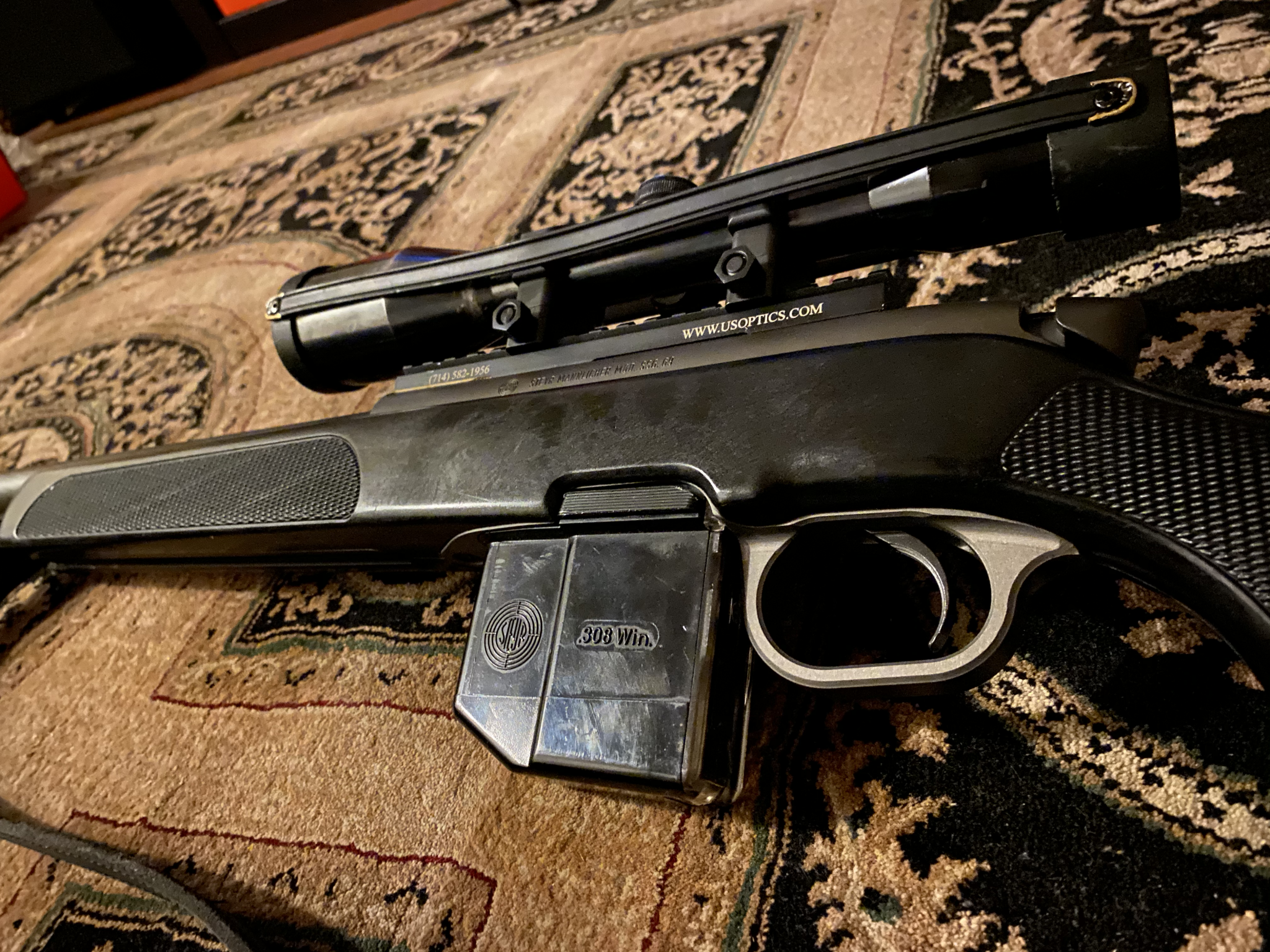

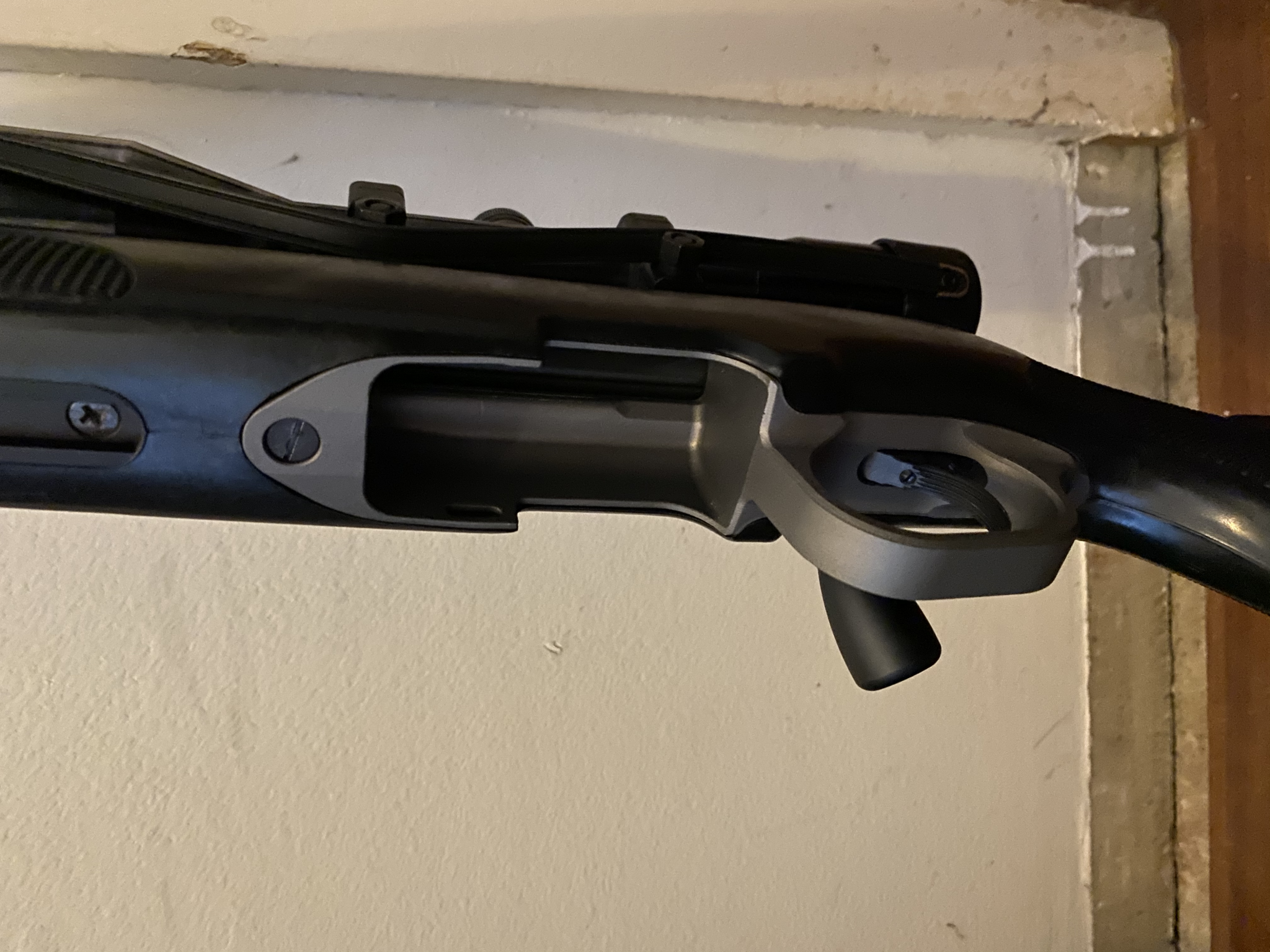

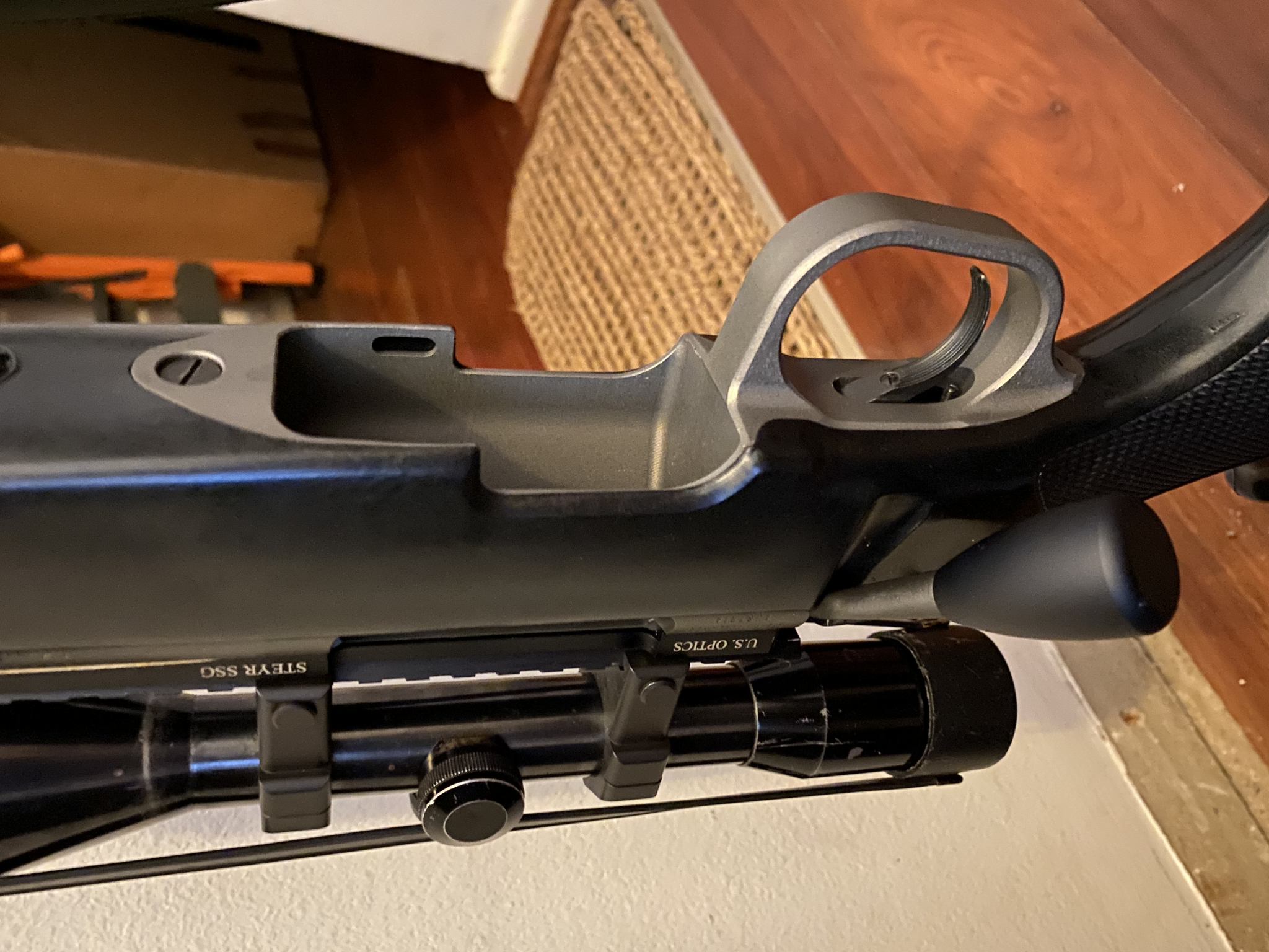

Got mine installed. It's excellent. Easy swap over and everything works as it should. Can store my plastic one away now for if I ever sell it (which probably isn't likely given that next to my K98k ZF39 sniper rifle and my m/41B Swede it is my equal dream sniper rifle and they're not going anywhere!

So to answer the original question, the new design of bottom metal is suitable for both the single and double trigger versions of the rifle. It’ll be the only one supplied from now on for ease of production. It’ll be the same for the AICS magazine version - one bottom metal for single and double triggers!
