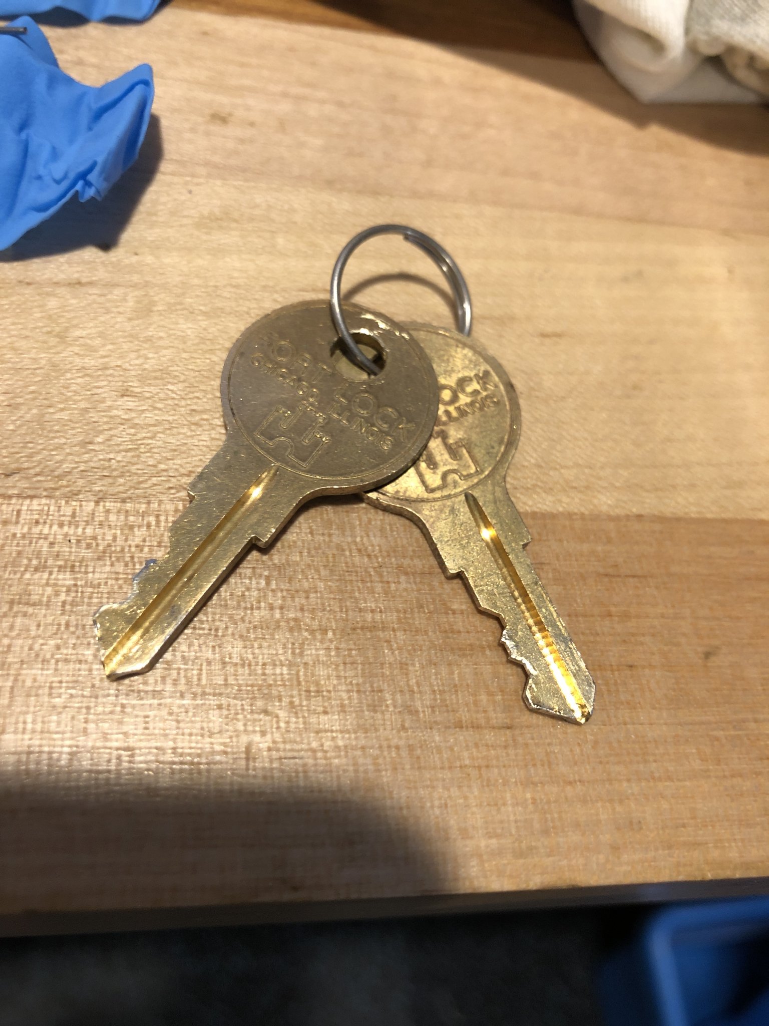

    I thought these keys on my gun bench were for the cabinet and I think I am right.
    Mother fuckery won’t fit in the hole.
    It’s like one of the pins is popped out of place and cock blocking it.

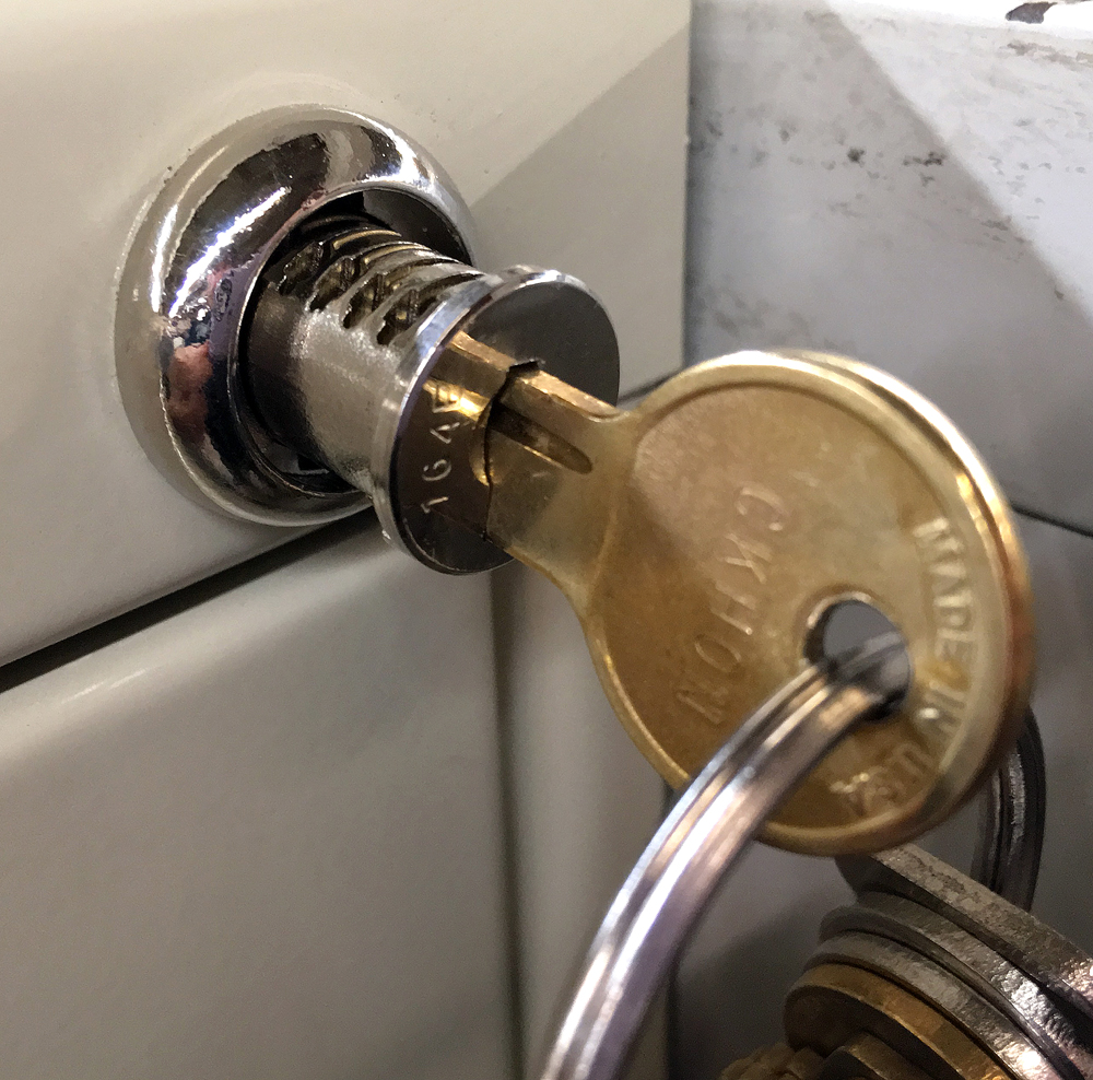

    Wafer lock like that, you should be able to open it easily with improvised "picking' tools. There's pretty much no lock easier to open.
    Go watch some more videos. lol
    If your tried it "pick" it, that's the problem (assuming you were trying to turn it the right direction). You're better off rocking it, just random wiggle waggle on that sucker.

    Well strictly speaking, that lock shouldn't have pins. It has wafers. And I have to say, I've drilled oodles of locks, but I've never drilled a wafer lock because there's never any reason to, they're just so easy to open.
    You can just kill it with a big drill bit and the center plug should fall out.
