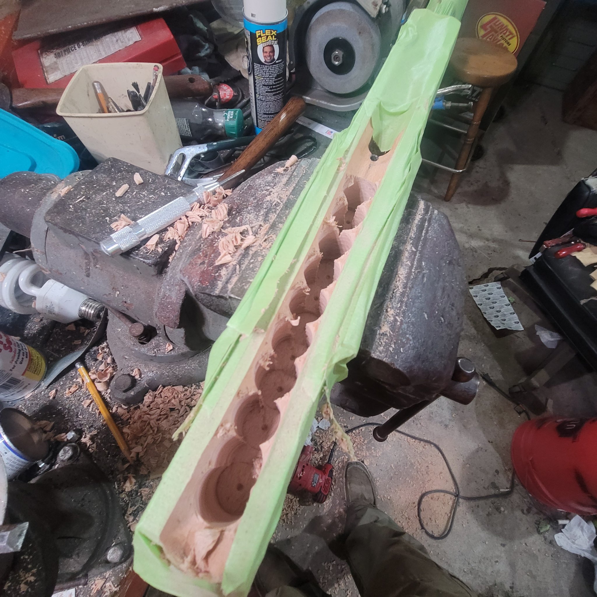

    I was going to drill cavities under the stock, or in the lop spacers I made. Hoping the lead straps aren't too wide for under the barrel.

    As for the clunking I may pour the lead into copper pipe that's .5-.75"OD and drill a matching hole, more than likely itll Be over sized so I'll ad a few drops of shoe goo, or a few wraps of electrical tape to make it snug but removable.
    If my calculations are close it'll be about 11 pounds without lead, and hopefully I can stuff at least a pound in.

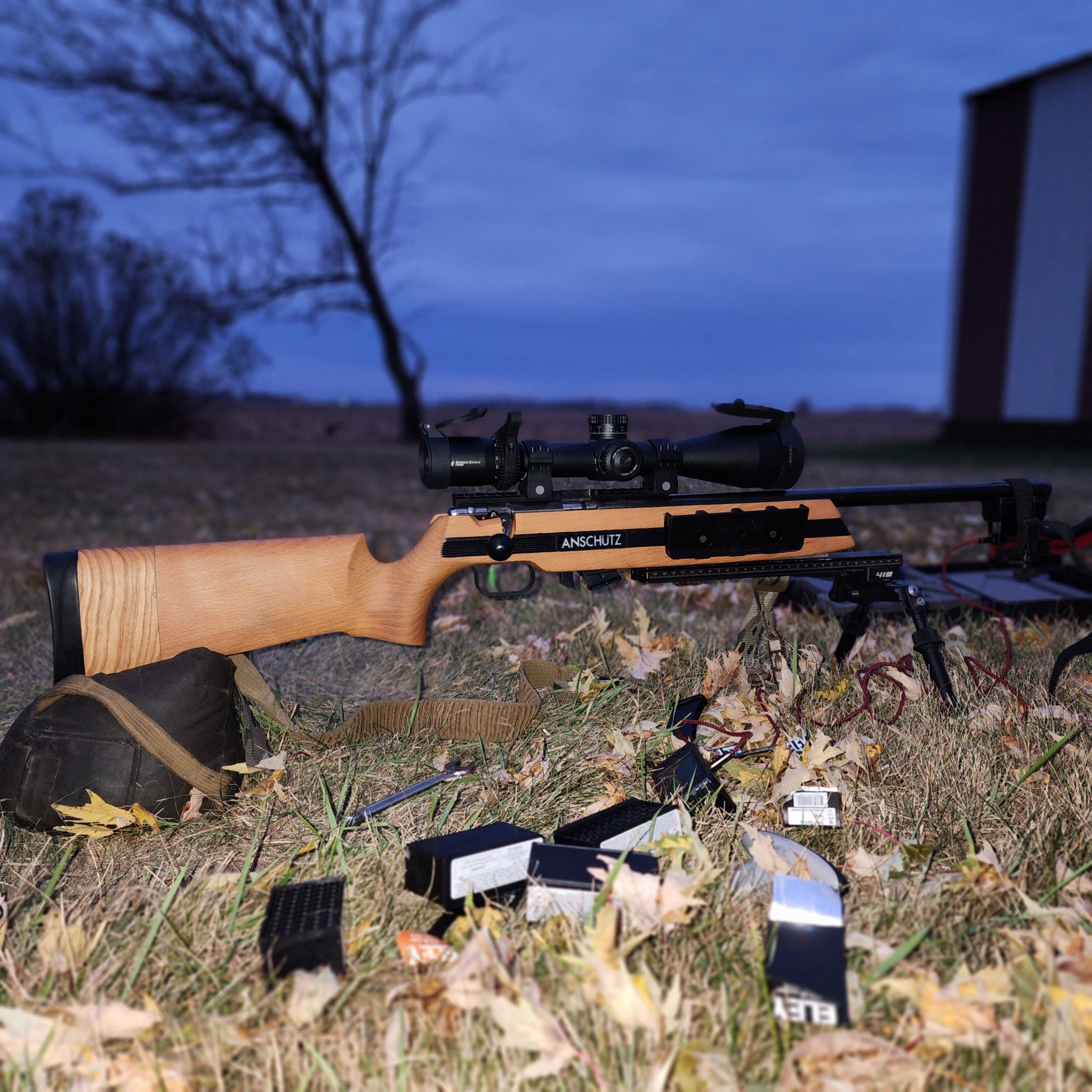

    Took a 1907 Annie.
    Chopped the stock to fit more like a MSR stock.
    The weight was off. Added probably 3-4 pounds to the barrel channel.
    Added probably 3-4 lbs to the butt stock.
    Added probably 1/2 lbs to the pistol grip.
    Balance point once set up for comps.

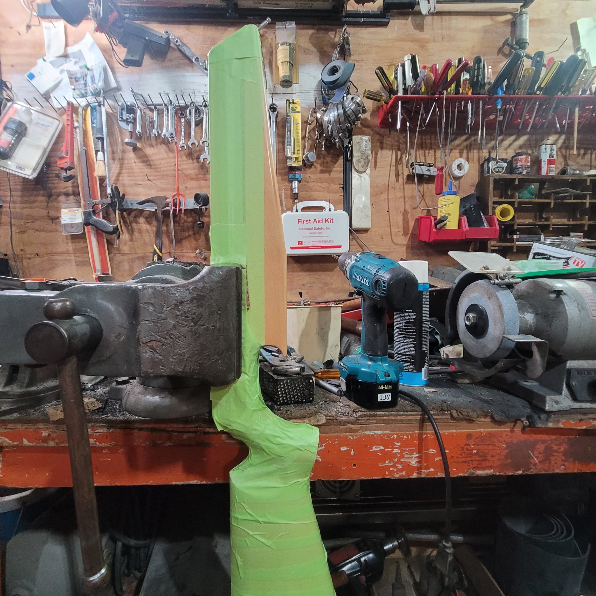

    Yes. That shop is a fucking disaster. Moved home and only have access to my old man's shop that he hasn't entered in 10 years. It's been cleaned up some since then.
    Added some LOP.

    Took a 1907 Annie. View attachment 8030263
    Chopped the stock to fit more like a MSR stock.View attachment 8030264
    The weight was off. Added probably 3-4 pounds to the barrel channel. View attachment 8030265View attachment 8030266
    Added probably 3-4 lbs to the butt stock. View attachment 8030267
    Added probably 1/2 lbs to the pistol grip.View attachment 8030268
    Balance point once set up for comps. View attachment 8030269
    Added some LOP.

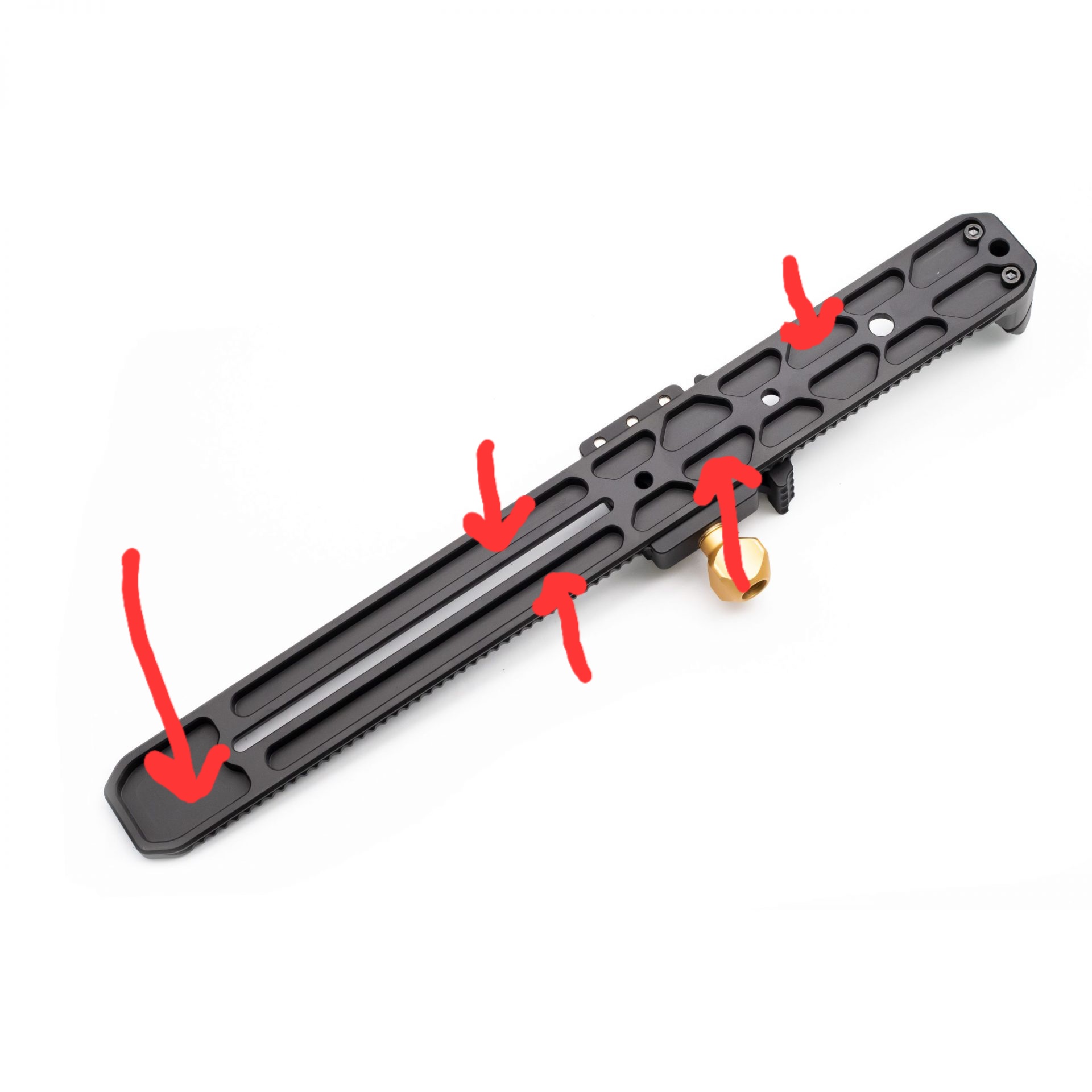

    I thought about putting shot in the back of the rail. Boyds stocks have a 1/2"X1/2" or so void under the barrel. So it's whatever I can pack in there. I think lead decoy straps are going to fill the most space but I'll probably have to cut it down both directions, not sure on the width of them.
    Reactions: camocorvette
    29oz steel ARCA rail, https://l3idesignsolutions.com/product/14-inch-universal-arca-rail-heavy-steel/

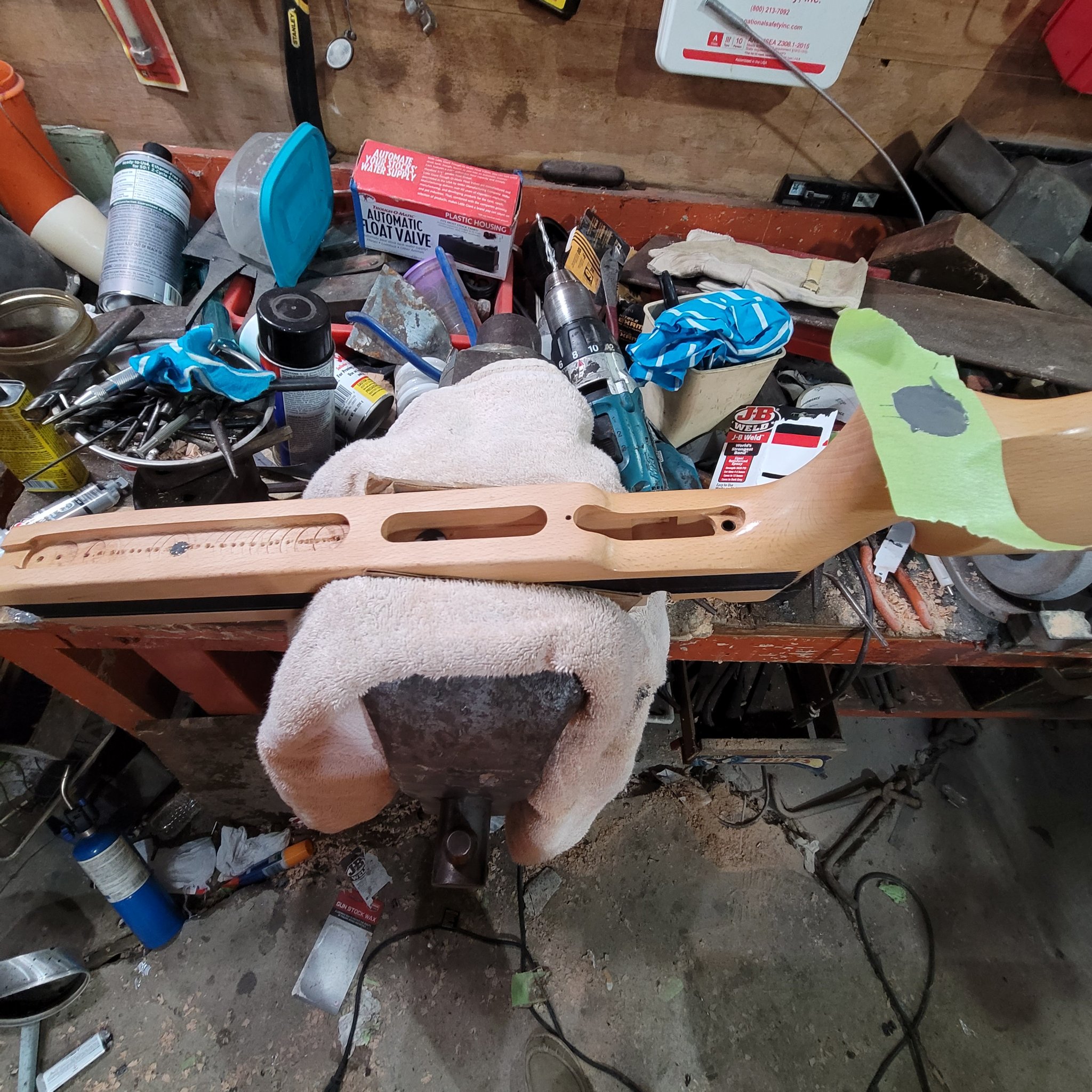

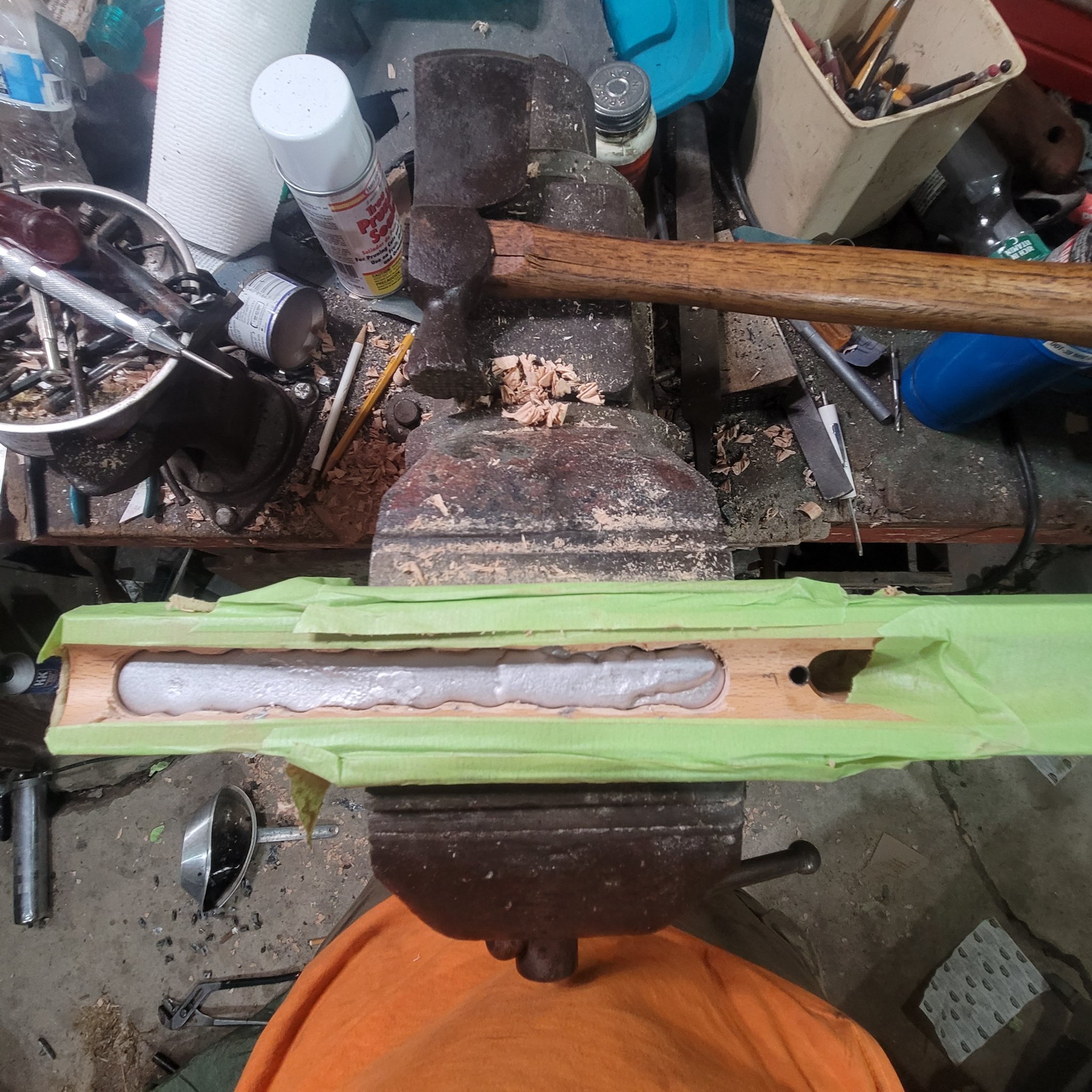

    This is what I did to a stock a while back, it turned out great. Not much tungsten powder was needed. I still have alot left from that jug.
    Reactions: akmike47

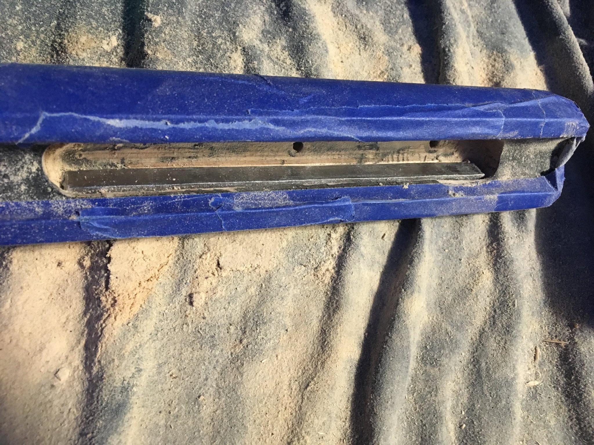

    I undercut into the sides of the forend and put about a pound of lead give or take. It'll need some in the butt I'm sure once the bipods on.
    I did find out my barrel doesn't free float in the front there's marks on the barrel....it shot great before so I'm wondering if I should screw with it. I know some guys let the barrel touch up front on these.

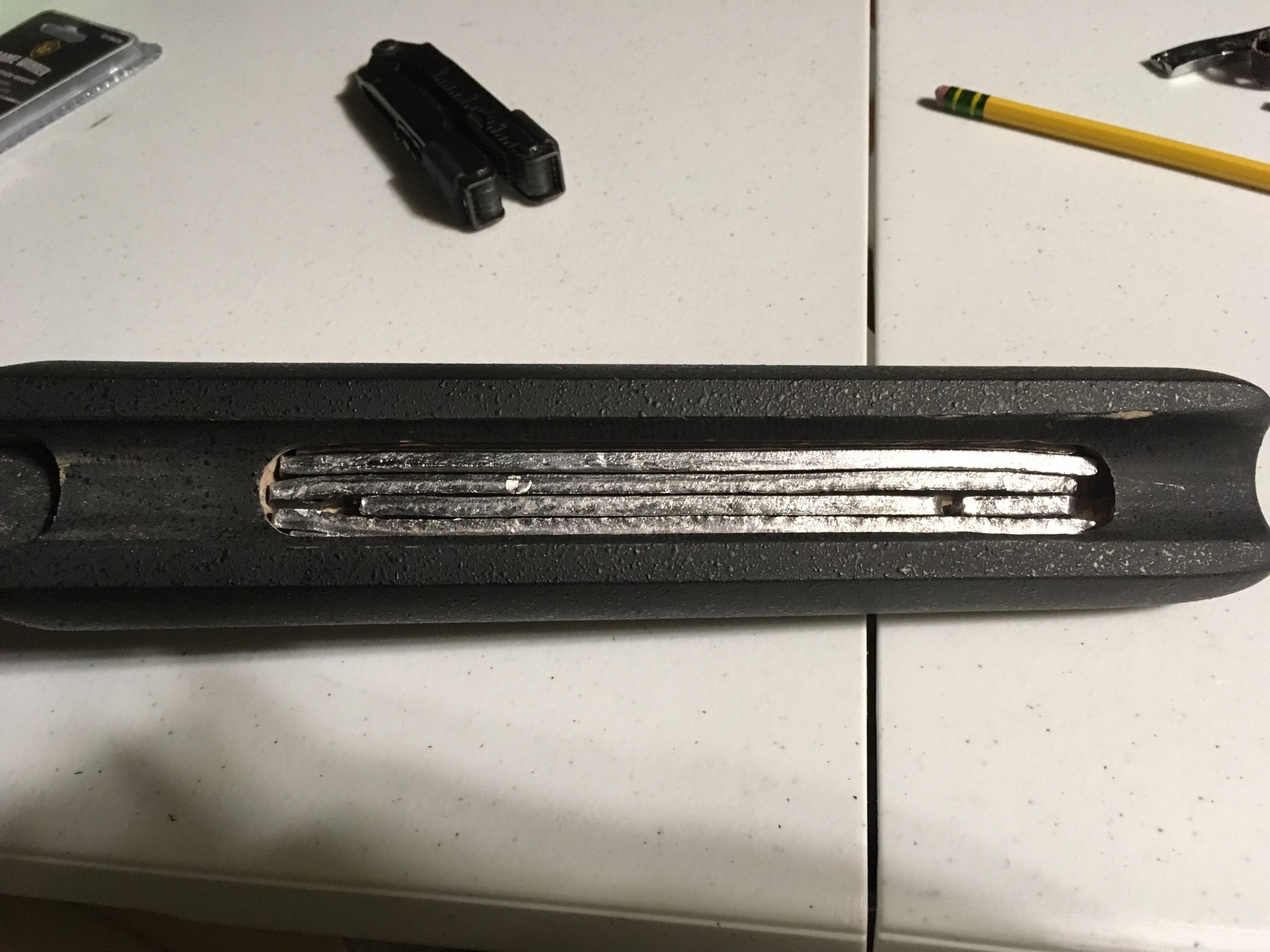

    Broke out the dremel, so you could say I'm a gunsmith...
    Would the regular old two part 30min epoxy be good enough to glue this, the shit in the syringe?
    You can fit more in there if you melt it in a pot and pour it in. Won't start the stock on fire.
    But that looks like it will work perfect for your needs. Yeah some 2 part epoxy would work well. Just remember your gonna have to sand it down. So don't get the super strength 9000 epoxy or you will be at it for a while. Ask me how I know... haha
    There's at least 1/8-3/16" gap between the top of the lead and the lowest point on the barrel channel so I shouldn't have to sand anything luckily. I bought the thinner straps so they would leave space.

    Only issue...
    Putting t-nuts under the weights hopefully they never strip.
    I may just lash the straps together with braided fishing line they fit pretty snug or CA some thin ply over them so it can be removed if needed
    Honestly some drops of thick CA would hold them in place its such a snug fit

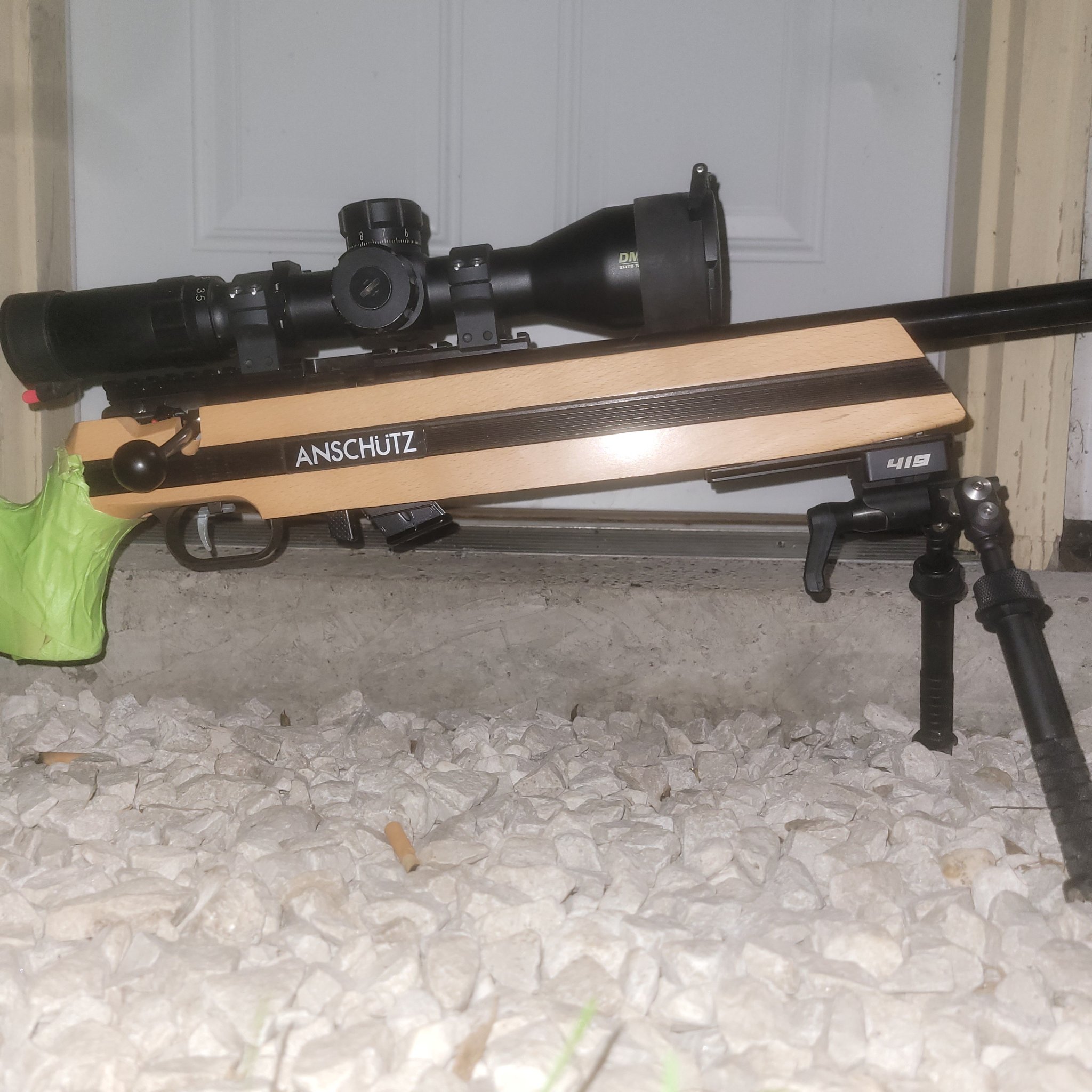

    Some Gel CA on the top seams of the lead worked great it’s not bonded to the stock at all, it’s a press fit in there and the outside two are pocketed into the wood. I even held the stock upside down and hit it on my hand a few times and it didn’t budge.
    Few gripes, Boyd’s didn’t drill the two sling stud holes in line perfectly so the rail is a little off to the side in the back but not a ton. I drilled the rear hole slightly over size to help a bit with that. Also I have to remove the rail to remove the action. The screw hole in the back is too small to fit a flathead, and I would have had to mount the rail too far forward if it was big enough.
    I’m leaving the wood spacer clear coated I think, I like the contrast of crap and higher end. I need to make another it’s still too short.

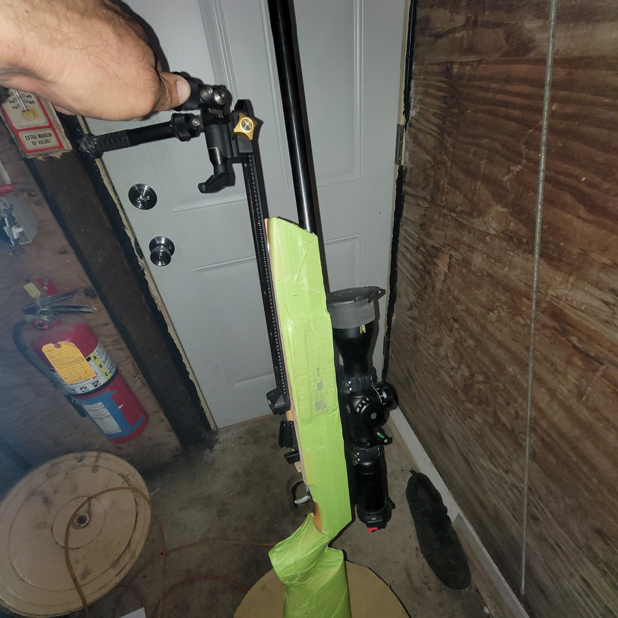

    Yeah I balanced my rifle on a narrow board. Then attach a plastic grocery bag to the side you need weight and add weight until it balances.
    Simple and effective, I like it.

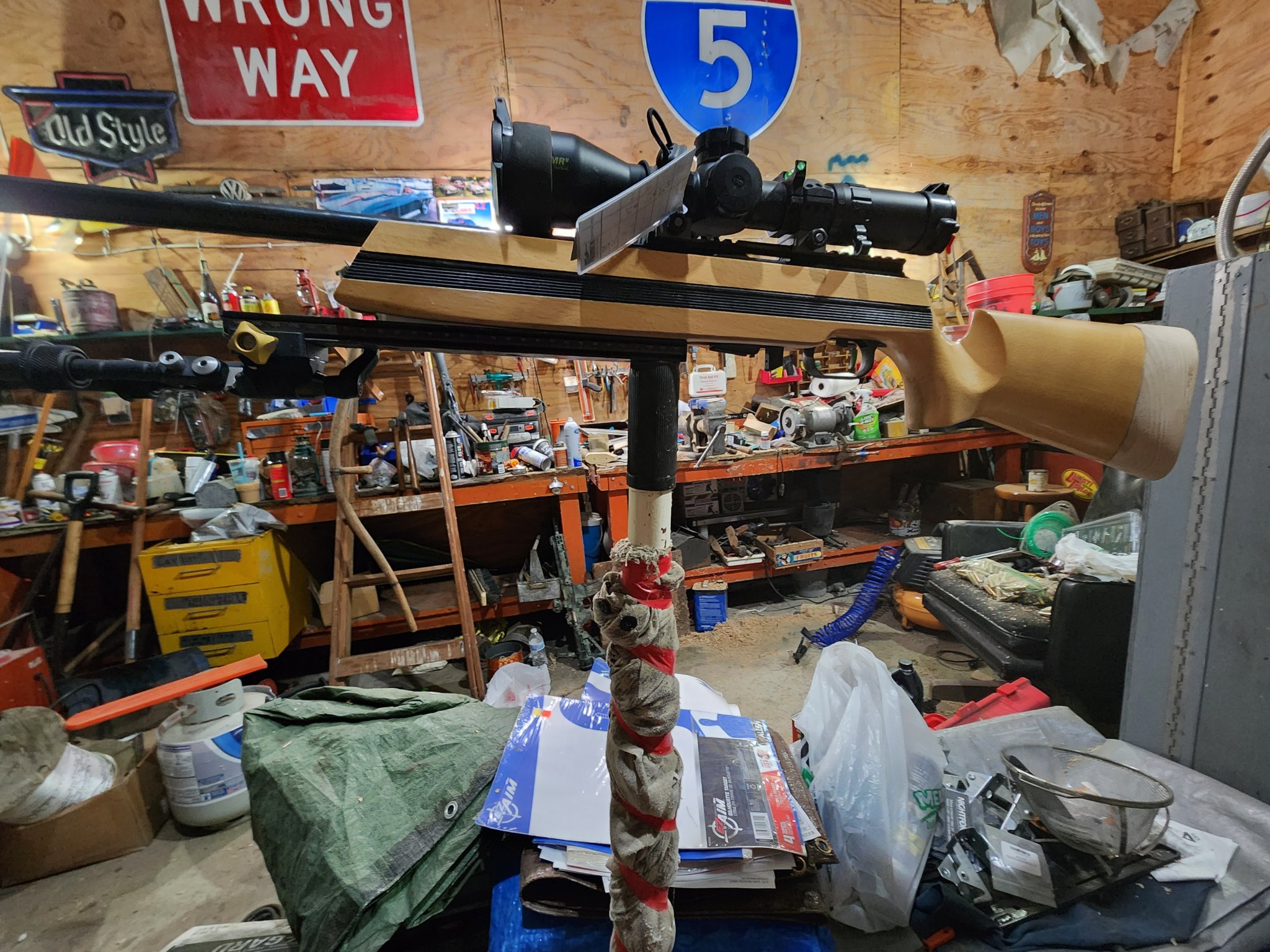

    Added more lead in the back side of the ARCA rail, probably up to 13-13.5 with bipod.

    Trick for adding weight in cavities.
    Buy some inexpensive food storage bags. Insert them into stock cavities, then partly fill them with Bismuth Powder/Nodules, which is nearly the same weight/density as lead, but is not toxic (I used it for ballast in Cub Scout Pinewood Derby cars, which prohibit toxic substance contents). If the cavity opens out within, it will lock the ballast in, so start with inserting a straight, untapered liner before inserting the bag, (find some fired shotgun hulls to use for this, remove the bases). Or not, if you want it solidly locked in.
    Remove the bag, add mixed epoxy - just enough to coat the nodules. Restuff bag into recess before it begins to cure, be sure it's taped/wired shut securely.
    Once cured; hopefully, it can still be removable, but...
    Hoping this helps.

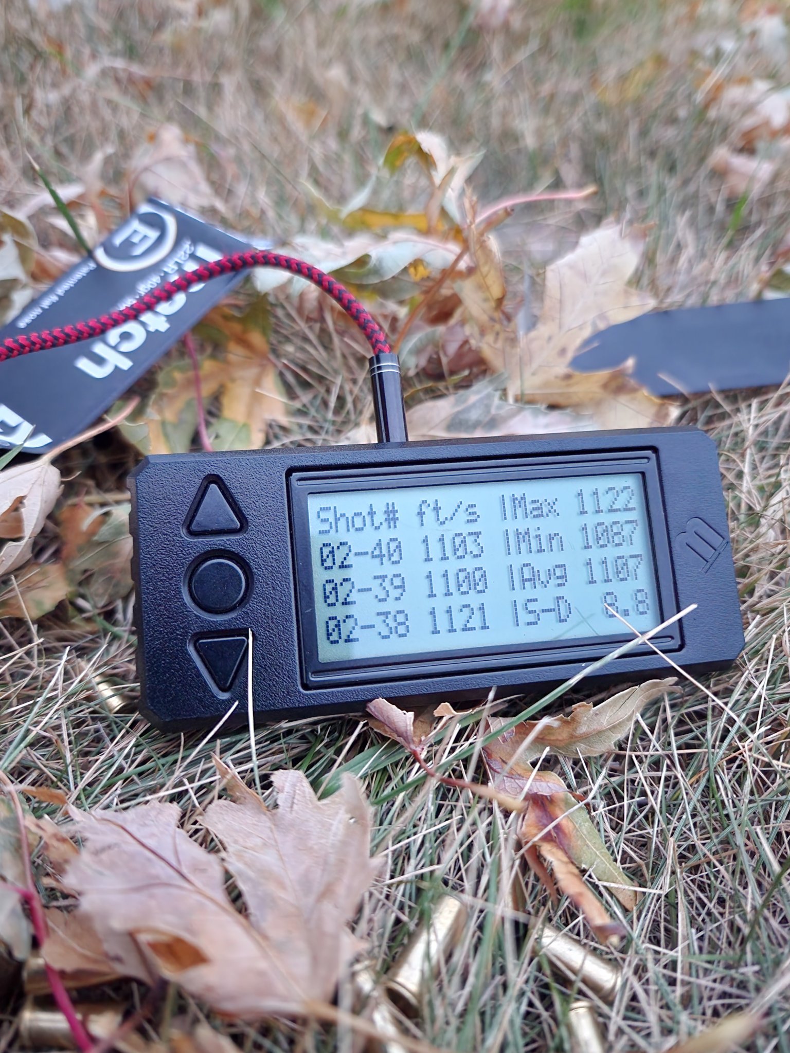

    Went to the range, shoots well and cycles subs. Couldn’t get down on my rifle so I was sort of hovering and still shooting 1/4” groups at 25 and .5-.9 at 50 with subs and supers.
    Not my best shooting by any means but haven’t shot in a year either on-top of the crap benches made for children apparently. I had a 3 shot .13” going at 50yd and my next two shots opened it to .91....fucking bulk ammo lol.
    Excuses excuses I know...lol but you’ve seen my .142 5 shot. I’d like to see what it does with match grade as well as it can shoot bulk when I get lucky and 5 round so are made similar enough.

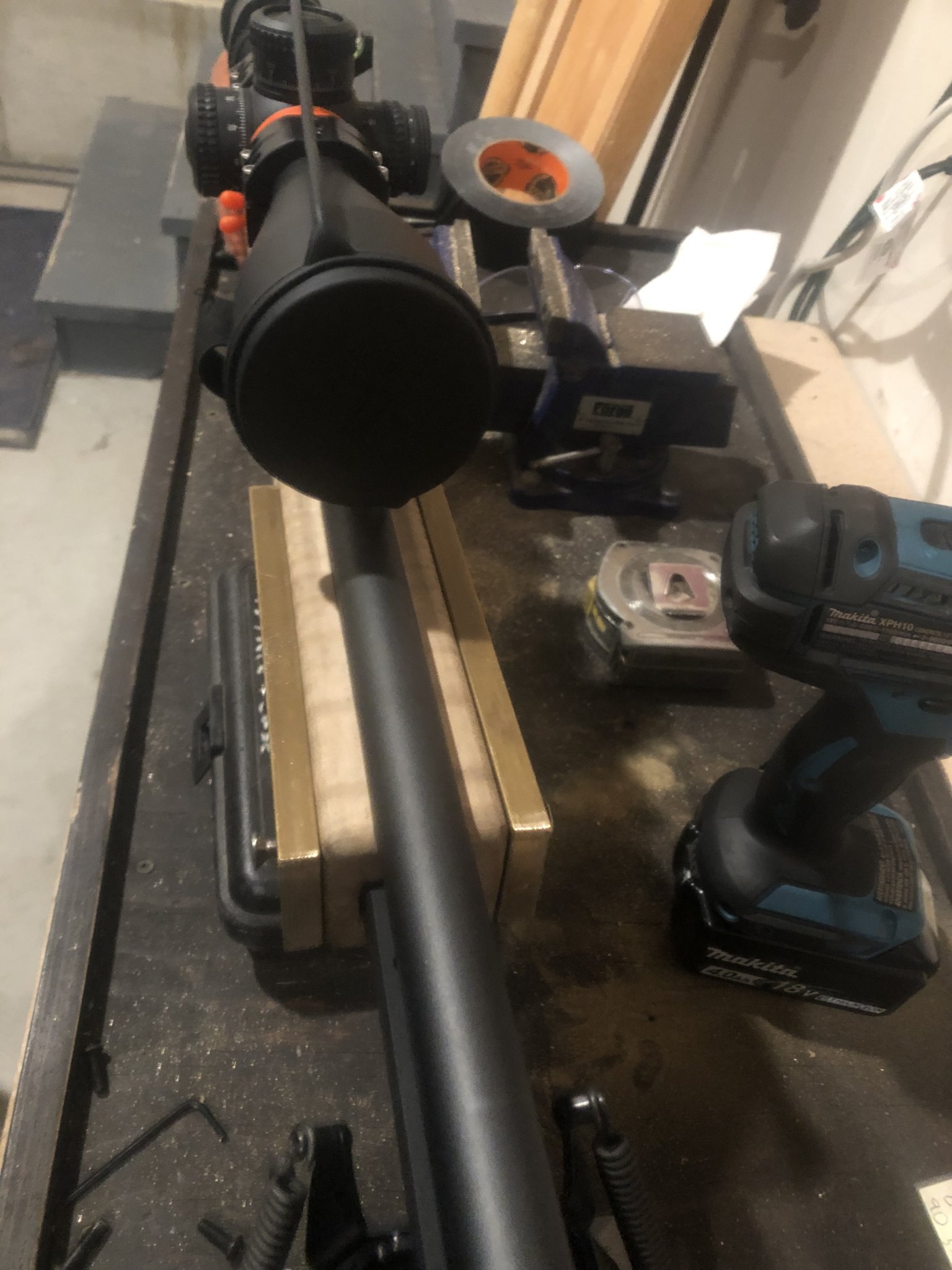

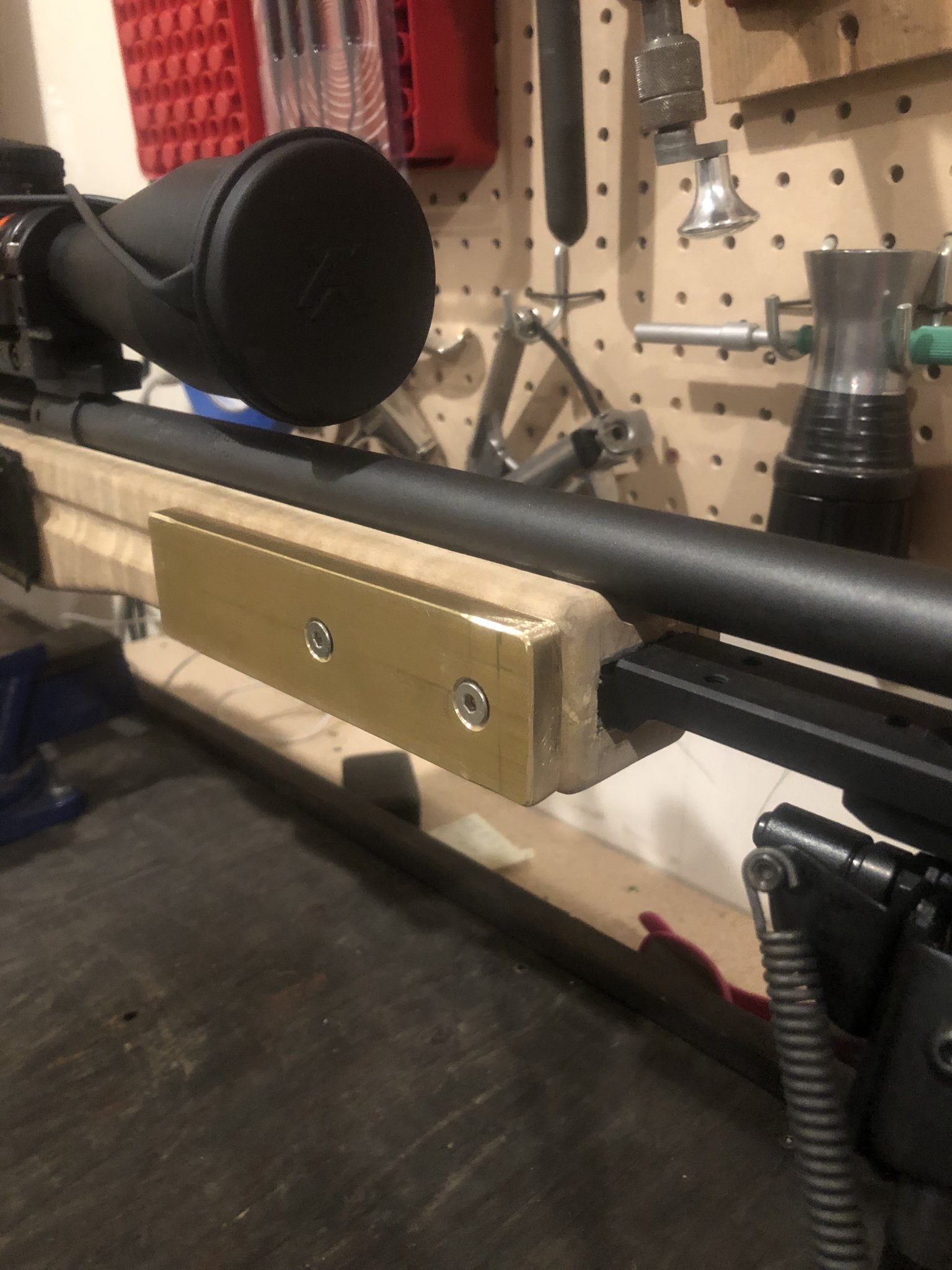

    Here was my solution: 1.5”x.385”x12” 385 brass stock from onlinematels.com $37. Cut it in half and each piece weighs exactly one pound. Little bit of finish work left to do but I did t want to literally sand off the weight. These are on a Rhineland Leopard stock that was pre drilled on each side for adding pic rails or whatever so I was able to bolt straight to the existing hardware. Rifle now weighs around 16lbs.
    Thought about this,but my stock is rounded on the sides and I’d rather remove material from inside than outside.

    I’ve got a Pro Varmint stock on the way for my 6.5 Grendel Predator. What rail did you order? It sounds like you used the sling studs to mount it. Do they hold it secure to the stock or did you have to “bed” it to the stock? Thanks.
    12” Area 419, wish I’d done the 14” weighted version . I used the front sling studs and added another blind nut towards the magwell. It’s solid I did sand a spot to the rear that had a rise to it but the rest was flat enough I rolled with it.
