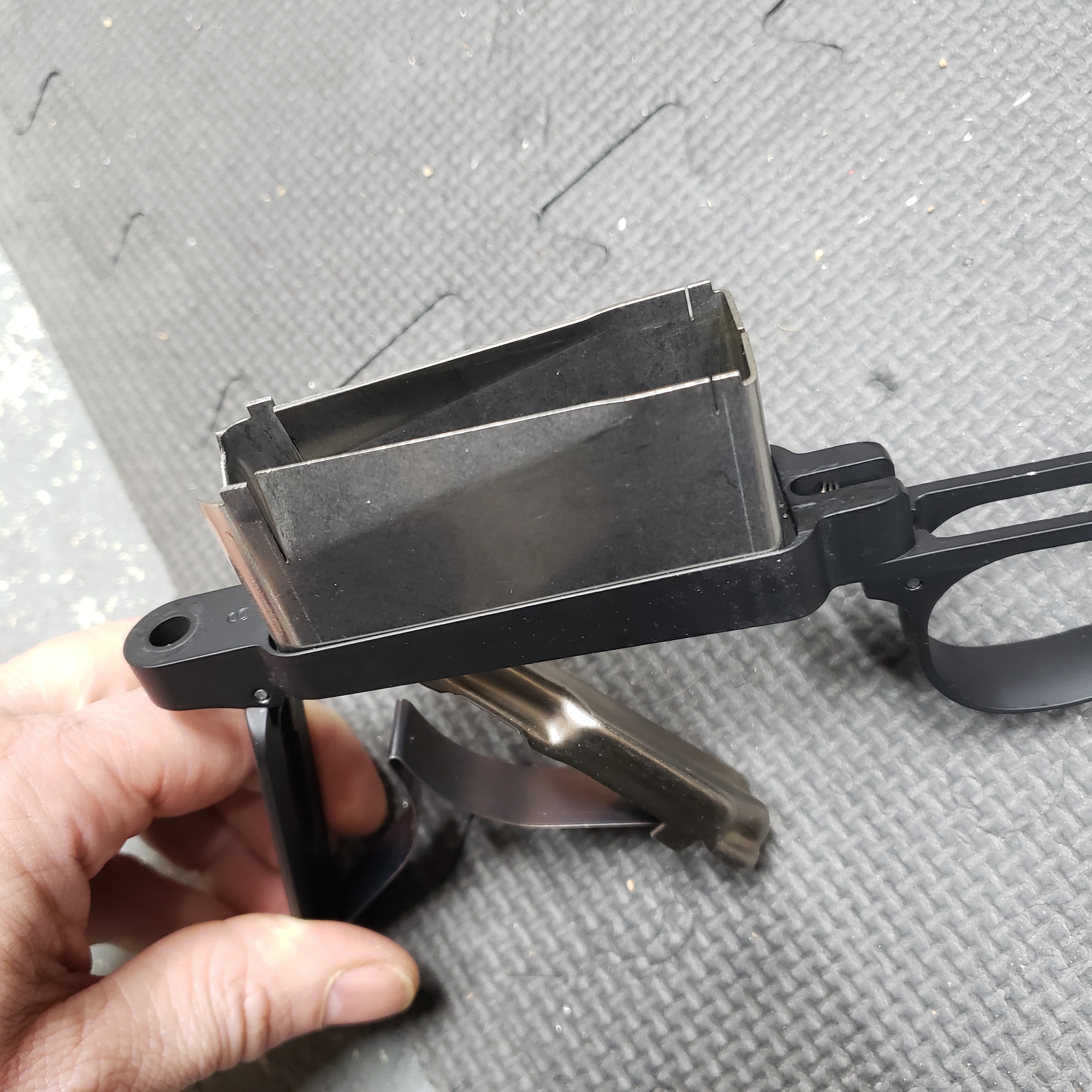

    Having an issue with feeding from two Rem 700's both in 6.5 Creed. They were perfect before getting pillar bedded. So now they both shoot fantastic, but dont feed worth a dam. They aways pass the hand feeding dummies test, but on the range is ALWAYS a whole other story; must be the recoil that does something.
    The only thing I could find was that after they were bedded, the blind magazine box kinda had some vertical play in it. Noticed that when I took the action out of the stock and bolted the bottom metal back up to it to see how it looked assembled. Noticed the action screws were now too long and would interfere with the bolt. I asked myself how could this be? If this is mated perfectly without the stock, how are the screws too long?
    Now I see - the assembled (in the stock) rifle is longer (taller) inside the stock than it is without. So then after it was all back together again and with the floor plate open, I could stick my hand in there and slide the mag box up and down about four millimeters. This to me didnt seem right but I was told by someone there was indeed supposed to be that play in there.

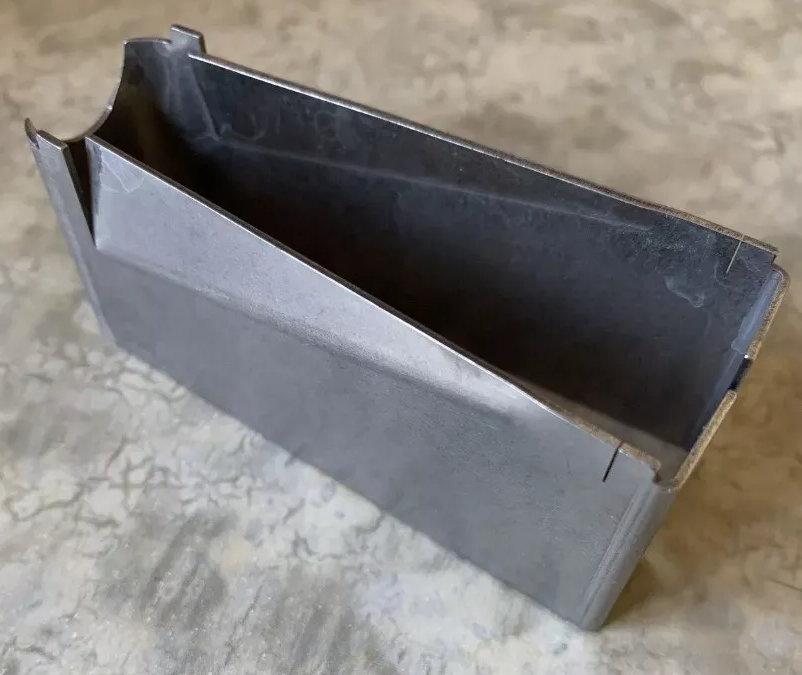

    While looking at the mag box, spring and follower design, I noticed the blued steel mag box was different than the stainless model I have. And they're both different than the ones you see on Ebay that have the little tab or eye on back of the box, where I think you can screw this box down to the action.
    1. This box that can be screwed down to the action; it seems older. Is it? Was this discontinued? What was it for originally?
    2. My stainless mag box has what appear to be laser cuts in it, and the folds to act like feed lips are more aggressive (closer) Why did the design change? Or was one meant for the 308 and the other a 6.5 creed? I dont know. Was it just a product improvement/change proposal over the years?

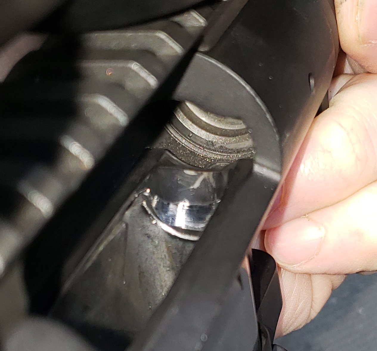

    The FtF is the bolt pushes the bullet tip into the ONLY flat section of the bottom of the feed ramp that exists lol. Of course it would find that 2mm section.
    If the feed lips are the bottom of the action (which I kind of thought myself as well) then these bends in the sides of the mag boxes are a tad too wide. The follower hangs up on these 'lips' if you will but ever so slightly. I wonder if that's supposed to be that way?

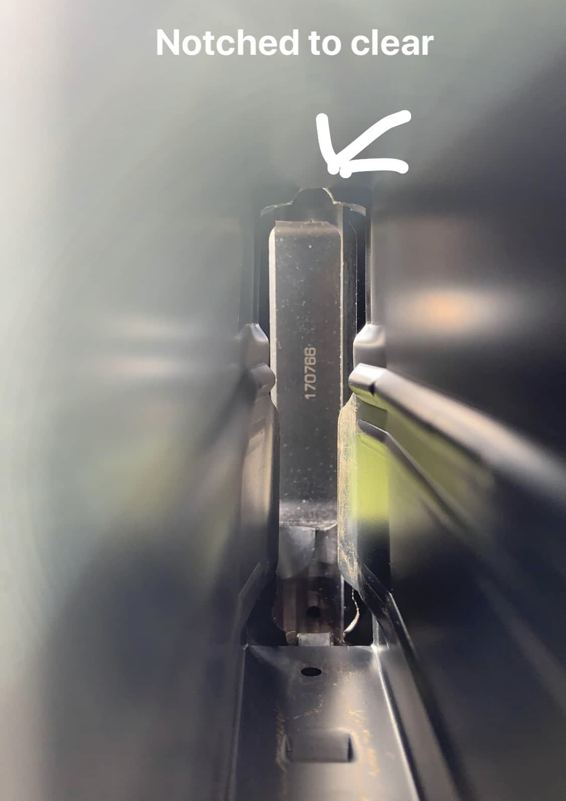

    The bullet under the feed ramp is common. A dremel grinding wheel gets rid of that overhang. This is looking up through an empty aics magazine showing where the interference was relieved .

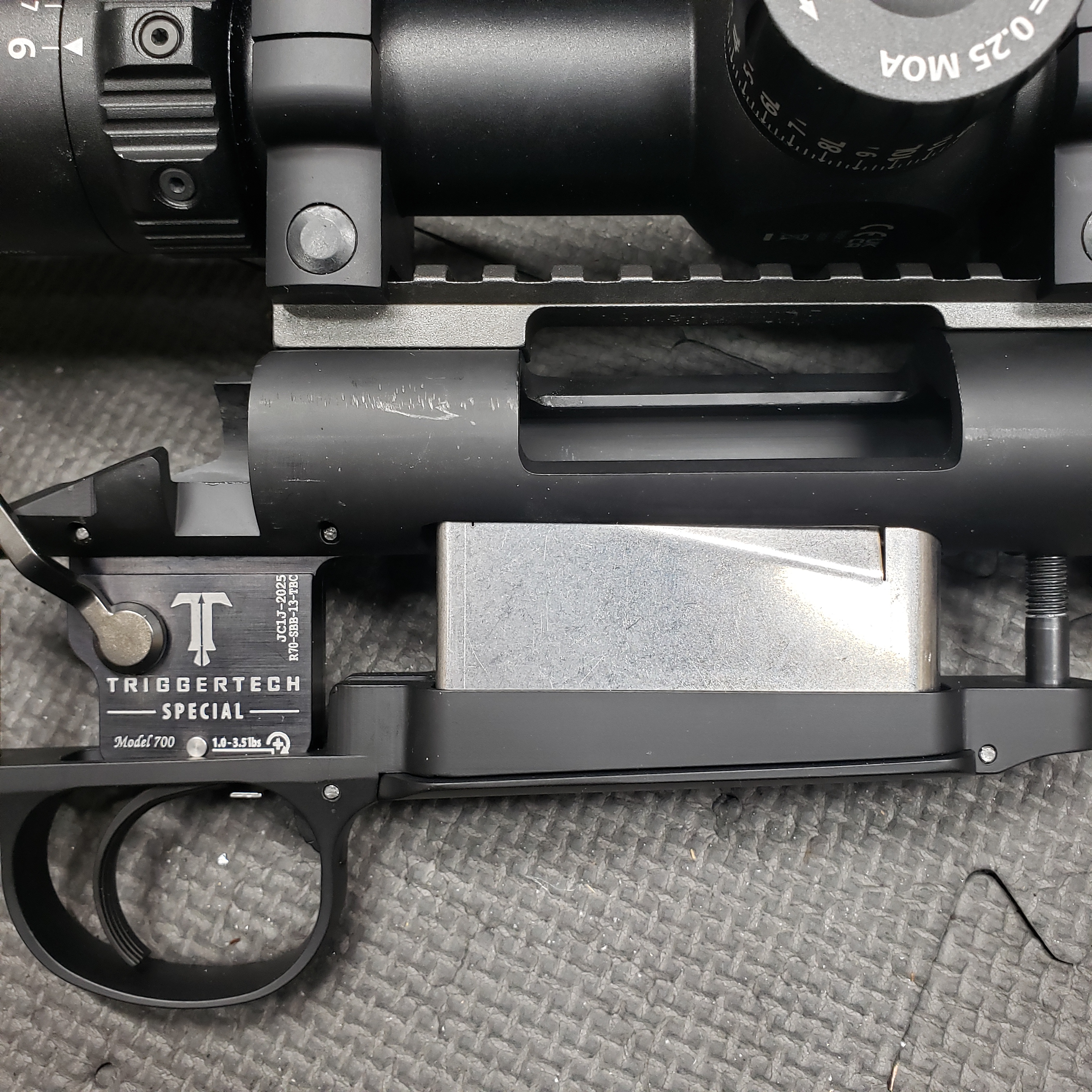

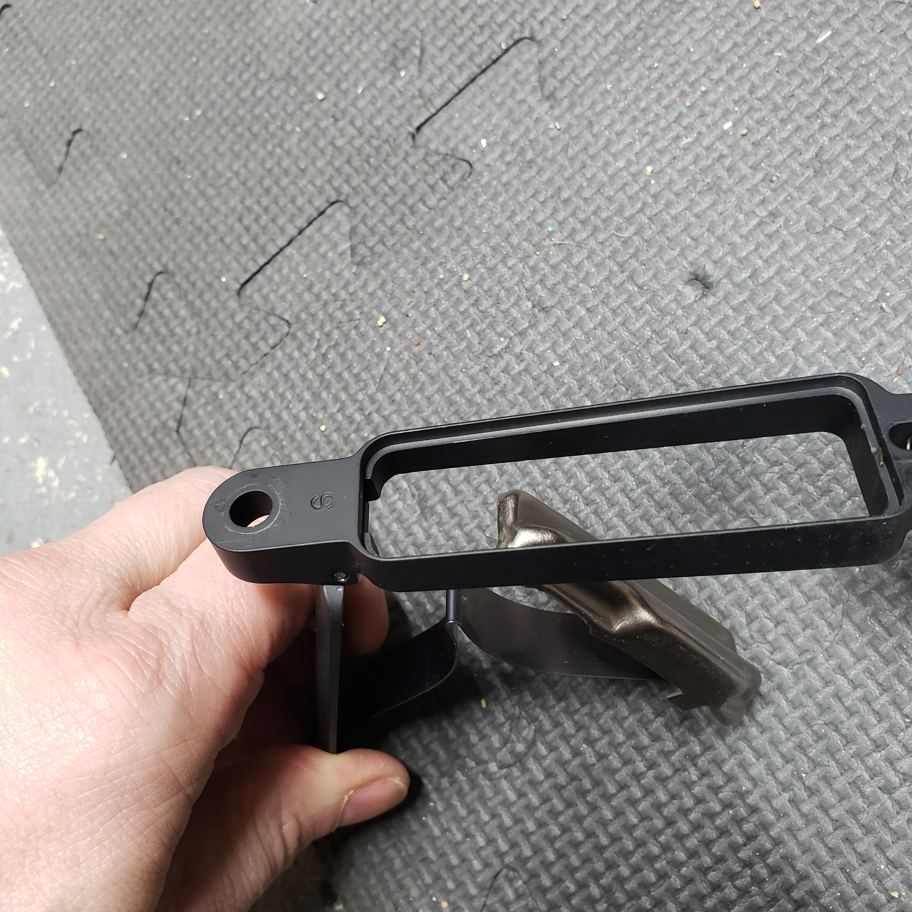

    Ok, first pic, of the bottom metal. See that little groove around the perimeter of the bottom metal. To me, that HAS to be for the mag box to sit in. I know there's supposed to be 'play', but mine doesnt sit in there. Rather, it floats around. The picture of the whole assy assembled, is how I envision it was designed to fit together. While not super tight, at least mated. The pictures of the two chambers are my options when shooting. Due to the mag box float, sometimes that semi circular cutout is right up against the bottom of the feed ramp, and sometimes it's about 3 or so mm's below it, as you can see between the pictures.

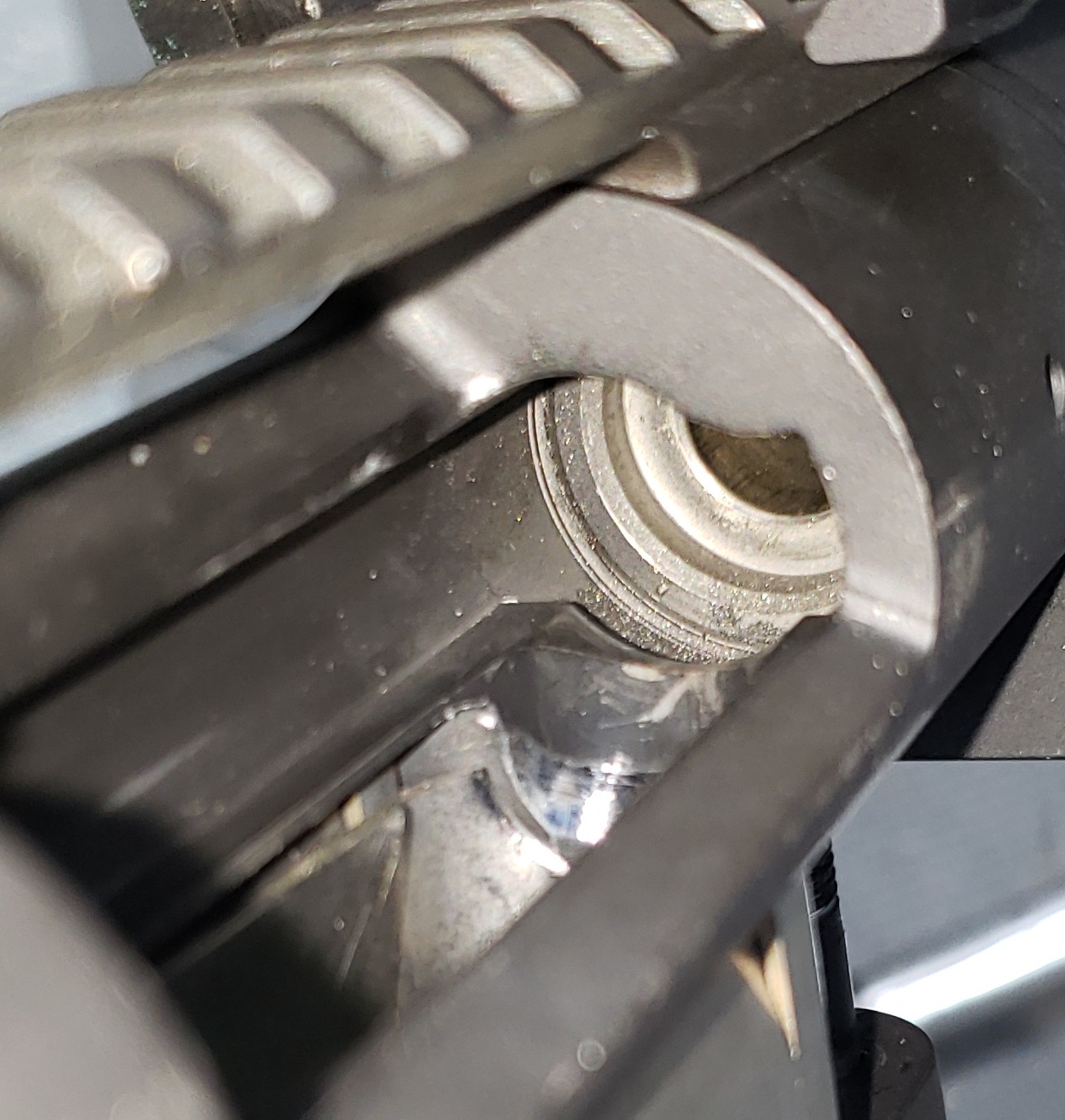

    At first, I thought it was that semi circular cutout by the mouth of the mag box that was somehow interfering but now I dont think so after reading some articles. I think it's that bent area (or crease) you see right behind the semicircular cutout. You can see it on the side of the mag box in the assembled picture. They kind of kick the round out torward the center of the feed ramp a little bit, and when this mag box is too low, that crease cant do it's job and the round stays indexed all the way to the right side of the mag box, and when the bolt goes forward stripping a round from the mag, it pushes it directly into the side of the feed ramp instead of more torwards the center.
    Now, I've ground down my feed ramp a little yesterday to see if that will help the problem, but now I see that it was probably the floating mag box all along.
