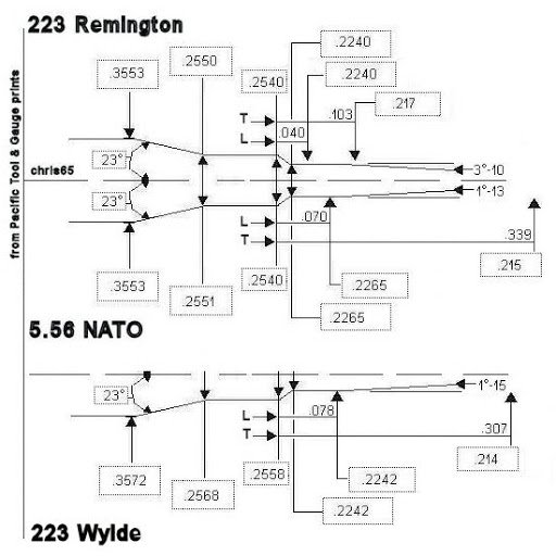

Ordering a .223 barrel soon for a build to launch some heavy 22 bullets. Is there any benefit to having a wylde chamber rather than a standard 223 on a bolt gun?
Wylde for heavier (75+ grains) bullets loaded long - and 1:7 - 1:7.5 twist.

A Wylde barrel can shoot .223 and 5.56. Other barrels will only be able to shoot one or the other.
Incorrect. I, and several other knowledgeable riflemen I know, shot factory 5.56x45 mk262 77s out of our long-throated (for a standard .223 chamber) rifles for years - understanding the caveat that a standard .223 chamber would cause dangerous pressure spikes.
But there is absolutely no problem shooting .223 Rem in a 5.56mm NATO rifle. Here's the SAAMI FAQ on it.
Well... my .223 with a regular .223 barrel shot the same groups with the same ammo as my friends snaz-nuts .223 Wylde barreled rifle.
That is until I put anything more than 70 gr. through it. But that's more of twist rate kabob than anything.
What's the root of the question here? Is the Wylde barrel more expensive? The Wylde chambering is effectively the best of the 5.56 and 223 smooshed together into a wonderous mix of potential. So... just get it and move on with life. Ideally in stainless, because that's cool.
You are absolutely correct. You can shoot a .223 out of a rifle chambered in 5.56. Shooting a 5.56 in a .223 chamber will create a high pressure situation. Do I understand correctly?
Reactions: DownhillFromHere
May - depends on projectile and loading. Its all about the throat.
Sounds like the wylde is the way to go then for loading long. Appreciate the info.
The Wylde or longer. If you google search there have been some pretty good discussions here on 223 throating for different bullets. I had a Wylde chamber cut for mine. It put the 75 a man about .02 off the lands @ 2.47 OAL. My AI 223 mags will hold 2.52 or a little more. I know some people said they liked their freebore closer to .100 for the 80g+ stuff.
