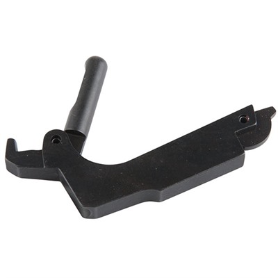

MK III locked up when I tried to pull the main/hammer spring (part you unlock on back of grip and pull out to remove bolt & upper). Instead of searching for a solution I absentmindedly knocked the pin out of the housing and disassembled it. Problem now is getting it back together so real question is has anyone ever reassembled one? Found a few references to a tool/jig Brownells used to sell but looks like long discontinued.
I've looked for videos. Problem is getting the spring/ball bearing compressed into the housing so the lever can be positioned and pin inserted.
And I know I can buy a new mainspring or Volquartsen replacement but this is from a cerakoted Amphibian so I'd like to get the original back together. Should have thought about it before I did it but I didn't.

Couple videos on fixing the locked mainspring issue and getting it out but couldn't find anything on putting a disassembled unit back together. Just to be sure, this is what I'm talking about. There's a plunger, heavy spring & ball bearing inside.
Jig Brownells used to sell.

They are a pain. I use a puch the size of the pin with a rounded tip to help out. I get the spring and ball in with a punch holding it in place.
Put the housing in a padded vise and pull the punch out a little bit while pushing the lever into place. Use the punch to align the lever and lock it in place. Last step is working the pin in from the other side without launching anything into your eye ball. It is a pain, as stated. Expect parts to fly before you get it to work.

Thanks, I understand the concept but it's the "get the spring and ball in" part I'm having problems with. I did find something that talked about doing it inside a plastic bag to capture flying parts but not sure how workable that actually is. Also saw suggestion to drill small hole in housing for pin to capture spring/ball then drive out when lever installed. That could be a last resort but still requires getting the "spring and ball" in. I'll get it eventually but just wish the jig was still available.
You can use a smaller roll pin starter punch to compress the spring with the ball on top. The cupped end makes it less likely for the ball to fly off into oblivion. Then you push the punch out of the way with the lever, and have to hold it compressed long enough to start the pin or a different punch through the hole.
