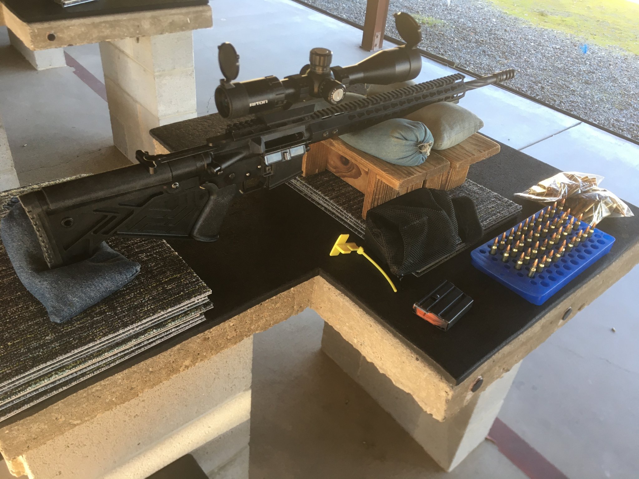

Been trying to get a 1:* 20" stainless 223 wylde barrel from BCA to shoot. It seems to be quite a fussy pipe, and so far it surprisingly seems to favor the lighter projectiles over the 68-77 ones i tried.
About 150 rounds in, nothing weird seen when i borescoped it, all installed right, decent glass, but struggling to get it under 2 moa.
Perhaps some of you have found the magic combo for yours, and if so i would like to know so i can try that load in this barrel :)

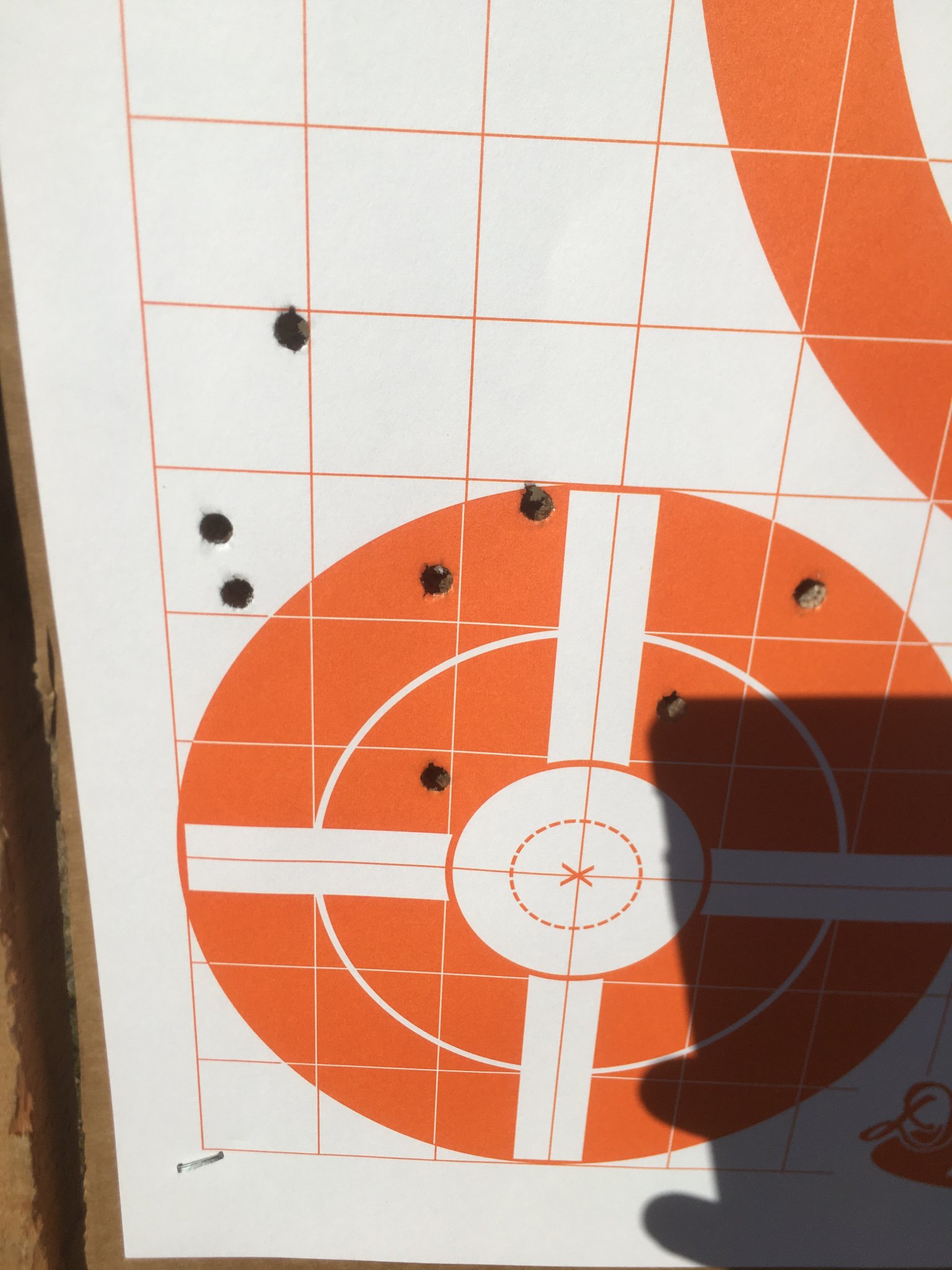

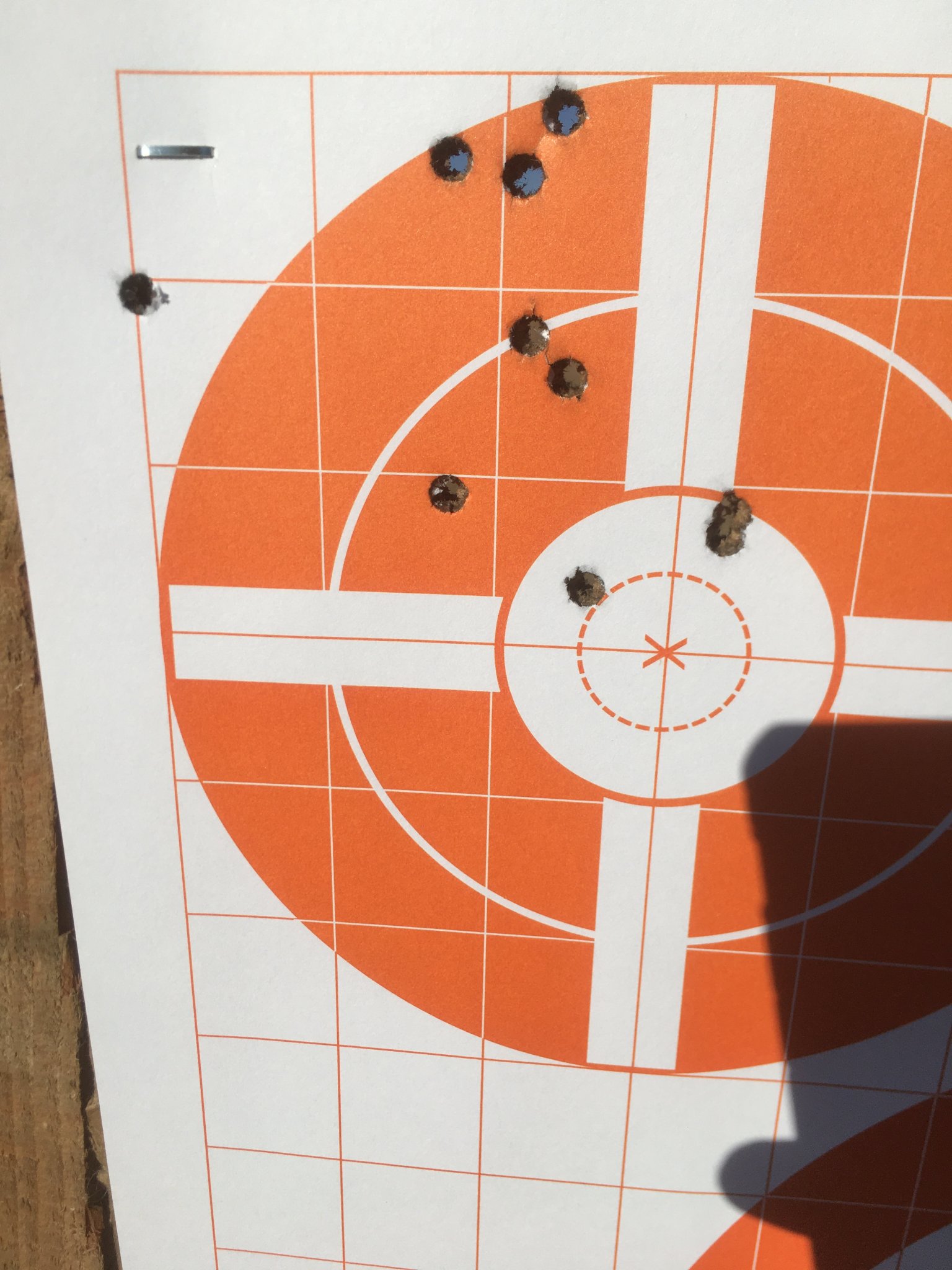

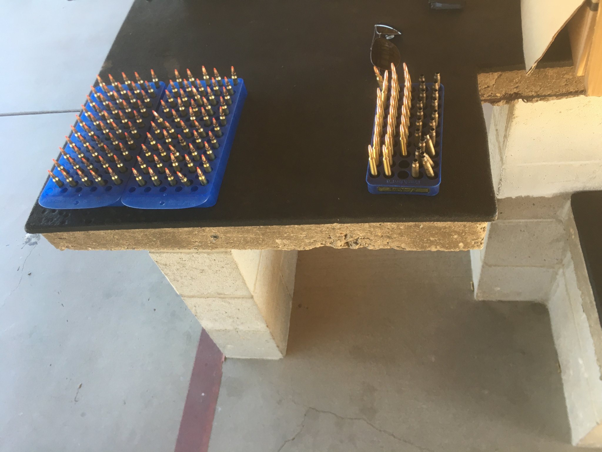

See emails below and attached pics. Tried again today. I give up. 2 moa at the very best.
Norma brass, tac, h335, cfe223, cci mag primer, non mag primer, remington br primer, s&b primer, hornady vmax 50,53,55,68, sierra 55, 60, 69, nosler 69 and 77, different oal's, scopes, you name it.
Sent email 6 days ago, zero input.
Thanks, Vincent
Your groups look alot like my groups with a bca barrel. I think mine is a 5.56 chamber 1:9.
Best I’ve done is 1.4 moa with 55gr nosler varmageddon and 26.7gr of cfe-223.
SD was terrible though. And it has been for every load I’ve tried.
