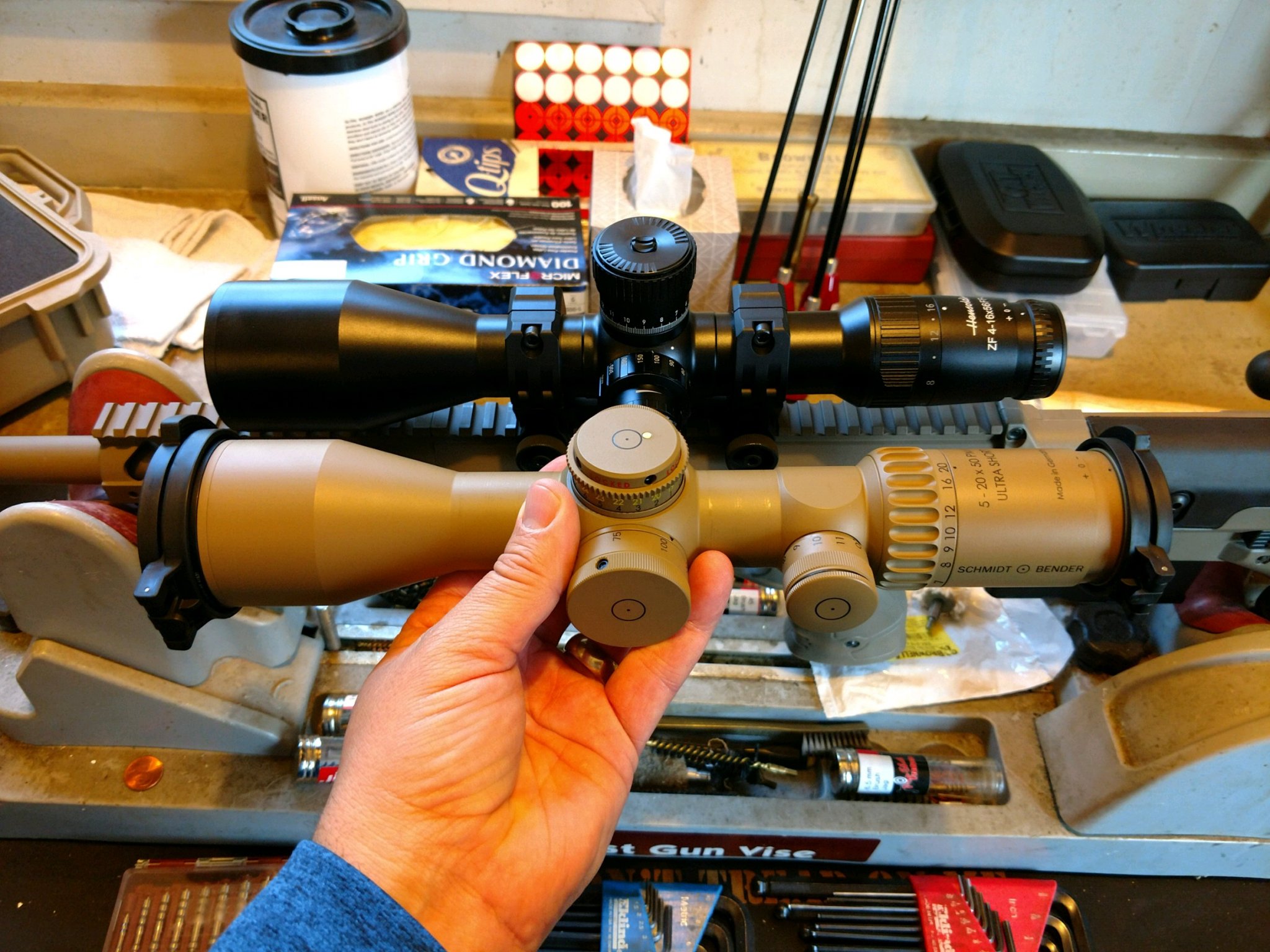

    Prior to the S&B Ultra Short’s introduction I used S&B 4-16x42 on most all of my LR VARMINT and target rifles. Loved them. Now all switched to ultra shorts.
    I seldom shoot beyond 800 m. Most of my shots are 200-600 m due to terrain where I hunt.

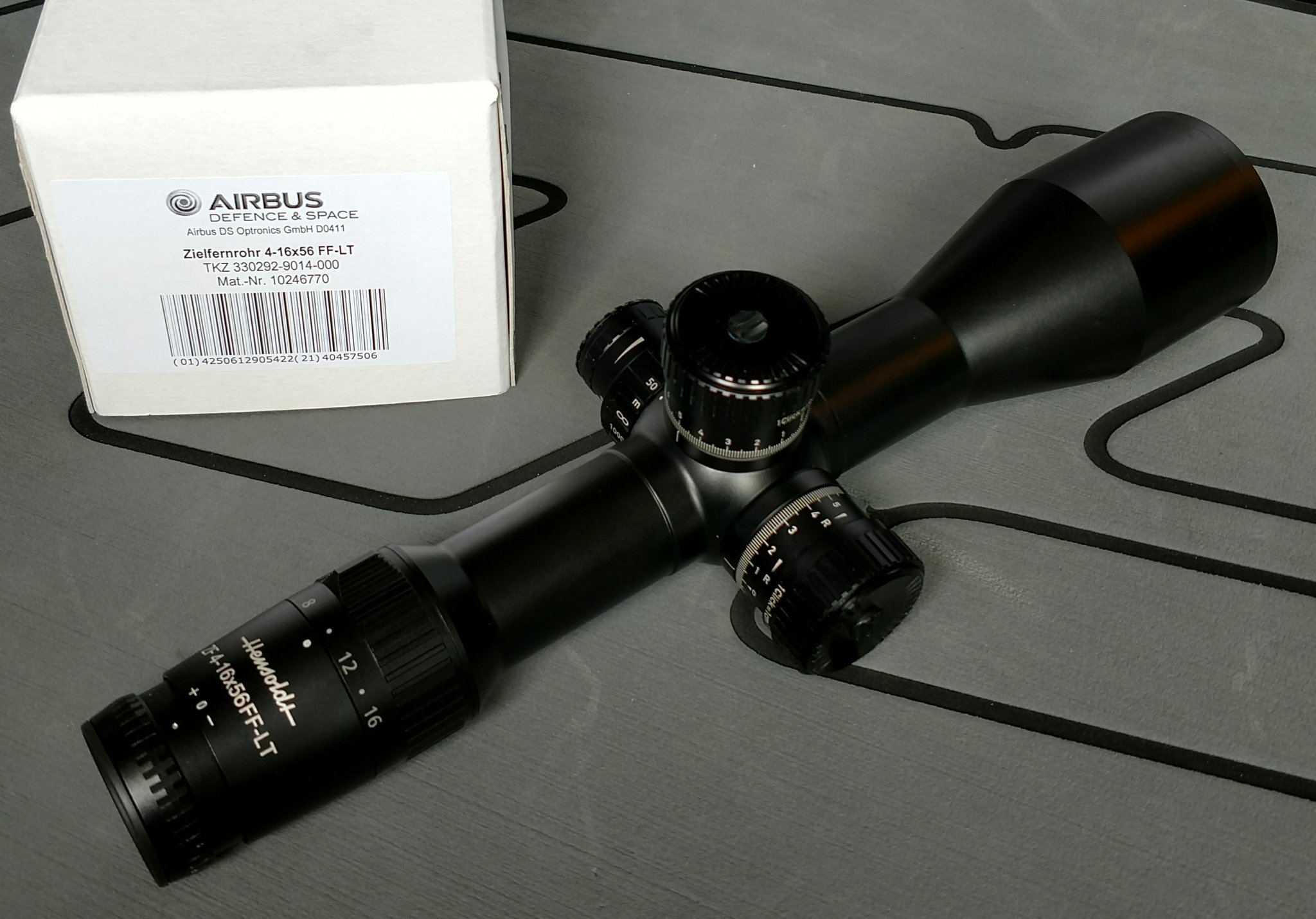

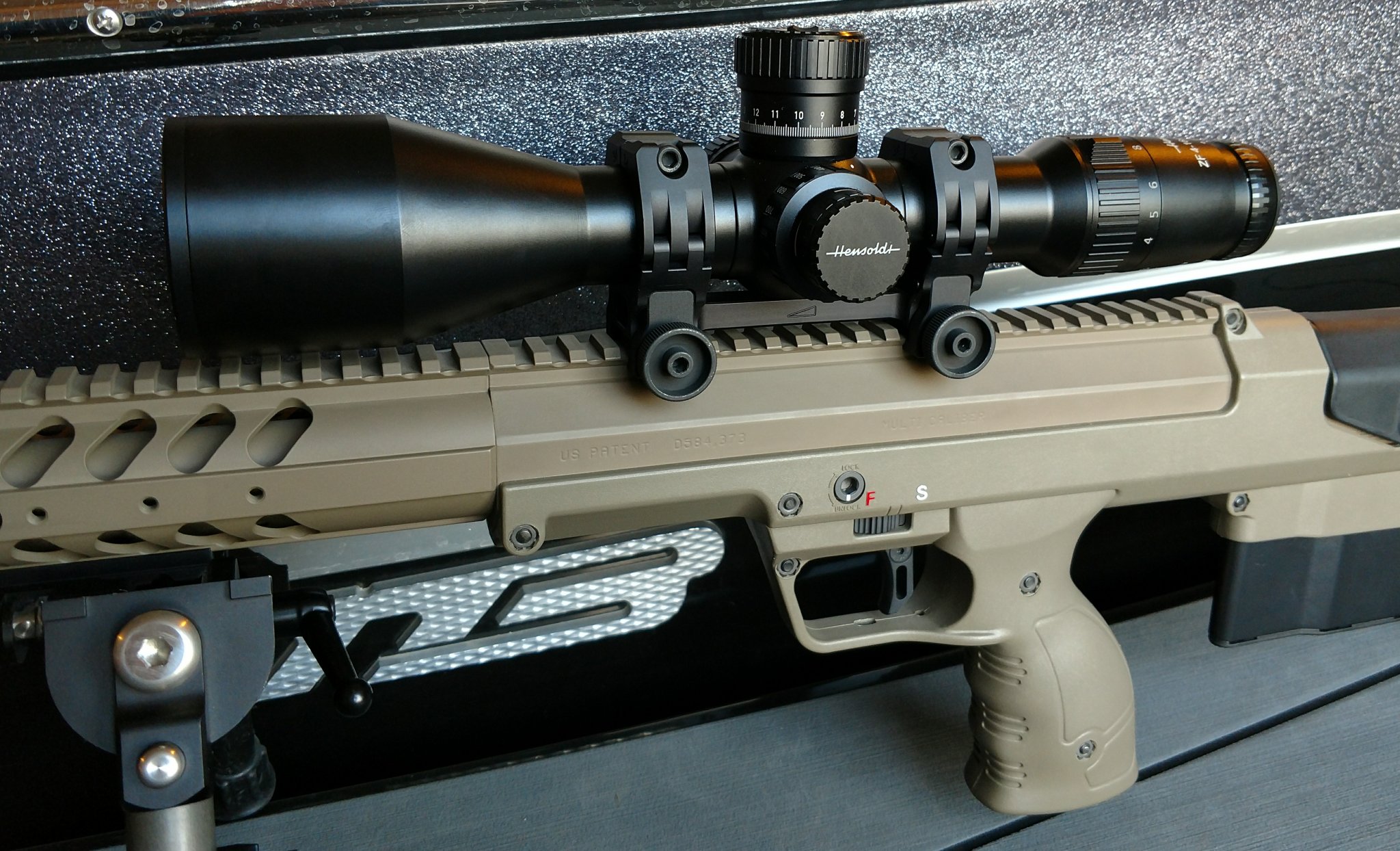

    For me the Hensoldt 4-16X56 LT in H59 is the best all around scope out there. Superior glass, top notch illumination system, unreal eyebox, perfect tracking with very positive clicks, light weight, amazing low light performance and exceptional fit/finish. I’ve owned & used many high end optics and I’ve found that this scope/power range is everything I need.
    Reactions: BallisticPrimate
    I just picked up a couple of these. I have never seen such a good deal on a Hensoldt as this. When I ordered mine last week, they still had 18 left.
