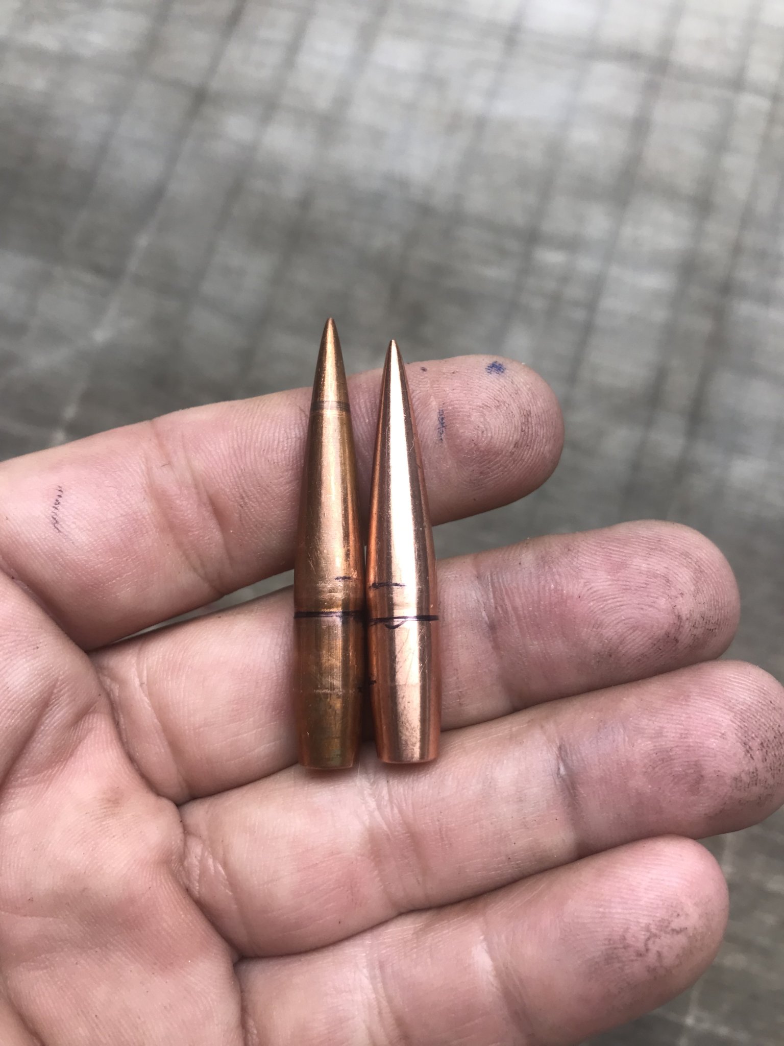

    The Berger has a base to Ogive length of .945" and Flat lines are .540".
    If I throat it for the Berger's the solids will be jumping .425 and if i throat it for the Solids then the Bergers would be stuffed all the way into the cases.

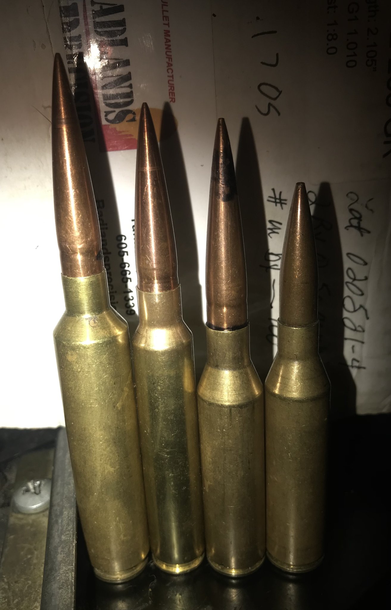

    Norma with that long throat is a kinda a pain with solids.
    Either solids are perfect and cup core is really deep eating case capacity or you have perfect placement for the Berger and barely any neck grip on solids especially if you have cute Sloan reamer.
    A freebore of about .150-.165 might be a decent compromise
    This 338 Norma is a 285 badlands.

    Normally what you want if you plan on shooting solid especially Warner or Badlands. let Dave at ptg understands that you want to touch the the first stage of the bore Rider with Berger bullets very close to the case mouth. Having a very short lead this will allow you to use aggressive solids. My suggestion is to seat a variety of bullets in a case and use a AOL comparator to find a happy medium between solids and jacketed bullets and give that measurement to Dave at ptg and tell him you want to touch the 0 curve at that measurement

    Thanks for your input SH! I looked on badlands website and couldn't find any dims. Can you tell me the overall length and base to ogive length are?
