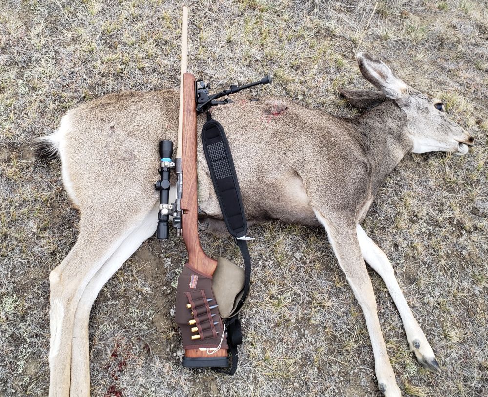

In September I built rifles and in October I went hunting.
260 Remington throated out to 3.1" AOL, very light rifle shoots 1/2 moa

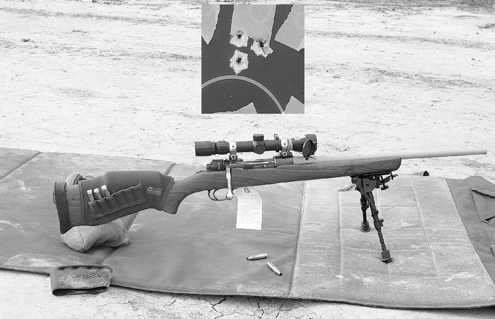

1903 Turkish Mauser in 260 with Bartlein barrel I shortened both ends and retapered.
