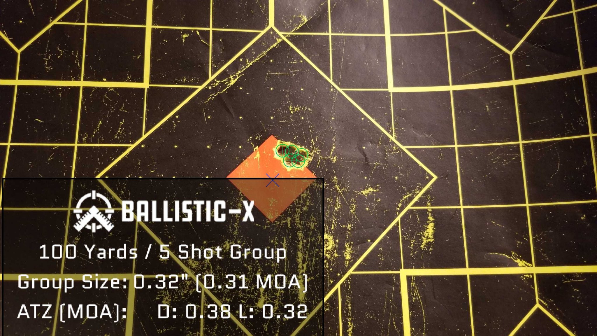

I just got this data yesterday . Lapua case FGMM primers 24.4 varget set to 015 off the lands 2860fps. So that is what is working for me. Mileage may very. :sneaky:

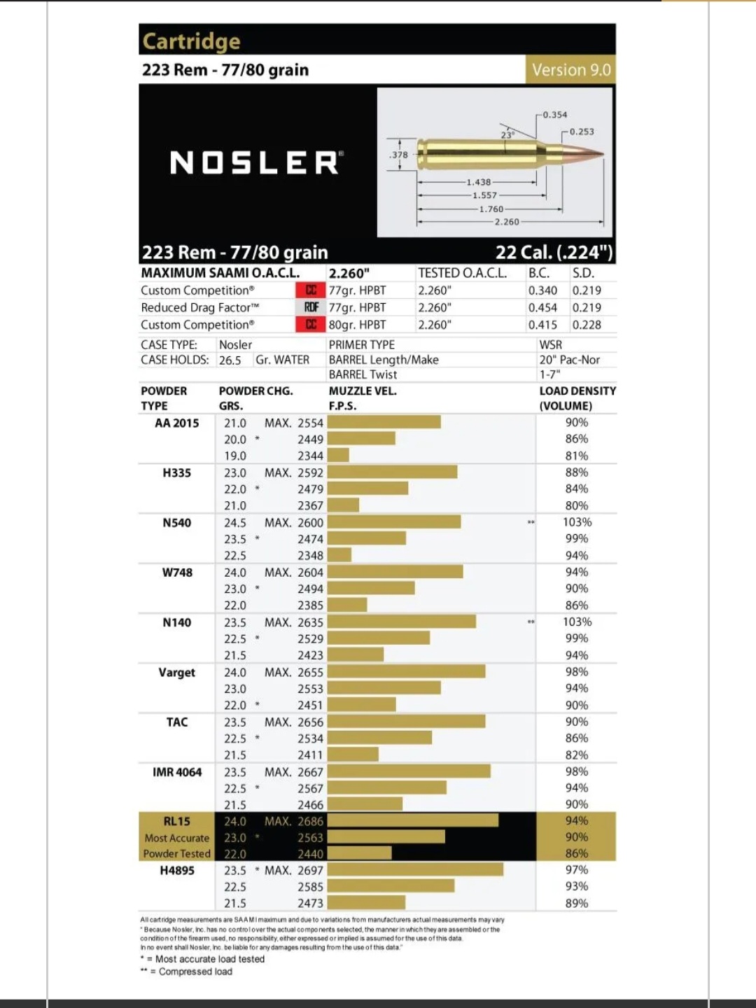

Began load development using the 80gr ELD out of my AR15 26" WOA with 1/8 twist and WOA's custom varmint chamber. Using Ramshot TAC with 5.56 data rather than 223 and CCI450. Started at 21.9 grs and .020" off lands or 2.410" produced 1/4 inch group at 200 yards. Hand fed each round.
Working up the charge results were not near as good until I got within 1 gr of max for 5.56 and groups shrank to all touching same hole.
Don't have velocity and SD numbers yet but will retest the loads near max and see if things change.
Plan to try RL15 after retesting best loads with TAC.
