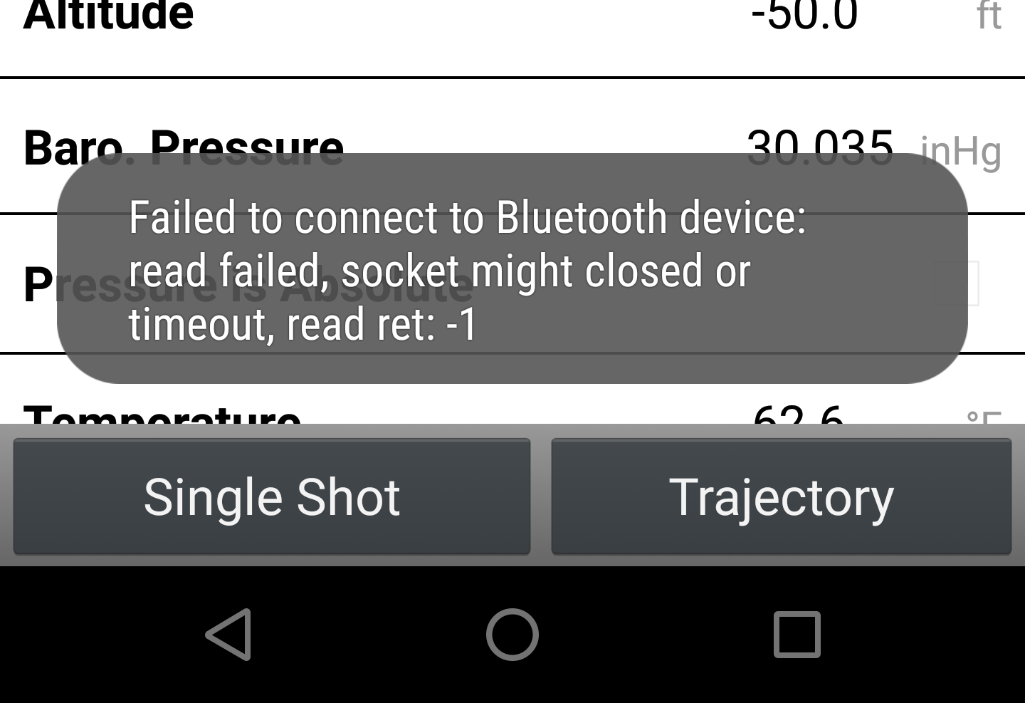

If anyone has cracked the code on how get AB (android) to reliably pull atmo info from the K5700 AB Elite, fill me in.
I have completed the hop on one foot, point at moon, change batteries, hard reset, firmware update routine...to no avail.
Thanks.
Mobile Device=MotoZ2
Android OS=8.0.0
Kestrel Link Ballistics=Build 123
Applied Ballistics Version=2.1.2
Kestrel 5700AB Elite w/Link=FW 1.18 Boot 1.01
P.S. I've done a fairly thorough study of the references listed below....but if there's a nugget I missed, I'm all ears.

Ok it's working...just like during load development...I'll see if i can put 5 in the same hole tomorrow and call this the Answer :)
1. Ensure all other BT devices are turned off in surrounding area.
2. Brand spanking new LITHIUM AA in the K5700. I had put a new alkaline in, but on power up it would say 3% ? Repeated with a new alkaline out of the wrapper, same result? I put a full charged Eneloop in there..it would say 38%? OK, fine ...you win, new Lithium it says 98% when powered on.
3. Reboot phone.
4. Open up and get the Kestrel Link Ballistics app connected.....when you power up the app, you should see a flash message saying connecting to Elite 123456, and then the Updated Kestrel Latitude menu should appear. If it hasn't you need to go through the Kestrel Link connection steps to select your Kestrel. If you get stuck here, ensure all other BT devices that may be causing conflict, are turned off (iPads, other mobile devices, etc), and all other apps that may be trying to connect to the K5700 are closed out and not running in the background. My response after discovering another BT gem that was still on, was another reboot of the phone.
5. Power up AB. Under the Environment screen->upper right->Acquire Atmosphere->Kestrel. If you don't see Kestrel here, go back to step 4 and get it connected via Kestrel Link Ballistics.
6. Acquire the Target Heading
7. Tap Single Shot
8. Under the HUD screen->upper right->Start Kestrel Atmosphere. If you don't see Kestrel here, go back to step 4 and get it connected via Kestrel Link Ballistics.
It's working for me this way. Not certain this is the prescrided NK/AB method or steps for a Droid 8.0.0 and a AB K5700E to communicate atmo to the AB app.
BTW...4DOF will pull data from the K5700E too....just need to ensure the K5700E is connected to Kestrel Link Ballistics first. And with mine it doesn't seem to matter if its in Ballistics, Weather, or Easy mode...it worked regardless.
And if this elementary stuff widely known, then great! I'm caught up with everyone else on now, maybe it'll help catch someone else up on it too.
