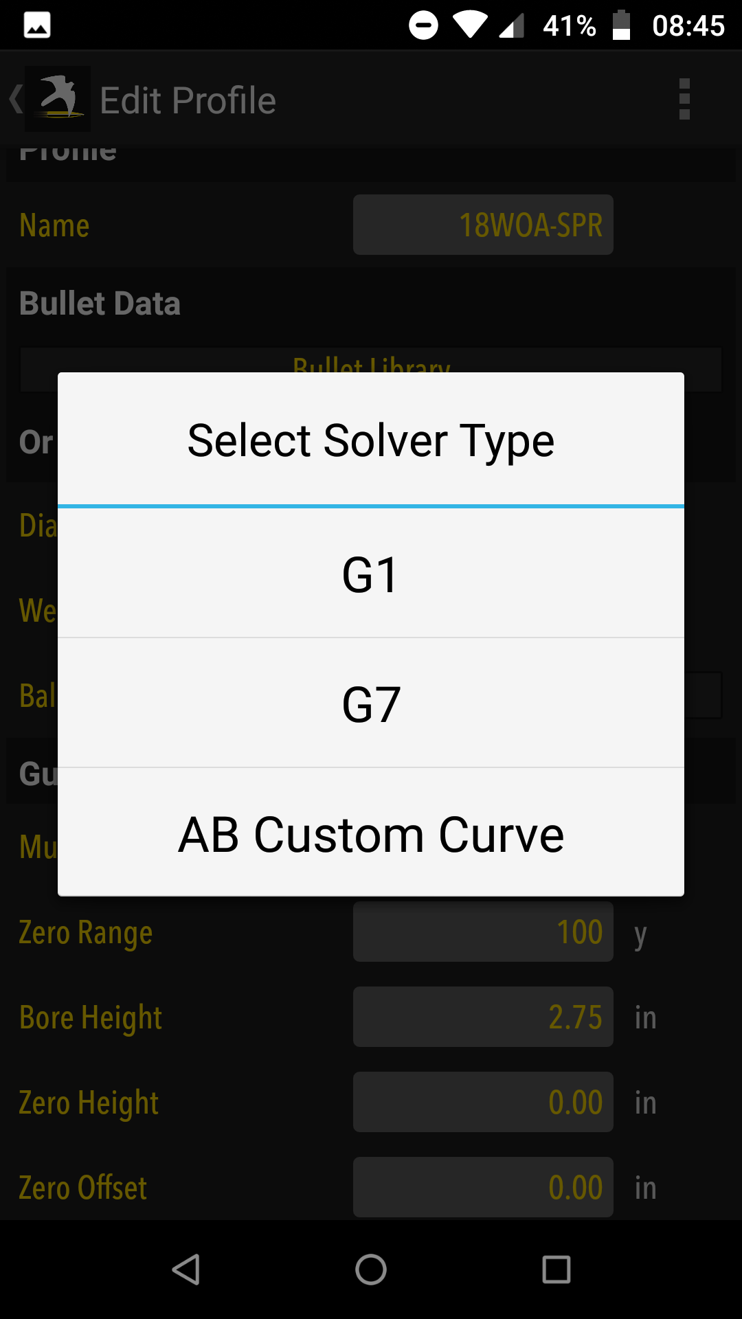

I was fortunate enough to attend an AB Lab Day recently. Slight confusion I'm sorting through now tinkering with the AB app, the Kestrel Link App, and my kestrel itself. Having a bit of a brain fart.....
Up to this point (before I had a PDM) I always grabbed whatever bullet I was shooting from the the library, tightened up the velocity, environmental, etc. and all was good.
Now, setting up a new bullet profile in the AB app, I select my gun, go grab the bullet / PDM that I have, and (I thought) I was to use "Custom" in BC however it shows up as "1.0" This is correct? (so long as I'm using my PDM? Or I'm supposed to change this to use the G7 value?
Perhaps part of my confusion as well is when I create a new profile for the gun in the Kestrel Link app and select my PDM, I don't get that Custom BC prompt. However in the AB app, I do. :confused:
Any idea why it shows as an option in the AB app, and not the Kestrel Link app?

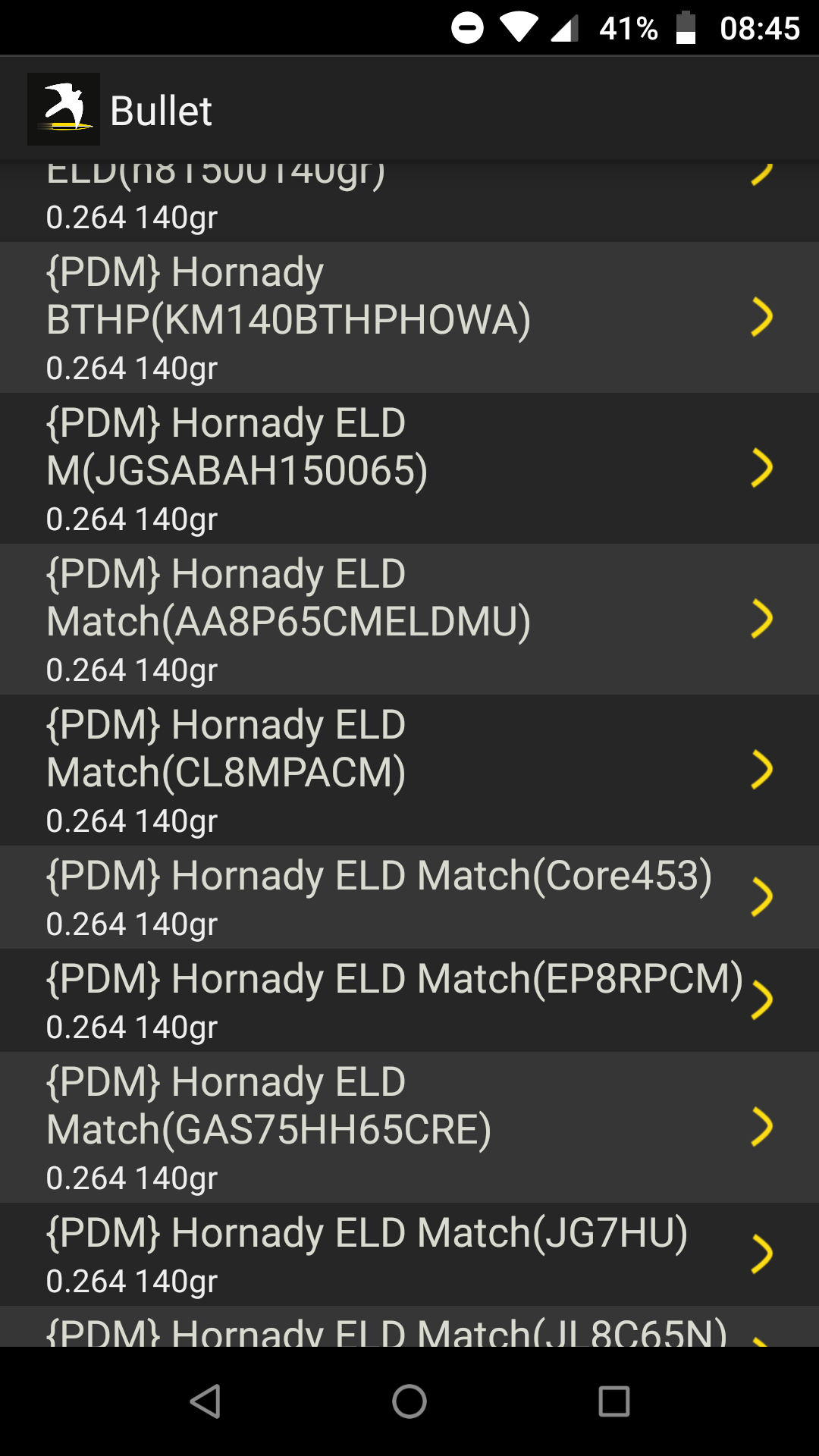

In LiNK Ballistics, click Bullet Library>select the diameter (0.264)> scroll to the bottom and find yours, will all start with {PDM} brand.
Once yours is selected you'll get the Custom Curve option to show.
I'm doing exactly that, and do not get the 'custom' option. As seen in the screen shot posted.
OK, weird. I don't get it. Thanks for the confirmation on if I'm doing something wrong/different/out of sequence.
I'll shoot message to NK Tech Support and see if they can provide some insight.
When you start the app have you been accepting the updates to the library, that is how new curves get added to the database in the app.
From his screenshots his PDM is in the 151900 database for both apps, but isn't giving him the ability to select the AB Custom Curve in the LiNK Ballistics app.
Yes.
However I'm not being prompted to update to a 152000 database. Although my PDM is in the database I'm using. So I'd be suspect if this were the issue.
FYSA: I also have an email thread with Joe R. Where he has recommended a few things which I'll try later tonight / tmrw and see if the behavior changes.
This is correct.
I got the prompt for the 152000 database while I was connecting it to my Kestrel, it was kinda of odd how it triggered. May be coincidental but is what I saw.
