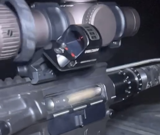

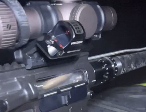

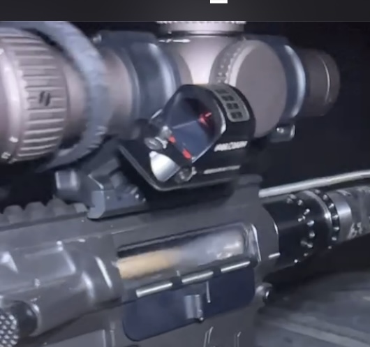

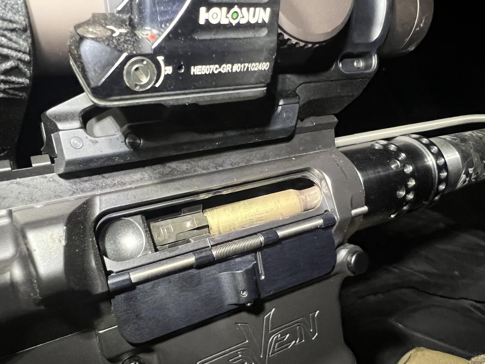

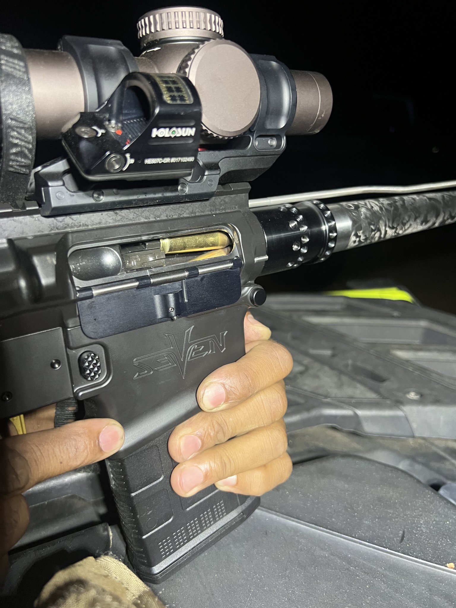

This is a new build that may fire 18-20 rounds well then stack the case 5 times in a row. So far have only shot PMC 147 gr. Have adjusted the gas. Going to try different ammo. I have a slow motion video I can send. We would love some suggestions. Thanks

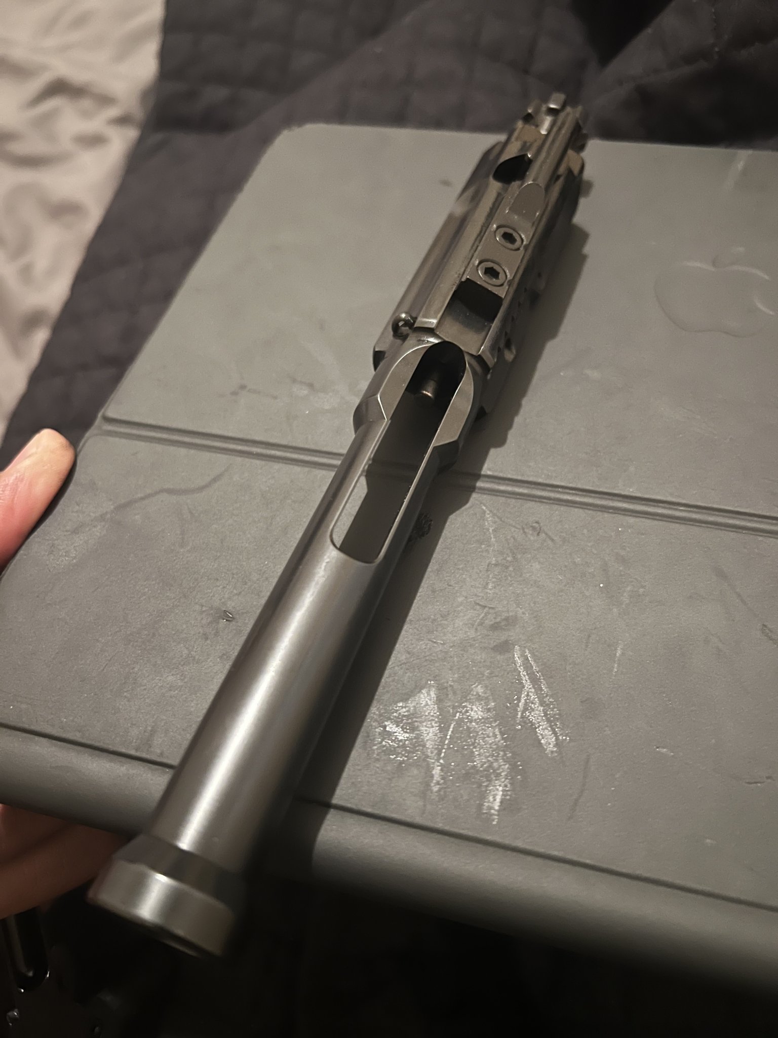

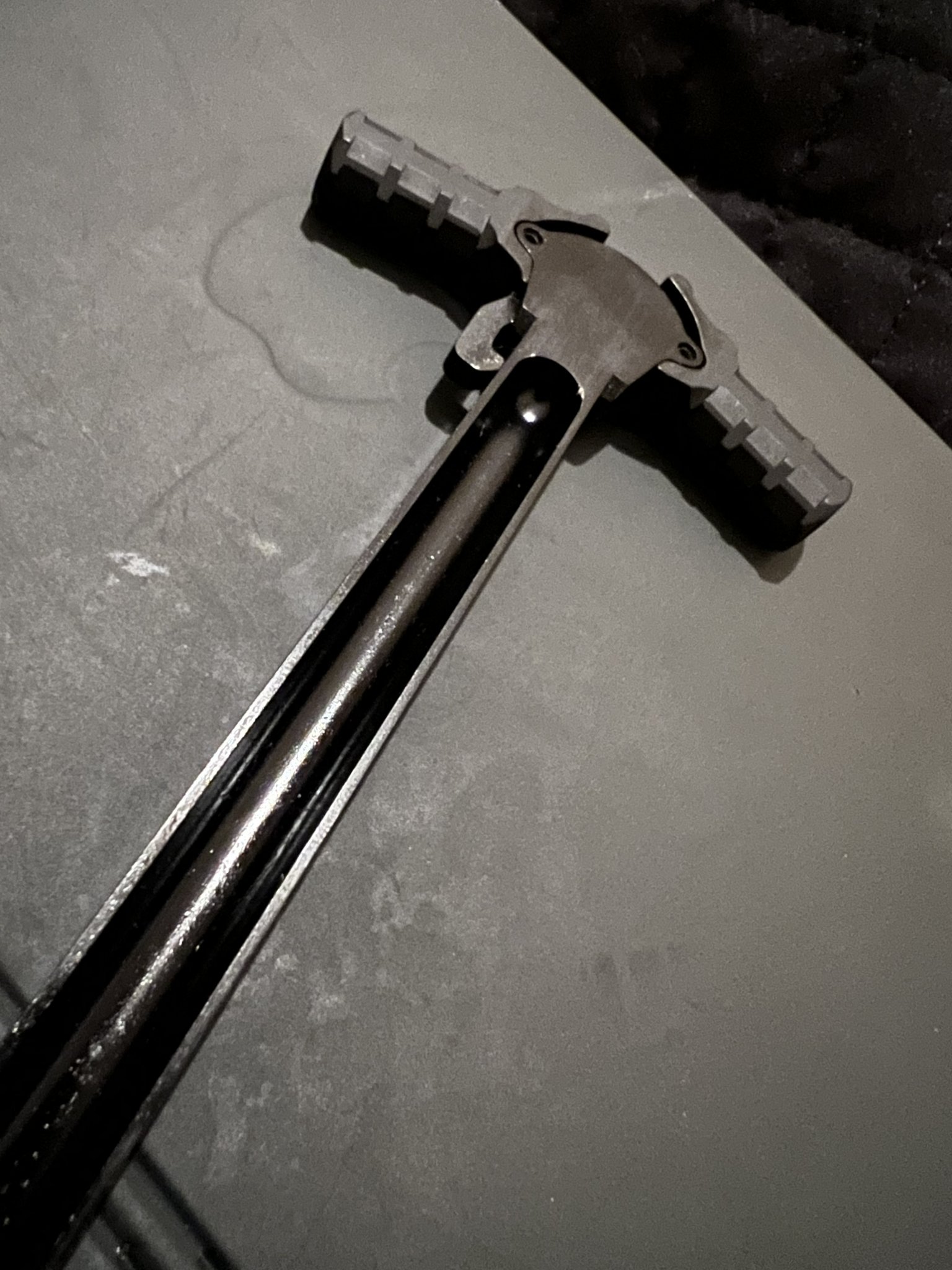

Also, pull out the charging handle and look for a giant ass mark on the inside rear from the gas key. This type of issue is frequently caused by a mismatch of proper buffer and tube for the AR10 platform.

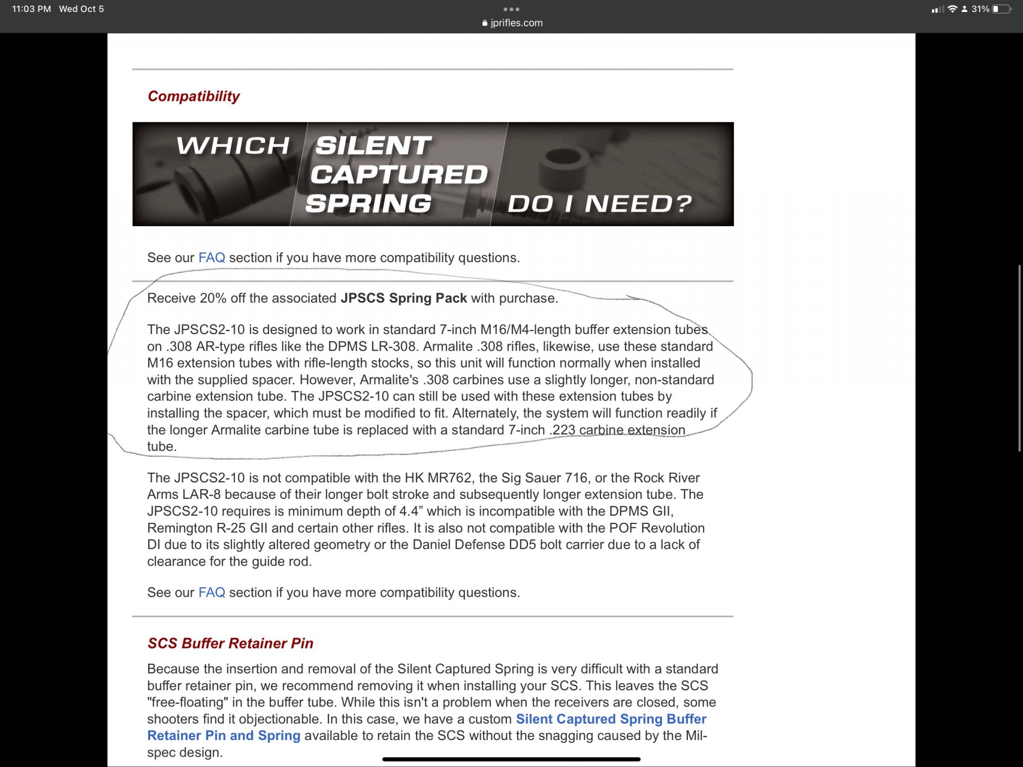

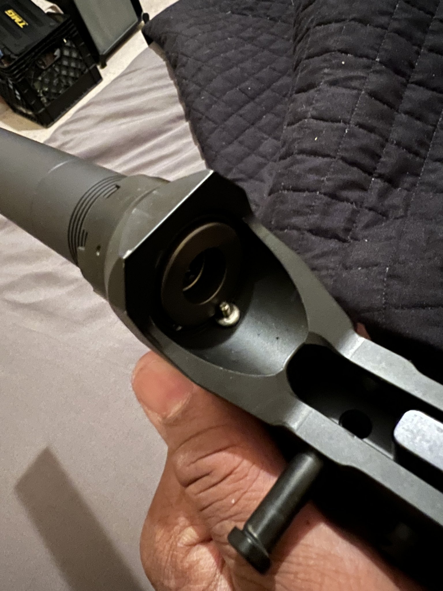

Do you have the right length buffer in there? Does the bolt catch lock back on the face of the bolt and still move back about 1/8 of an inch when you pull the charging handle?
It has JP AR10 silent capture buffer h2, Vltor RE-10/A5SR, A5 Receiver Extension Tube, SLR titanium adjustable gas block.

The brass shows witness marks from the extractor but not like it’s trying to extract with chamber pressure.

Him - definitely take your charging handle out and look for damage back near the latch. Flip it over and look on the bottom.
The A5 buffer tube isn't correct with the AR10 JP SCS if I remember right. You will get over travel.

vltor.com
"Receiver is designed to use the VLTOR A5 spring and buffer kit only which is sold separately."
Edited it, I just deleted everything I wrote.. that first picture now has me leaning towards under gassed. It doesn't look like it truly picked up that bottom round, but rather push it up through bolt drag to the case body.
(of course if it was a timing issue and the pressure was still up while trying to extract, it would do the same exact thing. lmao Okay I take back everything! :D )

Bolt comes back all the way.
Starts moving forward'
Case goes up more than right.
Jams in the front of the port.
My first thought is it's cycling too fast.
Since you said you have adjustable gas, I'd slow it way down first.
If it still does it, I'd think extractor/ejector issue.
