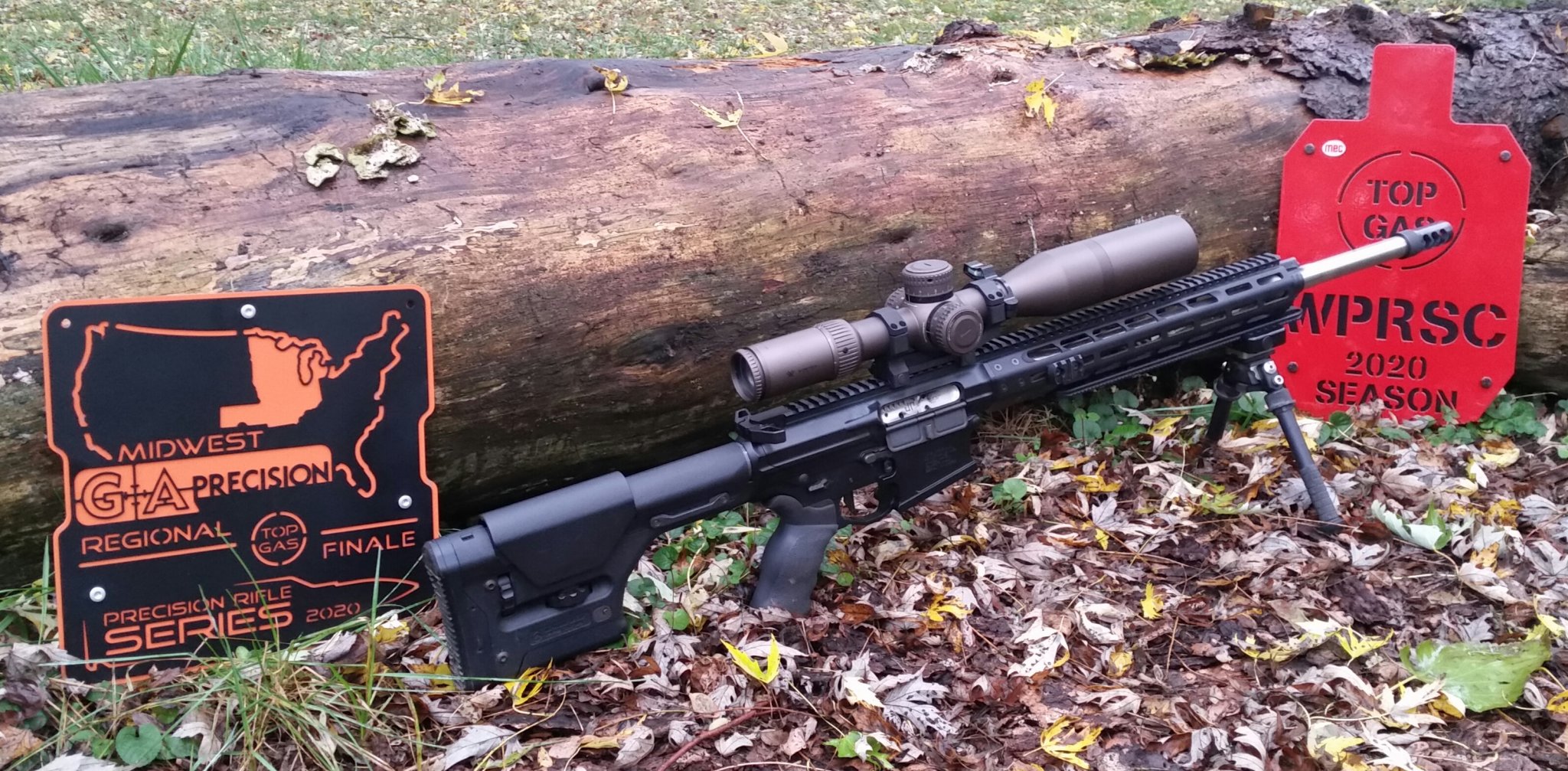

I shot a 6mm arc in a prs match. If a person built an ar15 with that purpose in mind, it would be a solid competitor. I never had a malfunction, or any kind of issue. I had a 22" barrel, but with a 26" barrel, it will shoot those 105's just a hair slower than most 6mm's used for prs. If I had any desire to shoot prs, that's exactly the rifle I would assemble.
Reactions: 232593
Same. I just don't enjoy bolt guns and my 17lb 22" 6mm Grendel is as close as I can bring myself to owning the static artillery type rifles that are prevalent in PRS. I could certainly stack the odds in my favor with a longer barrel and more weight, I just don't care to.
I have a 308 I built up over the past few years. I’m pretty happy with it and may tare it to a match, understanding 308 + AR = double the handicap. But I was thinking I might re-barrel it to 6 Creed or similar and get an ARCA Rail for my JP MK3 handguard to improve it.

I ran one for a year in the regional series, did very well and took home a top gas gun trophy that year. My scores averaged slightly lower than those of my bolt rifle at the end of the year. Understand that isn't direct comparison of the same matches because I wasn't shooting both at the same match... but within the same region.
I used a Mega Maten frame set with JP parts and barrel in 6.5 Creedmoor that I assembled.
Lessons learned,

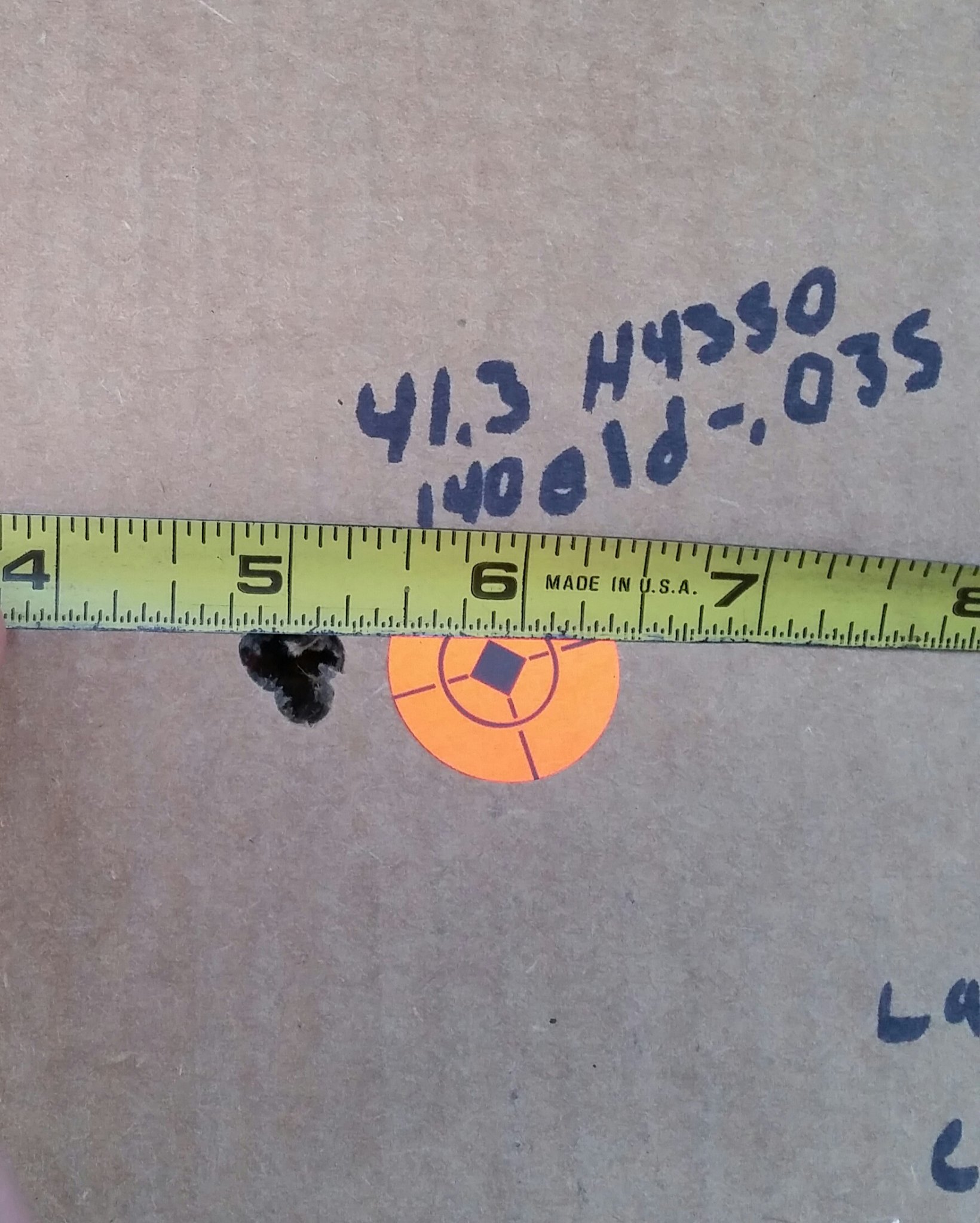

You can't hot rod your ammo as you can with a bolt rifle. I was running 140's about 2700 fps while most competitors were running the same about 2850.
Use .003 or more neck tension on your ammo
Some powders don't play well with a gas gun so you may have to experiment until you find one with a good pressure curve for your gas system.
Take time to get into a solid position to control the recoil, you are still going to move off target more than your used too so be prepared to track the target in the scope.
Remind your RO's you are going to have fast follow shots... I out ran their ability to score hits like they were used to with the bolt gunners often, as soon as I saw splash the next round was in the air.
Bring an extra bolt carrier group so you can swap it and clean it every few stages... or if you in a low dust environment a small can of wd-40 and the included straw on the can squirted into the vent holes of the carrier will also work after every stage.
Tactical brass recovery makes an awesome brass catcher and it never caused a problem...
