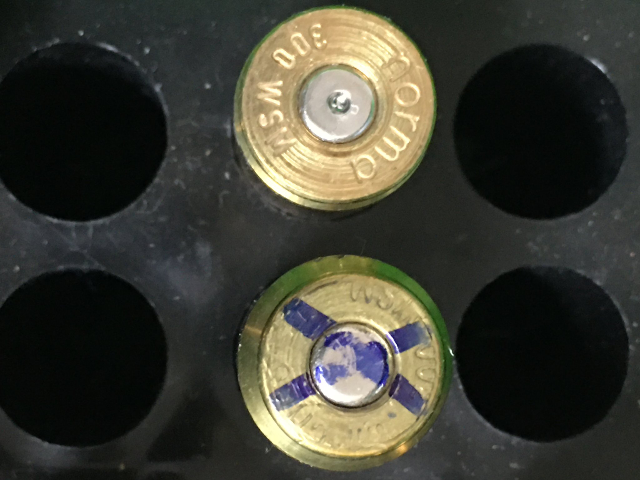

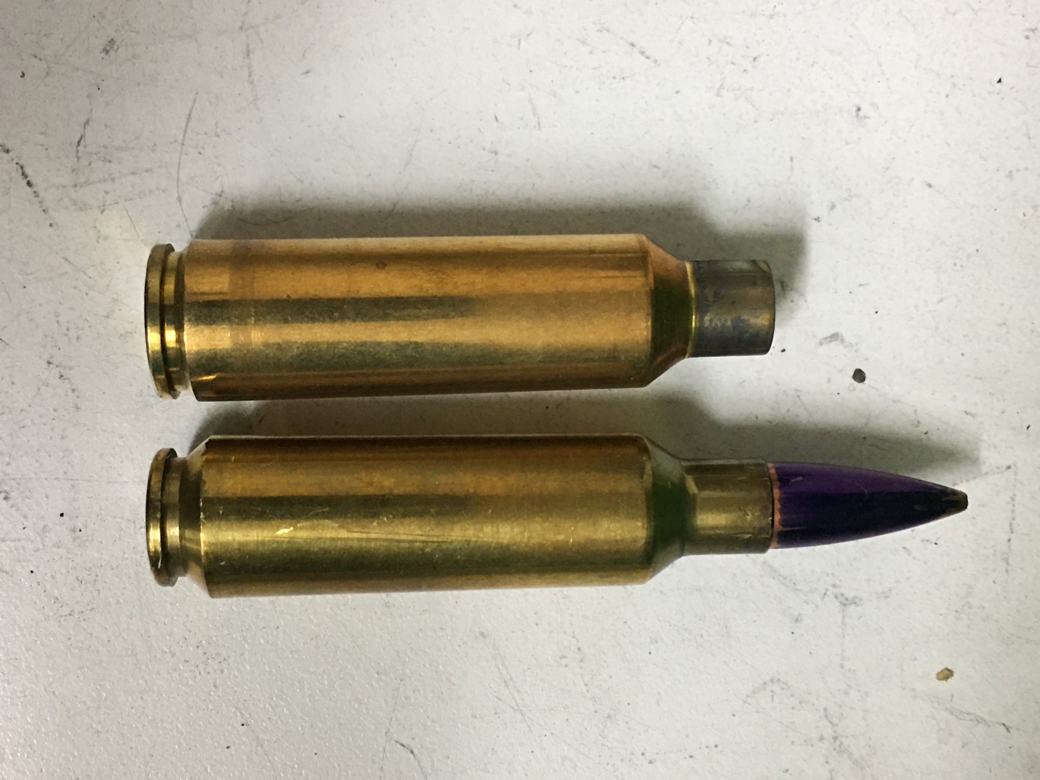

I ran factory ammo for my KAK 300wsm and chrono'd them. Then started building loads off that velocity and went from there. I settled on the Barnes 150 ttsx as it allowed me to seat a little further out and still maintain mag compatibility. I also had a load for the 130's but i felt it was too light for the wsm. The 165s shot really well but I couldnt seat them out as far as I wanted.
My reasons were
1. sounds like you cant reap the full benefits of the wsm before you run into over pressure. Not so much from over pressure but timing of the system with that much gas volume. a custom barrel with +2 gas system might be much more beneficial.
2. the WSM is .075" longer case than the SAUM and its hard to fit in and AR10 mag or is severely bullet limited.
I dont believe the 300 SAUM is even really around anymore so its not much of an option any longer.
