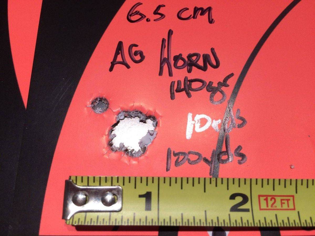

I have a PSA PA 65, with a Criterion Barrel ( with other accurizing tricks done by me ) that can truly shoot better then me.
I guess I am saying... if I can do it, so can most anyone else.
Provided you have the mindset and tools.

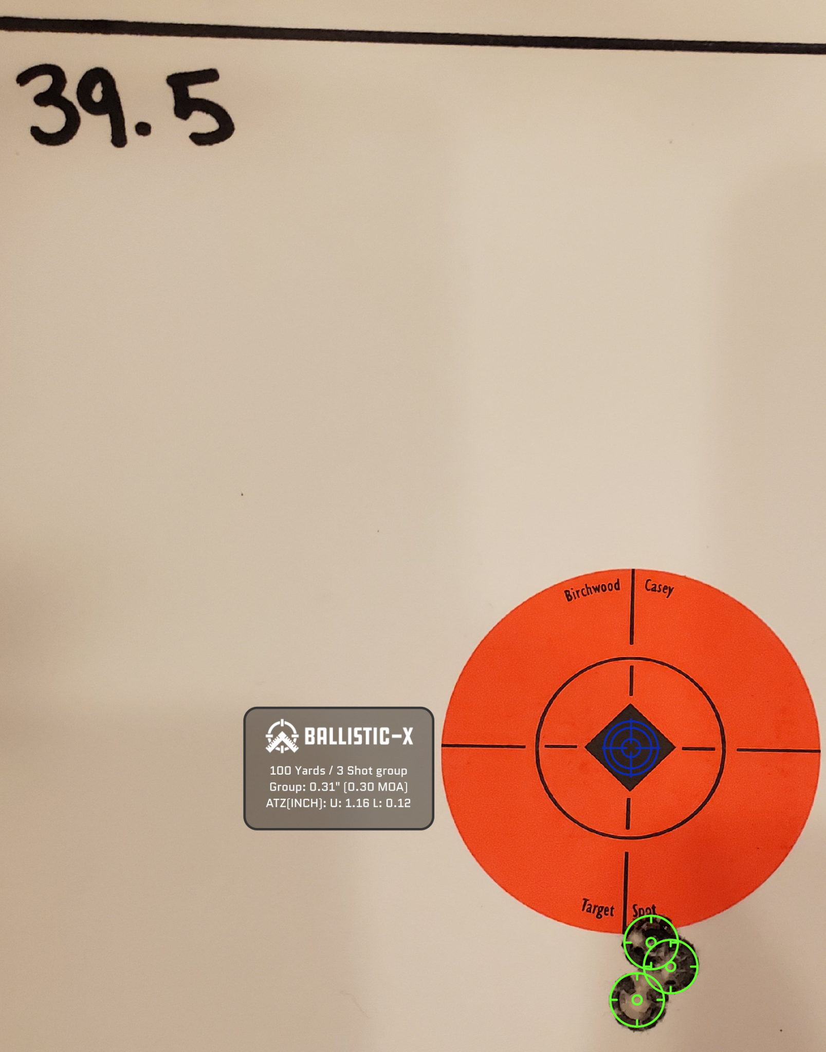

I'm shooting 1/2 MOA from both of my home-built Aero Precision LRs shooting handloads - one in .243 Win and the other in .308 Win. Both have 24" X-Caliber barrels, heavy buffers, light buffer springs, adjustable gas blocks, and Geissele SSA-E triggers. Spent less than 2K on each minus the optics.

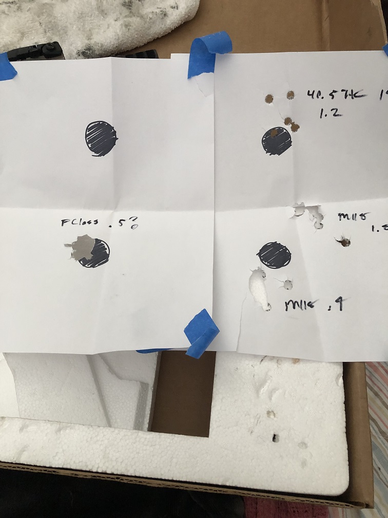

DPMS LR-308 24” stainless fluted bull Barrel. Moa with FGMM or Hornady match. Gun was $1199. It doesn’t get shot much because it’s a heavy pig and I enjoy shooting others more, but it’s easily sub moa with handloads as well.

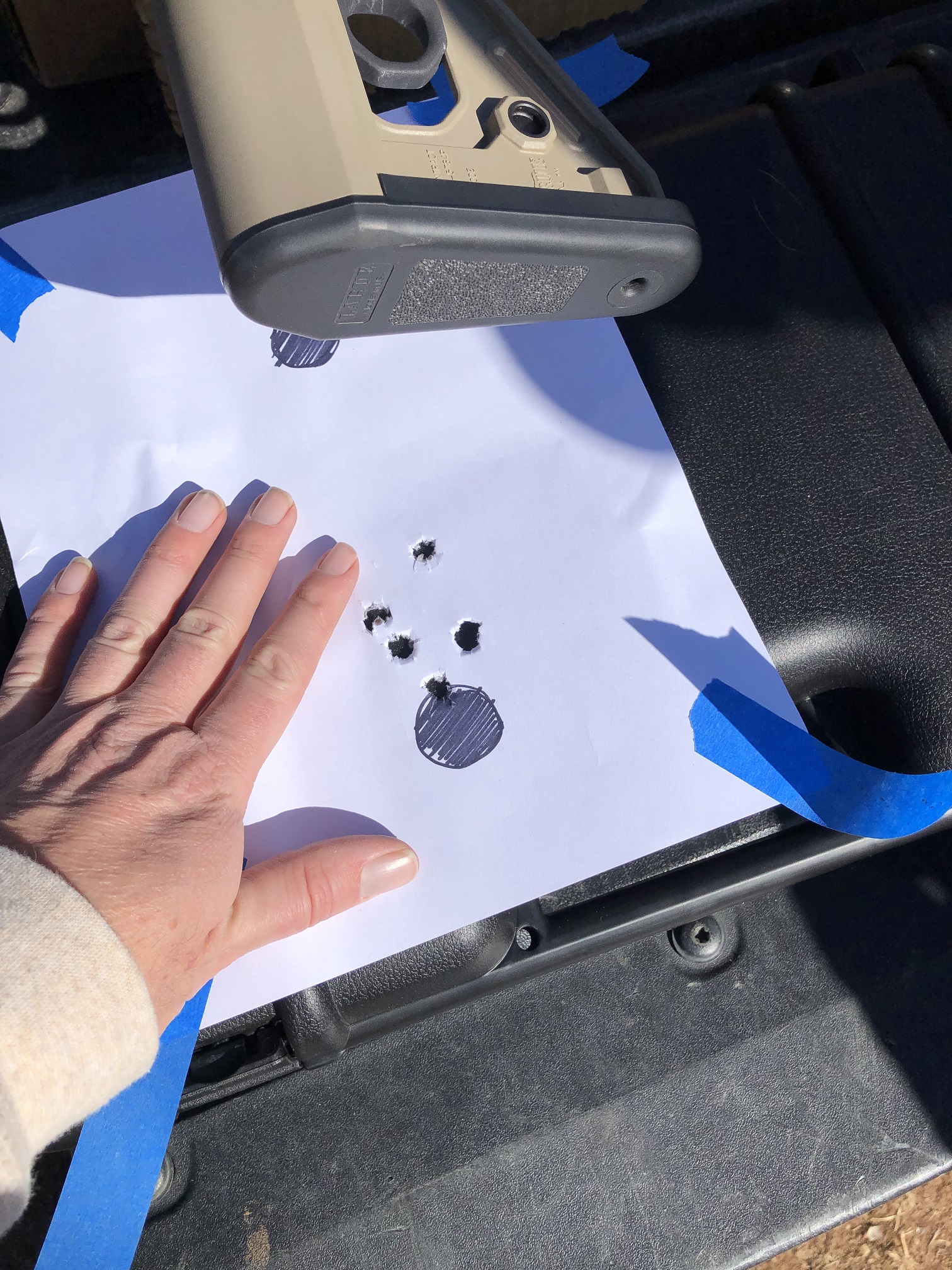

This was my 716i shooting FMJ blaster ammo. If I put it in a mechanical rest and single feed my f class loads it was 3/4MOA but that's not realistic shooting.

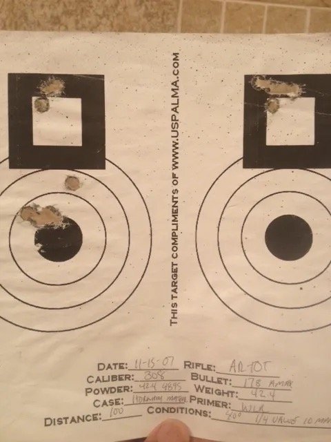

Another one loads are listed on here:

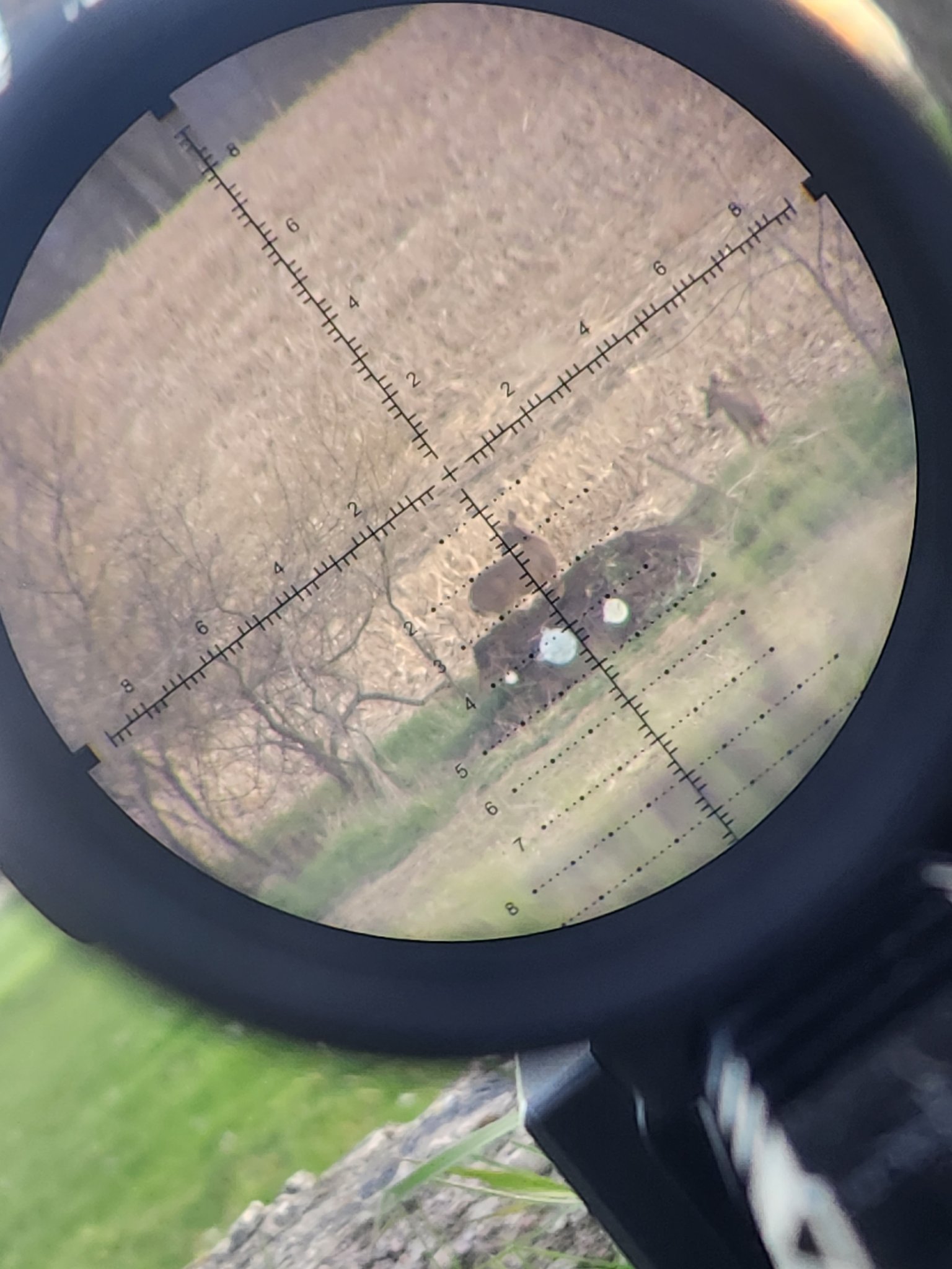

Just the other day. Banging steel and didn't even see them till they walked into my FOV. Sent a few more, they barely startled at the lead bouncing off steel. Had to stop shooting because they walked in front of the targets. Deer aren't that smart, and often stand around after near misses.
Deer on the range is a common occurrence at the Texas Precision Matches in Cawthon. So much so that no one mentions them.

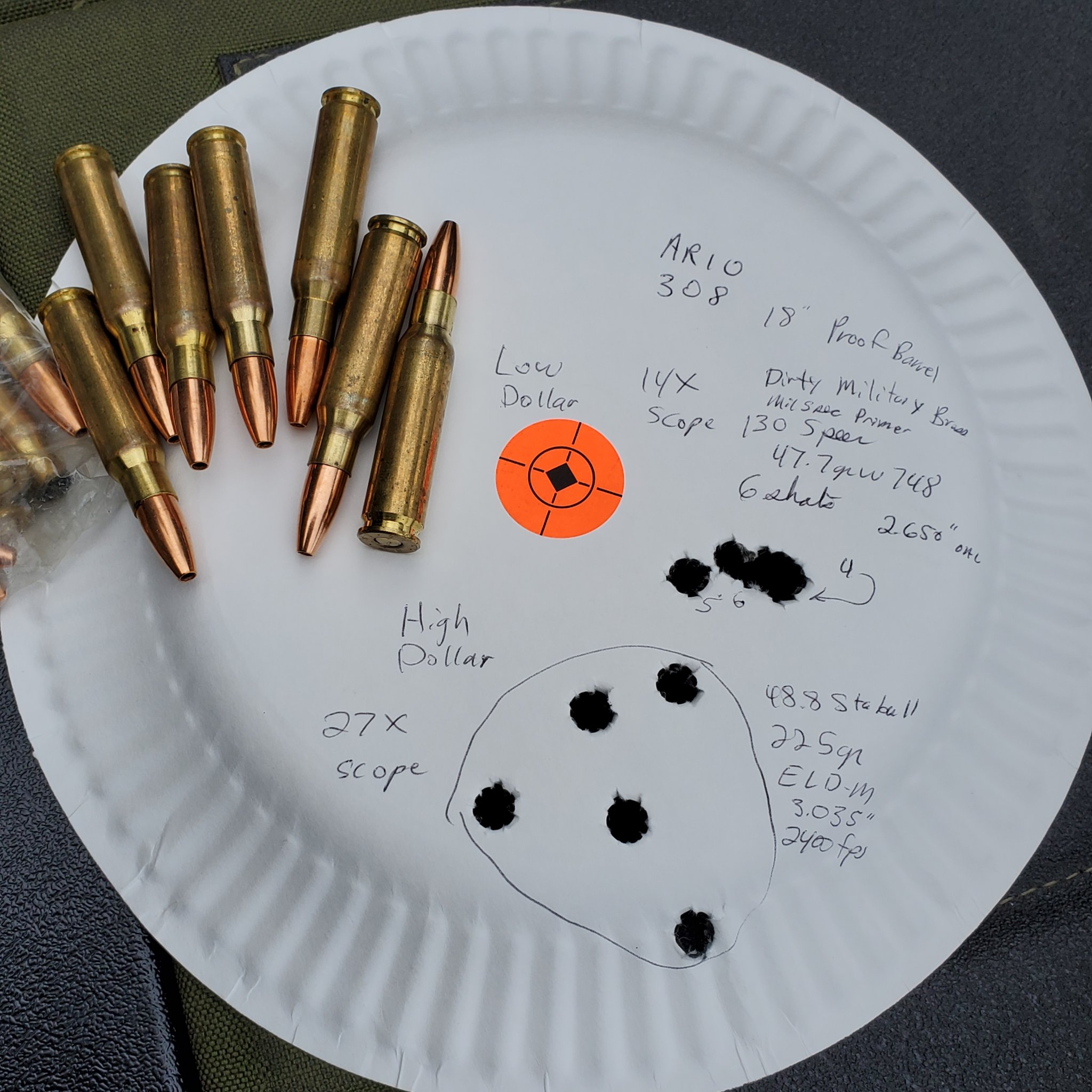

AR 10 is capable of fine accuracy...while testing two extremes 225 grELDM and 130 gr Speer.
The crap ammo was a 1000 bulk purchase of dirty primed of LC 308 brass, loaded on Dillion progressive, with old 748 powder needed to get rid of it & the primers. The first 5 went into .3" thought it was a fluke, next 5 into .4" so after shooting the 225 gr ELDM load, that was disappointing, I decided to just ran the crap ammo again to compare, ran 6 shots because I thought the one off was my fault and it went into the group ...this Proof barrel likes this combo, dirty LC primed brass, W748, and Speer 130, super cheap super accurate...but it's not a long range load, and mostly useless except for close range varmints...but the barrel loves it. No brass prep, no match bullets, long jump to rifling, no weighing, or sorting, & loaded on a progressive. It is what it is...and I'm sometimes amazed at the accuracy of the AR platform, while slaming cartridges in and out of the chamber in somewhat violent fashion.
