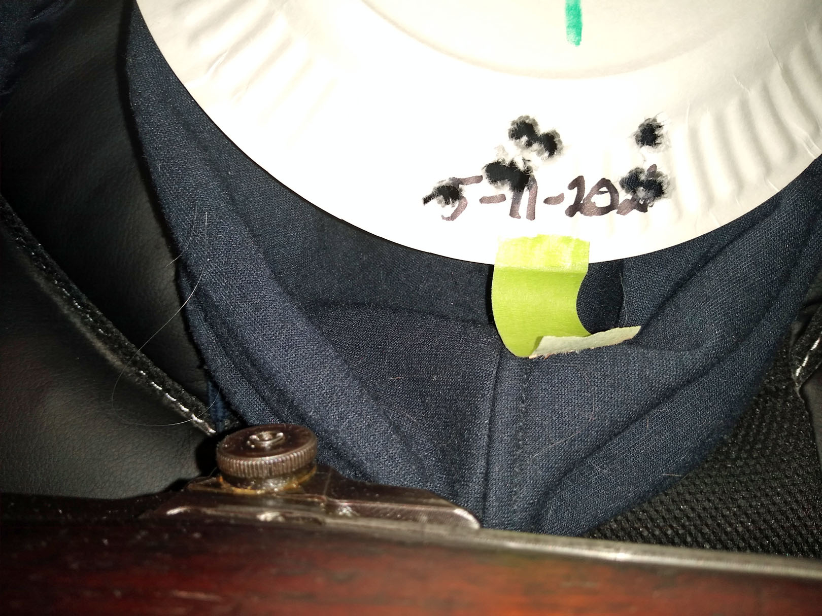

1 St. target was done with a M1 Garand 1942 Vintage Iron Sights W/stripped pinion . Hence Why at the time I was unable to elevate group ,however all #8 are there .

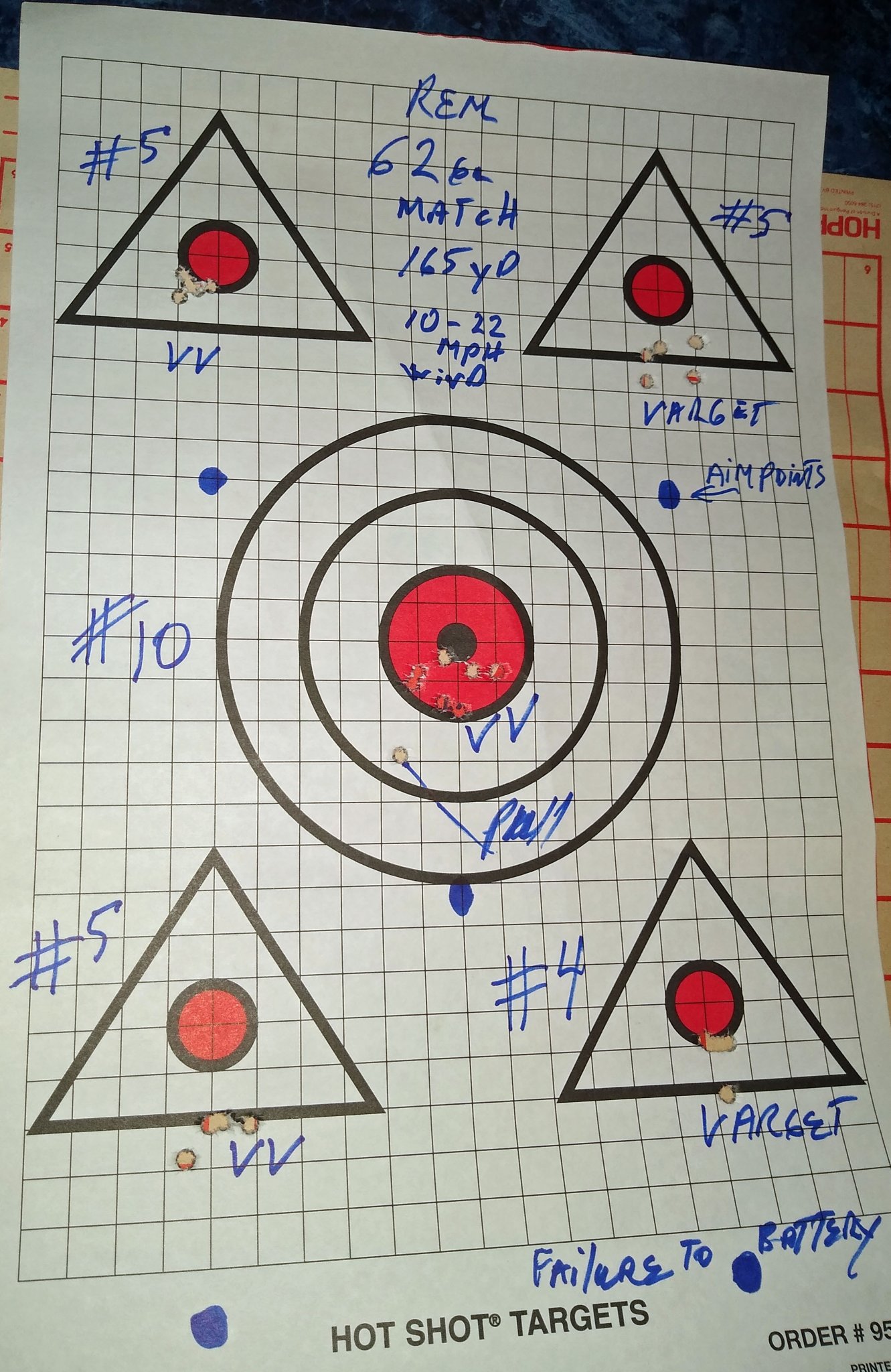

Older 5.56x45 out of an Aero precision AR 15 ,Powder evaluation . Some of you are scaring ME with 4-5 MOA talk .
Look at those paper plate at 165 yd. with an M1 Garand w/ Stock sights Granted Handloads . I don't own a rifle rest just old sandbags .
As I had acquired that particular Garand from a friend ,I wasn't aware the pinion was stripped ,so unable to elevate sight is why their so low .
I do use a decent spotting scope because as all I can see at 165 yd. is White . AR 15 is scoped .
I'm NO Mathew Quigley or Carlos Hathcock I assure you ,just and old steady hand .
