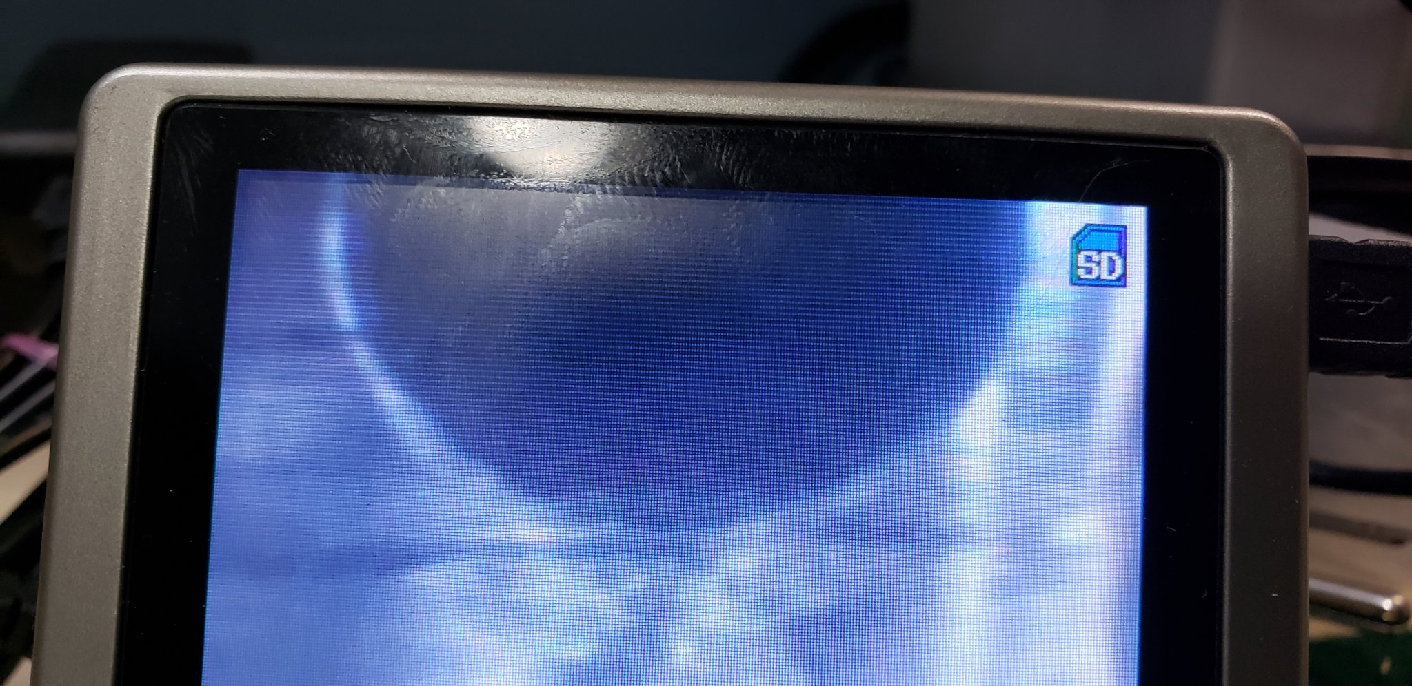

Here is a new match grade barrel unfired (zero rounds ever) and just cleaned. Notice there are zero burrs and port has been chamfered to remove any burrs.

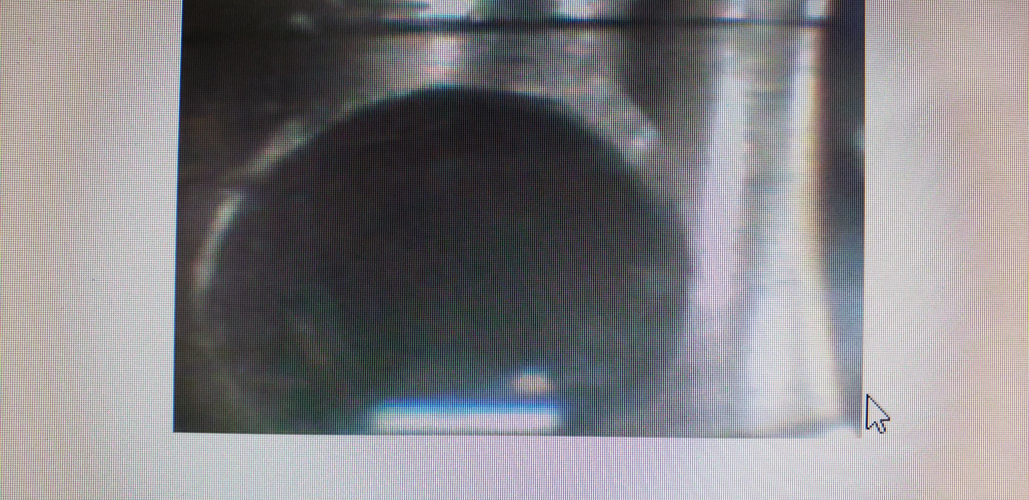

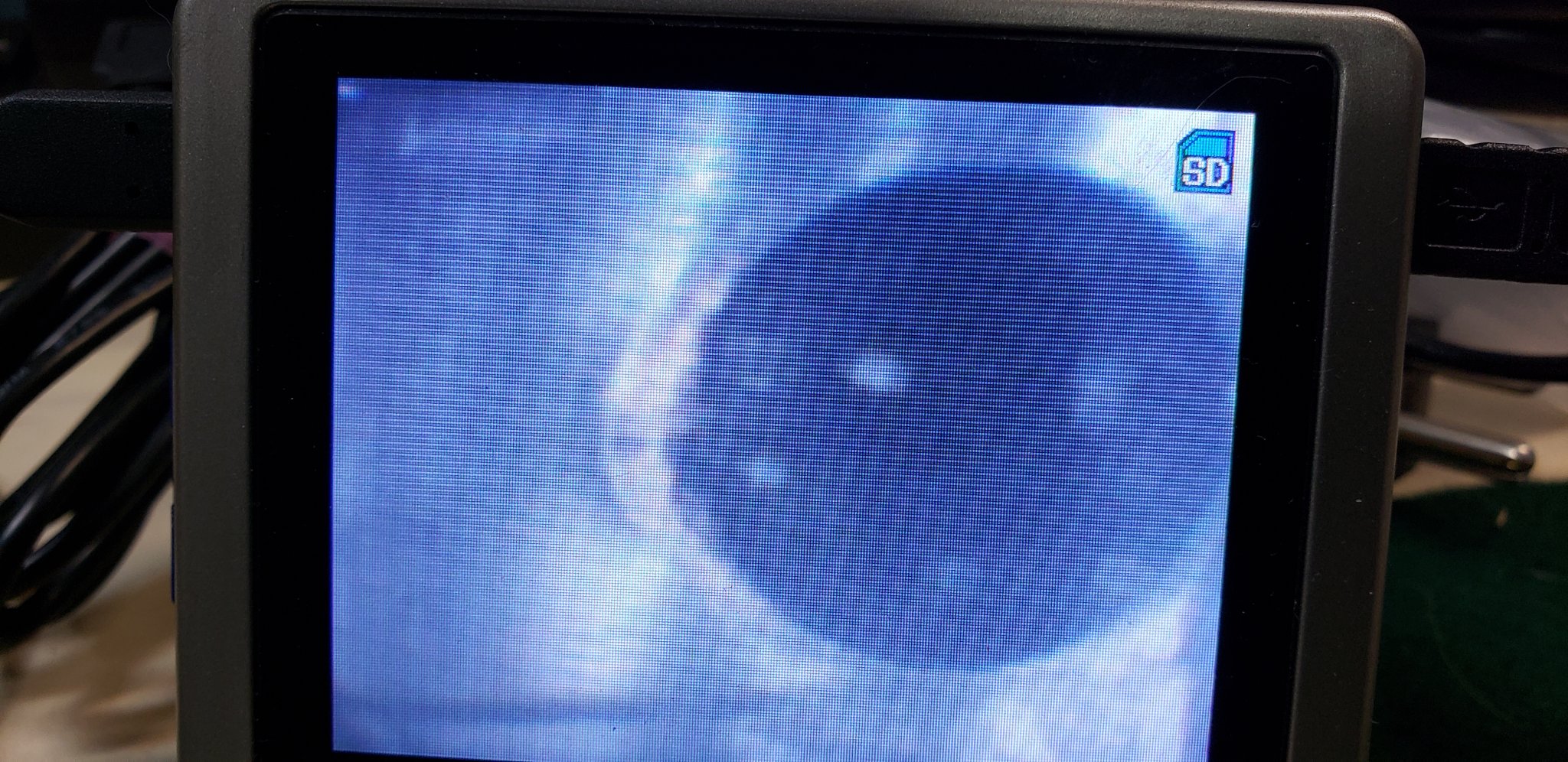

Here is after 15 rounds. Cleaned twice (first shot and then after 3 shots, then shot two five shot groups, which were a bit erratic grouping and I suspected a burr/deformation had formed.
I cleaned at home and took these photos:
Bottom picture is after scrubbing port with copper remover and still has copper. It has a distinct ridge that's formed on the back edge of the port that is rasied relative to the bore, grabbing and scoring the jackets of subsequent rounds (potentially causing them the fail/separate).
This is where I think Tubbs Final Finish has a place in AR barrel break-in. I can either shoot 100-200 more rounds normally to see if erosion removes the metal OR I can use Tubbs and remove within 10-15 rounds.

Rainier 224 Valkyrie +3 gas system. Stainless steel and I believe they lap barrels at factory (not sure though) but finish on barrel was PERFECT from factory; looked like my Kriegers and Criterion bolt barrels.
Process:
First shot was Fed Fusion, cleaned thoroughly, 2 shots TMS rounds, cleaned thoroughly, 3 shots 90 Fusion then then 10 handloads (two five shot groups).
Zero copper in bore even before last cleaning except the gas port and one tiny spot at throat/lead. Otherwise pristine barrel and machining.

This phenomenon occurs in every gas port that I've ever examined with a borescope. It's most obvious - and most erratic - with new SS barrels.
Some SS barrel steel formulas exhibit extreme erosion more than others.
Sometimes, if a larger "chunk" breaks out on the forward edge, rather than a slower, progressive erosion, accuracy will immediately fall off - badly. But, that accuracy can slowly return with more rounds fired as the jagged edge is eroded smooth.
Gas port erosion continues for the entire life of a barrel. One Mid-South Shooting instructor with some crazy amount of rounds though his 5.56 Mk 18 - several tens of thousands - had what resembled a worm hole in a piece of wood tracking an inch forward of the gas port. There was no rifling for the first couple of inches, either. It was amazing the gun still ran and provided acceptable accuracy.
You don't have to have a borescope to observe extreme gas port erosion. A telltale sign of this problem can typically be seen at the crown. Clean the carbon out of the barrel and examine the crown closely, with good light. If you see one distinct, narrow streak of copper at the crown, gas port erosion is the cause.
