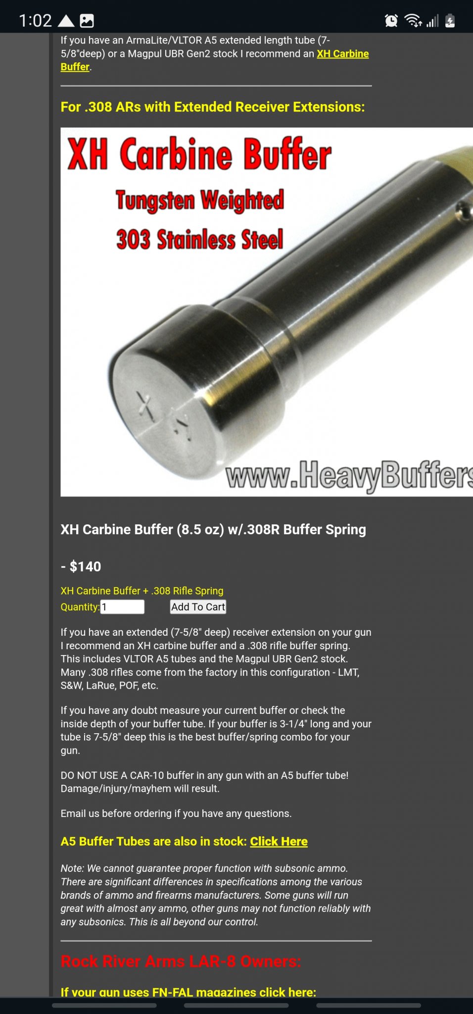

I'm thinking of trying H2 and H1 buffers next... or a Tubbs flatwire spring... am I headed in the right direction?

Armalite buffer kit you have is fine. No need to change that.

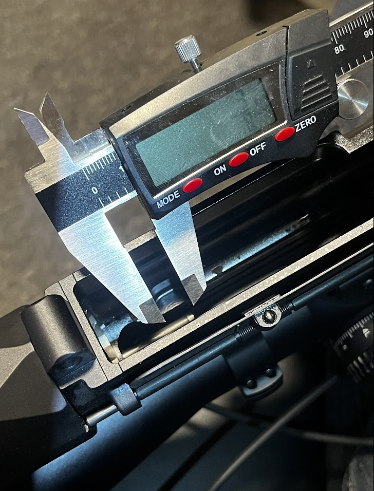

Did the best I could with my caliper and the gas port came in at 0.084"-0.089".
I think I saw somewhere that minimum 0.09" is recommended for rifle length systems?

I'd recommend measuring the gas port first; if memory serves, it should measure 0.090" - 0.096" for proper gas to the BCG. if it is not in that tolerance, you will likely have to drill the gas port with a numbered drill bit (#42 or #43, if memory serves). Once you have the gas port right, run through the standard test opening up the AGB all the way and firing 1 round, to see if the BCG locks on empty mag.

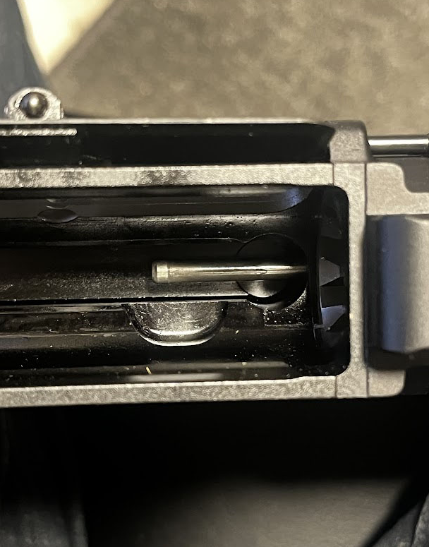

Gas port is aligned (verified with video borescope). And gas block screws torqued down to spec with a Wheeler torque limiter. Barrel is dimpled.
WC AR10 tube lands a little past halfway on the cam-pin cutout. I have a WC standard rifle length tube, but it would land 1/8” short of halfway on the cutout. Wilson Combat is annoying like that; they split the difference between the two tube lengths with their gas port placement. Annoying as hell.

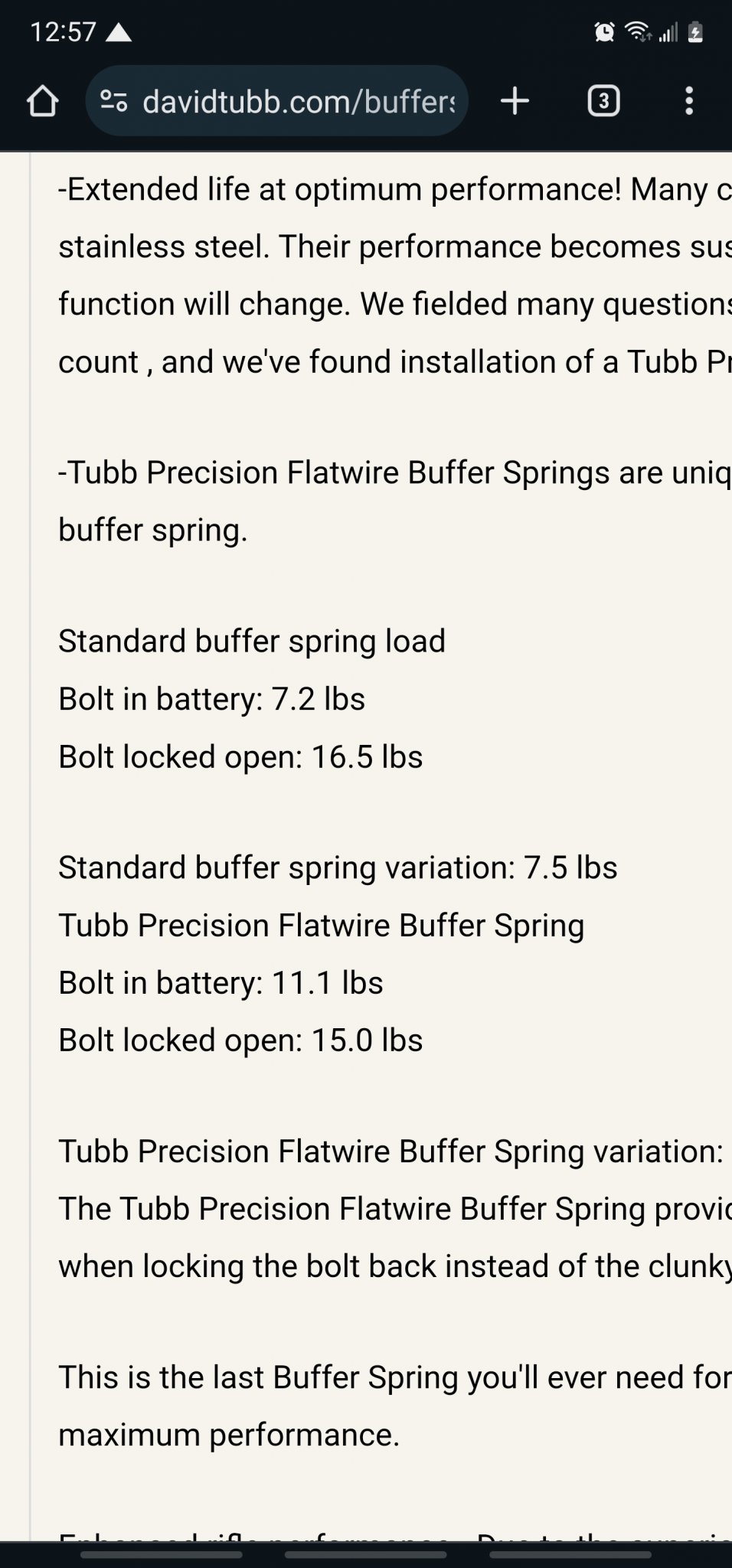

Tubb 308 flat wire.
The poundage is increased with that spring.
The poundage for that spring is listed on Tubbs website.

Also what's the deal with the gas tube? Mine looks a little short in the upper receiver.
That is a problem, WC drills the port in a different location so you need to get a longer gas tube to reach the center of the cam pin cutout. I think that length is apx. 15 1/2".

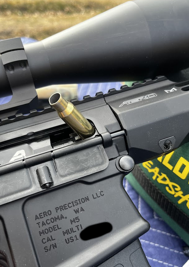

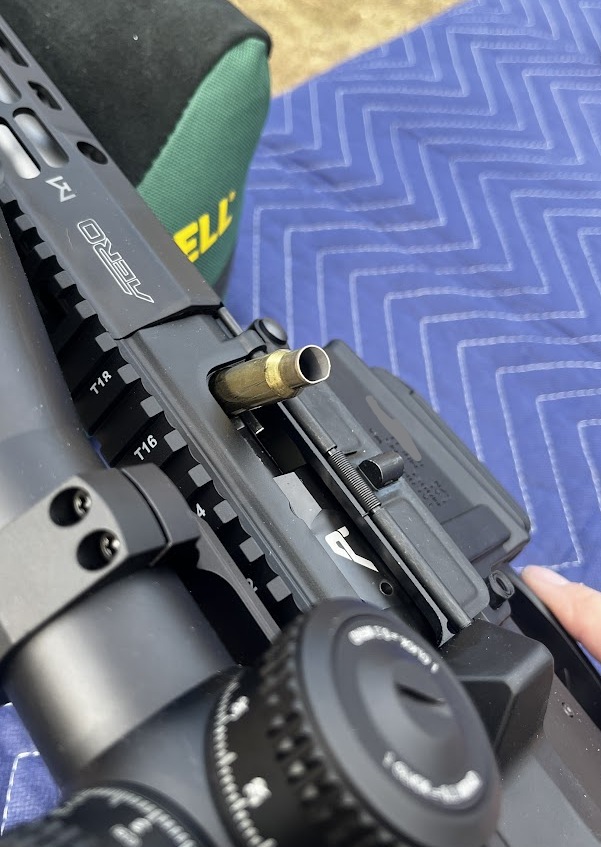

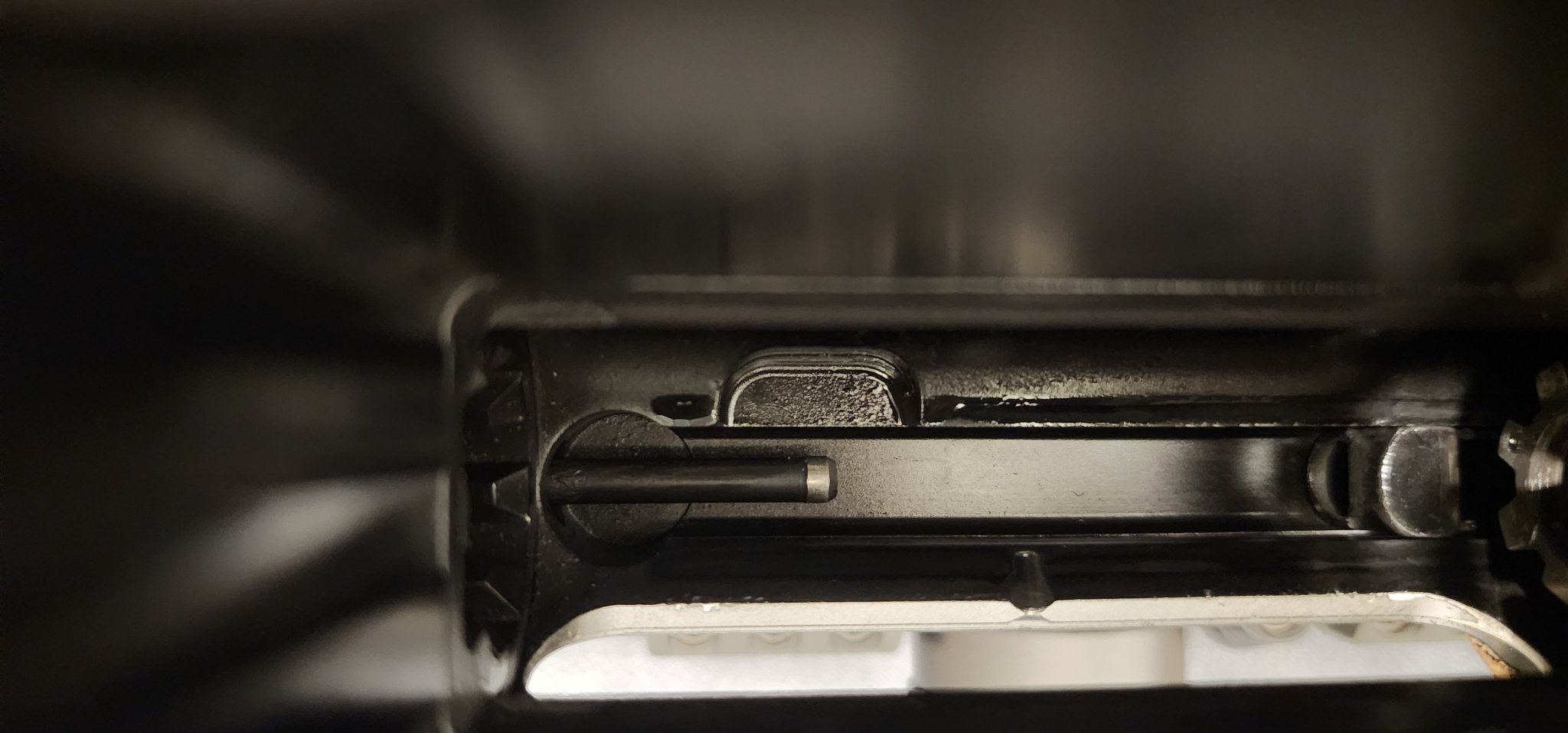

Here's a stove pipe from my last range visit. Note the smashed-in casing...
Your gas tube should not be that far back ... it should be right in the middle of the cam track ... wonder if that can cause the bolt not being fully locked in ...

Well yes and no, he used calipers, that isn't going to give a real number.
He needs to use drill bits or something, only saying that because gauge pin sets aren't cheap.

Your gas tube is wrong as already mentioned...that will keep the key "in the gas" longer than intended. It's only milliseconds but that's all it takes. So your BCG is being pushed for a longer duration.
The stove pipe also tells me the bolt is traveling forward faster than it should, likely after hitting the bottom of the extension.
The flat case mouth will likely go away once you sort the other issues out.
