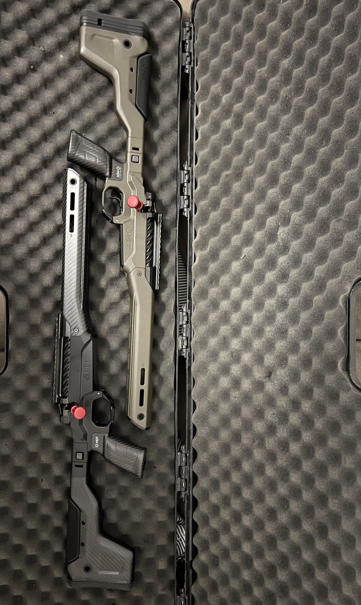

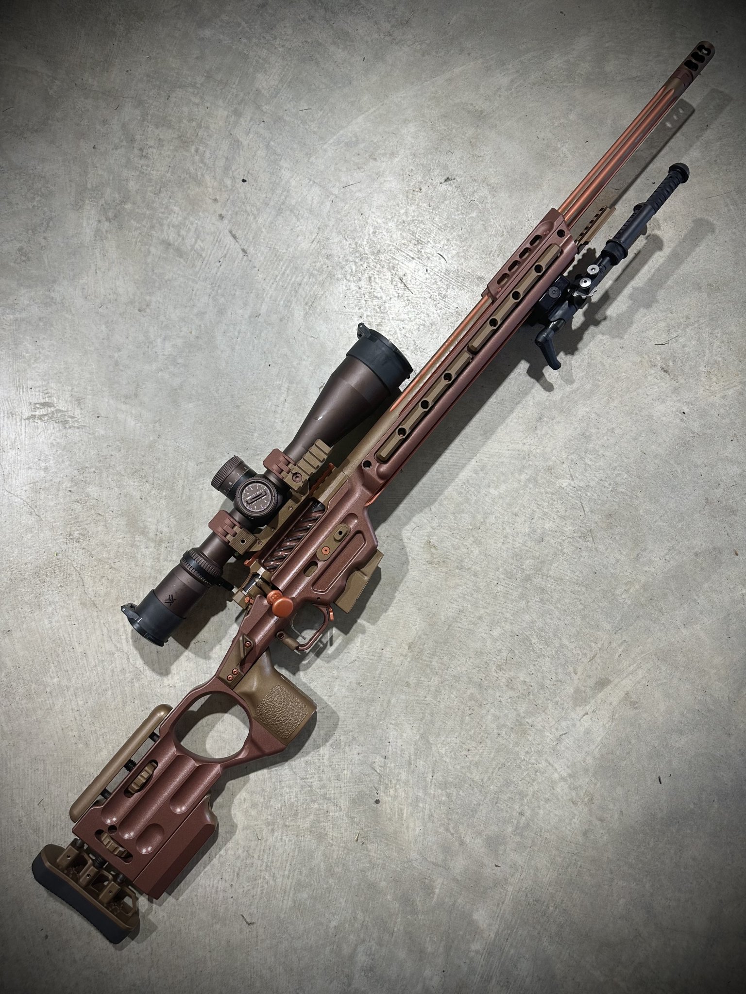

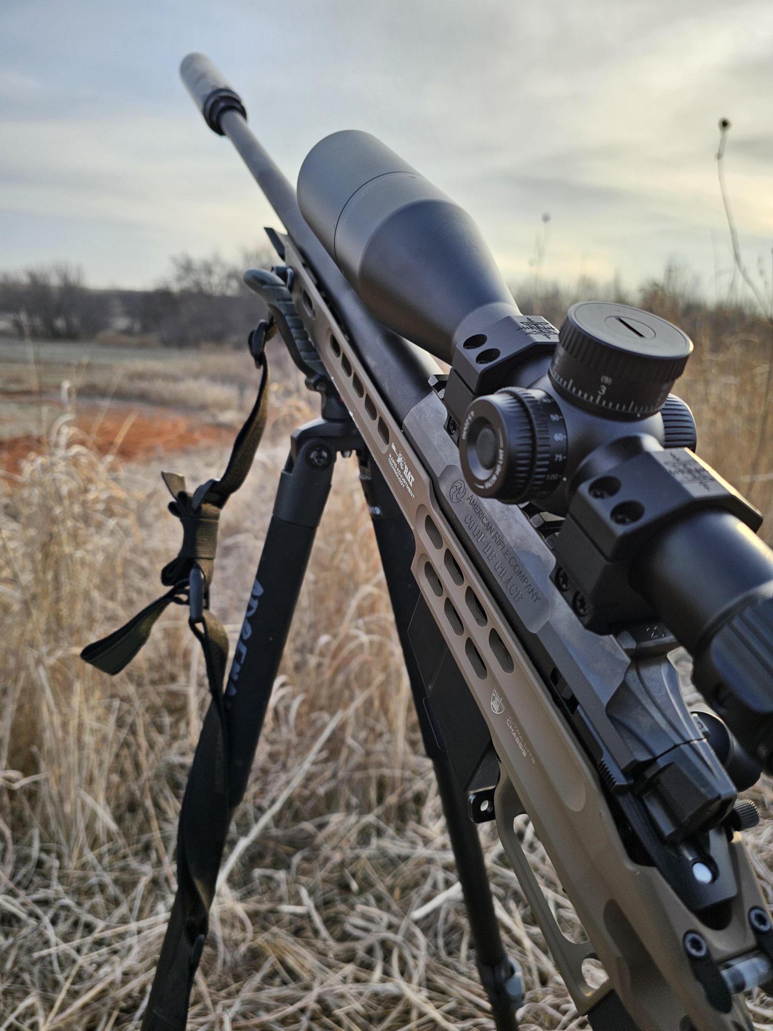

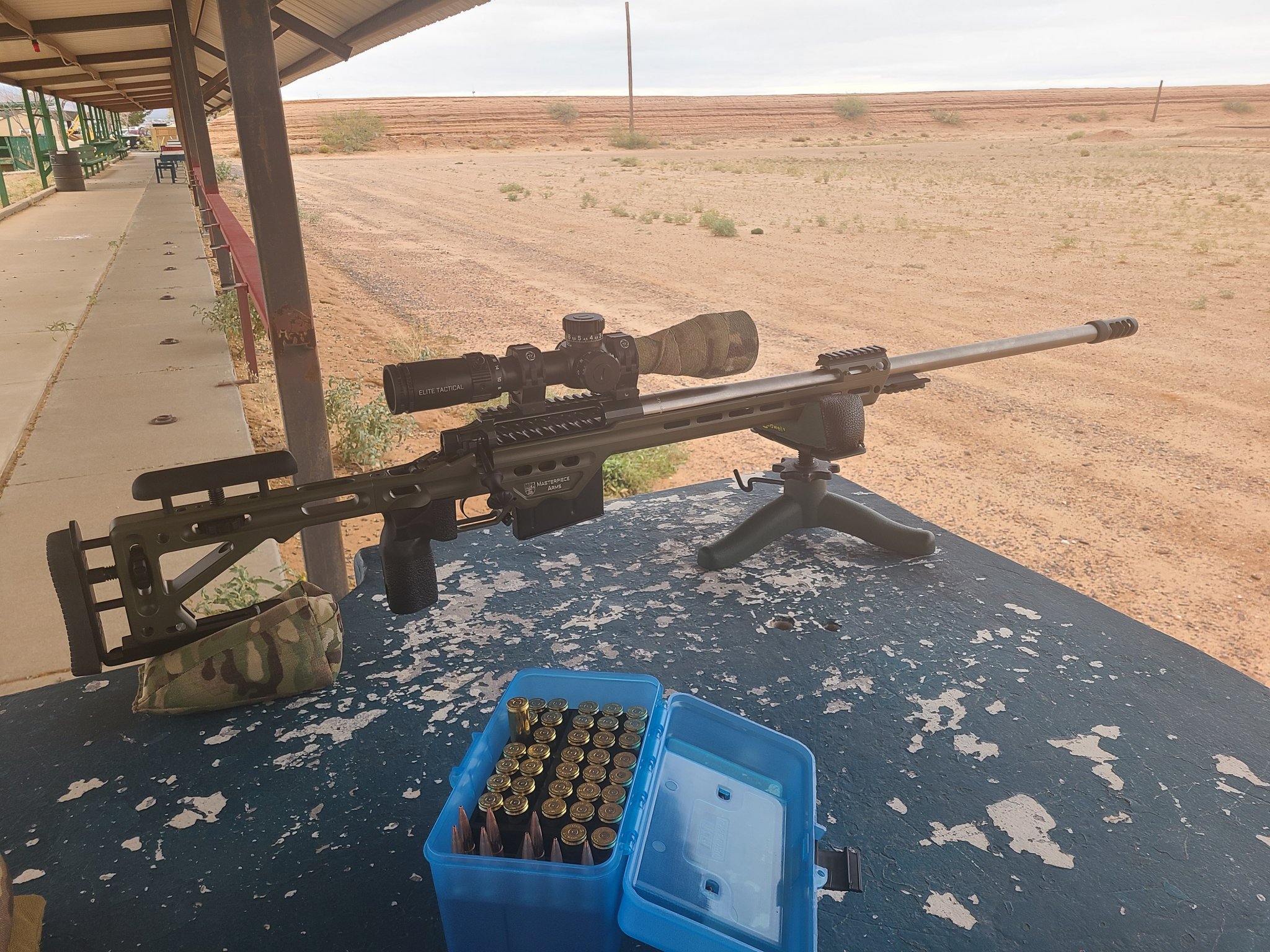

I got my long action put together and shot it for the first time today.
Build list:
RH LA .588" bolt head 20 MOA
Bartlein 28" heavy palma chambered in 300 NM by SPR
MPA ESR chassis
Triggertech Diamond 2-stage
Area 419 Hellfire Match brake
Bushnell XRS3 in ARC m-brace rings (swapping over to an m-brace mount with 30 MOA cant)
It shot pretty well with Peterson factory ammo with Berger 215s. I'm excited to see what I can squeeze out of it with reloads as the barrel wears in. The hope is to shoot past a mile with it.
Build list:
MPA ESR chassis
Bro, give me all the details. How does it feed? Is it smooth in comparison to like a Defiance or Impact? Did you go conical breech on barrel or flat?
I was planning on getting MPA to build a 300 NM on an Impact before they went to the CDG. There isn’t a lot of info out there on the CDG and the big lapua sized rounds, so any feedback you can give would be much appreciated.

These CDGs are my only custom actions, I can only compare them to Tikka T3s. The 300 NM feeds a little less smooth than my SA in 6 Creedmoor from AW magazines. That isn't a fair comparison though. I certainly didn't have any hang-ups or major binding. I do think the LA bolt stroke is slightly smoother than my SA. I figure this is because the bolt is longer so it binds less.
The adjustable trigger hanger is as smooth as ever. Its so easy to setup and makes the bolt open/close seamless. My LA has the newer design of hanger with the separate pins. This was a little easier to put together than the original design, but it does leave the trigger a little wobbly when it isn't cocked. When the firing pin spring weight is against it that wobble goes away. The TT diamond fit right into the trigger hanger, where the older design on my SA required dremeling to fit the Geissele trigger.

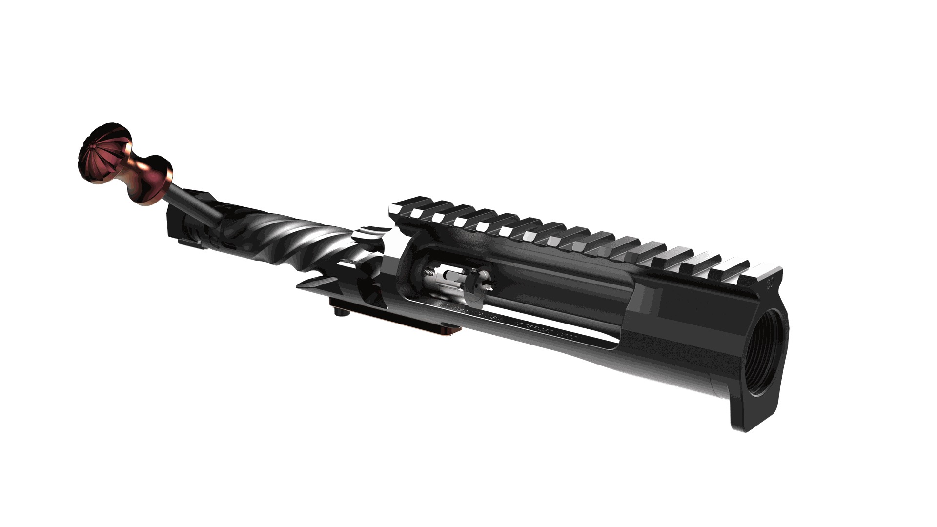

I don't think the barrel had a conical breech; I'm pretty sure the case head diameter is so large the ARC spec for the cone is small than the opening in the breech face.
There would still be a good amount of conical breech face, believe it or not. While it is indeed not necessary for the larger diameter calibers, the conical breech face actually works to capture the nose of the bolt face once the action is closed.

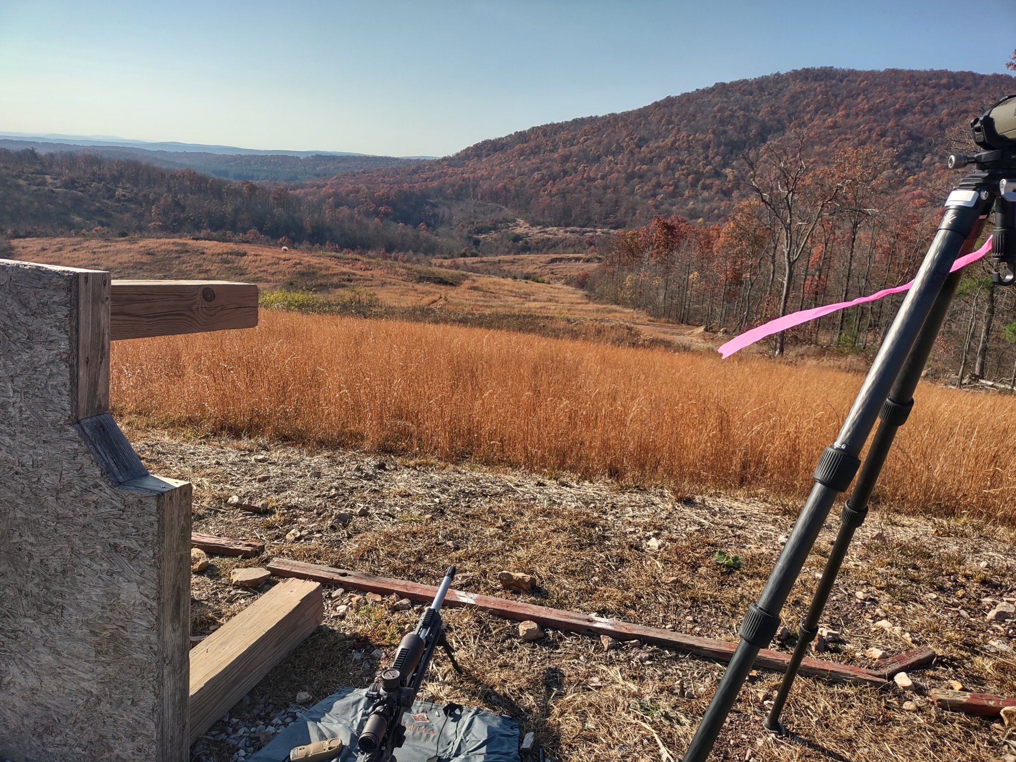

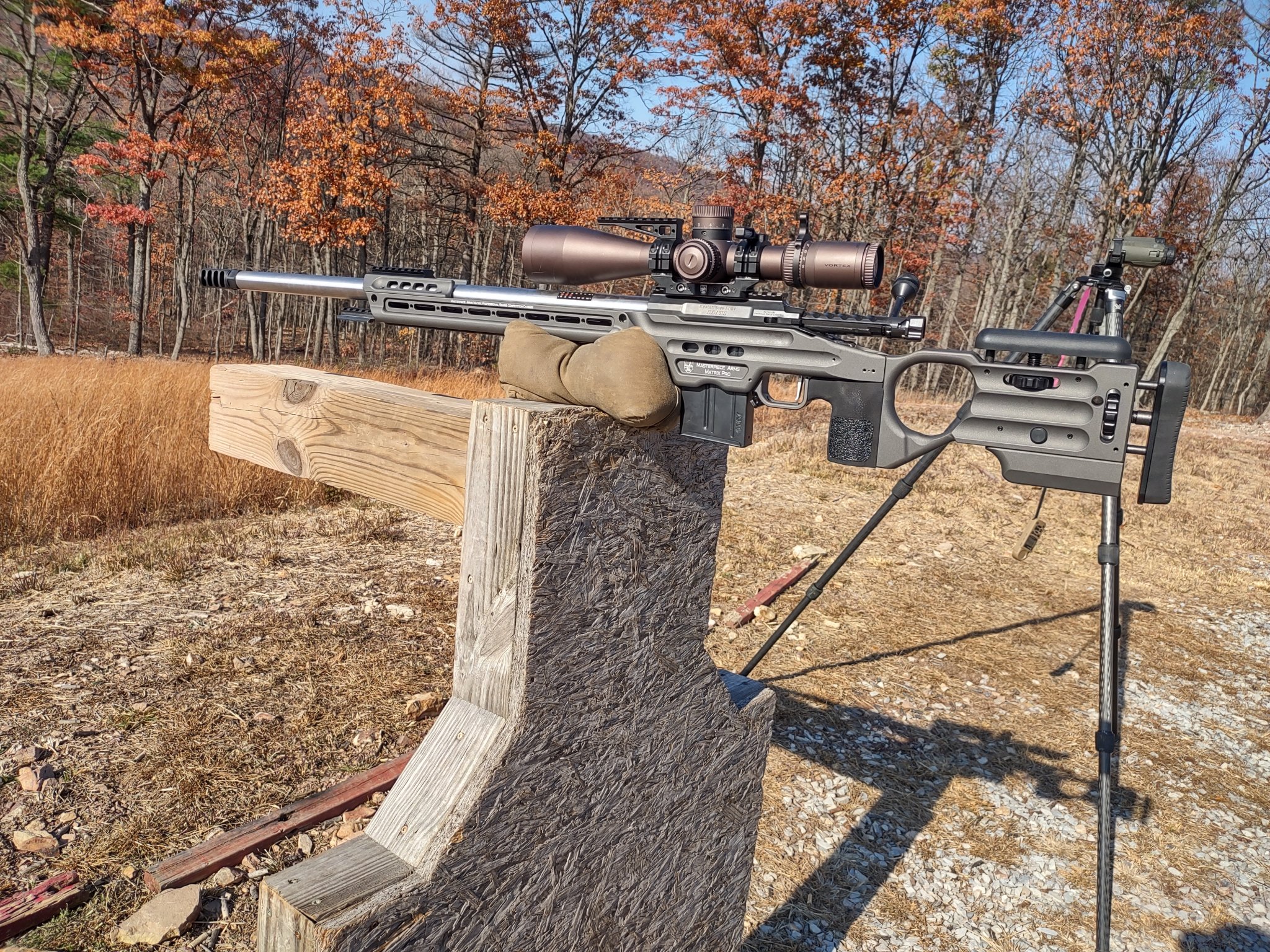

Took the PMR out past 1000 and broke the 2" plate at 430(woops).
This action is super smooth, I definitely missed when I ran out of ammo more than a few times.

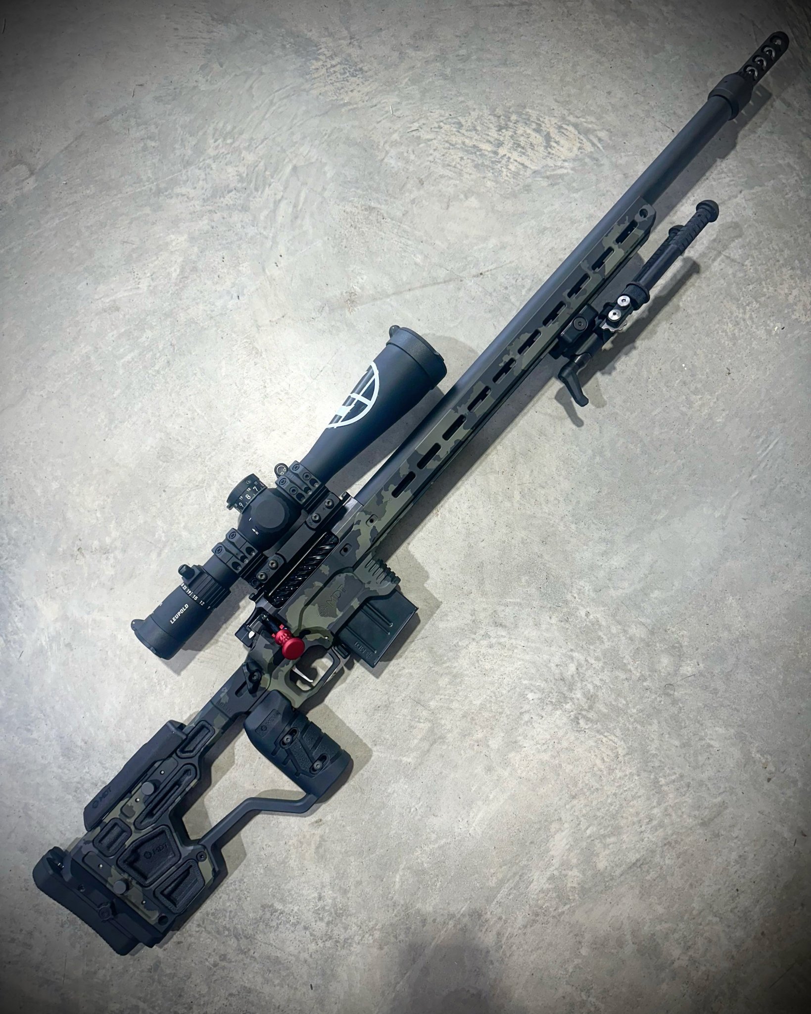

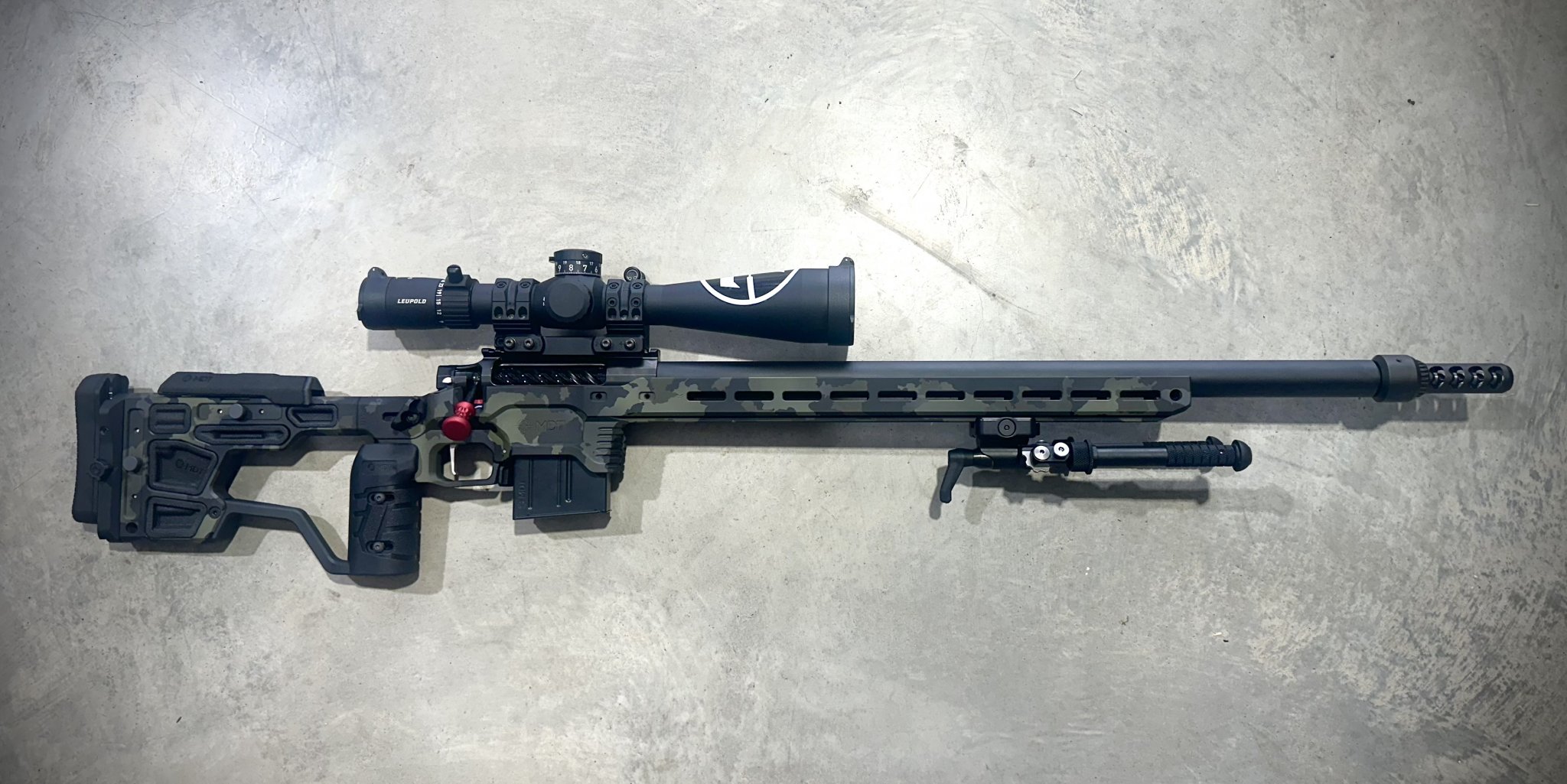

Heres a somewhat current build. Few things have changed but I dont have a super current photo.
CGD
PVA 26" Osprey in 6GT
KRG C4 (full weights though now have heavy angled bag rider)
T6xi 5-30 SCR2 (currently Razor GenIII)
ARC M-brace
A419 Hellfire Match (though now has TMB)
TT Special 2 stage flat
Atlas Cal
23lbs with the bag rider, T6xi and hellfire.

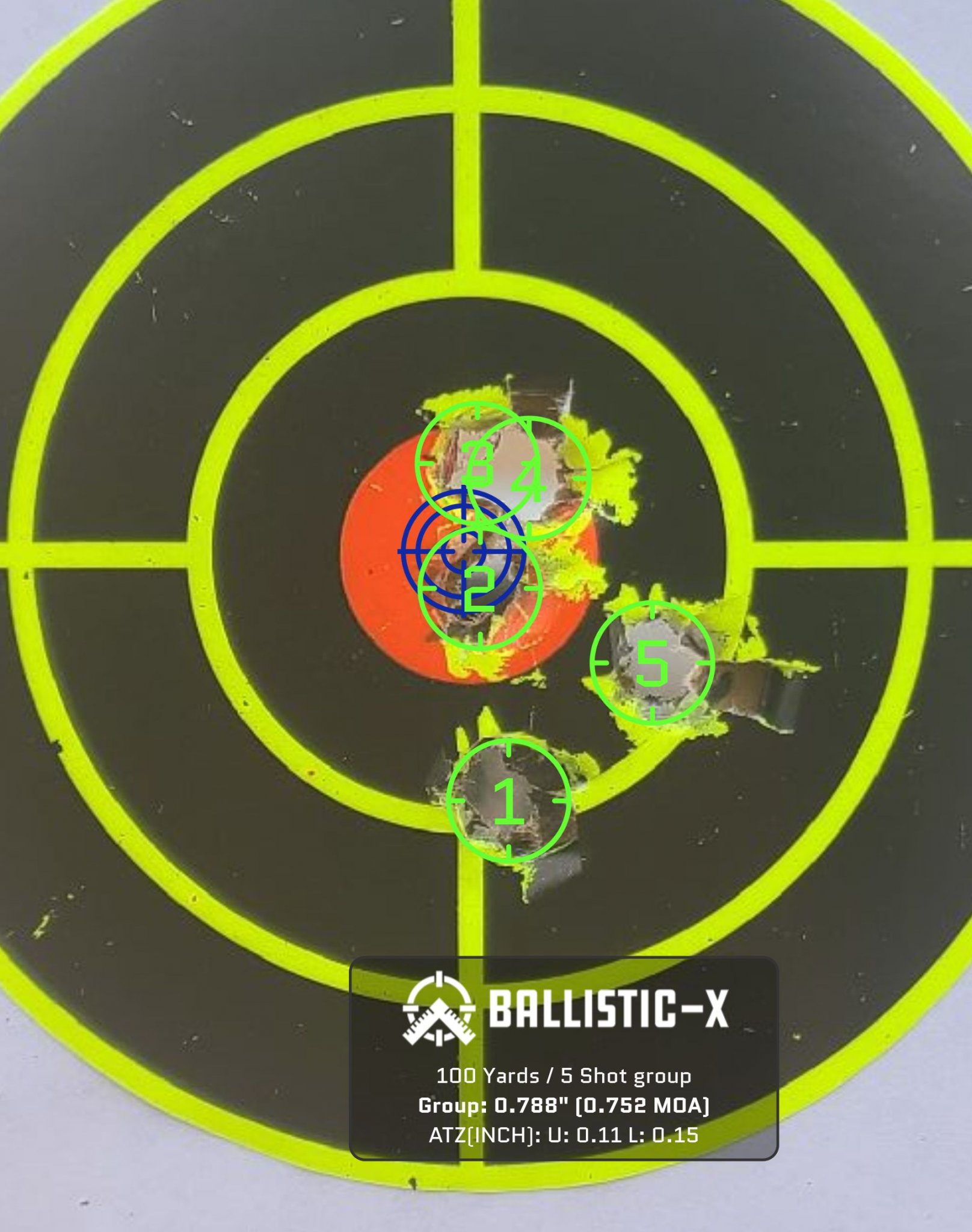

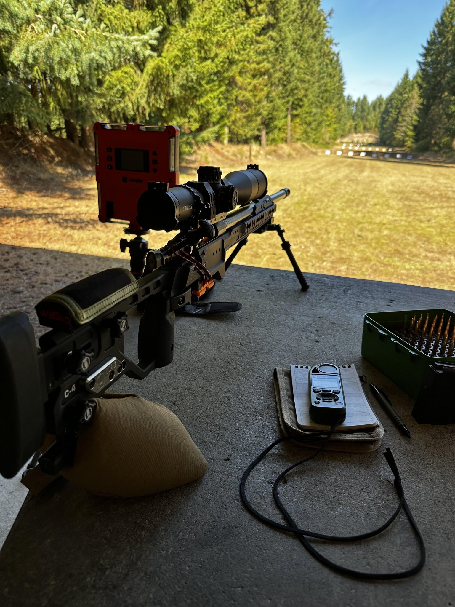

Got my CDG out this morning, doing a little coyote hunting.

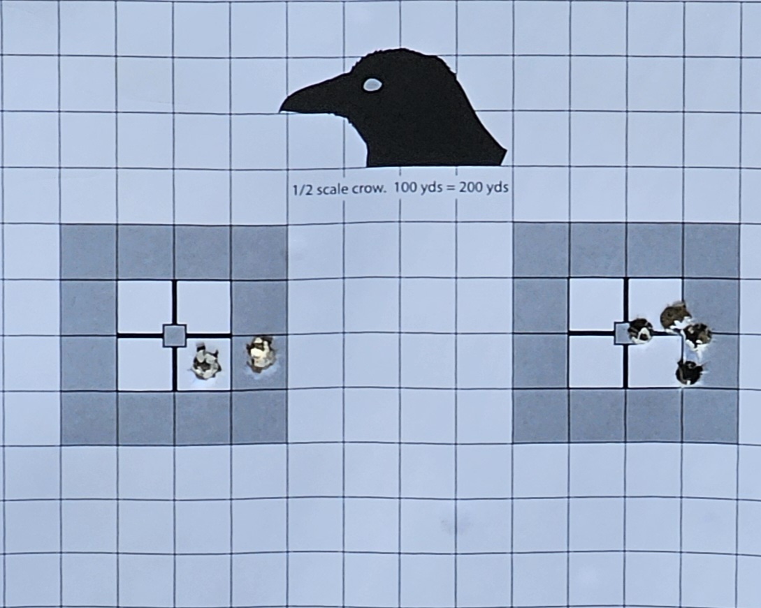

Interestingly, I did my load work up, then came back to verify zero last week. 6mm Creedmoor with the barrel from PVA. Hornady Factory 87gr VMAX does around 2975fps. My 87gr VMAX handload does 3145fps. But, at 100 yards, POI is basically the same. I am new to the bolt gun world, but I don't think I've had this happen before. 2 factory rounds on the left, 5 handloads on the right.

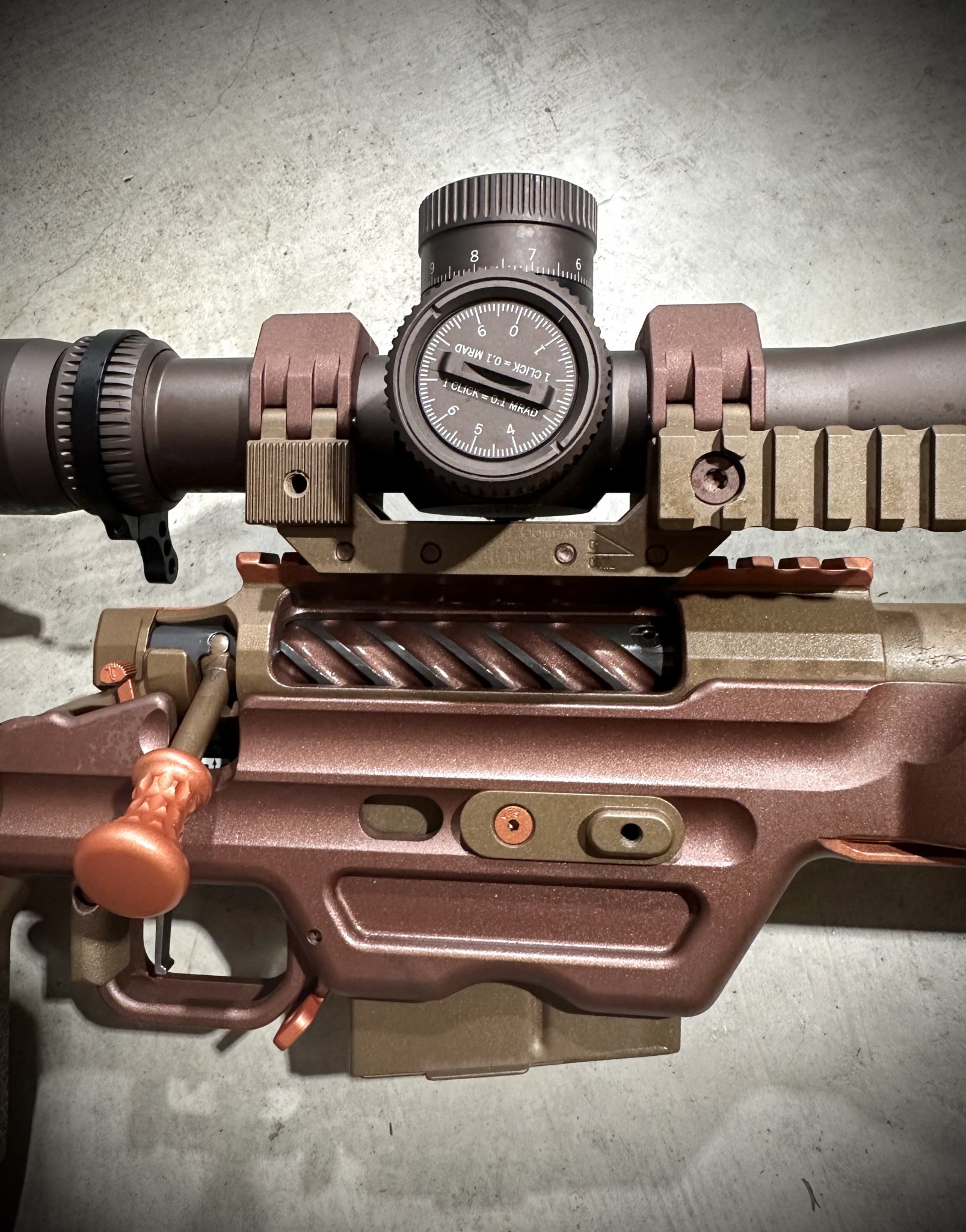

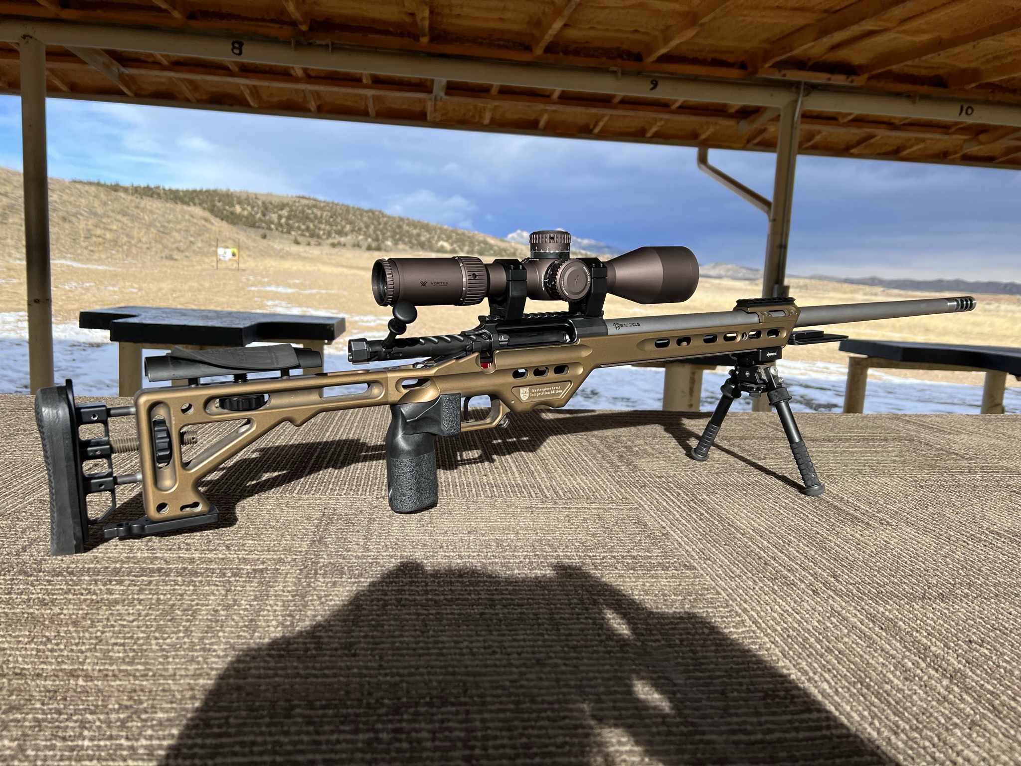

Finished up mine last week and did some minor barrel break in and load work. Took it out today to zero the scope with chosen load, really liking this rifle!
Here’s the details:
CDG SA fixed bolt
Preferred Barrels prefit in 6.5x47 Lapua 1/8 twist 26”
Triggertech Diamond
MPA Chassis
Vortex Razor Gen ll
Here’s the details:
CDG SA fixed bolt
Triggertech Diamond
MPA Chassis
Vortex Razor Gen ll
