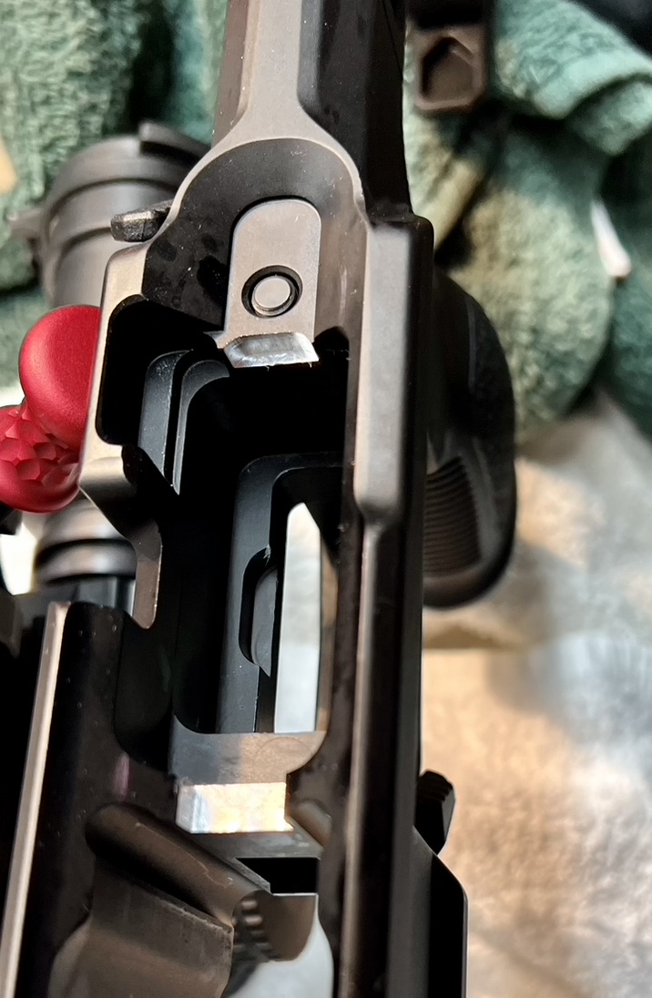

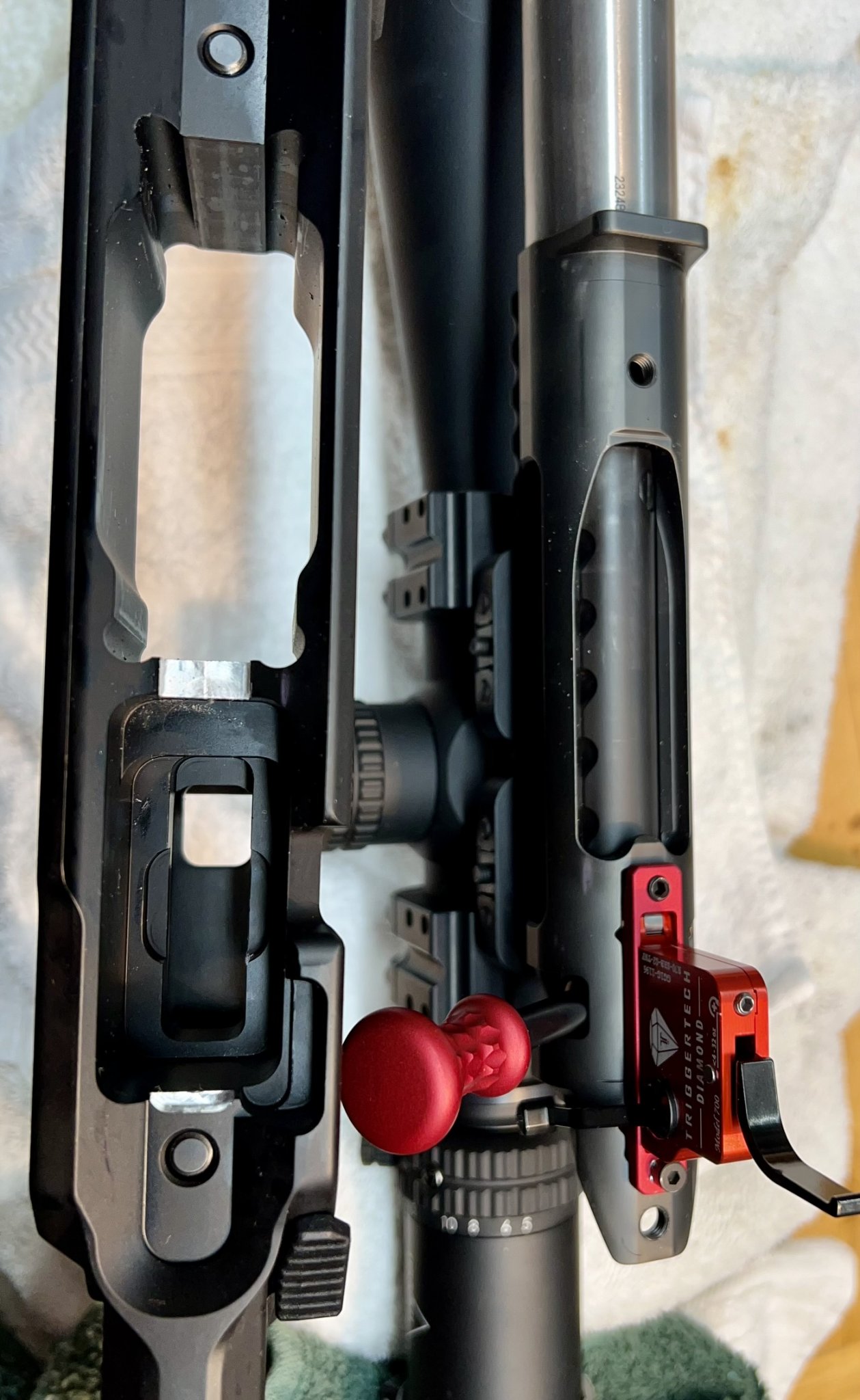

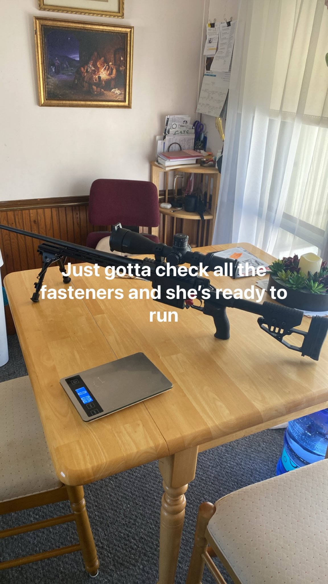

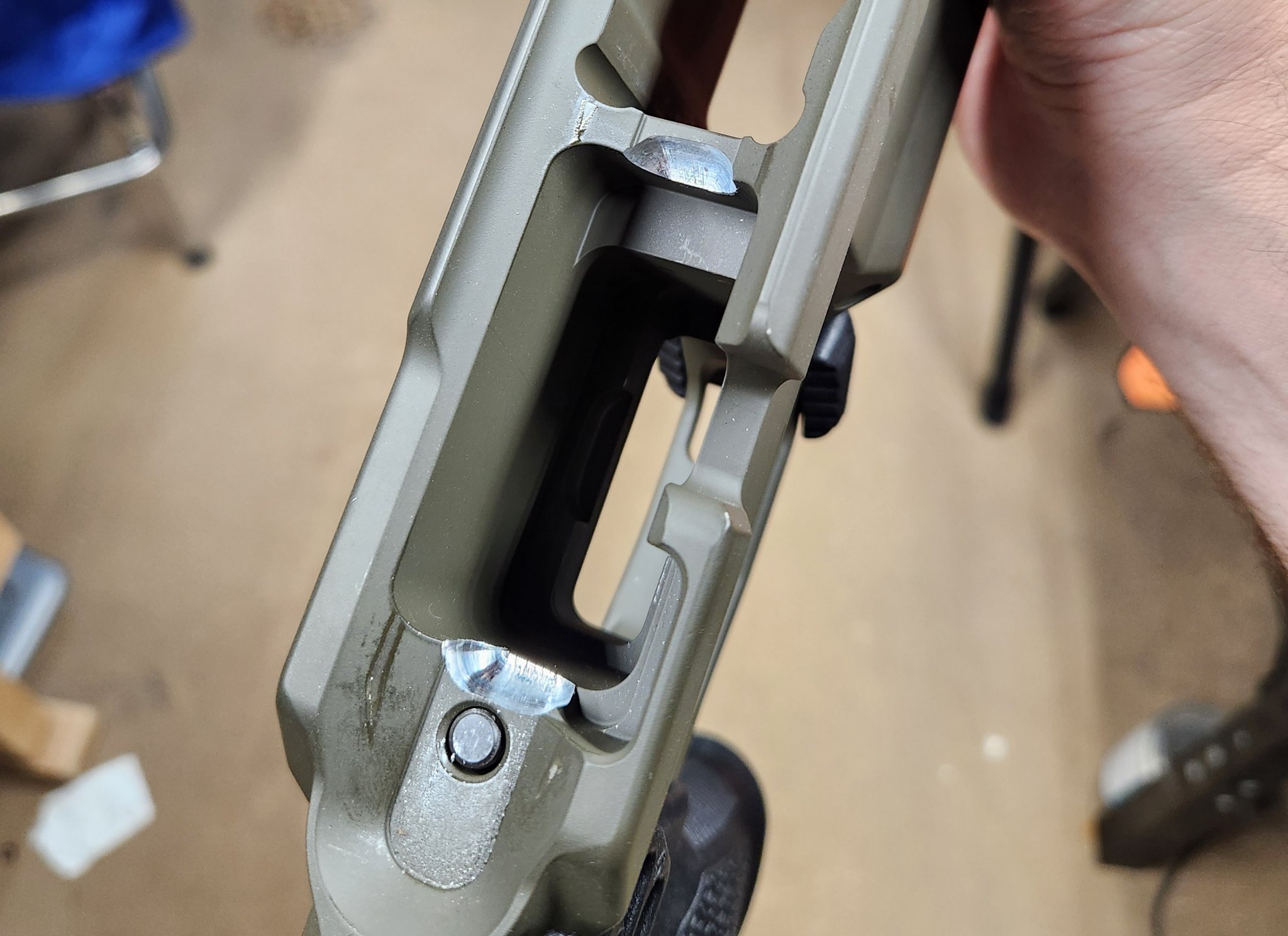

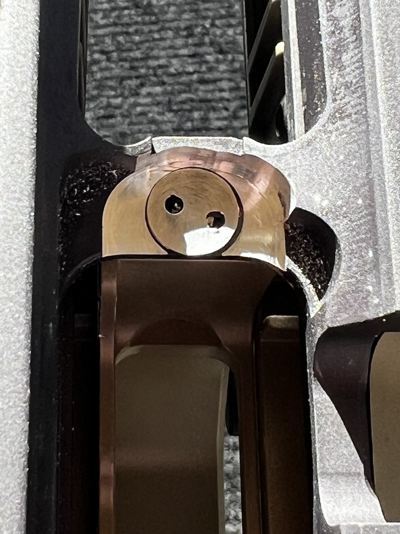

Decided to put my 6BR CDG in an Aero chassis. The trigger hanger required some relief cuts, see pictures below. I'm still working on magazines. The AICS feed fine, but cannot be locked in even with full adjustment of the magazine latch. I am currently looking for an in-stock AIAW magazine.

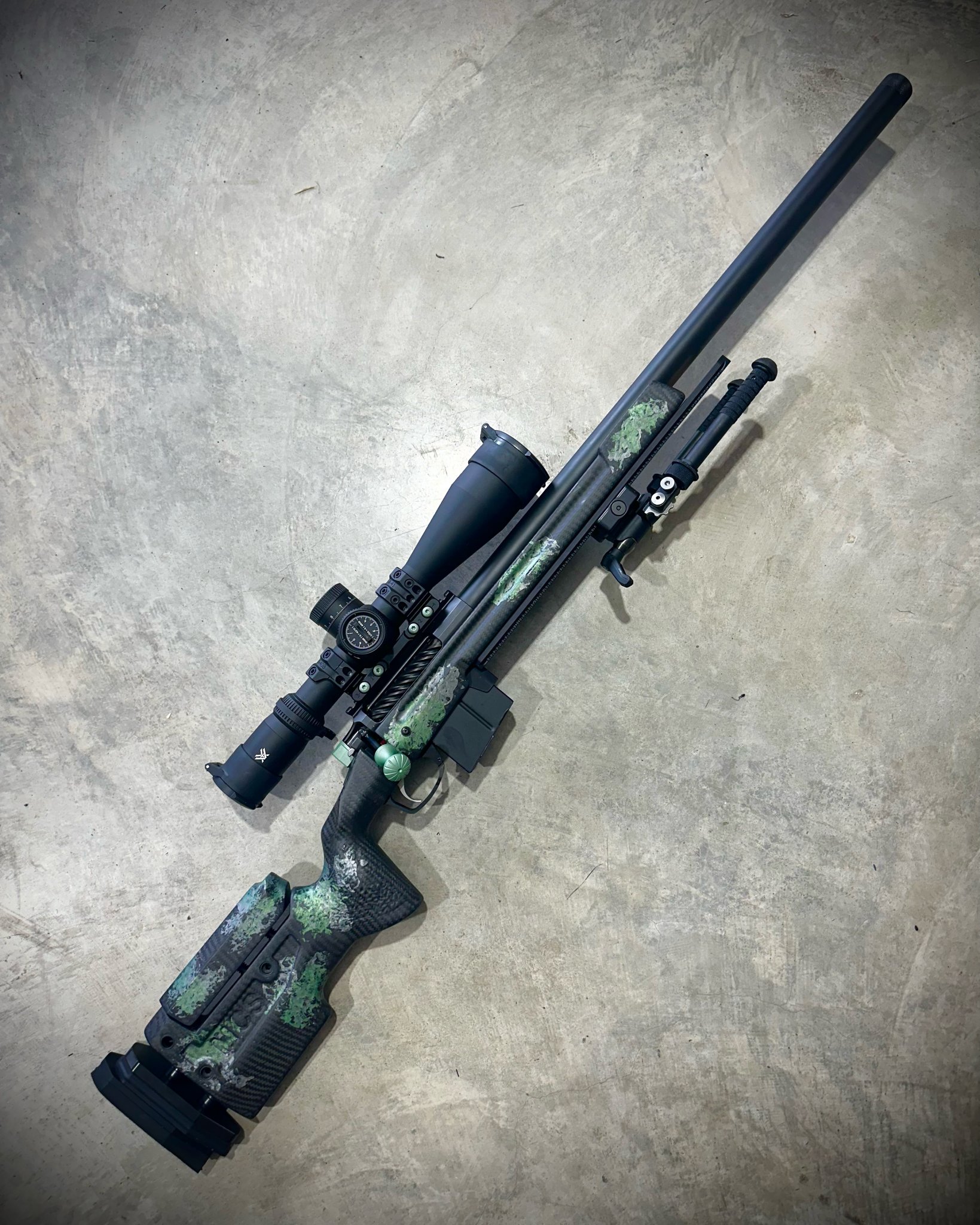

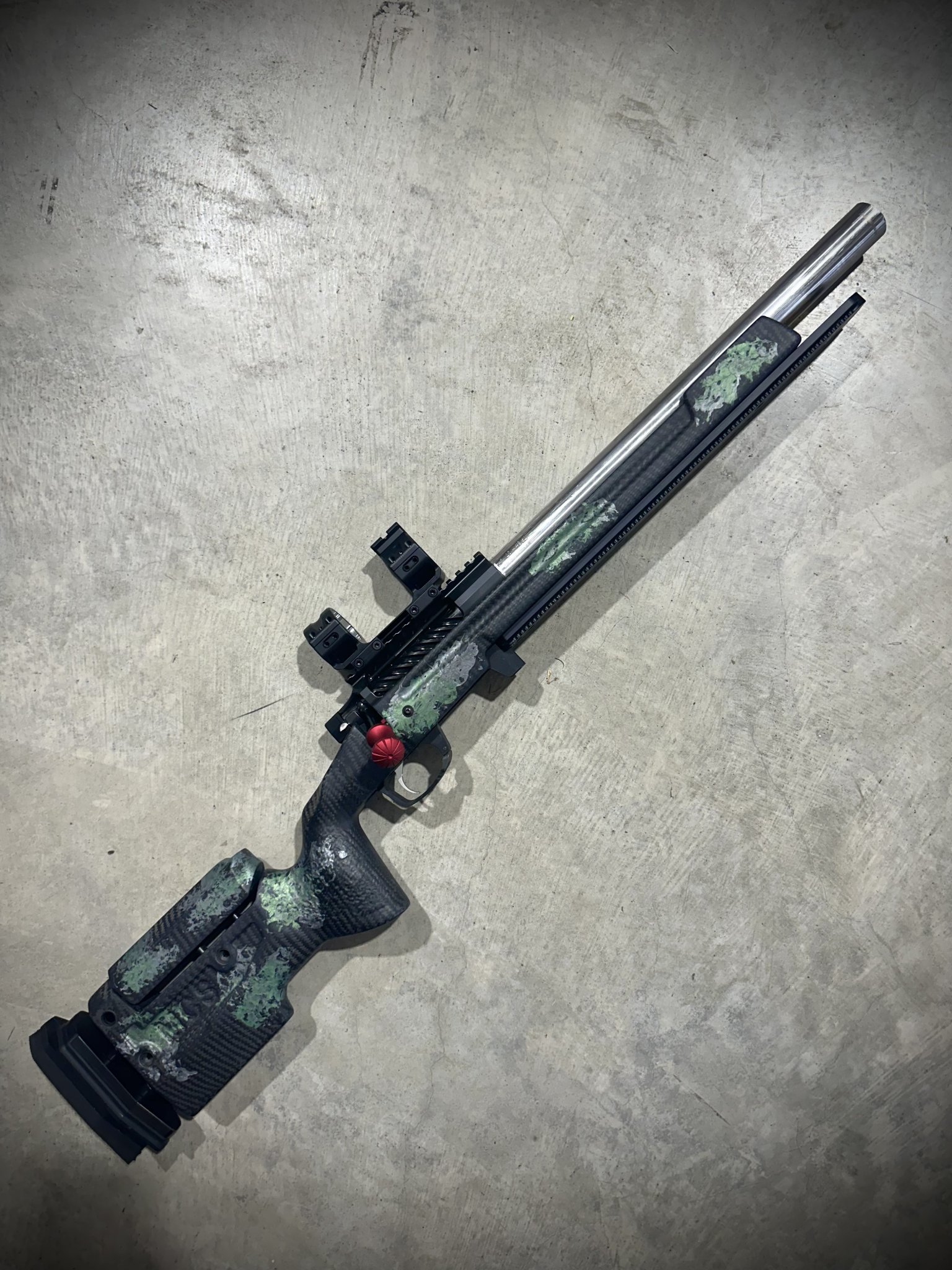

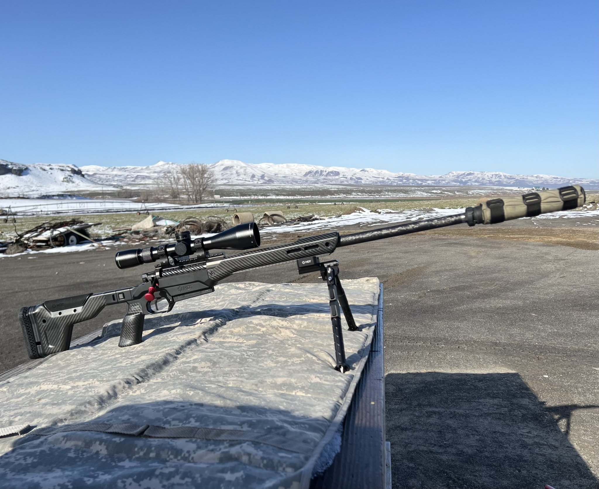

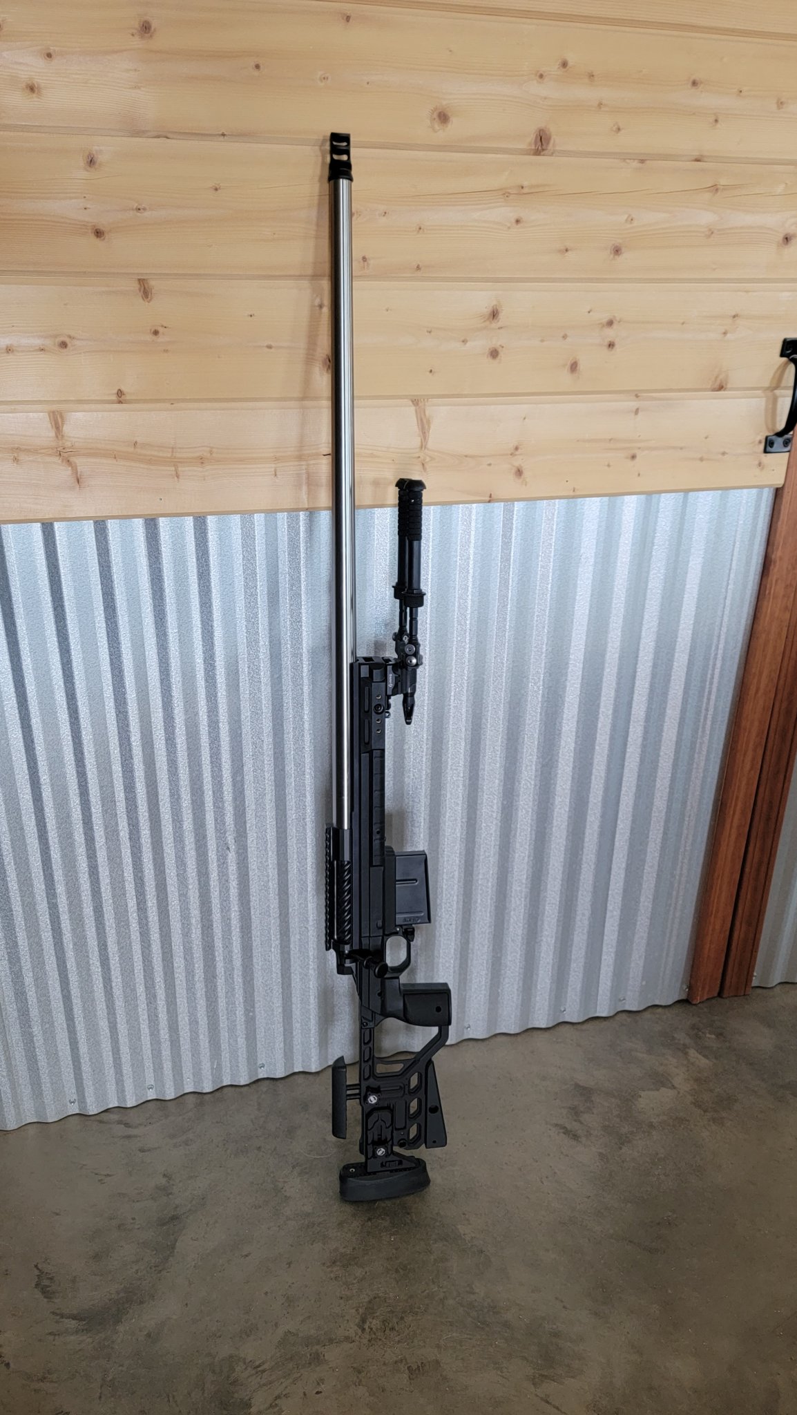

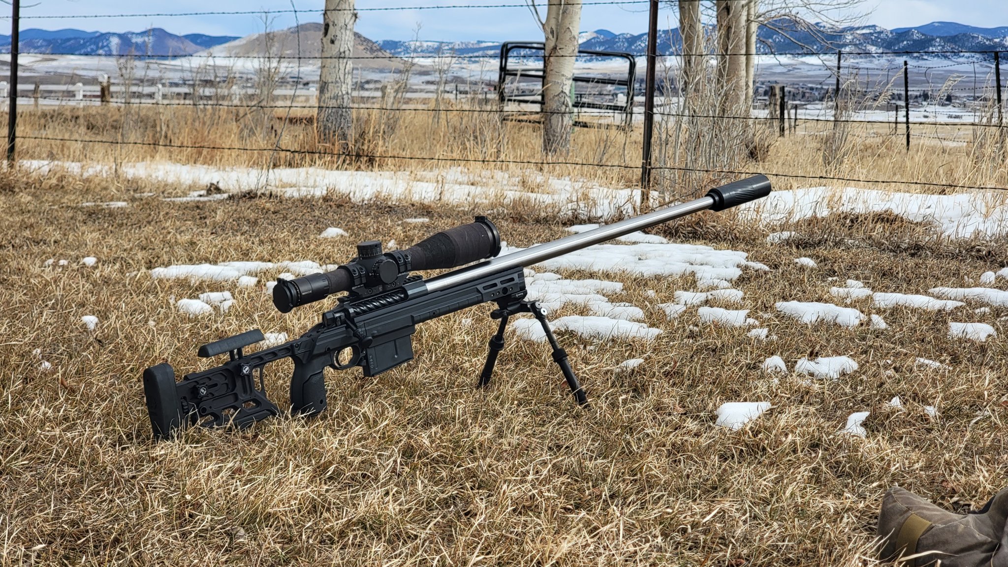

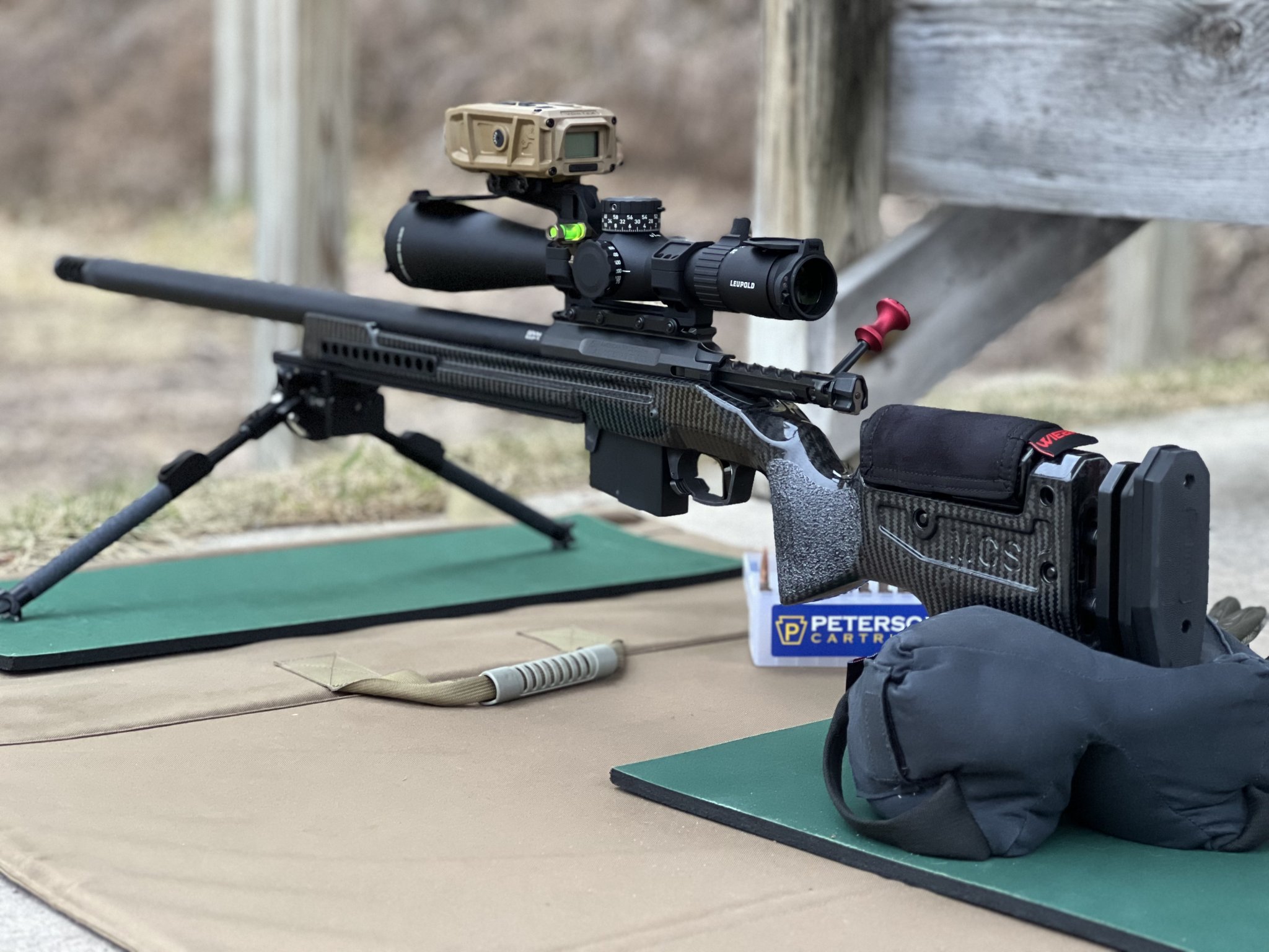

Here's My nearly complete CDG build.
My goal was a Sako M10 "At home". Still needs paint.
CDG Long action with 30 MOA pic rail
30" bartlien 1:9T 30 call barrel chambered in 300 Norma Mag
KRG W3 (still waiting for Next shot precision to release the LA Alpha forend)
Trigger Tech Special
Atlas Cal

How does she feel/cycle.
I’m looking to do the same thing.
Simplest way I can say it: the action feels a lot like a Seekins PH rifle, Absolutely zero cock on close which makes it feel much more expensive. The travel is more "creamy" than "buttery". It's a little odd running the bolt all the way back waiting for the hard stop but it never happens.
I'll shoot it tonight. But feeds great out of the mag. I coned the breach face so I'm sure that helps...

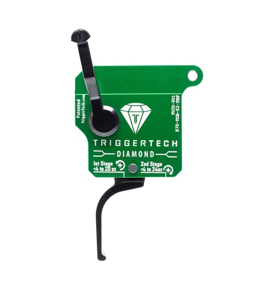

the two stage TT Diamond works great with the pivoting handle.
(y) Thanks. I was hoping that would be the case.
I have 2-stage diamonds in both of my CDGs. They're set nearly as light as they go and I haven't had any issues with them.
Purely anecdotal, sample size of two.
I appreciate the insight.
Another Diamond now on the way. This will be my first two-stage, however.

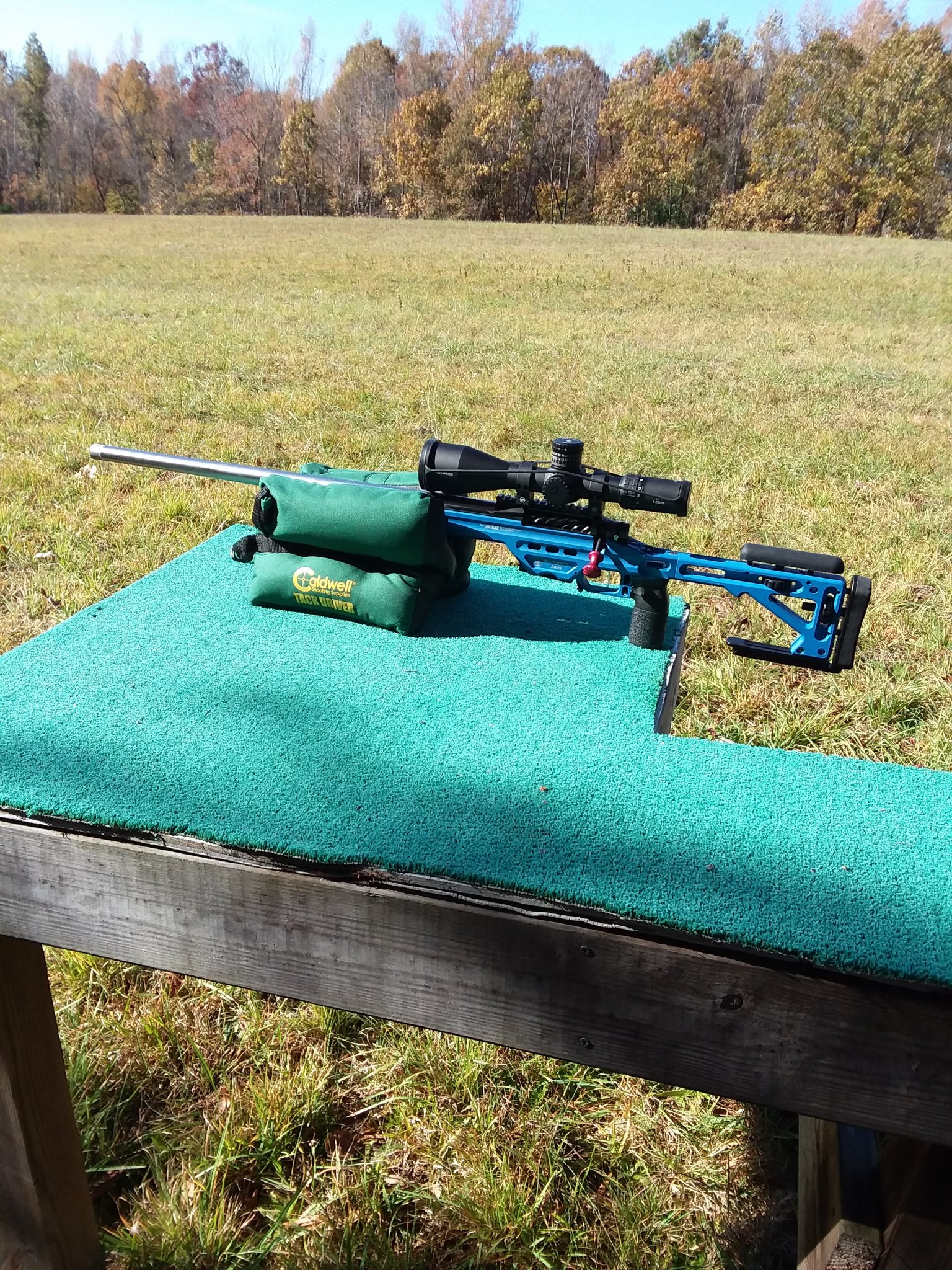

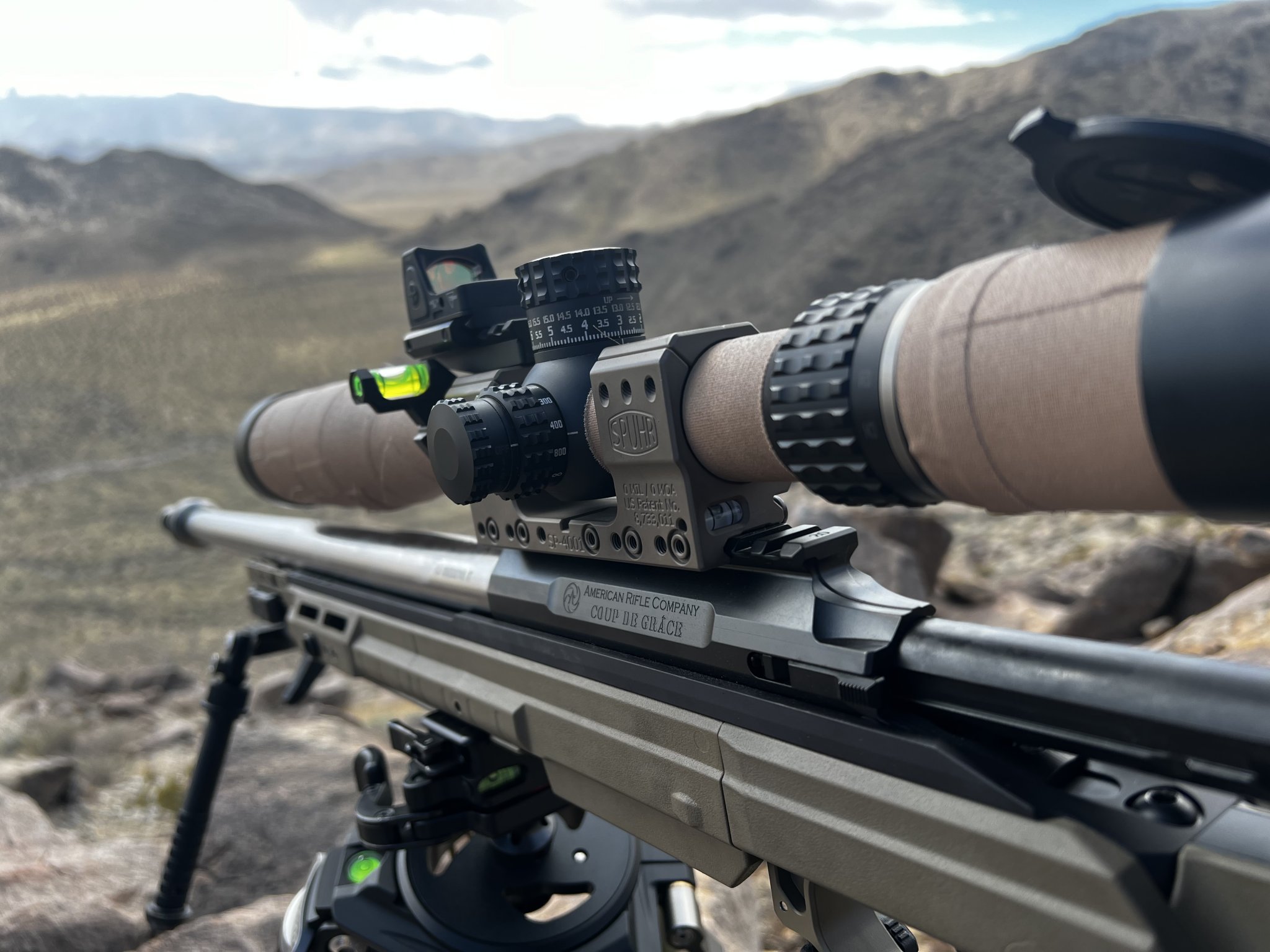

Just assembled my CDG in a MPA BA Comp chassis with a PVA MTU contour 223 barrel. I just finished cycling some 77gr factory ammo through the action. I ran 50 rds through it very slowly where it would just pop up out of the feed lips and then slowly push round into chamber. I had zero issues with all different speeds of cycling the bolt. I ran a few so slow that i watch the bullet slowly go up the feed ramp, pop out of the mag and then slowly into the chamber. Had to adjust the mag latch to get the accurate mag to seat, and also the night vision bridge will not fit with the MTU barrel, but has clearance in forend.
Good to know about the bridge & MTU profile.
I'd be interested in seeing pics of your rifle if you had time to post them.
My MPA BA chassis with a MTU barrel has clearance with the night vision bridge. Less than the chassis, but about .050 worth of clearance.
Edit: went and rechecked my barrel. It’s a M24 not a MTU, which would explain the clearance. Being a tad smaller at the muzzle and starting the taper a bit closer to the action allows it to clear.

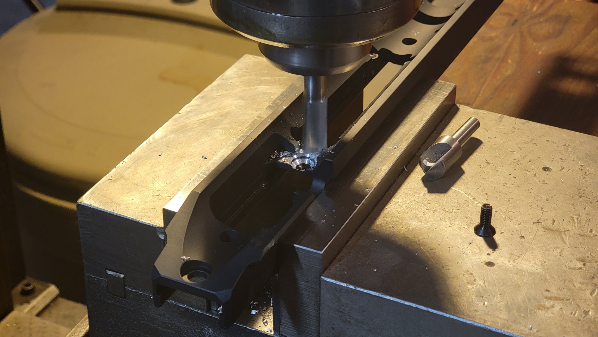

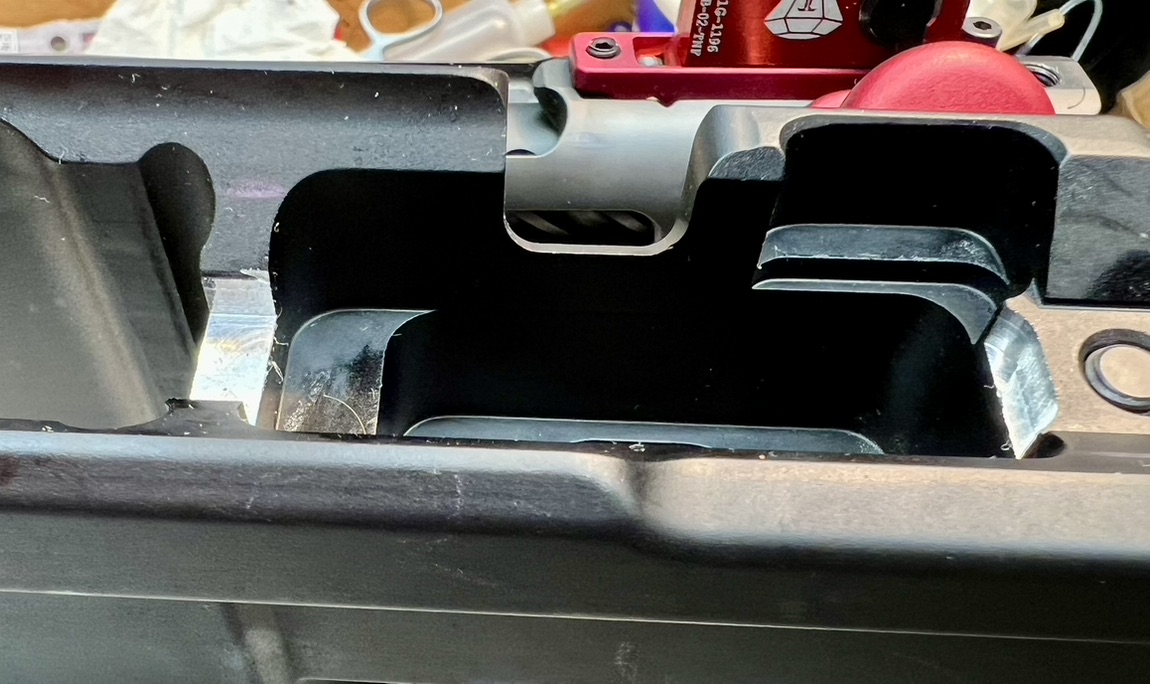

Got the barrel for CDG #1 spun up and coated today. 24" Proof Heavy Palma in the Solus chassis until I decide what it's going to live in. Did have to clearance for the front and rear of the trigger hanger.
Do you have any pictures of the work you did to clear up the trigger hangar? Currently, trying to figure out which chassis I want to go with.
I went a got the NV bridge out and tried to put it on, i could probably use a .005 shim and it would fit. Touches on the rear of the bridge. slightly clears on the front
I was incorrect in my post (did an edit) mine is a M24. I recall now the guy I talked to at Preferred Barrels asked me what chassis I was going to use and recommended the M24 over the MTU. It was a while back, senior moment!

OK, got back to the hanger tuning. I tuned it so it would barely be off contact on the uplift. I was able to set the trigger to 14oz with no fire. Added a couple more ounces to make my 1lbs pull and all is well. So, there is a correlation between setting the hanger and trigger pull. OK, just need my barrel from those pirates at PVA! :ROFLMAO: (Benchmark 26" burnt bronze metallic cerakote, 6 straight flute, 708AI)
Still have the same opinion? My Diamond single stage just over 16oz will cycle fine with my running it like a gorilla, and then 1 will slam fire. Curious if I need to make it heavier cock on bolt open.
