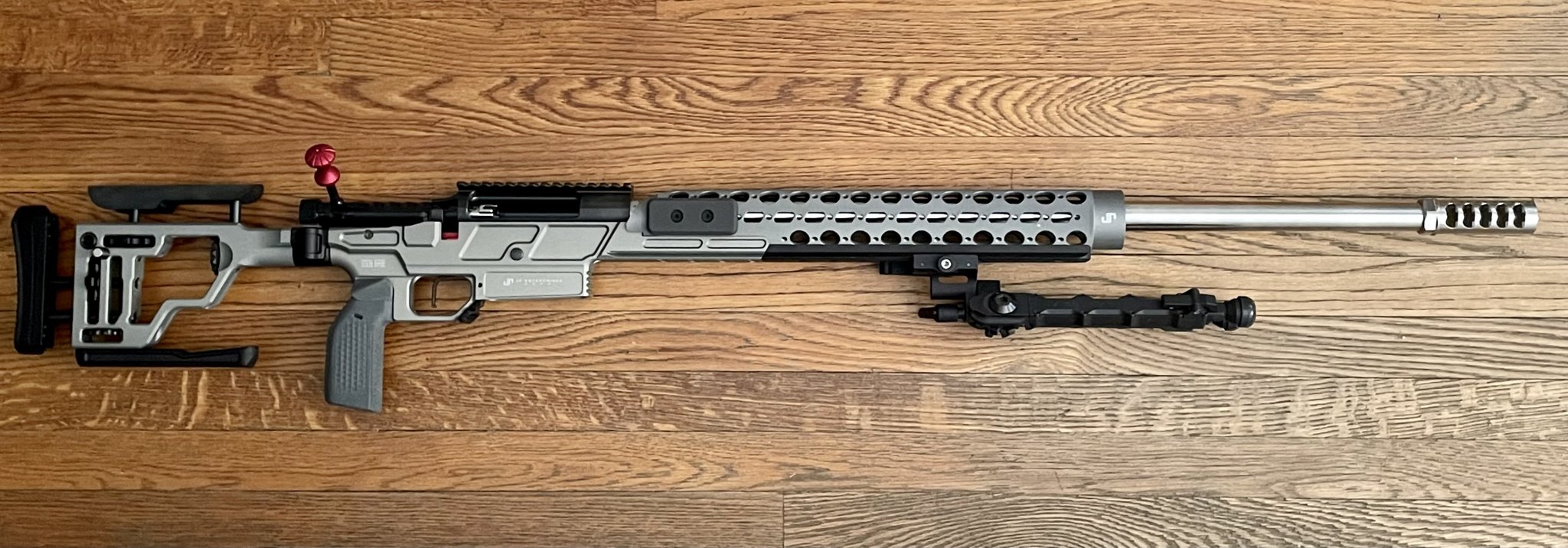

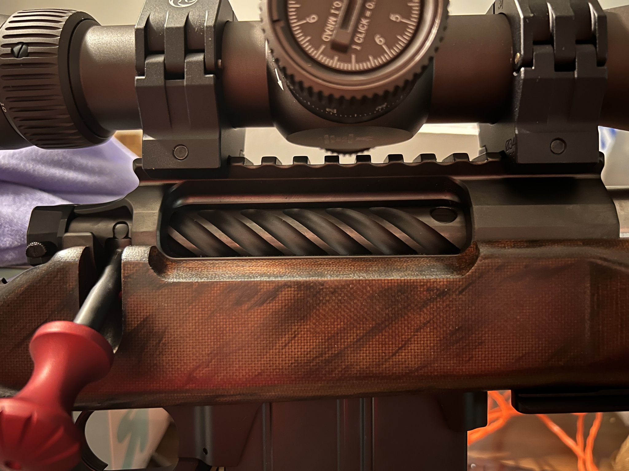

Took the .223 AI CDG build out today.
About 5 rounds to get the Gen III razor sighted in and the barrel to stop printing like a shotgun lol.
Then straight to 500, 700, 1000.
The CDG runs great if your not lazy with the bolt but it doesn’t feed as smooth as the .223 Impacts when side by side.
Also the brass is growing about 20 thousandths at about 1/4 up from the case head so where it will not chamber in our impact builds after fired from my CDG. The same reamer was used so that’s kinda weird.
Feeding .223 size cases definitely causes the action to hiccup if you do not run the bolt fast.

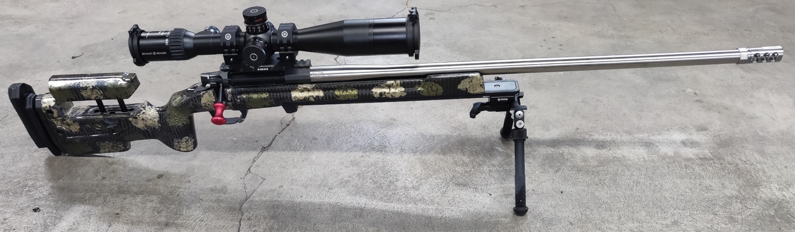

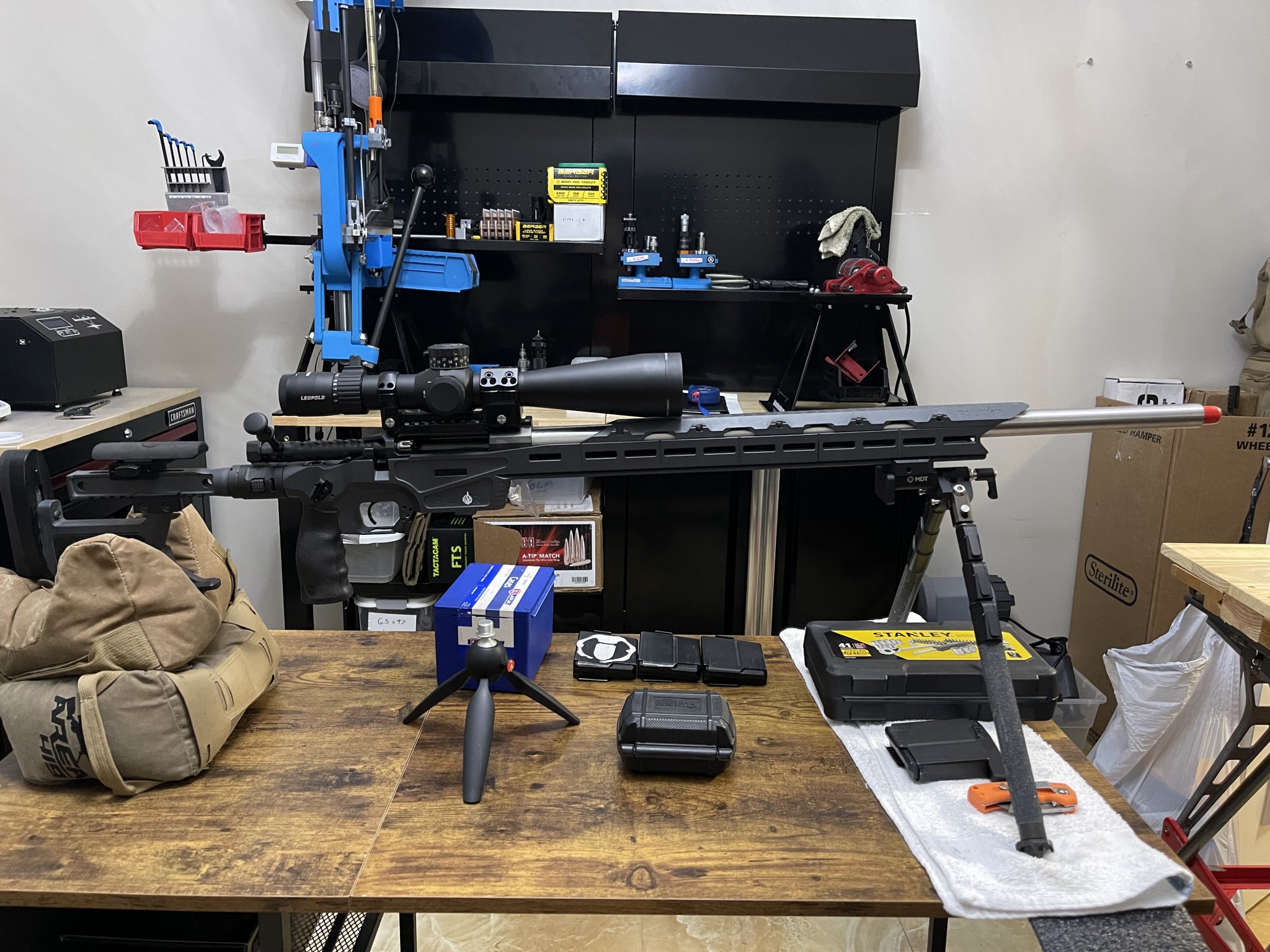

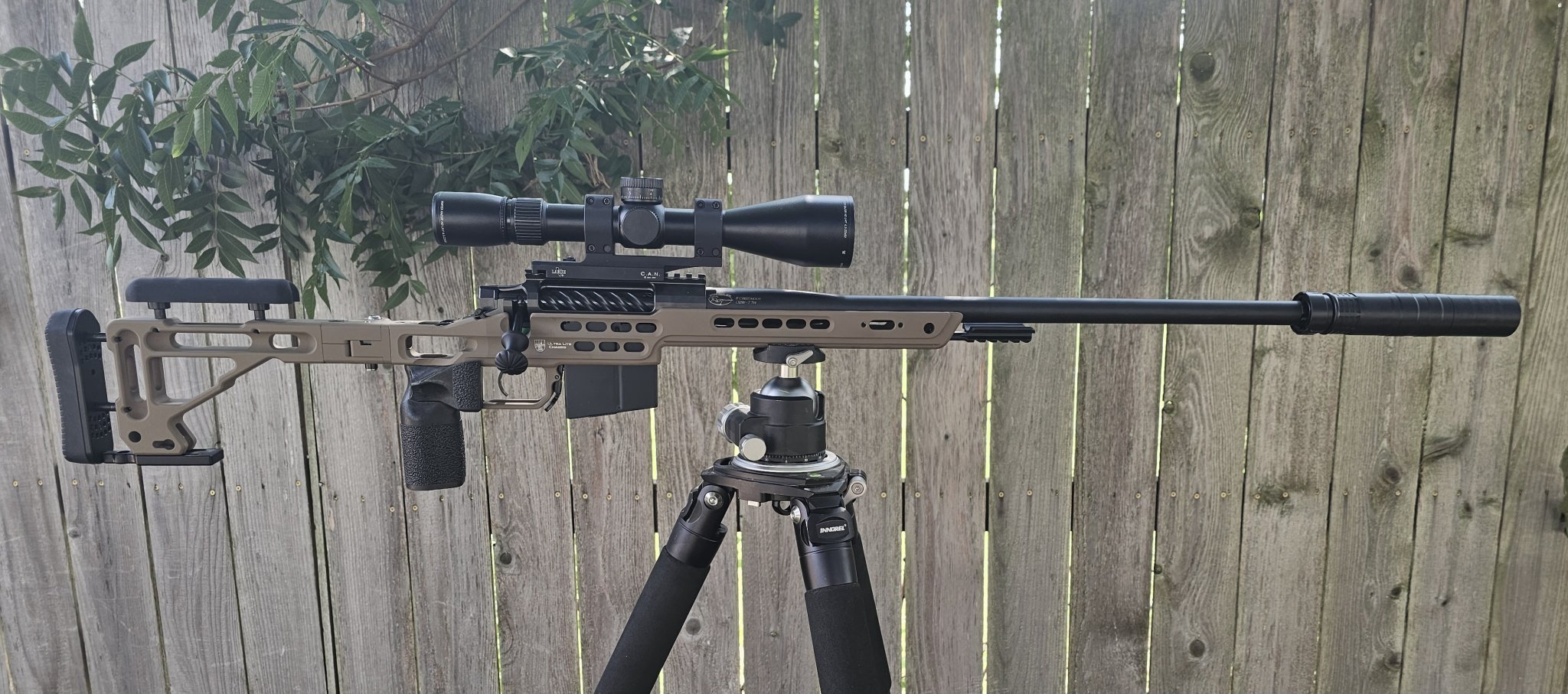

Decided I couldn't wait the 3-4 months until the Gen 3 Razor gets here from Liberty Optics July 4th sale, so tossed on my spare S&B 3-20 (which as of 30 minutes ago is no longer new in box) and loaded up some break in loads.
28" 22GT, Manners TCS in metallic GAP camo with gloss clearcoat, Bix tacsport 2-stage trigger, ARC mount, S&B 3-20. Going to be primarily used for long range varmint blasting.
While I love the huge FOV of the S&B 3-20 and the full length version has extremely good glass and a very forgiving depth of field, I wanted a thinner reticle and a bit more magnification for this build which is why I picked up the Gen 3 Razor. I'll roll with the S&B 3-20 for now until the Razor Gen 3 gets here, and if the Razor Gen 3 doesn't make me happy I'll probably swap it out for another TT 5-25 or finally break down and pick up a ZCO 5-27 or S&B 6-36, I haven't tried those two yet.
22GT feeds like butter from unmodded AW mags, which is good because with an HRD BR/Dasher spacer kit in the mag the rear spacer is too long for GT length cases and holds them too far forward so the case body rides on rib in the magazine and the bullet tips won't clear the front of the mag.
Hopefully get out and run the 50 lighter break in loads through it this week to settle the barrel, then start on real load development.
Also, I have to say that the SBR'd CDG in the HNT26 (way too many acronyms, sorry) that @evilsvt built a few posts above looks really, really cool.

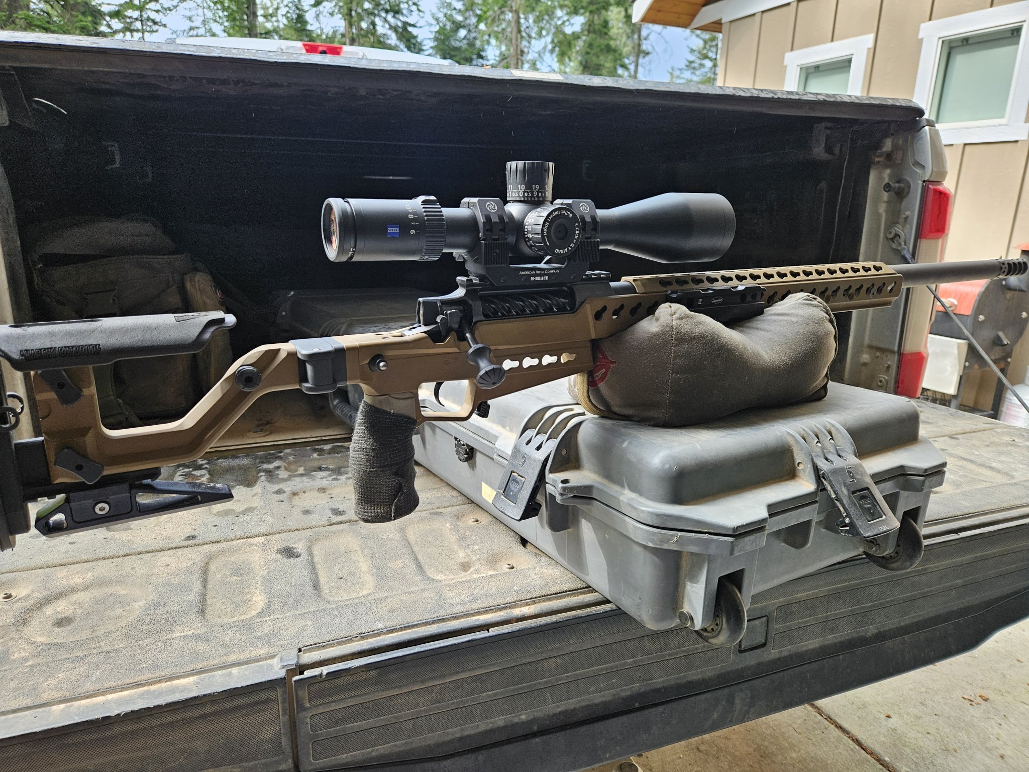

Got my PRS rig up and running. I have switched from Terminus Zeus quick change barrel action to the CDG. I also had my friend give the Matrix a new paint job ( RAL-8000). So far I am very happy. I had my barrel rechambered/ rethreaded for this action. I am shooting 6BRA. So far the groups are actually a little tighter and the barrel sped up after chopping 3/4" off ?? I had to reduce my load a little, bolt lift was little heavy. I very much disliked the ball that came with the CDG, it makes the lever way to short for aggressive/ sport shooting. I picked up a knob from Lumley Arms, which does not match, but i can always paint it.
As to compare the actions, the Zeus is extremely smooth and refine, but is a little finicky. It has been pretty good to me, but I wanted to make a dedicated PRS rifle and was looking to buy another action and the CDG seemed to be a fantastic option, that was designed for a AW mags and I like the idea of a control round feed. I am keeping the Zeus and have placed it into a Foundation stock.

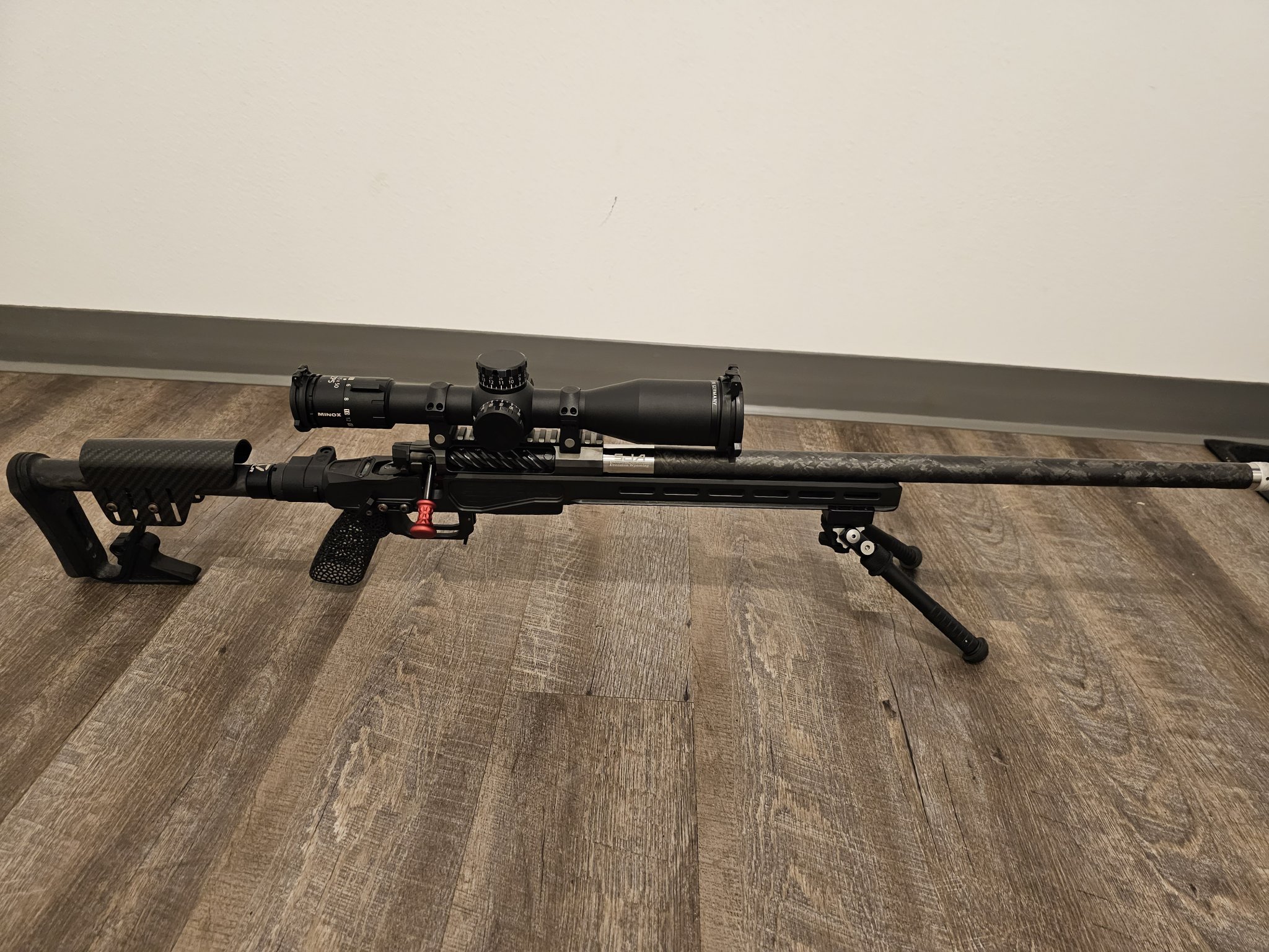

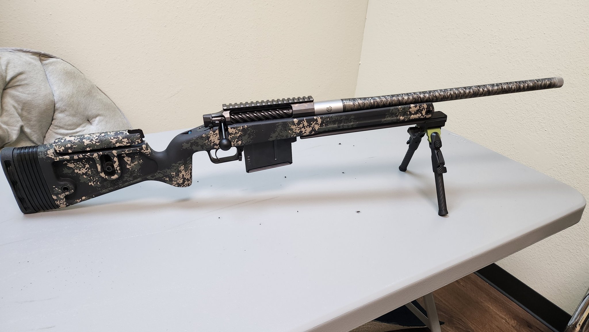

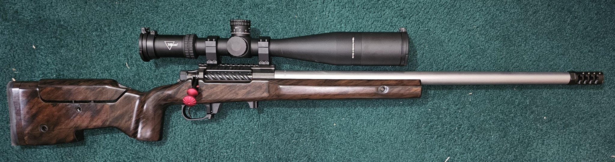

Finally got mine together.
CDG
22" PVA 6mm Creedmoor
Trigger Tech Diamond 2 Stage
MPA Ultra Lite folder
LaRue CAN Mount
Vortex LHT FFP
Rugged Radiant
Bathroom scale says 12.5lbs... probably closer to barely under 13lbs.
How’s your TT Diamond 2 stage feel running the bolt?
My good friend is cycling among a few top shelf 2 stage triggers and feels there is a definite perceptible difference between them.
Reactions: DubfromGA
I really can't give you a good answer. This is my first real bolt gun. My other modern bolt action is a Ruger American Ranch.
To me it feels fine haha. I had to ask another member to verify my work setting it up after watching the ARC trigger hanger video 20 times. I have a small amount of cock on close, but don't really think I can feel it in the handle. (Atleast I think it's cooking a little on close).

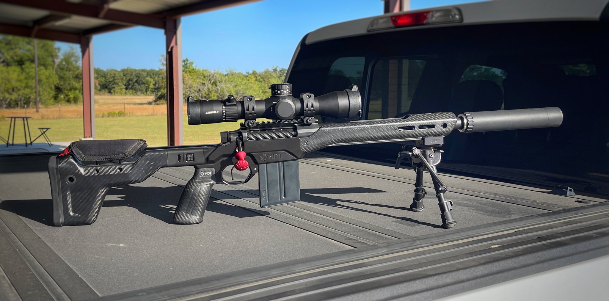

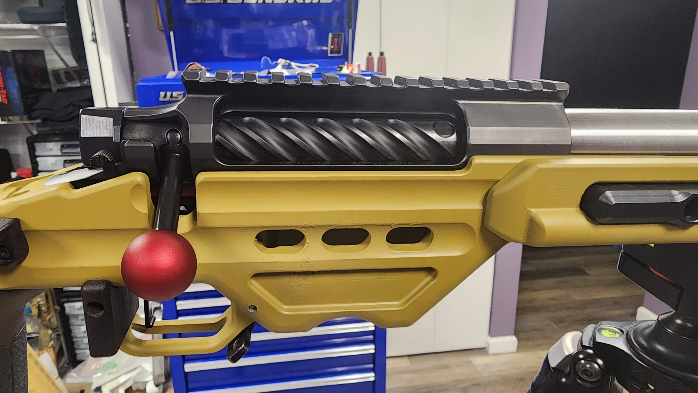

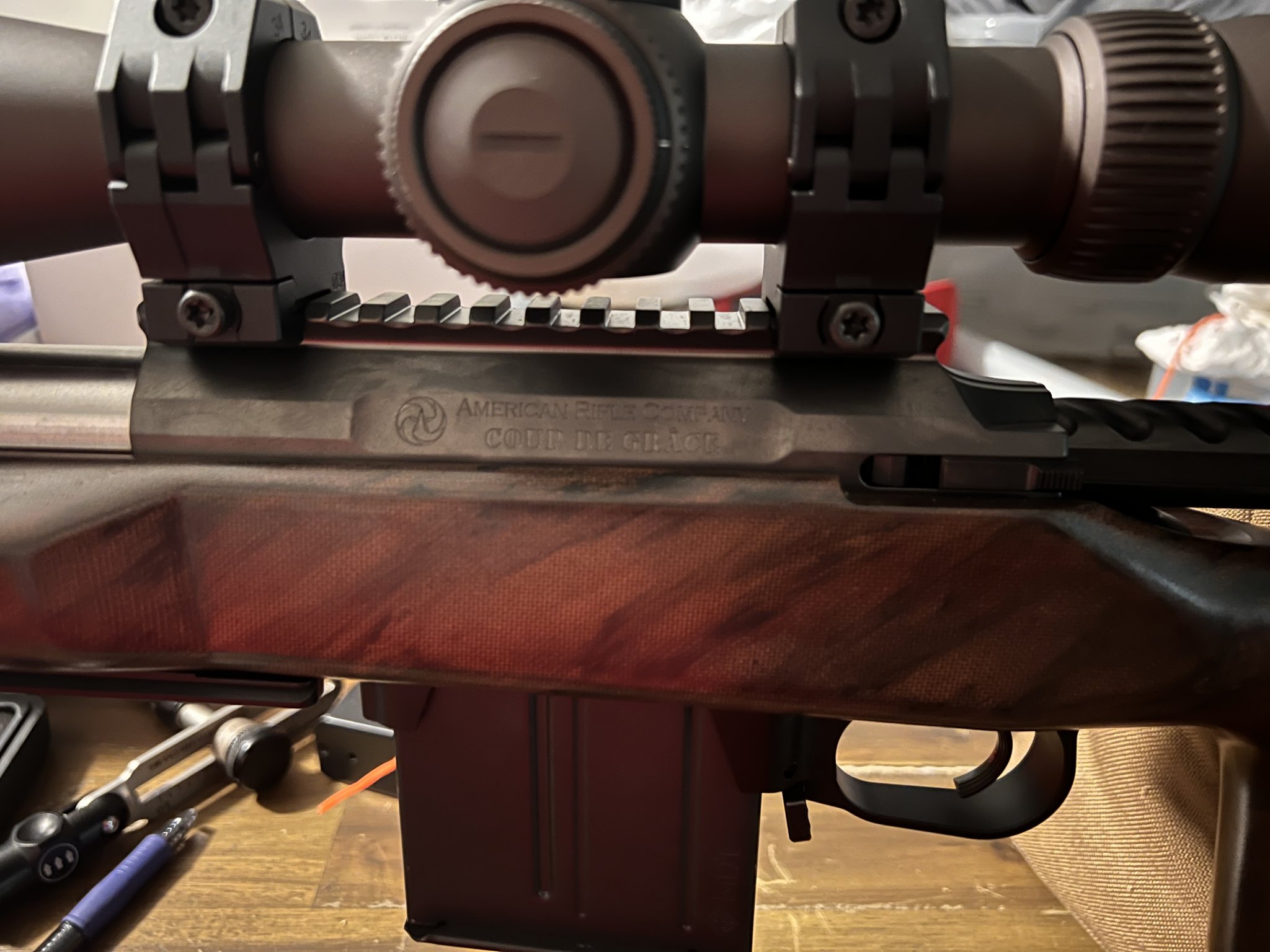

Still need to dig out a bipod and TMB for the muzzle, but so far not a bad combo. Scope is probably a temp as well. Action is really nice tho! Especially once you get the trigger timed. Will try the Falkor ROC, Matrix Pro, and C4 next so see what feels best with the CDG.View attachment 8196372
Damn that action looks good in the MDT ACC...

I’ve been running 22BRA with hrd kit in aw mags.Can run bolt fast or slow and feeds 100%.I had to tune mags some.Closed feedlips some.About .010 on both front and rear
How’s your ejection with the brass? I just put together a 22BR on the CDG and my brass is coming out between 1 and 230.

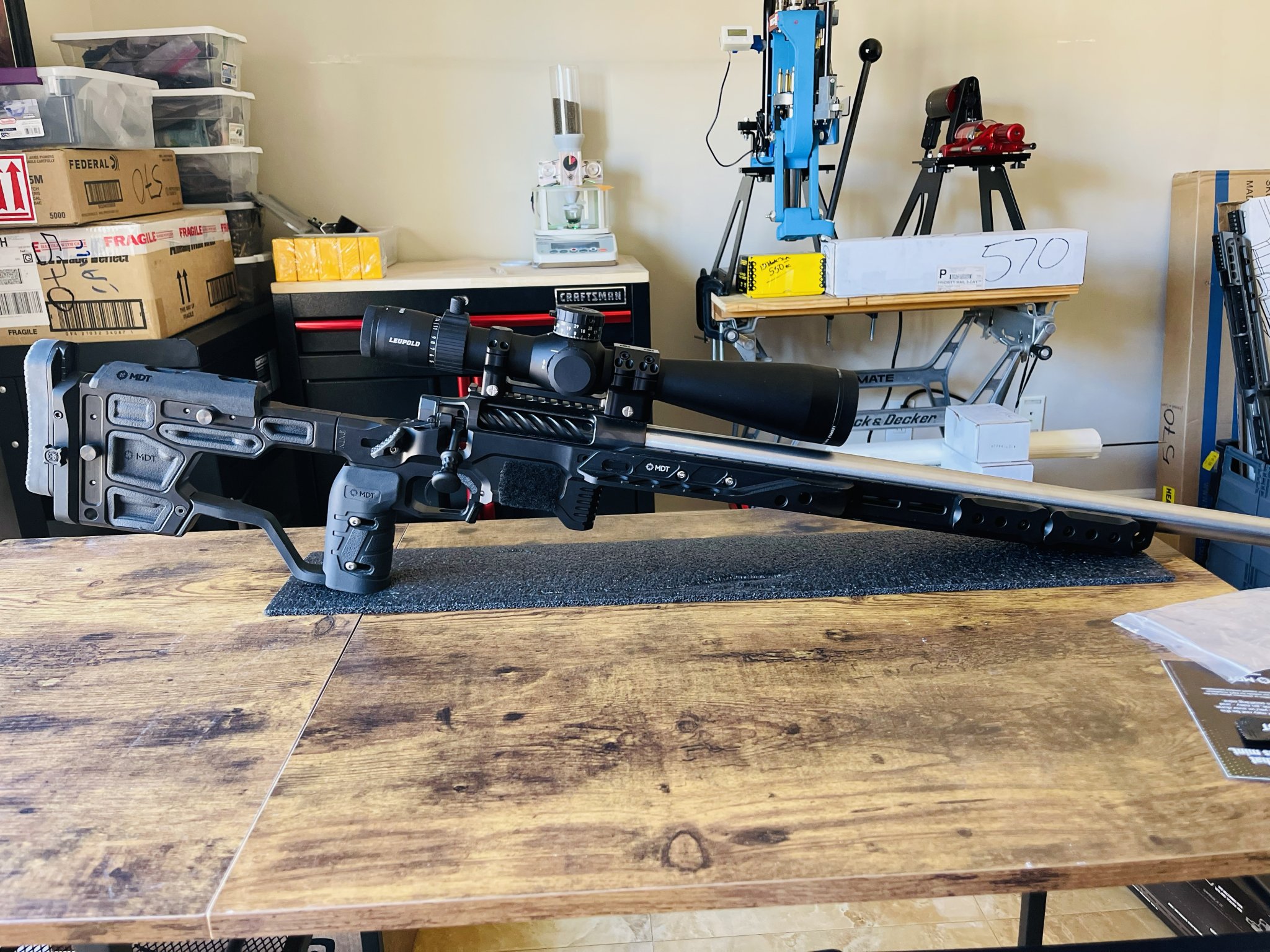

Thanks to all the SH friends who helped with their knowledge.
CDG SA, 6 Dasher, Alpha legacy reamer .154 fb, IBI Viking MTU barrel, TMB brake, MDT ACC elite, Flavio Fare‘ Veloce trigger. Zco 527 mpct1, Spuhr 6601. DST precision internal brass bar. Docter red dot, mv3 sendit. Hoptic USA mlok single round quiver. Mkm throw lever. @Obi-WanKannoli titanium Spuhr kit.
