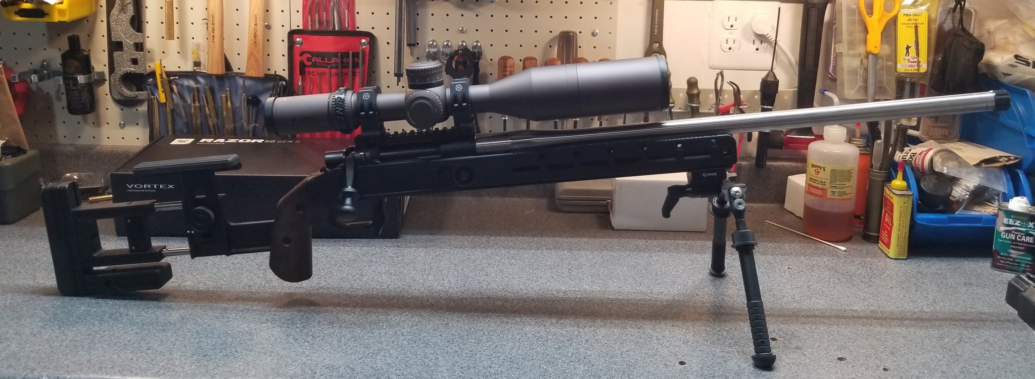

Current rifle setup:
Lefthand
Gen1 Nucleus (single digit ser#)
MPA comp chassis
(edit) 6.5creedmoor Prime factory ammo
I have 2 ARC mags both with LRI followers installed. These mags will not feed if there is any contact to the magazine at all, as in if you slap it in and then it hangs free it runs. But if a support bag or barricade or hand comes into contact with it you are done, bound up having to remove mag and then reinsert into the rifle. I have tried them with the ARC followers and it is worse only because of the nose diving and internal binding. I would say there mags not working for me personally has more to do with the chassis then with the action. I tested this out by moving my action to a manners stock and a KRG stock my two buddies had. I had better luck using the mags in those setups. My thought is the MPA chassis doesnt fit the mag as snug and allows it to tilt forward and back. causing failure to feed. I just ordered the MPA mag plastic insert to see if this fixes it. the 2 AICS mags I have run perfect in this set up, not sure if its the fact that they are longer and not double stack that is helping? but I can wedge these AICS mags into a bag or a PRS barricade and still feed the rifle. I am by no means a pro, haven't shot better than 50% in the PRS matches I have competed in, but dropping an entire stage do to failure to feed from the mag binding is a no go for me. In the style shooting I do the mag is going to end up in contact with something. Maybe I can use this as an excuse to purchase a Foundation stock...
I want to use them because they are so compact being double stack, I just cant trust them yet to be reliable. Anyways good luck just my experience.

Thanks to another member and a WTB in the PX I should have a couple mags in the next day or two. Will get a TMB from @rydah by April I hope.
Now for a break in the weather.
