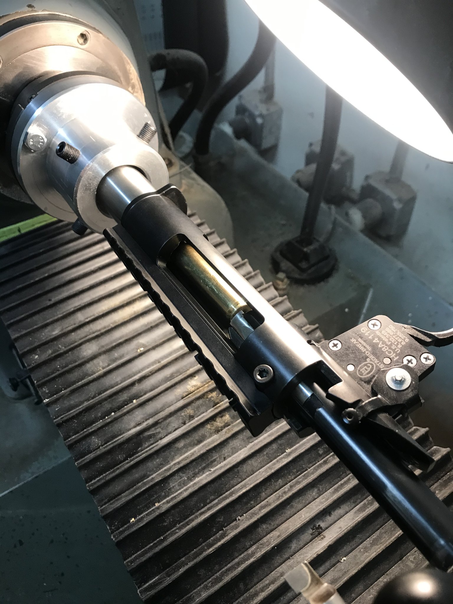

Any particular technique ? Just throw the round on top of the empty mag and slam the bolt ?
My 1000 yards practice range has mandatory single feed and I really hate doing it on my DTA and was hoping it would do it fine in the Nuke.
No issues in mine single feeding 6 Creed but .223 is a struggle owing to the smaller chamber and flat breech.

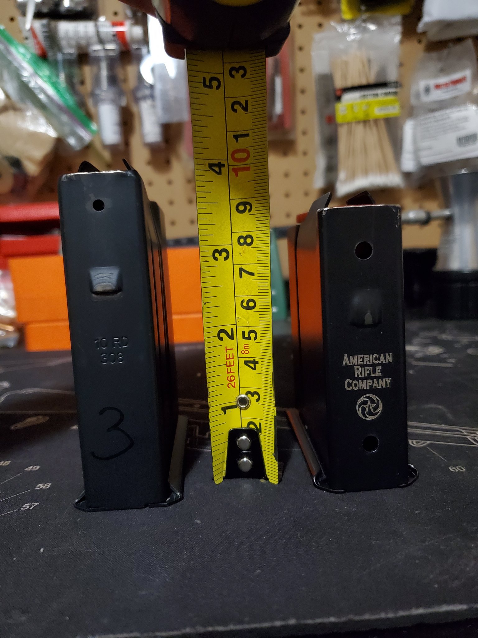

Here's a picture showing the height difference:

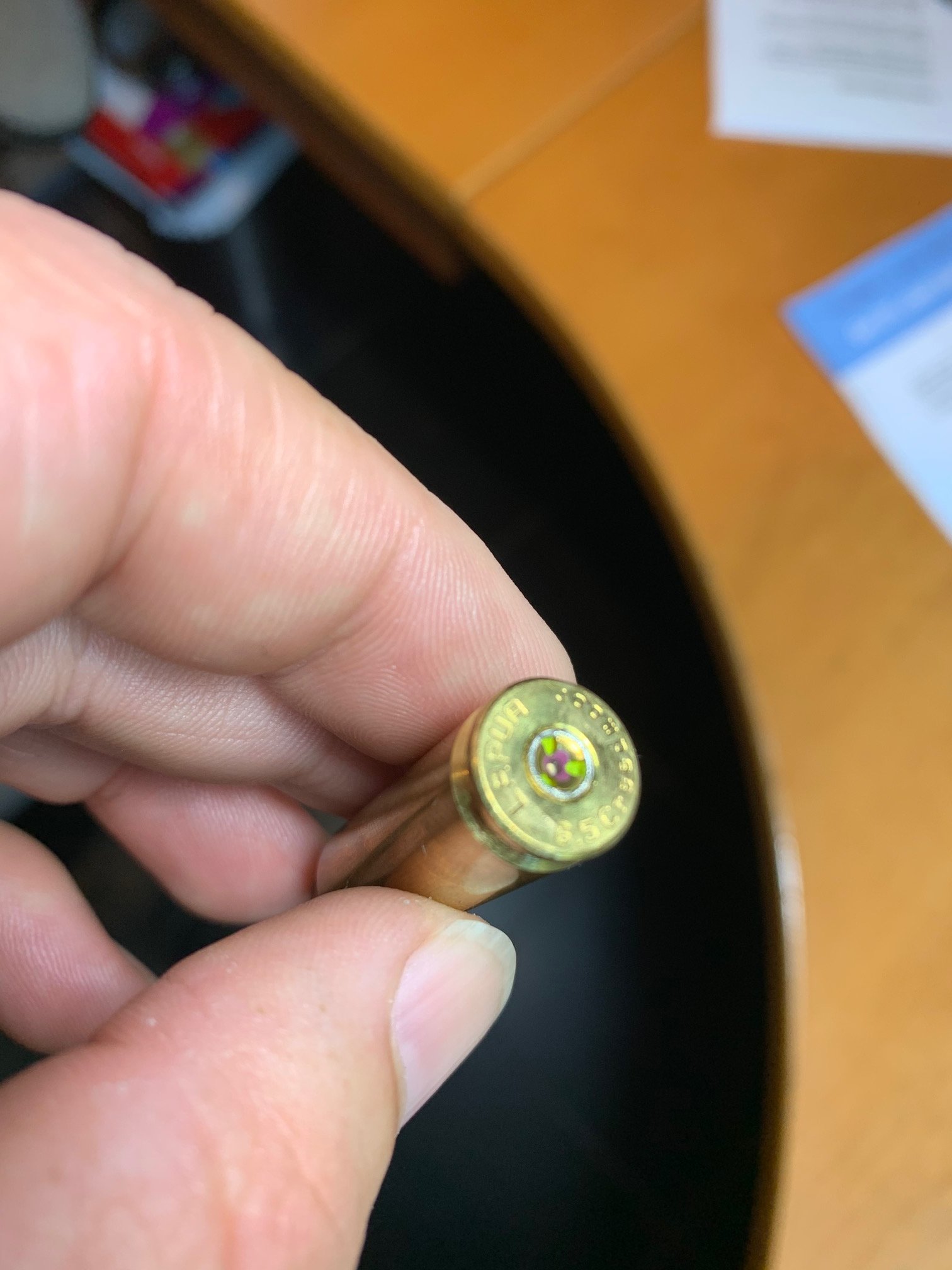

I'll resurrect this thread. I'm not sure why there is so much love for the nucleus here. I had a ton of light primer strikes with my Gen 1 with the 16 lb spring that came with it. So I switched to a 19 lb spring. Last match, I had 3 light strikes out of about 80 rounds. Everyone said I didn't seat my primers enough. Funny because I've not had that issue with any other rifle I reload for, and after checking, all my primers were below flush, but either way its completely unsat. So I changed again to the 25 lb spring and it's got a comically heavy bolt lift now.
Not to mention my action has never controlled round fed. My origin is a true CRF, the nucleus is not. I've put both actions in the same chassis and used same mags, the ARC wouldn't CRF no matter what I did.
Confirm your firing pin protrusion, confirm your headspace, confirm you are not bumping the case shoulder excessively.
My gen one nuke will CRF with MDT mags provided you are quick with the bolt.
Reactions: 357Max
How far below flush? What is your firing pin protrusion? It is adjustable on the Nuke.
I've got about 800 rounds on my 1.1 with a 19# spring zero light strikes. Cant remember protrusion but I checked it before and after I changed to the 19# spring to ensure it was the same or +.001 - .002
Recently I've loaded with Russian Wolf magnum SRP & CCI #41, no issues & single digit SD's

If you are having light strikes I’d heed the others advice and check pin protrusion, shoulder bump and head space.
I'd agree with those saying to check your pin protrusion. I had thousands of handloads through my Gen 1.0 with 16lbs spring (all CCI 400s and BR2s) with zero lights strikes. I came into a real good deal (this was pre-covid) on Hornady Steel match in .223 and bought a bunch and started getting light strikes. Swapped in a 19lbs spring and never had an issue again and the rifle's total round count is somewhere close to 20k.
Mine must be controlled round feeding. When running it slow on the bench, it's so damn smooth, I question if it actually picked up a round. Every time I fall for it and check, it has indeed chambered a round. I'm using ARC mags & they do have shorter feed lips that allow the round to pop up sooner.
I kept the pin protrusion the same as what came from ARC which was about 0.035".

Might also be a mag height problem, if it's presenting the round too low then the feed lips might let it tip up and slip past the CRF rim on the bolt face. If so, that's more of a stock/chassis problem, although I can understand frustration about the ARC action requiring a more precise fit on that.
Just something else to check.

This does seem to be a trend though, all of my issues are user error. Like how I didn't seat my primers enough. I reload for about 15 different cartridges and I've never had light strike issues with any of those, but yea my reloading process is wrong. Gotta love the internet sometimes.

Internet is great. Anyone know what primer this is?
