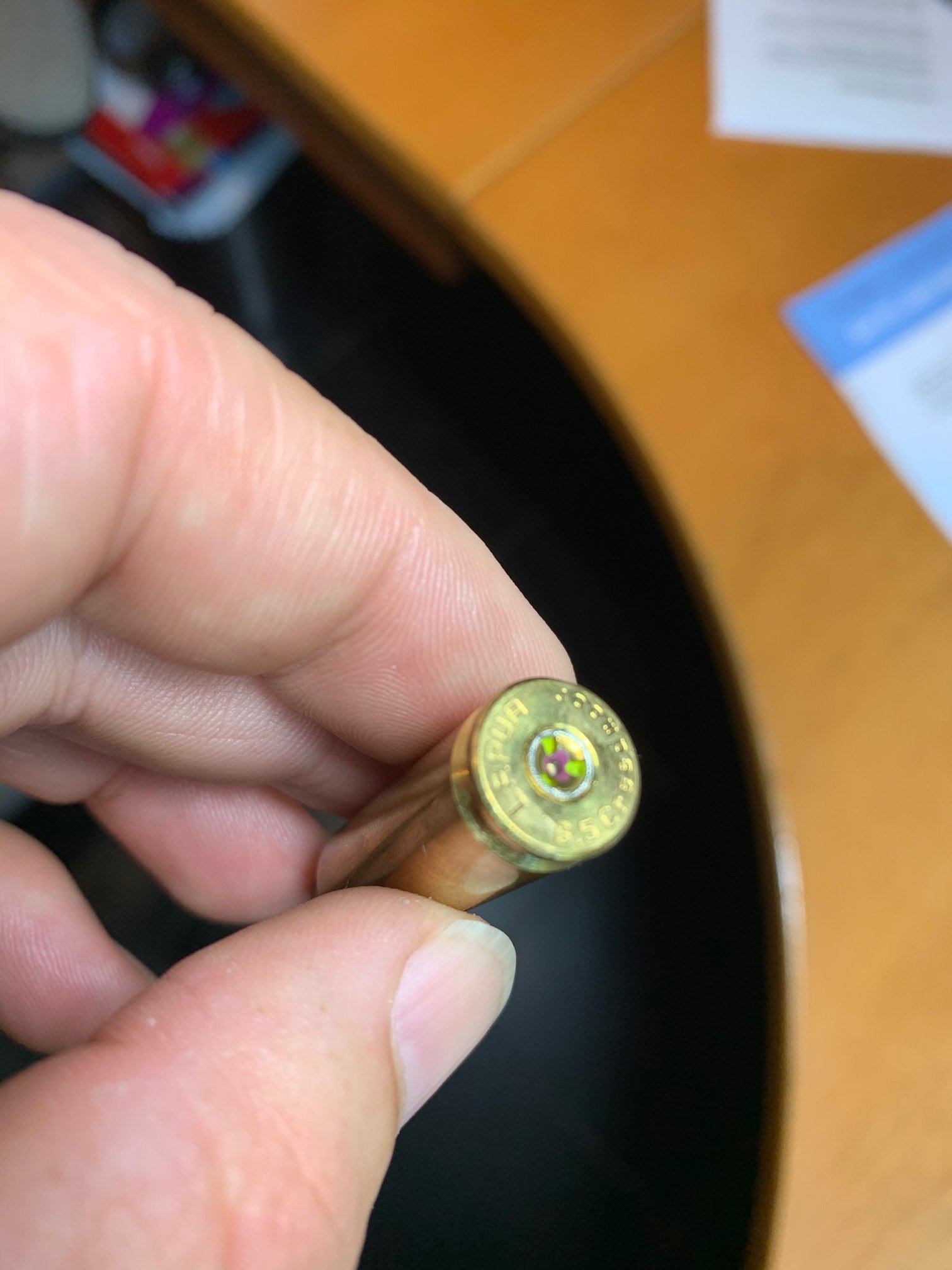

Internet is great. Anyone know what primer this is?
That looks like one of those new fancy military primers made in a super high speed shop with amazing quality control.
Primers fine, case is backwards though😏

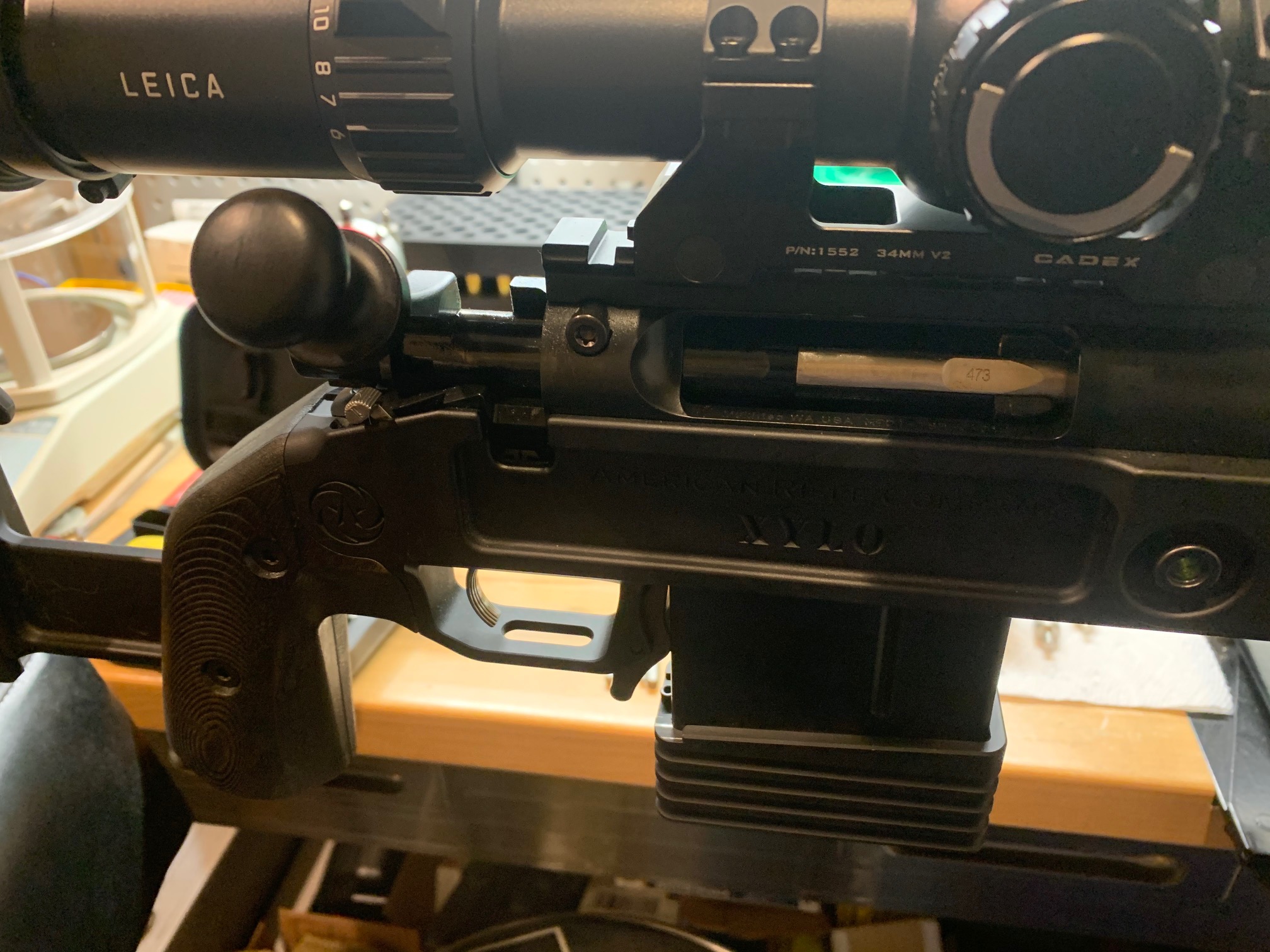

When you are clambering a round, can you extract it without sending the bolt full forward or closing the bolt? I can't. The round pops up out of the mag and is not grabbed by the bolt face. Im using ARC mags as well. The origin that I just picked up, that does CRF.
Finally got around to checking this. Firing pin protrusion is .035 #19 spring. Never had a FTF. As for control round feed, when it pops up from the mag (ARC mag), it is against the bolt face but not yet clipped into the extractor. I have to run it forward enough for the feed ramp/chamber to straighten the round. It is then clipped in & can be extracted.
Picture below shows bolt position when the round becomes fully controlled.
