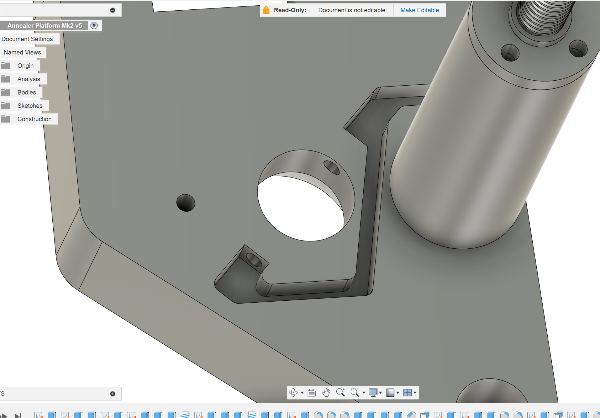

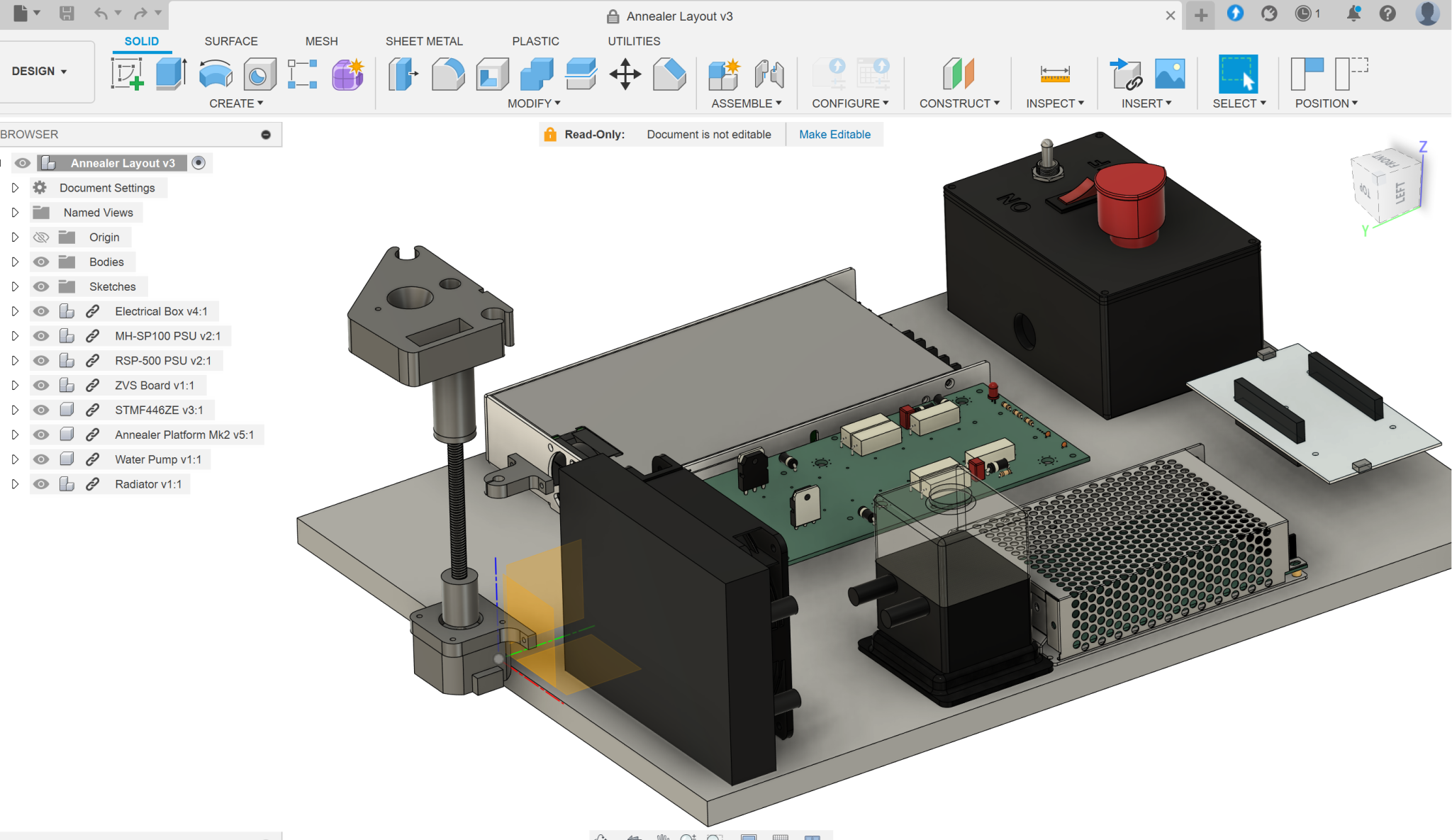

Interesting. I wonder what sensors they are using for the temperature sensing. I have actually been kicking around the same sort of thing for my homebrew annealer, but the only infrared temperature sensor I found that was fast enough and capable of measuring high enough temperatures hasn't been available in the US for the past couple of years (made by Melexis). It's like $85 just for the sensor via China, and I can't be sure it's not a knockoff so I never tried it.
It make Aztec mode irrelevant, since you can directly assess case temperature and don't have to destroy the case to do it. Because of that, you can measure every single case instead of relying on one setting. It also means you wouldn't have to calibrate anything but height, as you can just pick a temperature and it should automatically do that for every case, regardless of thickness.

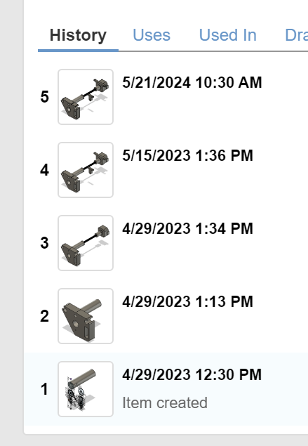

I've even had a stepper to adjust height like that.
Photos just so people don't think I'm some blowhard. you can see the cutout for the photo eye I was going to use for a safety interlock. 🙃
