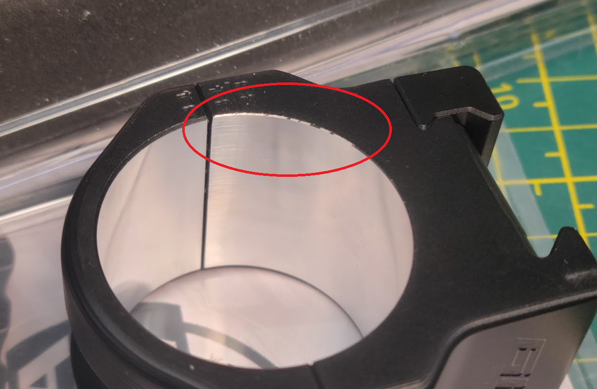

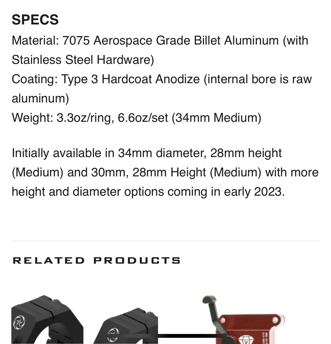

Can someone educate me on the final boring/honing that’s done after anodizing? I don’t know enough to bash it or love it, but I am curious since I don’t recall anyone else doing it.
They're essentially lapping the rings in-house and then marking them so that you can put them together matched to the lapping.
There's 'issues' with doing this in-house vs. on your rifle on the pic rail mounted to your rifle. Not all pic rails are straight and attaching anything to your pic rail can twist and warp it. And is the argument for one piece mounts.
Reactions: akmike47
Why would $220 high quality rings need lapping? It’s nearly 2023.
They don't. But apparently A419 decided to take the extra step. If I needed some rings, these would be on my short list even w/o seeing any in the wild or known testers. My biggest concern with these rings is the possibility of the raw aluminum marring the finish on the scope tube. But that's just speculation on my side w/o any real proof or evidence or real knowledge that it may happen. Just a thought.
It is supposed to be so the bore of both rings are equal to each other.
Meaning, theoretically they are both identical height, parallel to the pic rail, no miss alignment left and right, no taper.

@flyerwhat is the exact height of the 34mm ring? All i've found is "medium".

The bore honing or whatever left a few spots above the water line (the chamfer) unevenly anodized that catches on the fingernail, pretty sure this is just cosmetic but curious if it might make ring marks more obvious. Lots of machining/tool marks on the exterior ring surfaces
Pics?
Maybe this? I don't know.
I noticed this. It looks like a nano-dick width (technical measurement) of where the anodizing / boring / chamfer come together?
You can barely feel it with your fingernail. These things are so beautiful otherwise, I'm hard pressed to think this is an issue.
I'll buy you a steak dinner if you can see it once an optic is mounted, and or if it effects functionality.
