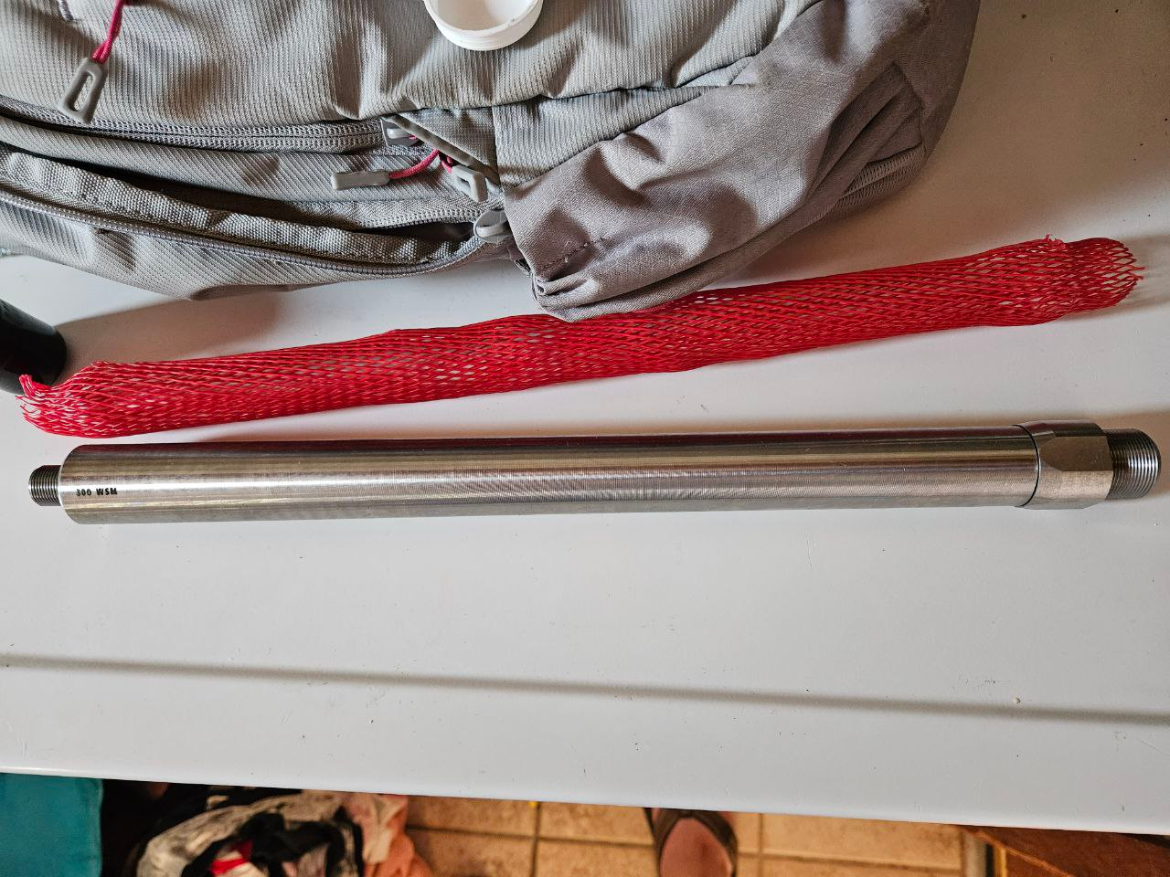

Well, only 10 months and 10 days into the 5-8 week wait time, my barrel finally arrived. It does appear to be 26" long and a 7SAUM cartridge does appear to fit and someday I'll eventually give it a shot...but I'll NEVER order another from these guys considering the delay in production/shipping and the rough outside finish on the 'finished' barrel.
Oh, well...

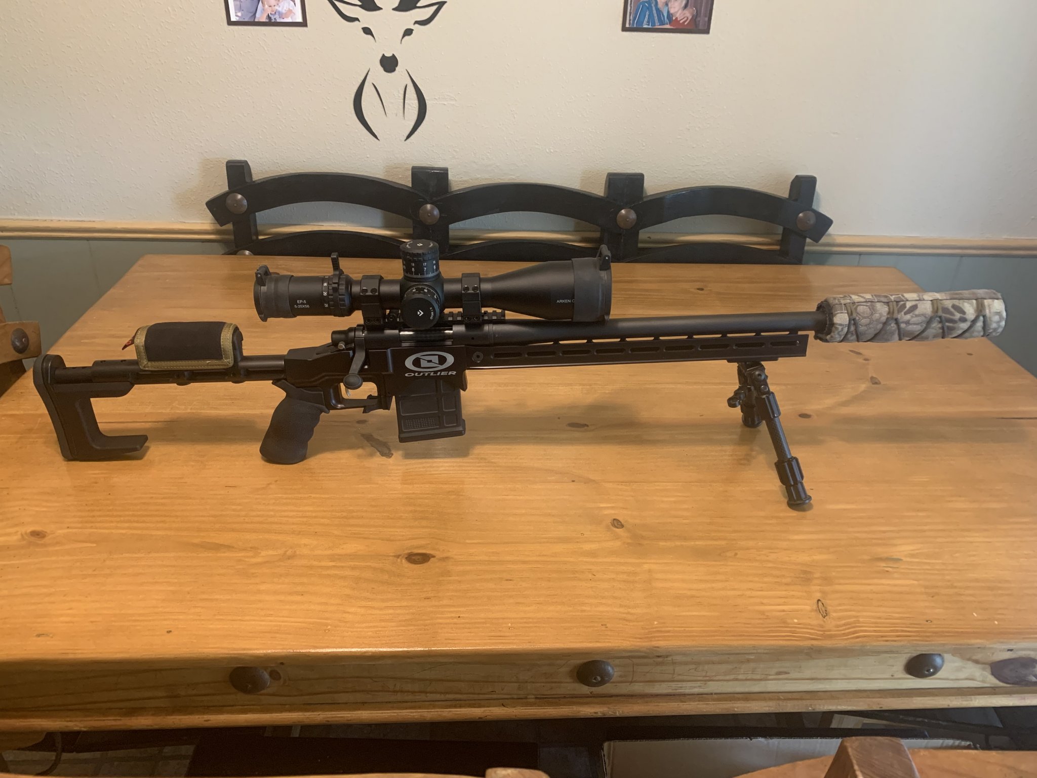

Got my chassis and barrel in, as well as my SH4 6-24MIL. Had it all set up, and my new shooting buddy wanted it, so I sold it to him. Put those funds right back into Outlier for a Remington Chassis, with a new EP5 5-25MIL. The 700 is the SPS Tactical in .308, and it shoots fantastic!! I will get some pics on the next rage trip, as my phone died.
