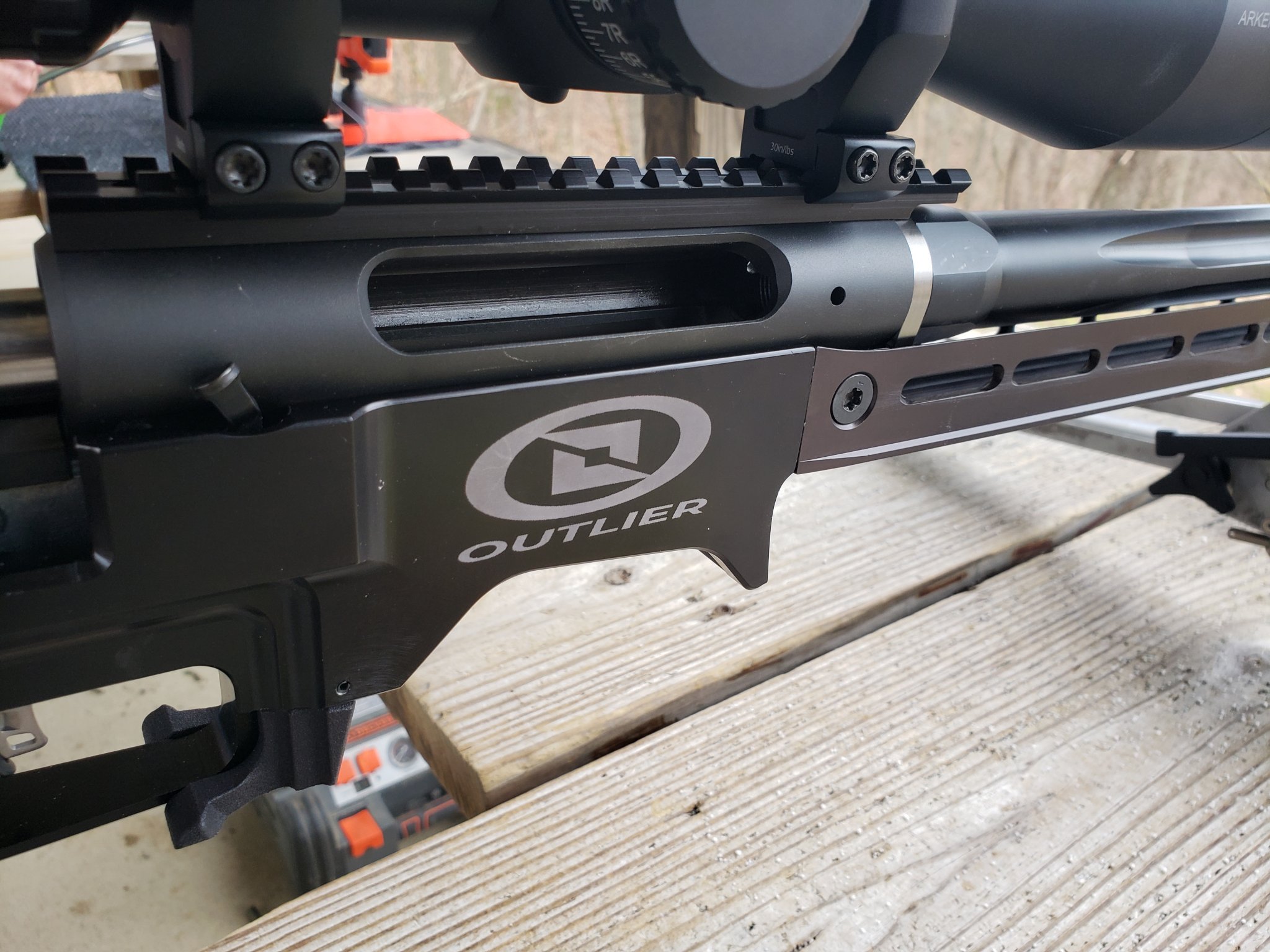

Have a fluted 308 Outlier barrel and chassis on a Savage Axis we've been kinda testing. Got a bit of a problem presently with the bolt/action not camping back to start extraction and why we haven't been shooting it lately.
They wanted to see how the 308 shot right from the git-go with no breaking in or load development. A buddy put it together at his house, told me where the lands were and I loaded up rounds for it.
We met at Briar Rabbit range here in Ohio for testing. 43.5 gr of Varget with Lapua Palma brass, CCI 450 primers and 185 Juggernauts.
Took two shots after bore sighting to get a close zero. Next shots were for group to see what it'd do. Some will say it's not the best way to test a new gun but we wanted to see how different shooters did with it.
First 3 shots shot by a past ELR World Record holder, second group by the Open class range record holder at Rayners, third by a very good local shooter and the last group by my Son who holds the 223/308 range record at Rayners. All good shooters.
Seated .003 deeper and is very consistent a cloverleaf gun now. No complaints at all on accuracy. I did make a tight fitting insert for the chassis to stiffen it a bit which really helped.
Will find the target and post pictures from that initial firing. Performed very well for a budget setup. It also had n Arken EP-5 which made it a complete Arken except for the action.
I forgot I posted here about the Outlier barrel/chassis we started testing. The Axis action wouldn't have been my first choice but that is what they wanted us to test. We ran into a problem right off with very little cam back with the bolt for extraction. An aftermarket tactical bolt still didn't help. Appears both needed more material added to create rearward action to start extraction. We found a local jeweler with a lazer welder that added material and some slight filing/reconfiguring cured it.
Here is the picture of the target. The order we shot the groups is in the post above. It's still a 3 shot cloverleaf shooter but we lost most of the summer due to getting the extraction issue remedied.
This is how we did the first group tests copied from my initial post in case the quote wasn't read.
"Took two shots after bore sighting to get a close zero. Next shots were for group to see what it'd do. Some will say it's not the best way to test a new gun but we wanted to see how different shooters did with it.
Seated .003 deeper and is very consistent a cloverleaf gun now. No complaints at all on accuracy. I did make a tight fitting insert for the chassis to stiffen it a bit which really helped."
