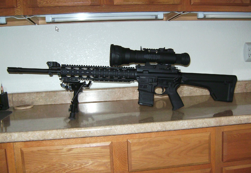

I mounted the Armasight Nemesis 6+ ID 2nd gen scope and a Frankenstein rifle I made.
It is an AR-15 with the following parts, Spikes Tactical Lower, CMMG lower parts, Geissele supper semi-automatic trigger, Magpul MOE rifle stock, Armalite buffer and spring, Aero Precision upper receiver, Olympic Arms stainless ultra match barrel 1 in 8 twist, Yankee Hill Machine quad rail and covers, PRI gas block flip-up front sight, Knights Armament USMC flip-up rear sight, Delton charging handle with Badger Ordnance tactical Latch, Magpul grip, Magpul trigger guard, Smith Enterprises Vortex flash suppressor. With the day scope, the gun shoots ¼ MOA.
While mounting the scope I had trouble with the large objective. With the scope day light cover on, the scope front objective was too big with the Yankee Hill Machine quad rail installed. I had a choice, one cut the day cover and risk damaging the scope in day light, or two cut a couple of the rails off the quad rail so the scope would fit with the cover on. I chose to cut the rails off the quad rail.
