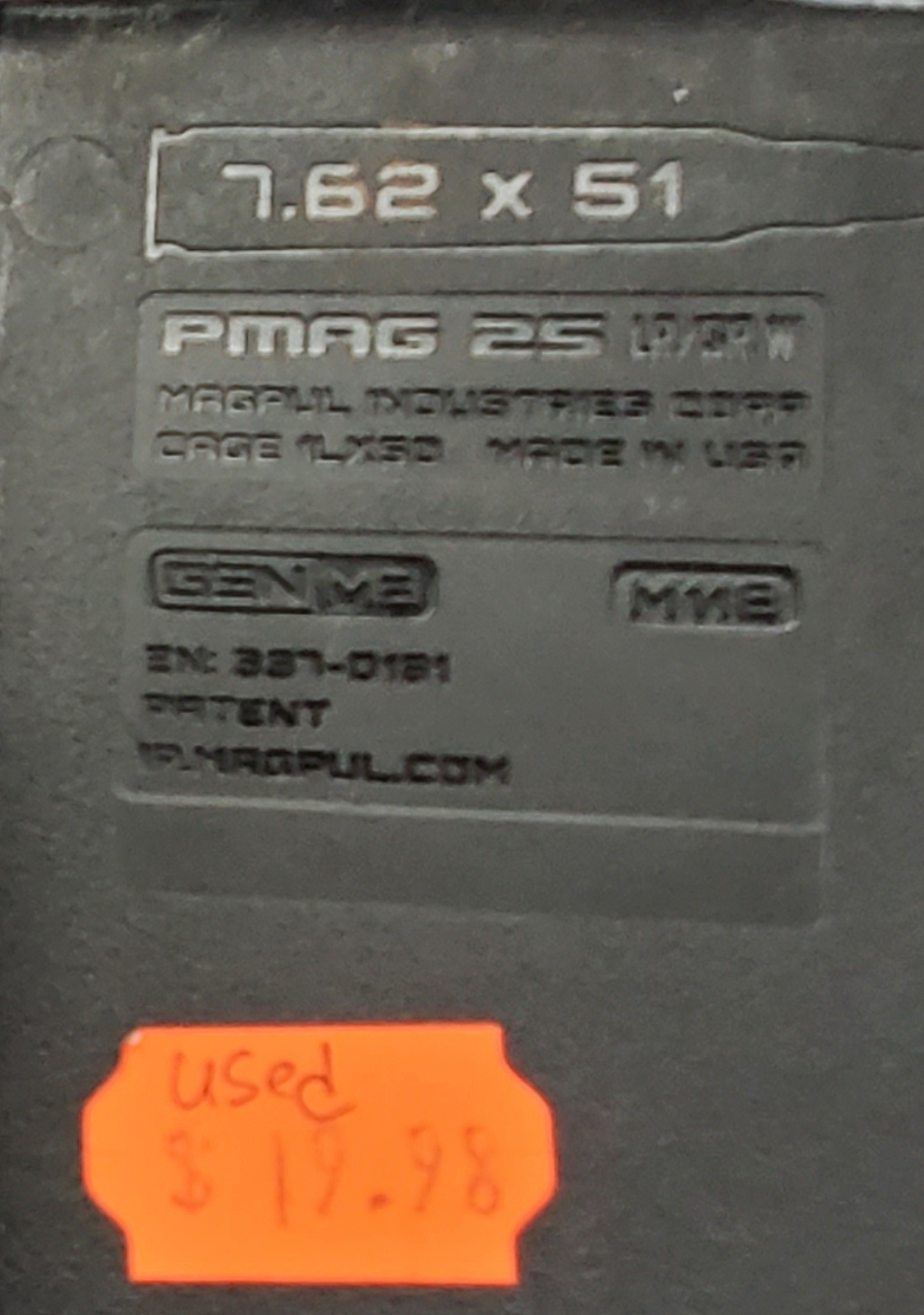

    And if you buy any second hand look for the "M118" marking as seen here
    Reactions: ReaperDriver

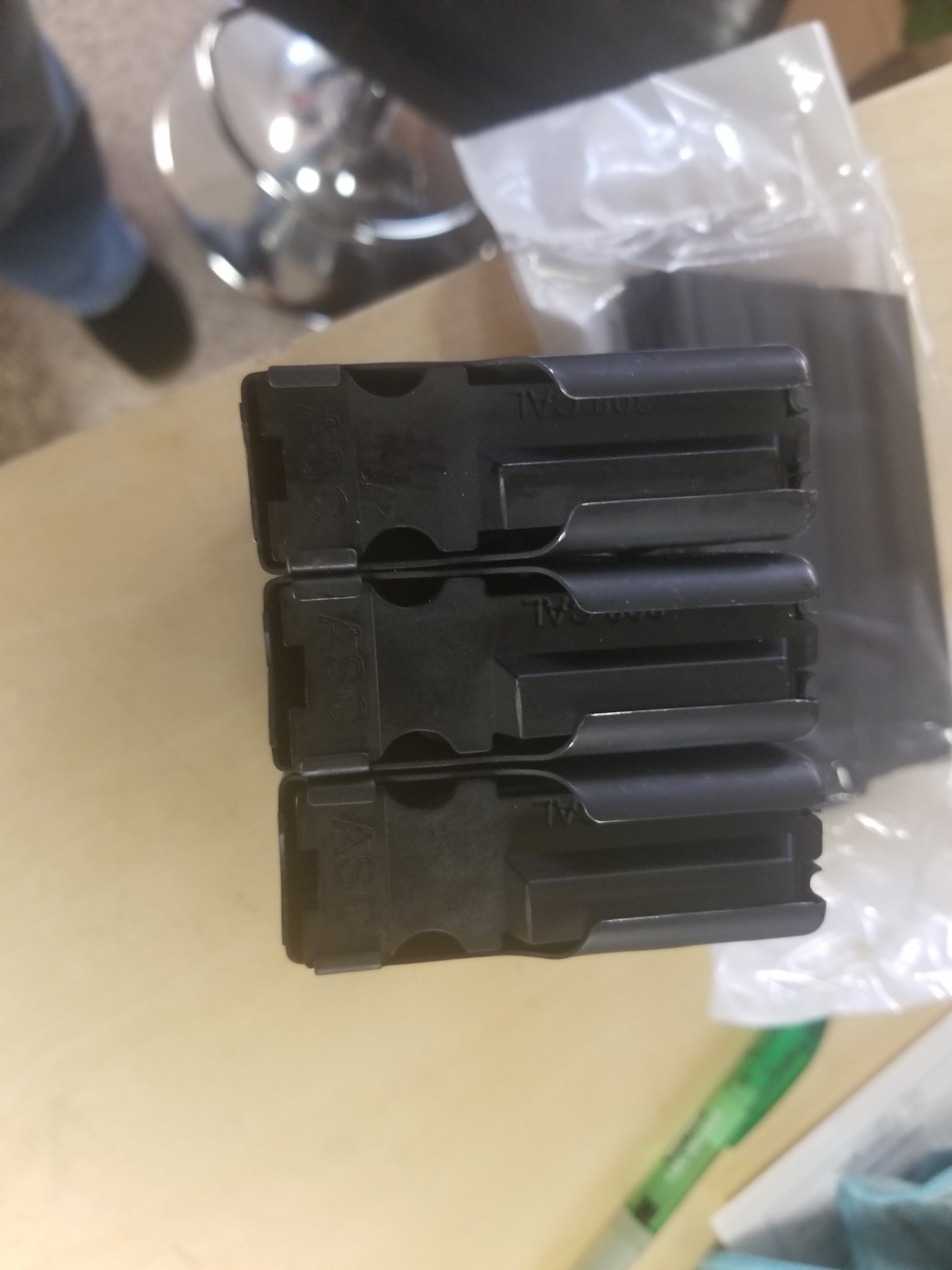

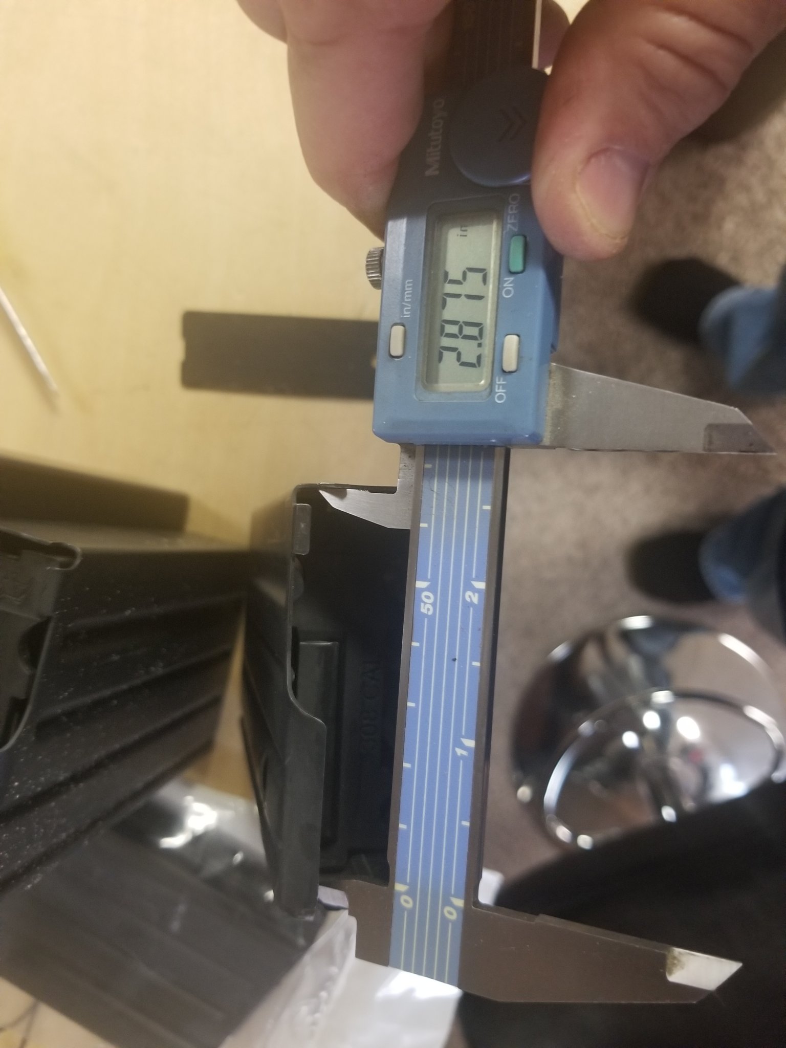

    Did you do anything to mod your ASC mags? I loaded my .260 Rem rounds to 2.850 and they were inconsistent feeding. Several of the bullet tips (130 Berger AR Hybrid) dragged on the inside of the mag front wall and hung the follower up. I have 3 brand new ASC mags and they all did the same. I wonder if ACS changed the internal spec. I now load to 2.847 and they seem to work fine.
    Mine are about 3 or 4 years old.
    Yup, I measured mine as well when they arrived and got the same measurement. However, no way is a round going to fit at that length. I even tried 2.865 to give it some room and no worky. I finally ended up at 2.847 just to give it come clearance. Otherwise the rounds even at 2.850 drug the nose on the front of the wall. I just shot all my loaded rounds yesterday, but I'll load up some soon and post a pic to show the actual bullet clearance.
