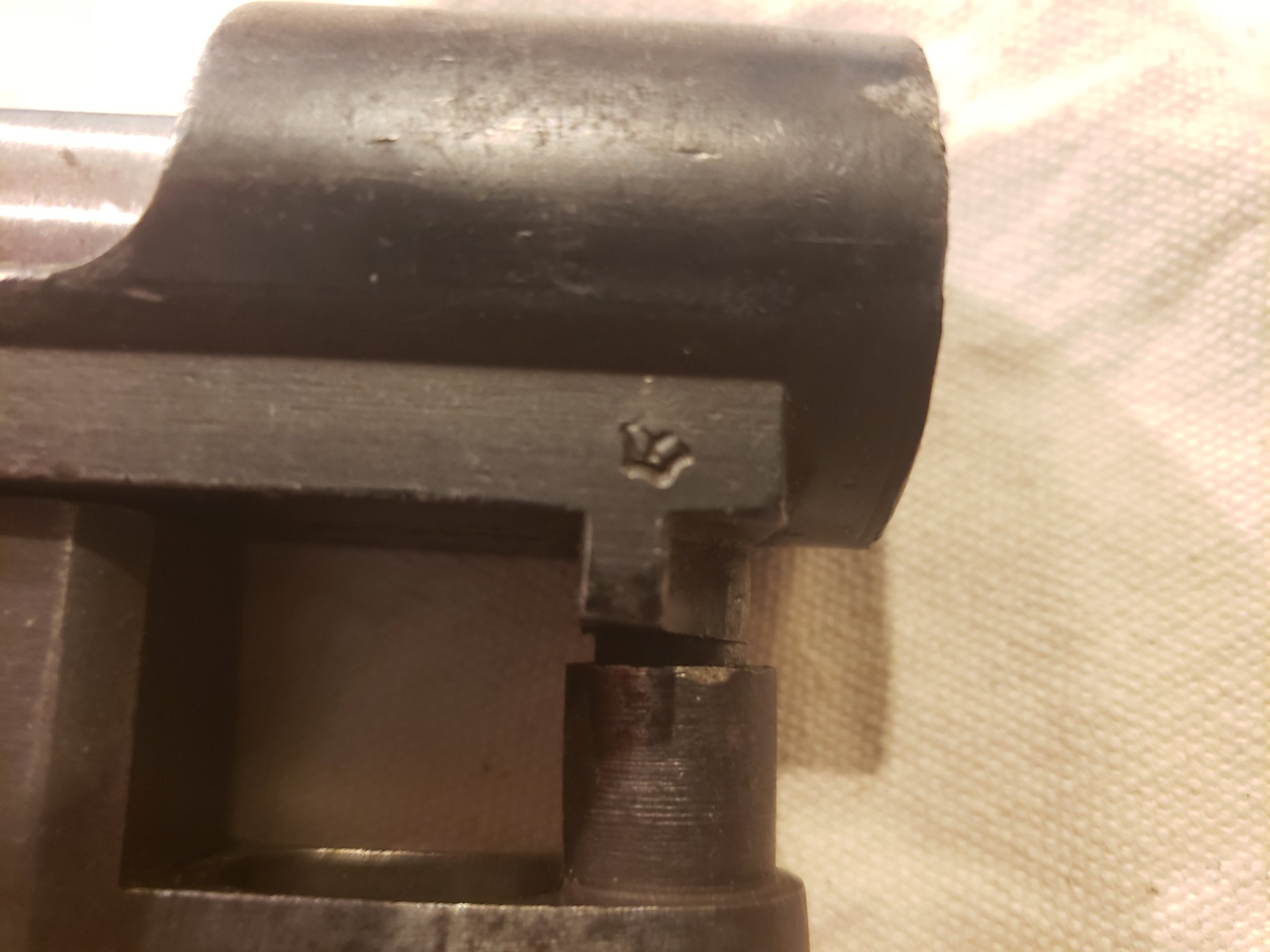

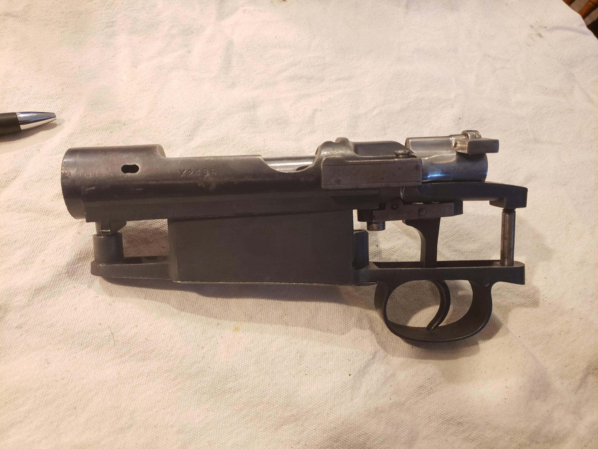

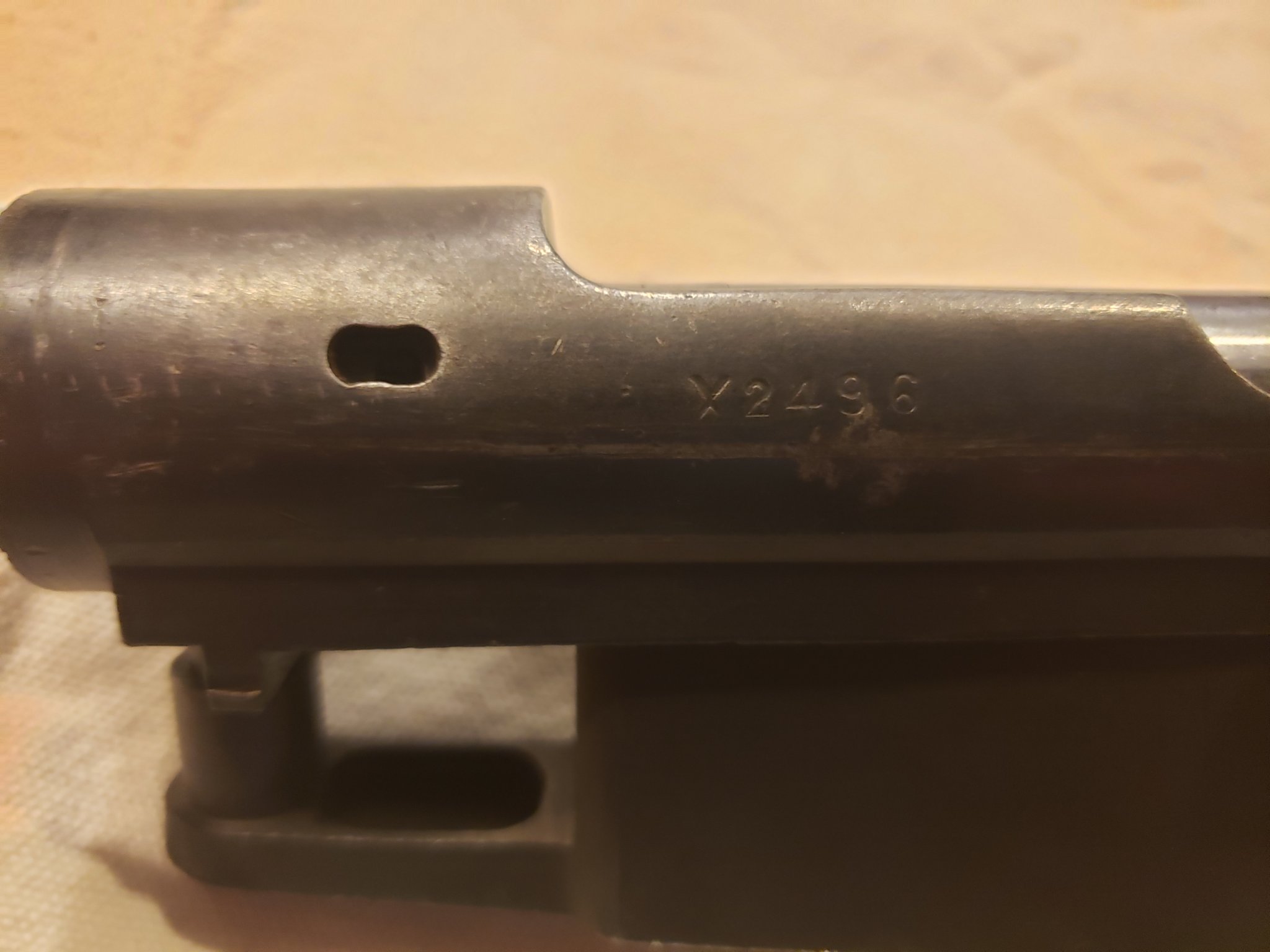

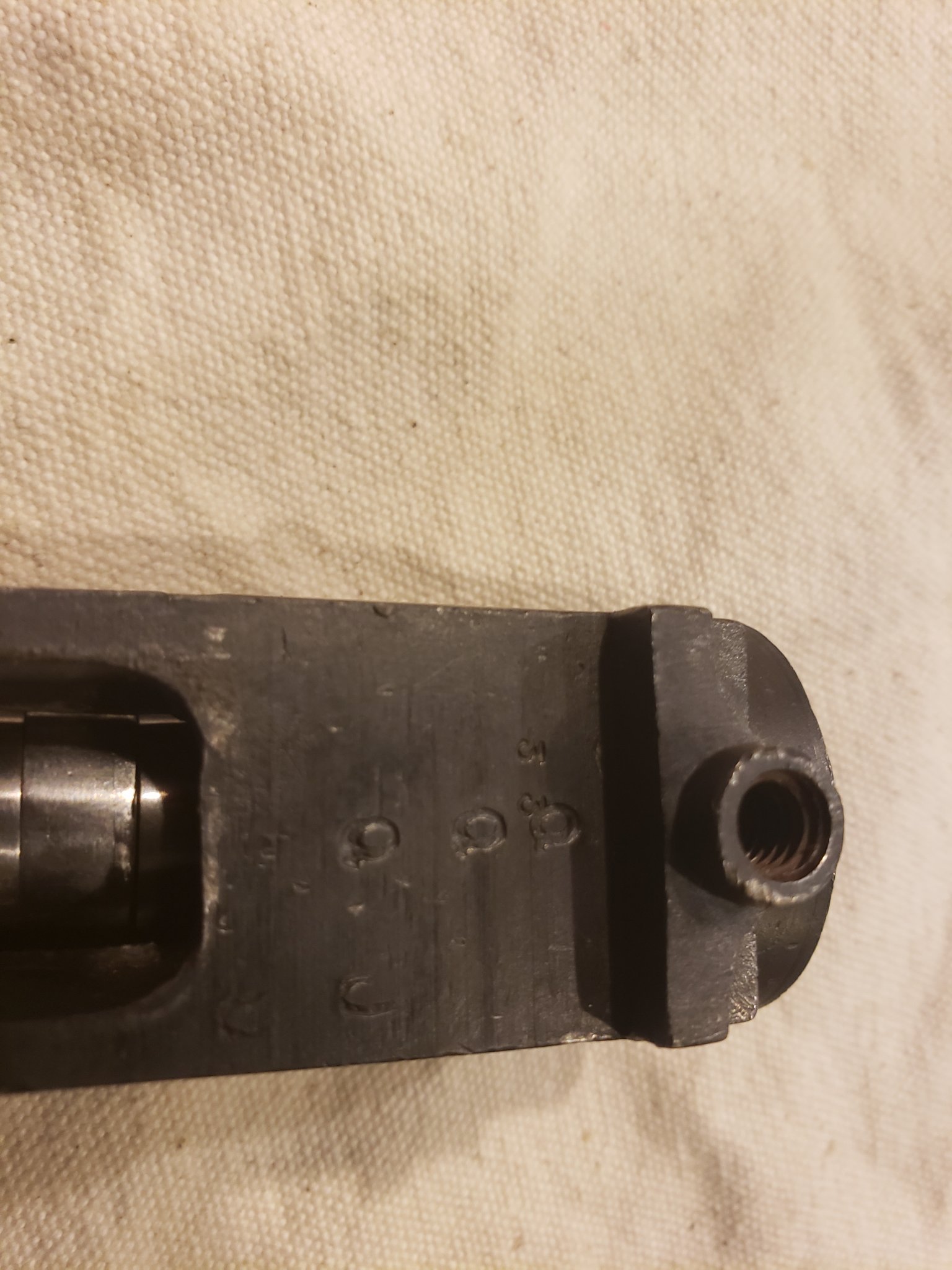

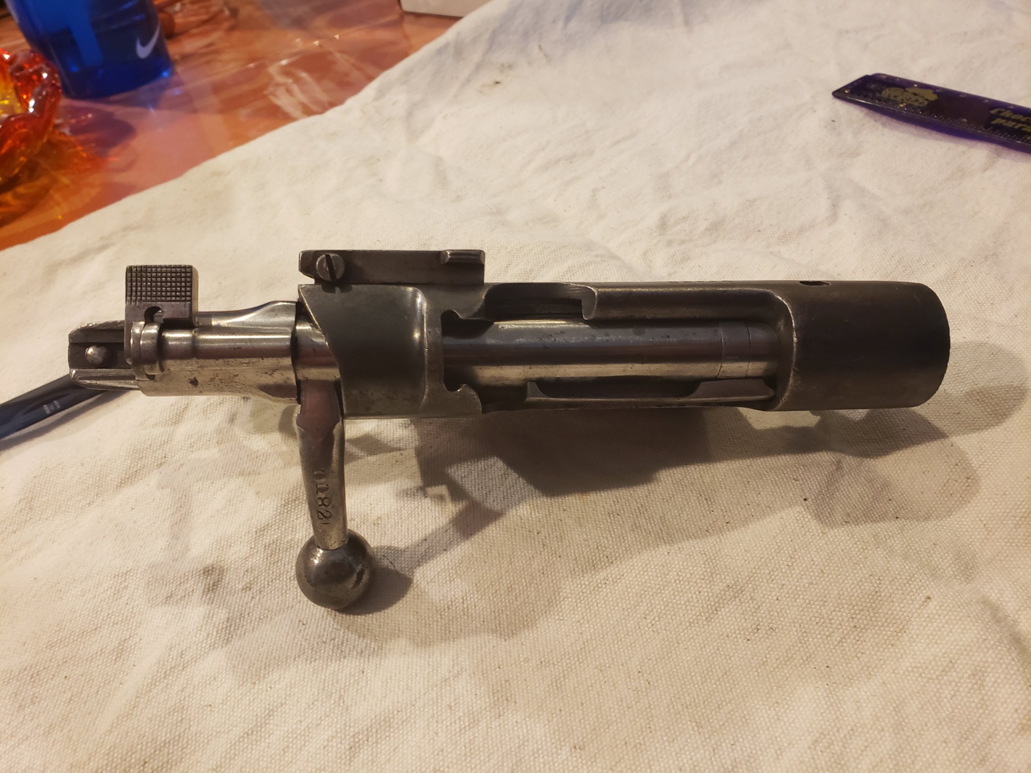

I bought this mauser action at a gun show a few years ago for cheap. Its a small ring but I have not been able to ID what it is beyond that. Any one know of a mauser expert in the lower lousiana area that could help ID and rebarrel it? Also looking for suggestions on what caliber to rebarrel it too. It has no markings beside what I took pictures of.

This is a mixmaster of parts and non matching serial numbers - looks like a 95 Spanish Mauser small ring. Be very careful what you build on this. Originally 7 x 57. My recommendation is to sell and buy a 98 Action or a commerical action that has more safety features.

That is a scrubbed Spanish 1893 action. Should have a squared bottomed bolt face.

Get a better action. This one lacks basic safety features of a 98 Mauser. It has no safety lug, handles escaping poorly and the striker lacks the indexing feature that keeps it from firing when not fully closed.
