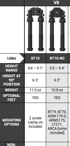

He has this model, not one set up for the ADM-170 adapter:

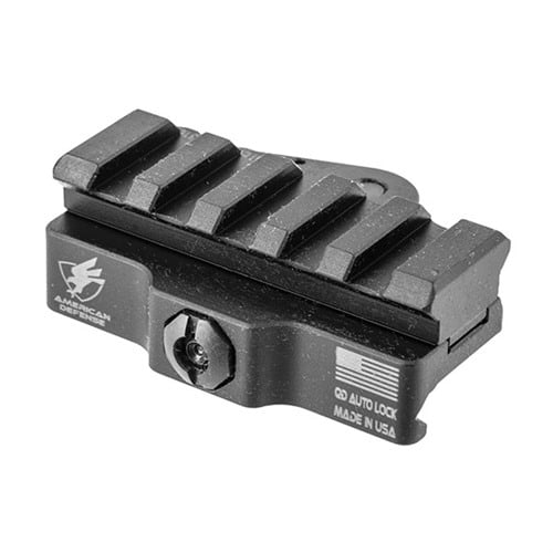

I would say the most expeditious route to take is a get an ADM QD low riser and mount this to it, use threadlocker on the screws, and make it semi-permanent.
Check out AMERICAN DEFENSE MANUFACTURING AD-170-VPG 5-LUG PICATINNY RISER MOUNT | Brownells available Online at Brownells Today and many more Red Dot Mounts products are available in our Optics Department.

ETA: After reading the FAQ's on the Accu Shot website pertaining to this issue, sending it back to them to have the conversion done doesn't seem like too bad a deal. It sounds like they'll straight up exchange it or convert yours for a nominal fee, less than the cost of the AD-170 mount.
