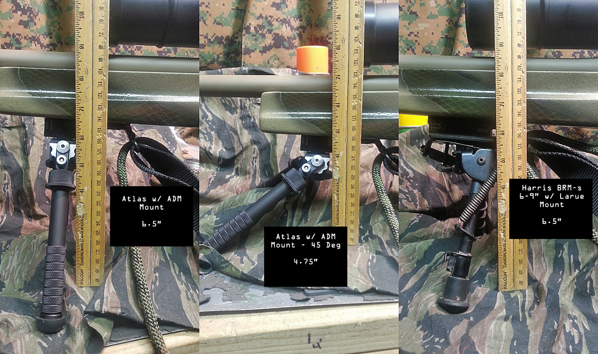

I was in my gun room working on stuff thinking about this thread and snapped these three pics real quick. Horrible camera phone pics thrown together in photoshop real quick but might help someone out.
