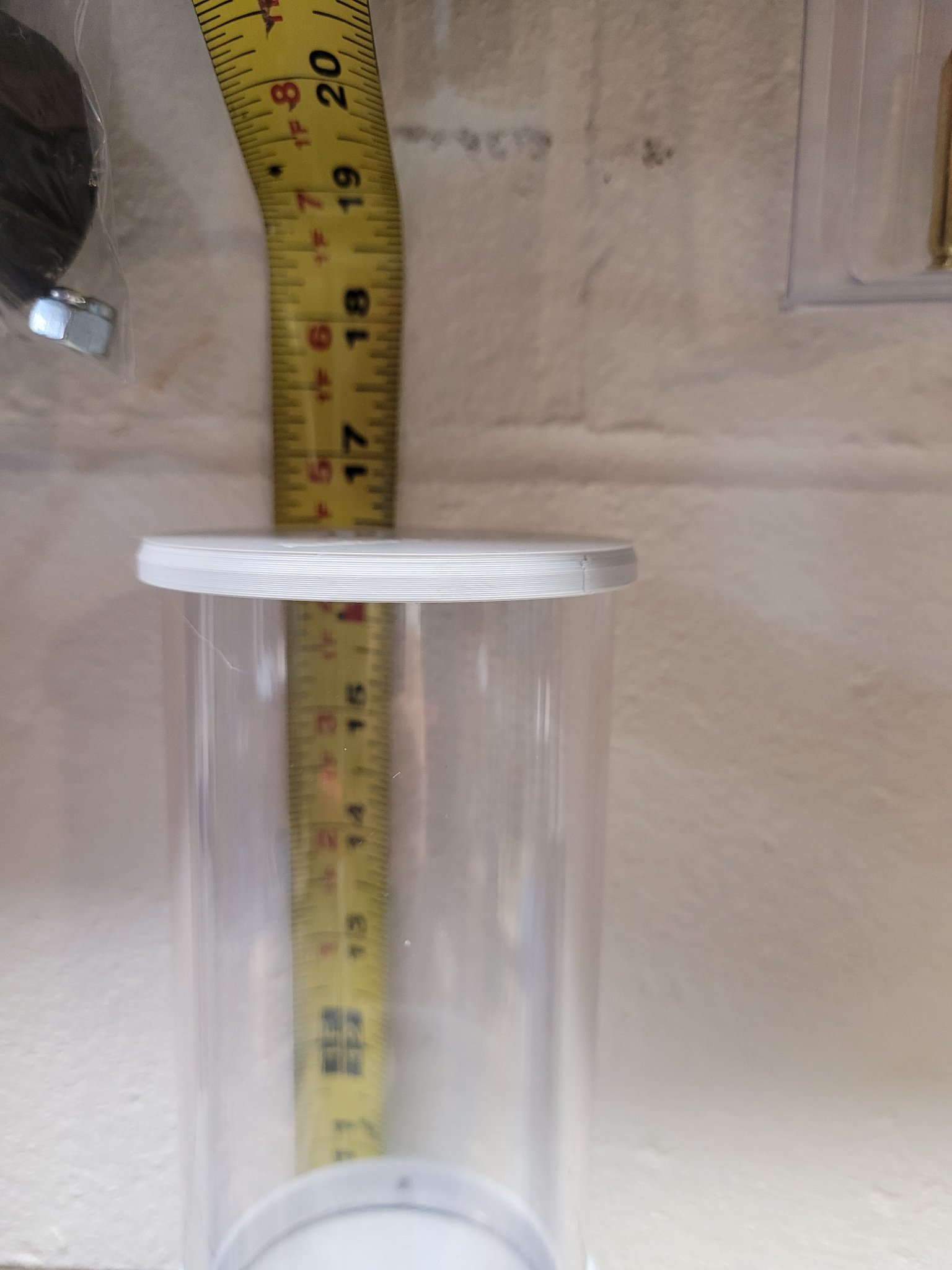

Anybody that has received there v4, can I get a measurement? How tall is the entire unit with scale? I’m building some shelves and I want this to fit on the top bench under a shelf.
Thank you
16.5

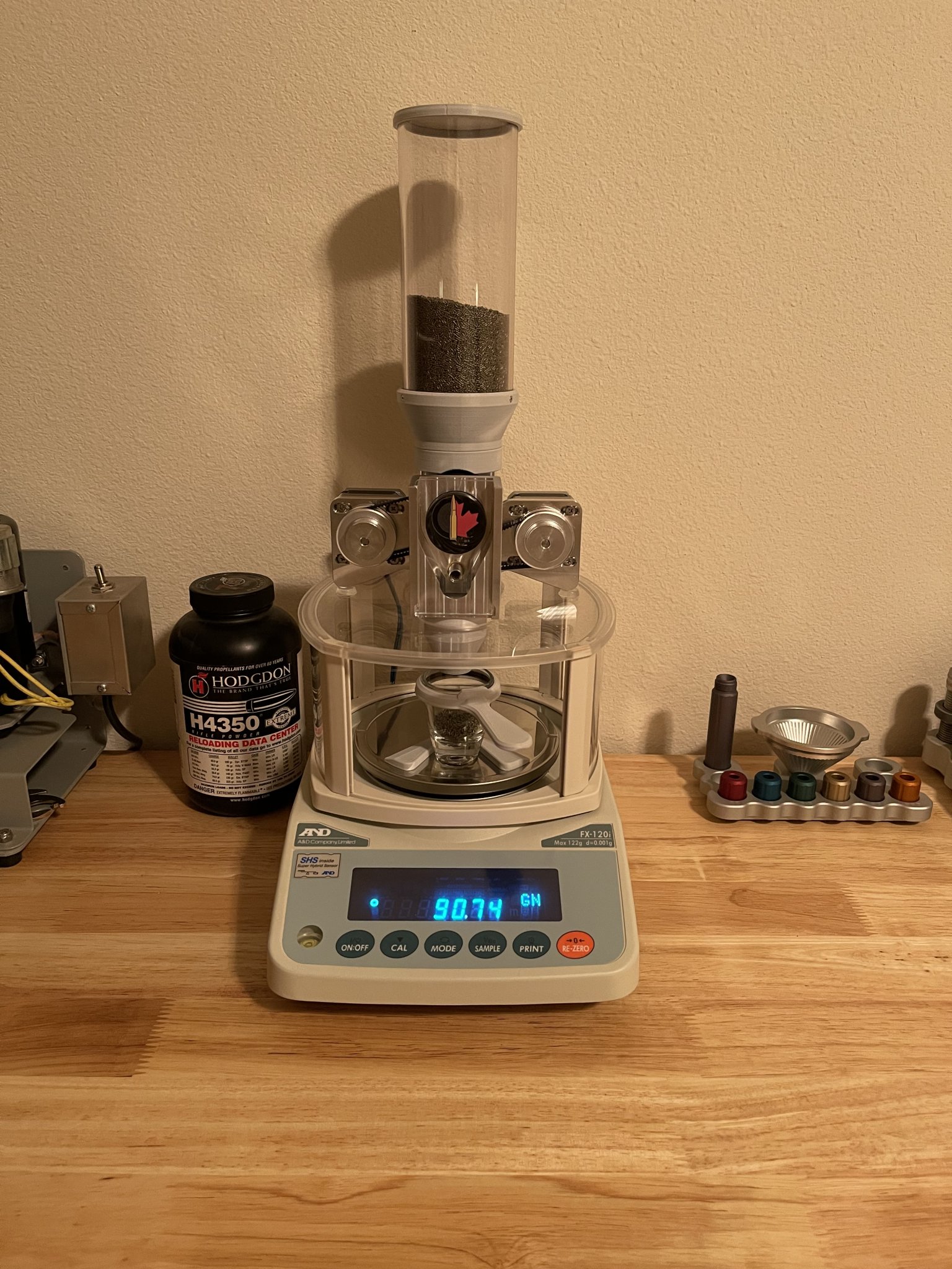

Mine arrived today and I’m very impressed. Great build quality and is very fast. I was worried about going from two lites that it would be slow but when pouring over 50gn it really shines and is hardly slower than two lites

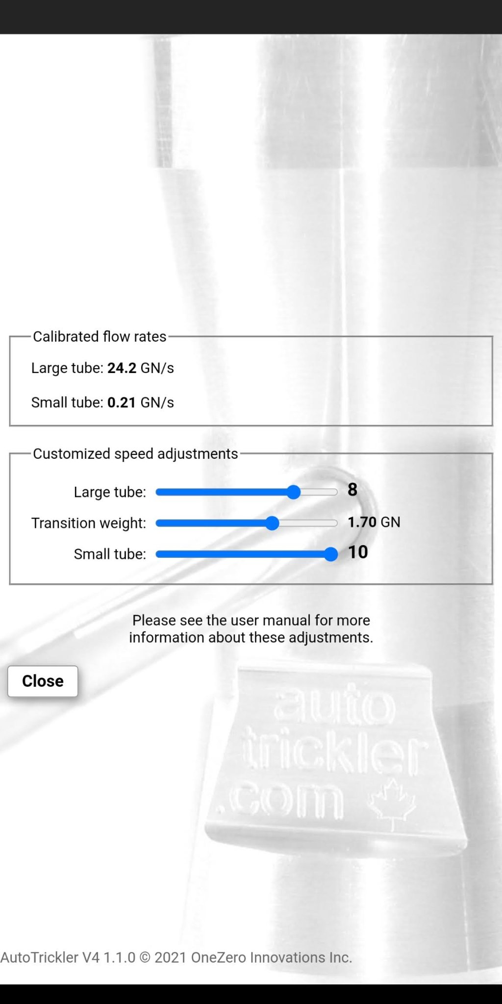

8 and 10 for speed settings will definitely result in overthrows. And 1.7 transition setting with 24.2 flow on the large tube seems way too small.

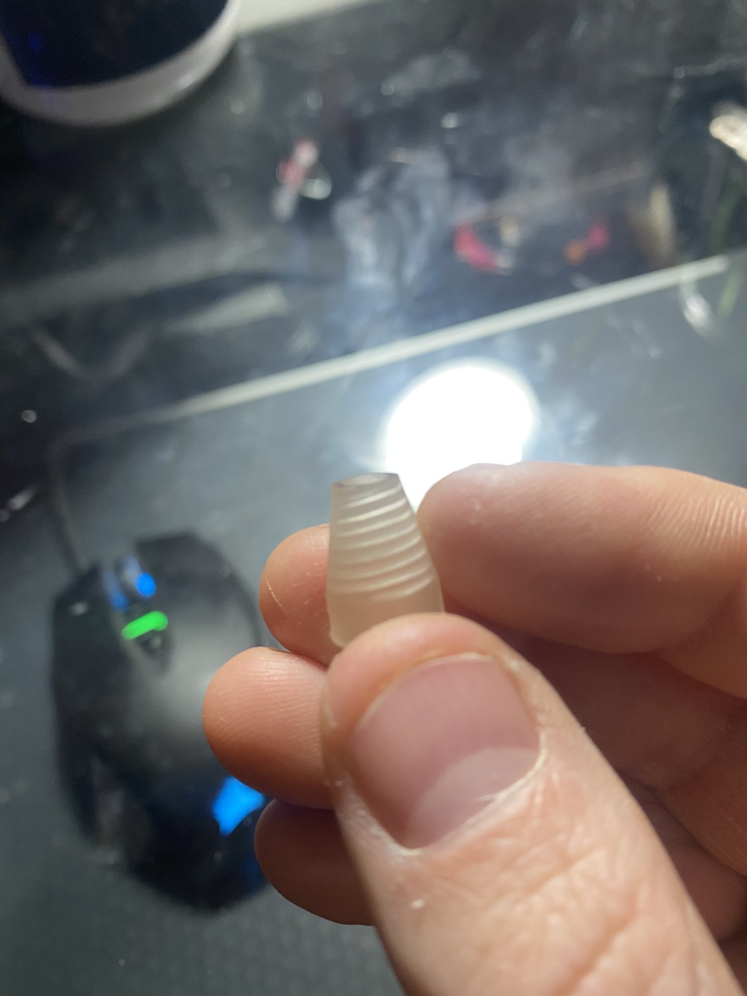

Where can we get one if those tips. That is the big issue I see right now is a stall at the end which causes it to push a clump of kernels. Other than that I have not had any other issues. Runs great.
