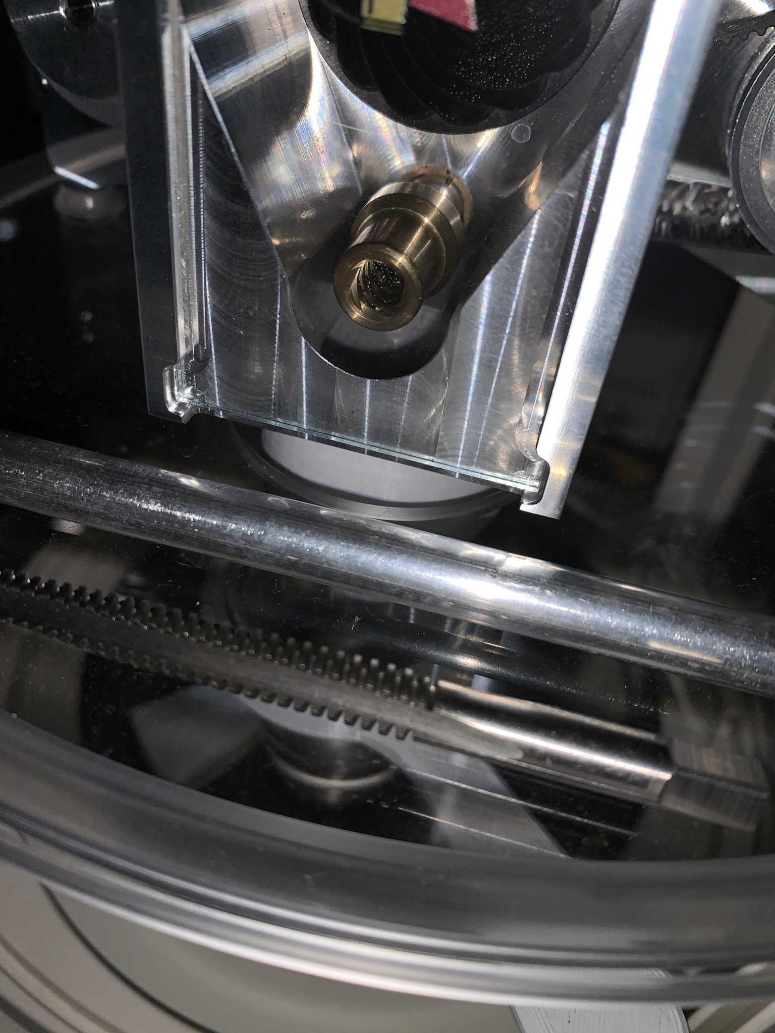

Tubing & Acme tap finally delivered. Next weekend project will be a new trickle tube for large kernal powder.
Tubing & Acme tap finally delivered. Next weekend project will be a new trickle tube for large kernal powder.View attachment 7934236
I hope it works out for ya, just seems like alot of work to get something to function correctly. I sold my V4, im gonna try the V3 and ingenuity precision route just to see if it's the tits.. The regular V3 was a good setup, it works, I just didn't like how you had to empty the trickler, the ingenuity precision one looks quick and simple. Good luck...
I have a V3 that I'm perfectly happy with. You're right about the trickler though.

Did you try a reducing insert ? I bought a set off a member on here. I haven’t set up my v4 yet but others seam to have had good luck with them. I know it helped on my charge master.
Yes I tried them first, then made the one pictured. The V4 is great with my current tip & ball powder. It struggles with larger grain powder. I’m hoping that threading the small tube With the coarse Acme tap all the way through will help facilitate a smooth flow of the larger kernal powders.

You can have your screw elevation/tilt adjustment, but I think shims are the way to go as they are more easily repeatable. Level the scale and then throw in the shim(s) that worked the last time you loaded that powder. I don't like the idea of trying to judge just how far the bubble moved. A .010 shim will be a .010 shim every time. No comment yet re: the trickle tube.
Reactions: secondofangle2
I am using a printed tip and shims, no issues. The key is to make sure the set up is right. Scale settings / inputs are done right. I check every time I calibrate powders too. .18 to .22 on small tube produce best results. Most, not all, but most issues I have read about are user induced issues.

To @DellaDog second point, I’m not confident an elevation adjustment alone will work. The issue I’ve noticed is that with ball powder this thing rocks, however as you go coarser on grains the flow rate split between coarse tube - fine tube grows. If I shim the back to get a smooth steady flow from the small tube then the big tube is dumping way to fast.
I tried to strike a better balance of large-small flow split via making a new small tube that is Acme thread tapped all the way through + a 4 start super coarse Acme thread tip. It’s better, but still the small tube is damn near level when you get the large tube flow rate in the range where it doesn’t constantly overthrow. Large kernel powder just needs more tilt to the small tube to get even flow.
If I were to do 1 more mod to this, it would be a way to make the small tube independently elevation adjustable from the large tube. The V4 has this relationship locked & I think that’s where the biggest problem is.

It ran them all fine. I had plans to make the small tube independently tilt adjustable, but it’s working pretty dam good now.
FYI - I use small Allen keys to shim the back as needed to get small tube flowing .2 - .23 with powders like H4350.
