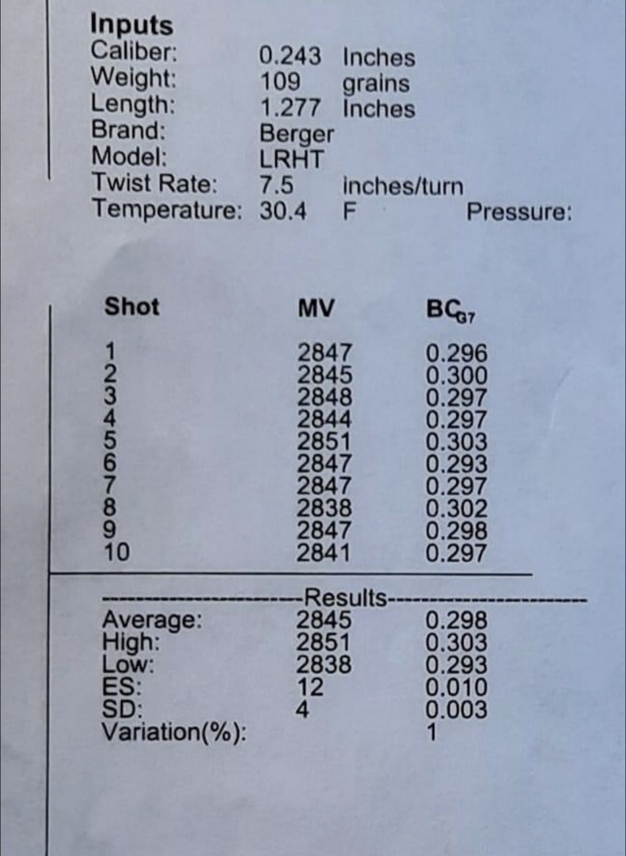

Avoid this pitfall with distance/target based ladder test
The way I’ve heard people define positive compensation seems as illogical as thinking bullets shoot tighter as distance increases.
It’s definitely interesting.
Finding a load range that exits higher and lower in the vertical barrel vibration at the damn near perfect time so faster and slower rounds have a similar waterline.
Alex Wheeler is a proponent.
Combine that with relatively low round count load development to get there…..
It’s definitely easy to question the validity.
For what it’s worth, it’s a similar theory to OCW. Varying powder charges which have same POI. It’s essentially positive compensation @ 100yds.
I’m absolutely ok with either method being completely valid or completely false. But I haven’t seen long term data that suggests either is reliable. Granted, that’s a task in a half to test enough to truthfully validate.
tuning for the distance is covered in the bottom of the page:
at that picture: http://www.varmintal.com/600yd-trajectory-chart.png
but I asked erik cortina, but they dont do it that way. so I think they dont believe in this.
but if positive compenzation exists, why everybody are chasing the smallest ES/SD for the long distance?
but if only small ES/SD will hold tight water line in long range, than positive compensation does not exist...
than our nodes are not signs of positive compensations, but more of a sign of small ES/SD and tight water line, which are all for...
Because some very high level don’t chase SD.

We haven’t even begun to address the vertical dispersion at distance due to bullet to bullet BC variance. Which can obviously be helped via trimming and tipping. But yet again, unless you’re able to measure it, (most aren’t rubbing oehler screens or Doppler), you’re still just pawing in the dark.
For example, a 10 shot string with an ES of 12, and a BC variance of .010 can have a maximum vertical dispersion of 8” @ 1k yds.
So, when you shoot 1 or 3 shots and you aren’t measuring *both* velocity and BC, you literally have no idea if you next 1 or 3 shots in your ladder test are because of positive compensation or just a difference in BC and/or Velocity.
“Experience” doesn’t equal fact. Experience used to say the world was flat.
Here’s a brief sample of how possible the above scenario is:

This entire thread is based on a highly Improbable outlier “pitfall”. That is not what Experience dictates, nor is it how the smart money bets.
Also something to remember, the “highly improbable” is exactly why people think there are velocity flat spots.
The exact same high and low velocity shots that create these flat spots are the same that can show positive compensation at distance.
The front line of accuracy and understanding has never been driven by statistics. It has always been driven by shooters that believe perfection is possible, that the equipment should work perfectly, that they didn’t pull the shot.
Statistics completely misrepresent reality. How about an example? Statistically explain how Tac Ops can consistently produce rifles that shoot in the 0s with factory ammo, on an outdoor range, with no machine rest, across multiple shooters. Mike guarantees 1/4”. What would WEZ say about that? Not possible? WEZ operates off of flawed logic, it’s not remotely accurate and really good shooters already know it. Statistical significance is logically flawed, too. You guys are “proving” yourselves into a position where nothing is knowable. From my viewpoint you seem like you’re about two or three logical steps away from an accuracy existential crisis.

On your last pic above, the slowest rd and the fasted rd had the highest BC. Which goes against any BC is higher with faster velocities which actually is a thing with a large enough sample. So, if we cannot control the BC's of massed produced bullets, our only weapon is a system of load dev that actually enables us to control vertical dispersion at distance. Operator choice it is.
