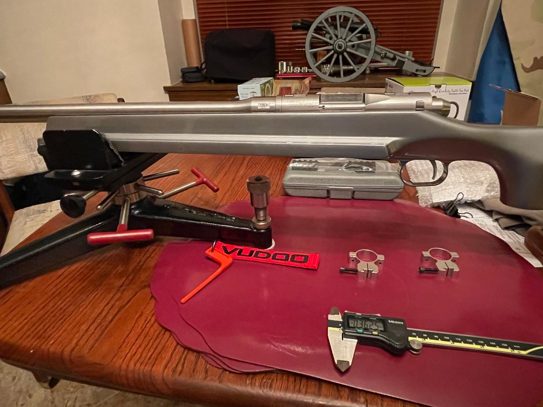

The original post has evolved into a thread on ammo so I thought I would start a thread on just the rifle itself.
Received mine yesterday and it has a slightly dark silver McMillan Edge stock with a 24 " Shilen Ratchet barrel and Flavio 60 degree sear. Absolutely beautiful to my eyes. No time yet to post a picture.
I have a question for other owners. I purchased Kelbly rings and they do not seem to fit. The receiver needs the rings to spread .0330" wider for them t o slide on. Has anyone else had this problem and is fo what have you done. I thuink if I were to file the knife edes of the clamps I would being a bad thing and the rings would not"grip" the receiver well. I will be calling Kelbly latter this morning.
Thoughts?
Suggestions?

I don't know these rings, but why can't you undo the clamps completely and do them back up once in position? Sorry if I'm making a daft comment? But once in place you could torque them correctly.

The Vudoo has the 11mm dovetail mounts milled into the action and will accommodate single screw rings that are 0.500" thick. If you want to use a thicker ring (double screw) you will have to purchase aftermarket dovetail bases with #8 screws and a hole spacing of 0.860"

I got some double screw rings for a 11mm dovetail mounts for my CZ 457 from Amazon. They were made for airguns and work fine. Cost about $10.00 and they gave me the proper hight for the cheak weld I was looking for.

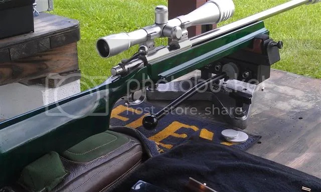

Now, here is a thought, something to consider.
I am an experienced painter and have done multiple stocks, multiple ways.
Paint can/does chip, the best finish is going to be a color coat with a urethane clear, just like all the cars out there, if they’re going with a simple, one coat, gloss enamel, I’d opt out if you can, this is super easy and cheap to get done anyplace that paints cycle parts or a body shop.
one of the nicest, lightest, most resilient finishes I have done on two color gelcoat stocks is to use a straight catalyzed urethane that you can tint. With a few coats it allows you to barely see the gelcoat but after polishing, it is hard, durable, and really pops.
If I have a pic around I’ll post it.
Lastly, remember, if you intend to, somewhere down the road, shoot something like IR 50/50 with a weight class, primer, paint, etc. can build weight fast so you might want the best result with the least amount of layers.

Here is an Edge I did a while back that came, green/gray gelcoat, you can now barely see unless you zoom in.
Sorry about the photoshop overlay, only place the image could be found.
