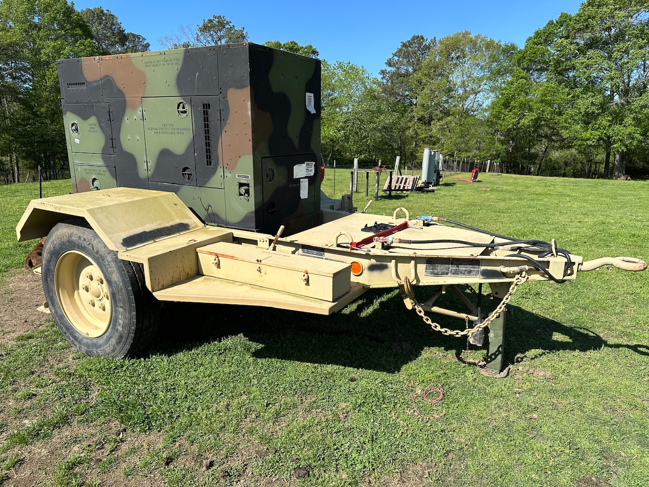

Also got one of these. A 30kW mobile diesel from a GOV auction with only 8 hours on it. Looks brand new! John Deere 4-cyl diesel.
