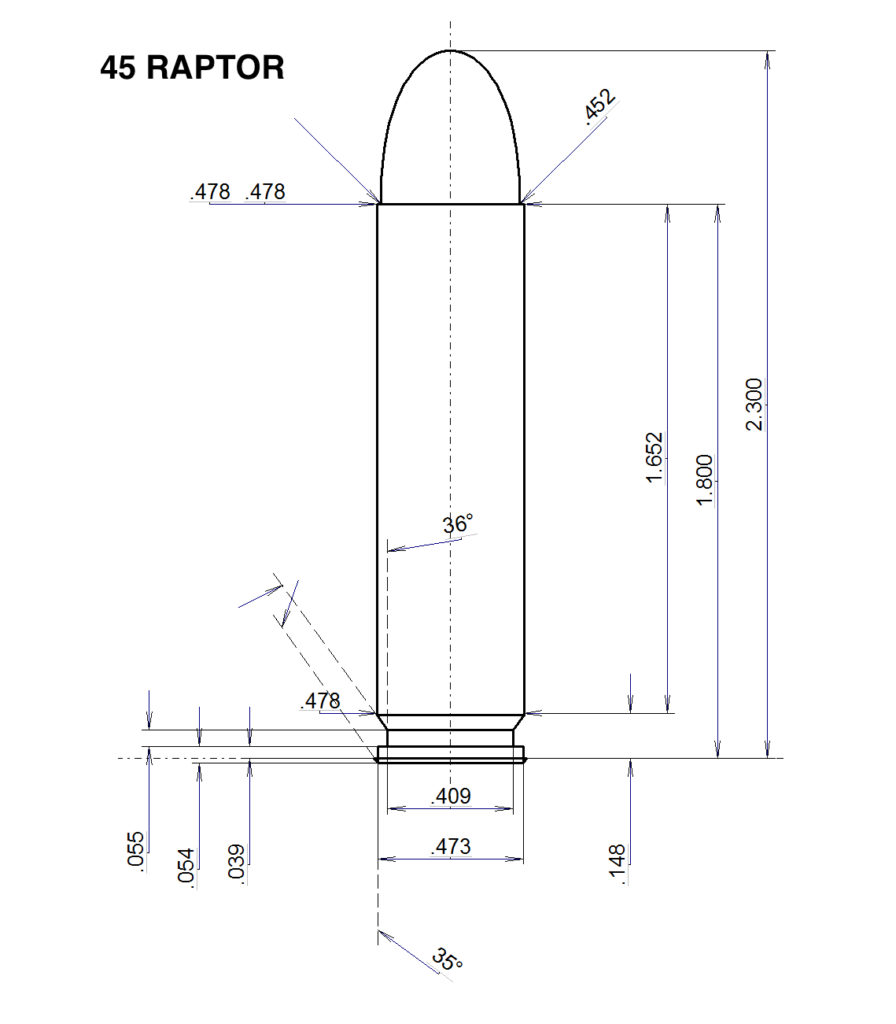

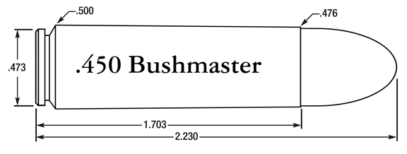

The bushmaster is a slightly tapered case and the raptor is straight wall not sure on the measurements.
Hmmm. Looking at those drawings, it seems like I should be able to fire form the brass, and just not FL resize. Given that there's no shoulder to worry about, I don't see anything wrong with just neck sizing.
I DO appreciate the heads up, though, because my default approach is to FL resize.
