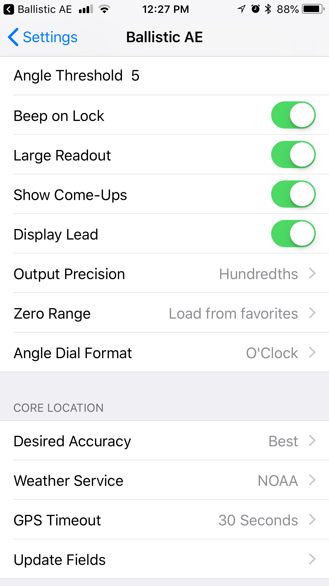

This what mine is set to:
About >> basic settings
Location: while using
Change weather service to NOAA
Go back to current atmosphere and tap the location icon in the upper right corner of the screen to populate the inputs
