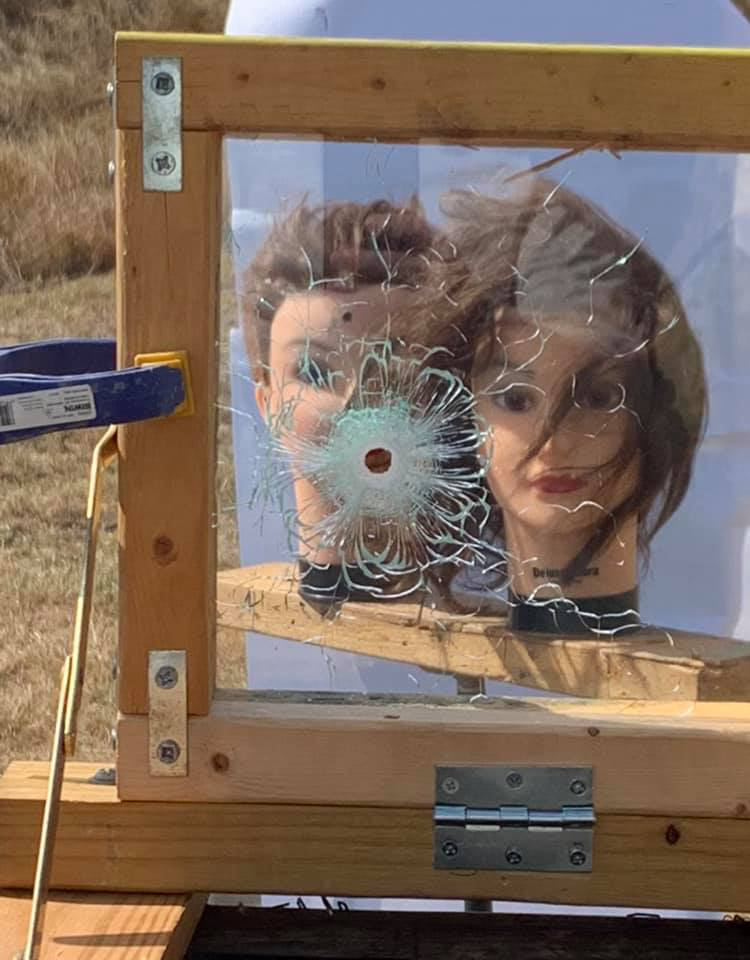

Here's a pic of an example of the training glass is used for. You are able to assess how accurately you can place a shot and what kind of damage is done from the glass.

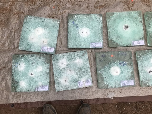

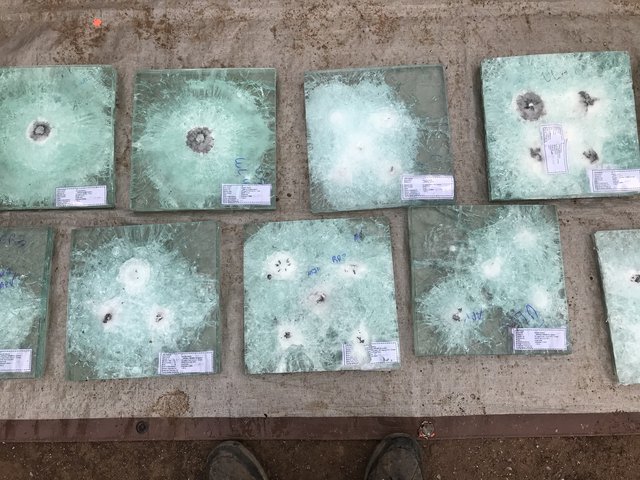

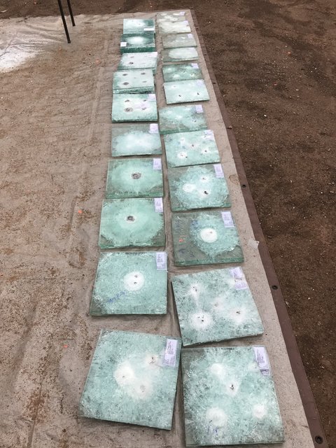

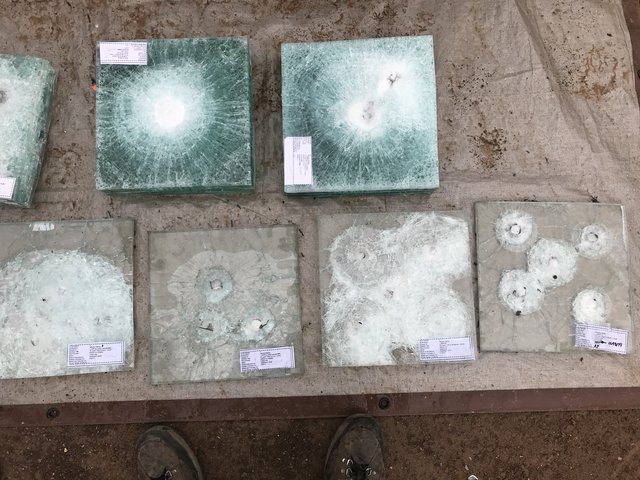

I met an engineer at the local shooting range that designed ballistic enclosures. I ended up helping him out on several of his testing days, setting up the test samples and recording the results.
The samples were usually around 15" x 15" and varied in thickness and weight.
The testing was done at 15 FEET and the test samples were held upright with heavy rubber blocks and clamps so they wouldn't move on impact.
1 to 5 rounds were fired at each sample depending on caliber and testing protocol.
Calibers we tested were 9mm, .357 mag, .44 mag,.45 ACP, 5.56, 7.62x39, 7.62x51 ,30-06 and .50 BMG.
We stood behind a 3/4 inch thick piece of plexiglass with a small shooting port.
Ballistic glass consists of alternating layers of glass and plexiglass, the number of layers and thickness depends on the caliber you're trying to stop.
Basically the glass fragments the bullet and the plexiglass catches the fragments.
Here's few pictures of the samples from one day of testing.
