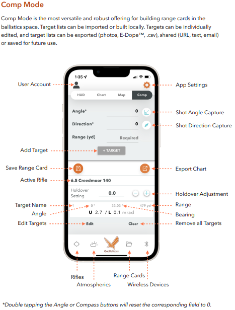

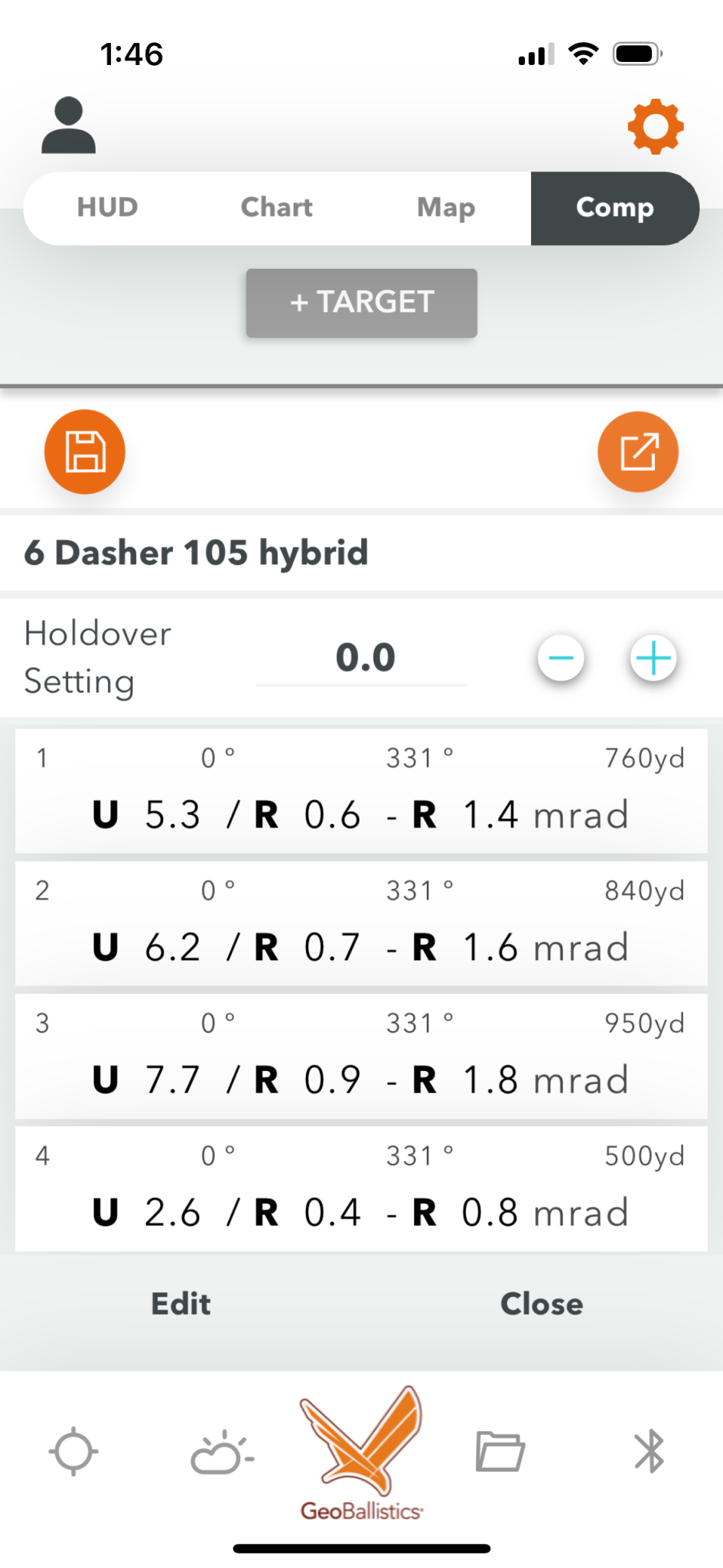

I just downloaded the ballistics app (on the advice of someone else here) so I'm playing with it and will get a better understanding soon.
For shooting matches most of what you use will be the comp mode. Basically you enter what direction and where the targets are and how far and it will tell you the dope you need to use to hit them sequentially.
First target is 760, second target is 840, third target is 950, fourth target is back to 500. It will show you that youll need to dial 5.3 mils, 6.2, 7.7 and then 2.6 mils in elevation on the targets in that order for the stage.
And the 2 wind speeds are my gathered/entered low of 5mph and high of 10 mph winds so I know how much wind I can expect to have to hold on the stage.
You can then save the individual stage card info a folder called a range card and enter the next stage.
I enter all of my stages the morning of the match during the match directors brief (speech) so that I have it ready for me to shoot all day the rest of the day.
