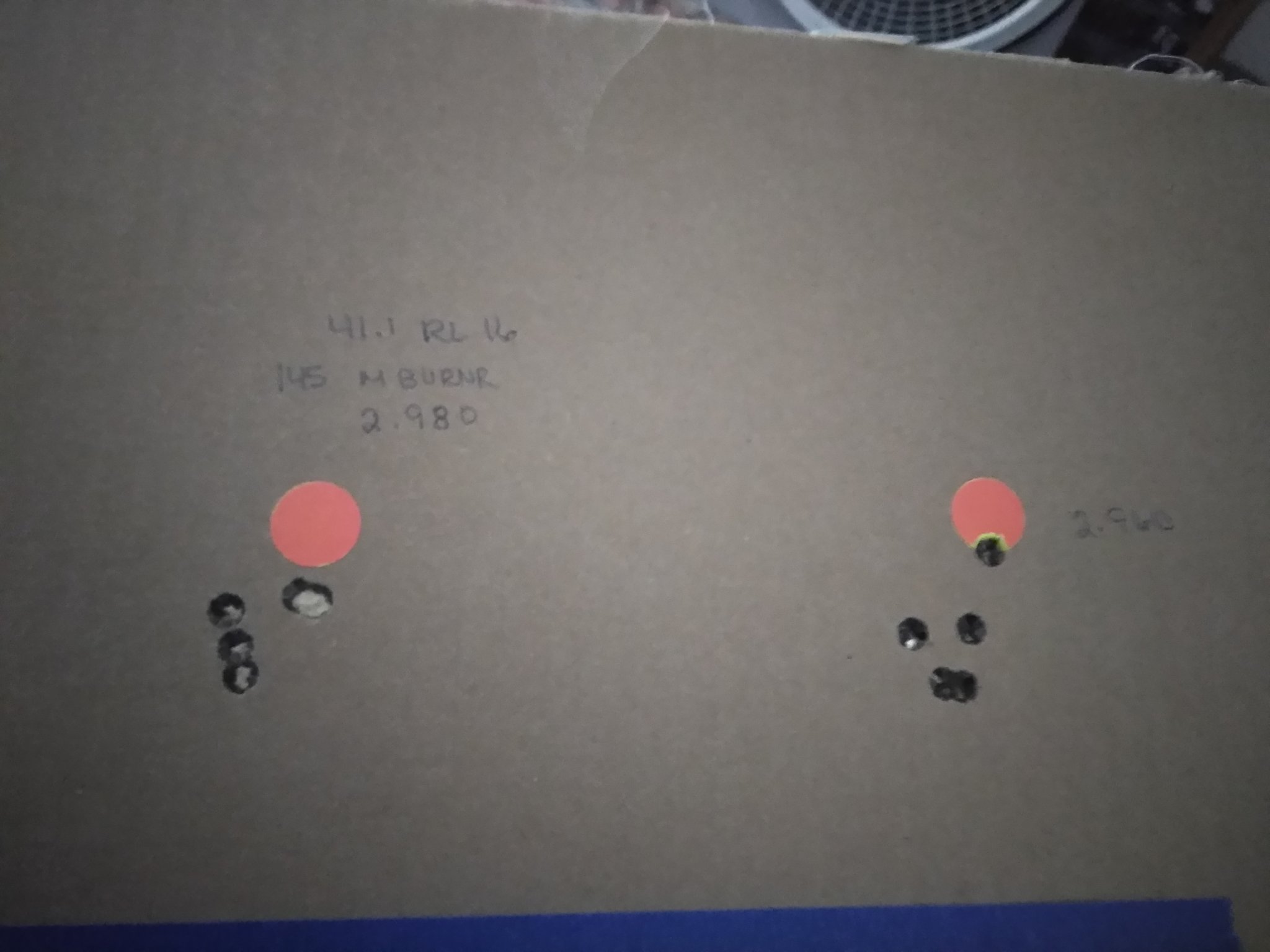

I have shot a handful with RL19(actually RL16), just picked a mid powder charge and 2.850 (actually 2.960&2.980)coal. 5 shot group was around 3/4"& 1 1/16" at 100.
No more testing since then, to damn hot out here right now.
I found 2 groups shot with RL 16. You can see the coal written next to the groups.
Those orange dots are .60. the group on the left is less than 3/4" in the right about 1 1/16".
I don't have the speeds written down but if memory serves me about 2680 fps.

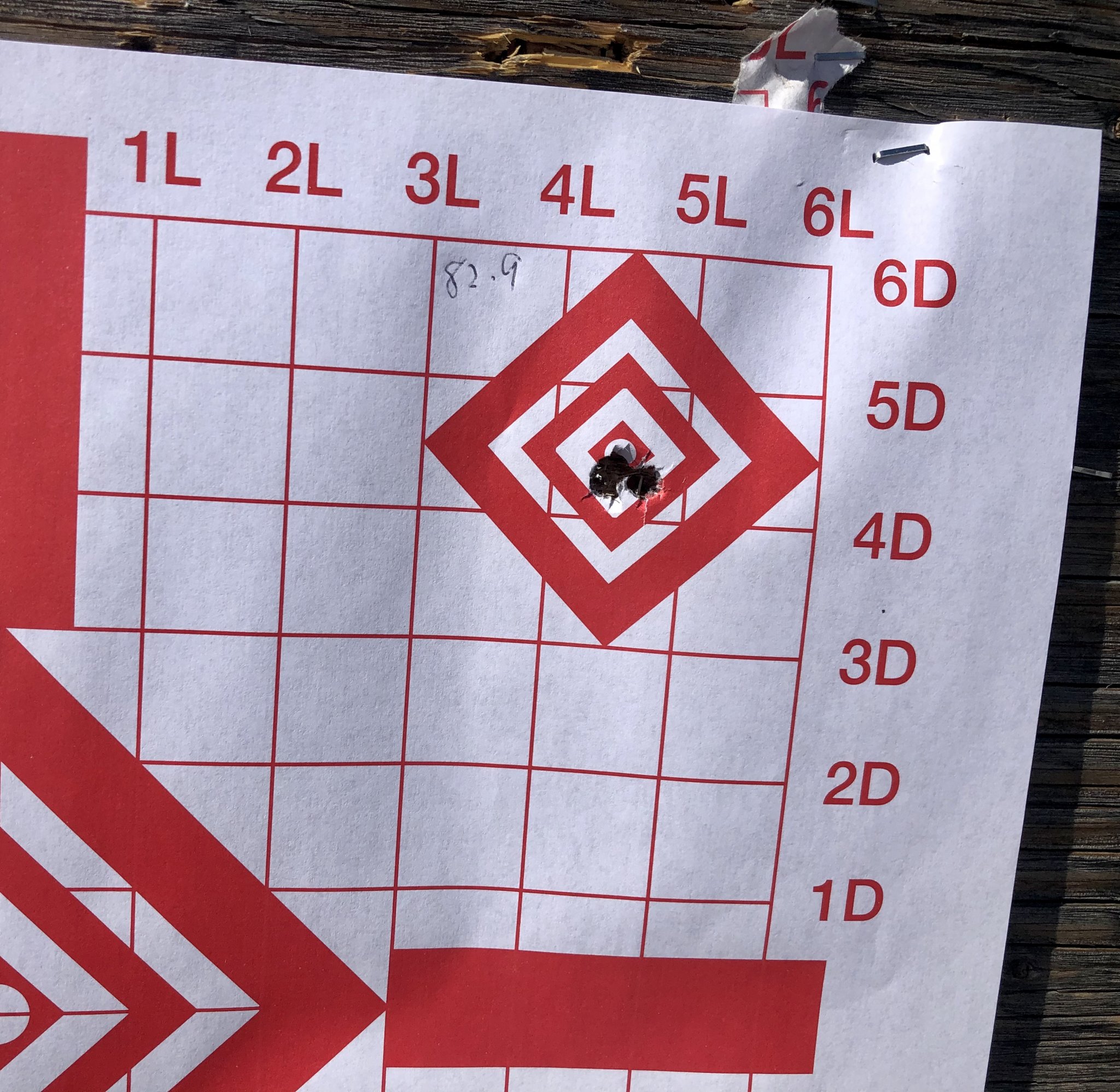

I started with a known good load, near max, for 147 gr ELD-M using H4350 and they went into one hole.
The only thing notable is the further off the lands, the bigger the group.
I was going to use RL-26 but this shoots so well I don’t feel a need for more velocity given the high BC
Done. I think I’m going to like this bullet.

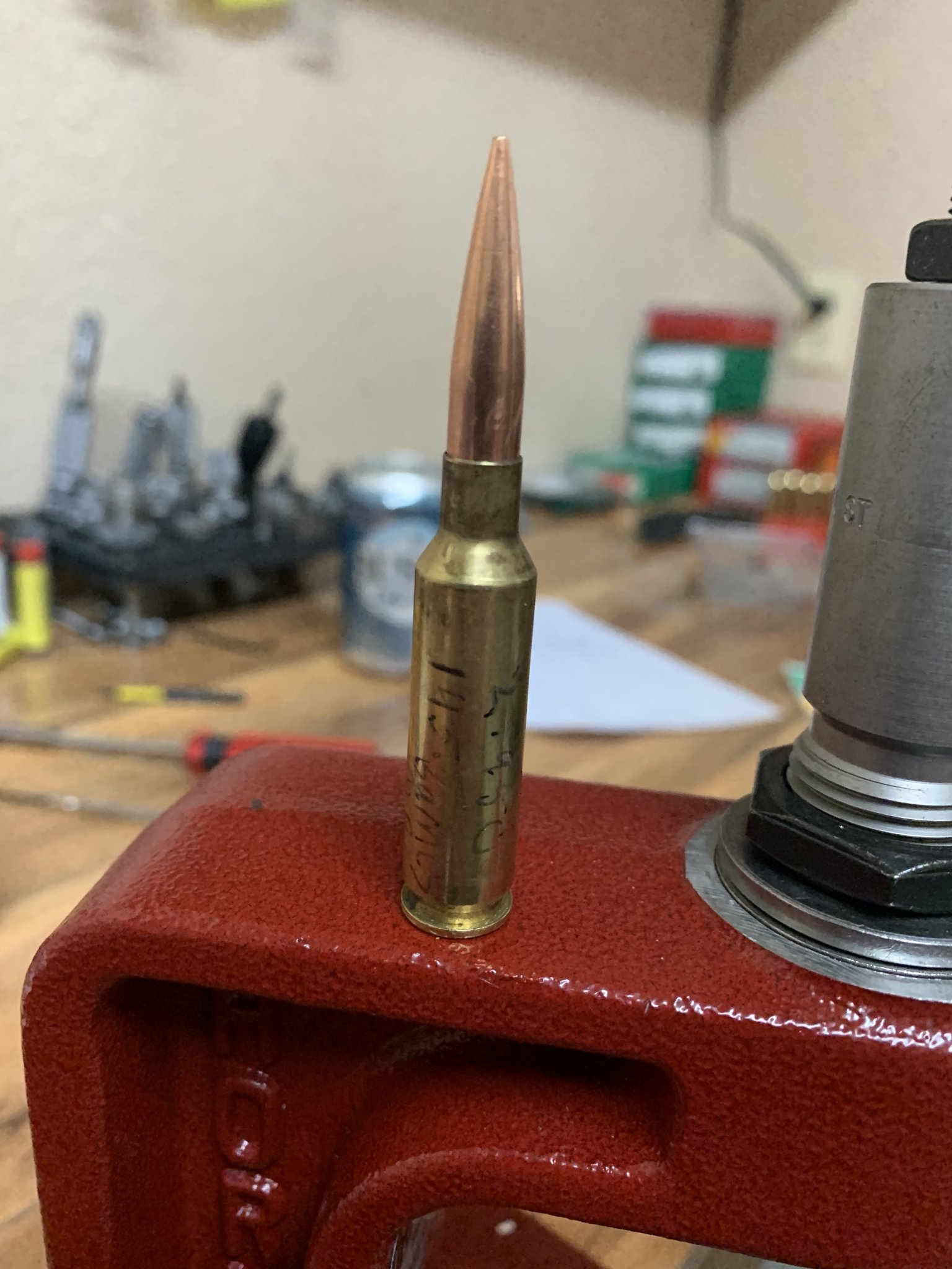

I just received 500 of the 145 Match Burners in the mail.
With my 6.5 Creedmoor Seekins to hit the lands I would have to seat these out at 3.000. I’m going to start at 2.950. They just fit in an American rifle co mag.
Going load with h4350. Hopefully I can find something promising.

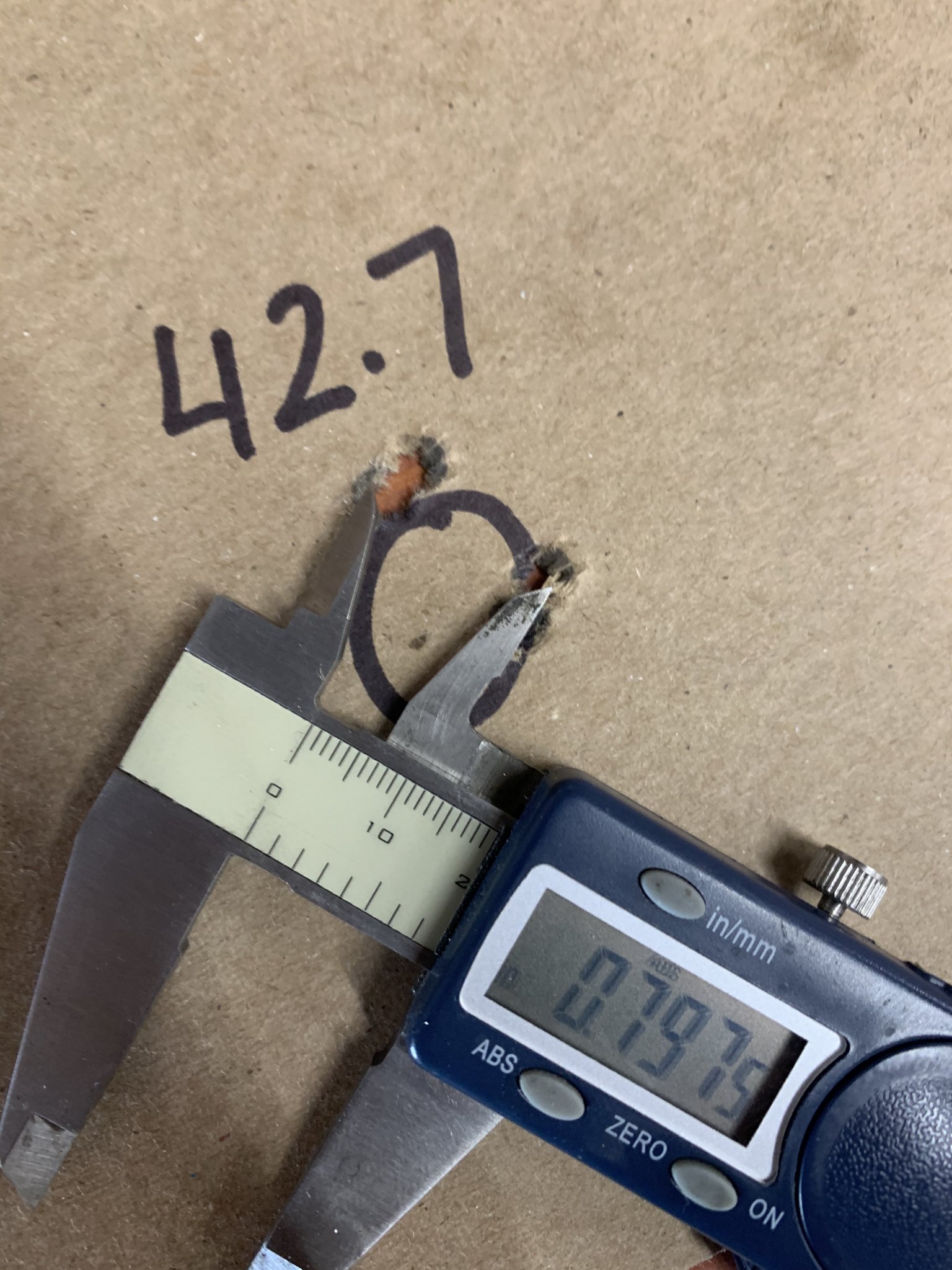

So I started working with these match burners a couple weeks ago and they are showing promise in my Seekins Havak Bravo. I seated the bullets at 2.950. To hit the lands in my rifle they were right at 3.000. At 2.950 the just fit in my ARC mag. Velocity was good and I had no pressure signs. Next load I will mess with seating depth to see if I can tighten up the group.
Seekin Havak Bravo
Prime once fired brass
145 Barnes match burner
Cci200
42.7gr h4350
Coal 2.950
Velocity 2730. Sd 4 Es 10

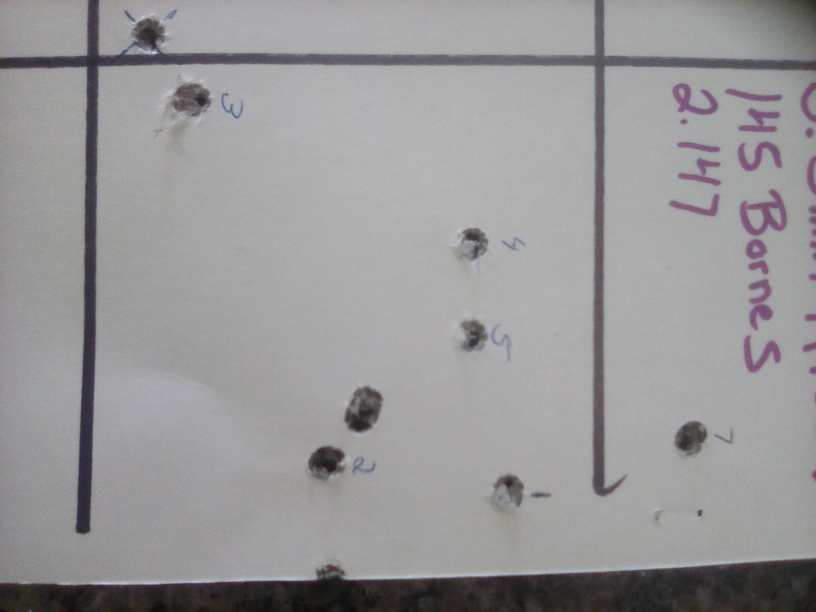

This bullet does not stabilize in my barrel. 24" 1-8" twist. I'm also at sea level. Shot a ladder test at 100yds to start load development. Bullets left oval holes in the paper and was over a 6" group. No its not the rifles fault. Minutes before this, I verified my current match load. I have ~ 1500 if someone wants to trade.

My current 8tw barrel does not stabilize these. Holes 1,2,3,7 left clear oval marks and most of the rest you can see that the pierced hole is off center. This was 100yards and about a 6" group.

I'd look for other issues in your rifle before blaming the twist rate for not stabilizing it. An 8 twist barrel will stabilize 147 ELD-M's just fine and the OAL of those compared to the 145 match burners are almost identical. I think your rifle has issues if its not stabilizing these.
I gave up on them. They showed some promise, but in the end I never could get consistently good groups out of them. They kinda behaved like the RDFs for me.
