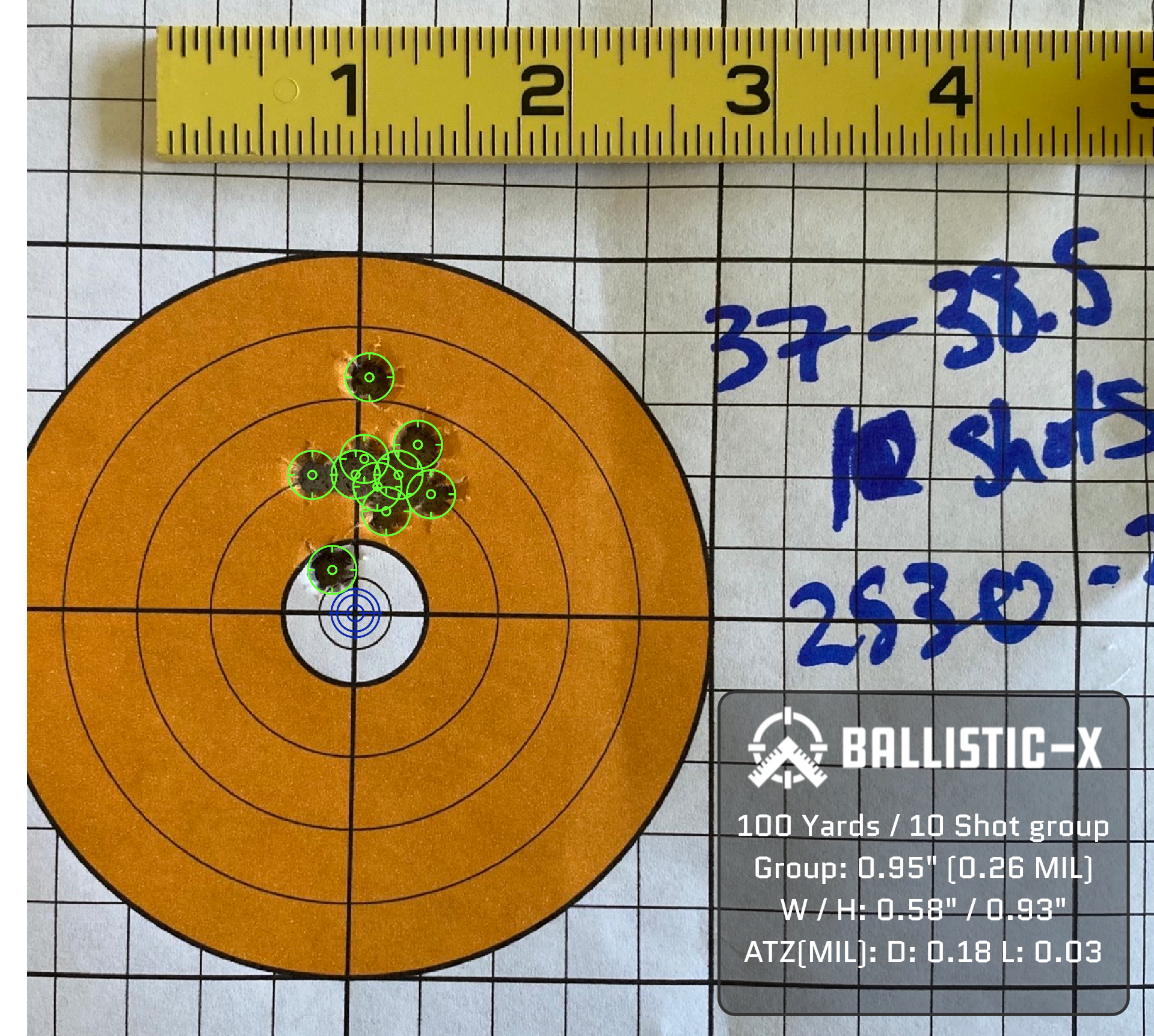

REALLY interesting discussion. I started a few years ago with the 1 shot - clean (x5) and worked my way up (3, 5, etc.) ... always spending my first range day in the "Cleaning Mode". That's how I was told to do it. Stopped that on the last few new rifles and opted for a 20-30 round first range trip focused on zero'ing the scope and getting an accurate velocity measurement ... followed by a good cleaning upon return home. On comparison, the latter has actually settled my groups faster and provided better results. That's when I learned that you can actually "clean the accuracy out of a barrel" if you over-break-in and clean too often. That's been my learning, and my journey.
On a new barrel I clean for carbon at the end of each range session and continue to do this until I notice velocity stabilizes.
On my current Benchmark in 6GT my first three shots averaged 2852, at 64 rounds it had sped up 32 fps and now at 161 rounds I'm 22 fps faster for a total gain of 54fps from new and gains have slowed considerably. Time to start serious load development.

All of my low pressure sighters 37-38.5gr H4350. Low shot I pulled and high shot was 41.5gr looking for max before I went home. Under 1” for a 4.5gr spread, heh.
Well, this is my first "precision" rifle in a chamber I have been looking into for quite some time. I will follow the manufacturers recommendation that's detailed in the owner's manual.
